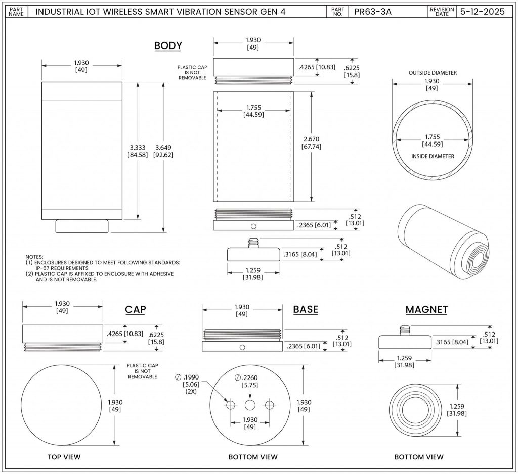

Figure 1: Device Overview

Sensor Specifications
SpecificationsMinimumNominalMaximumNotes
Height85mm
Base diameter48mm
Weight225g
Enclosure RatingIP67
Mounting ¼-28 UNF thread
Magnetic mount
