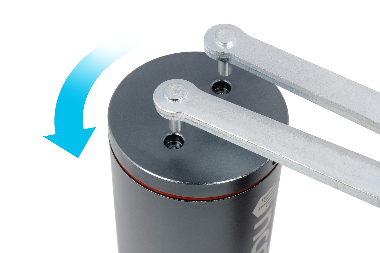

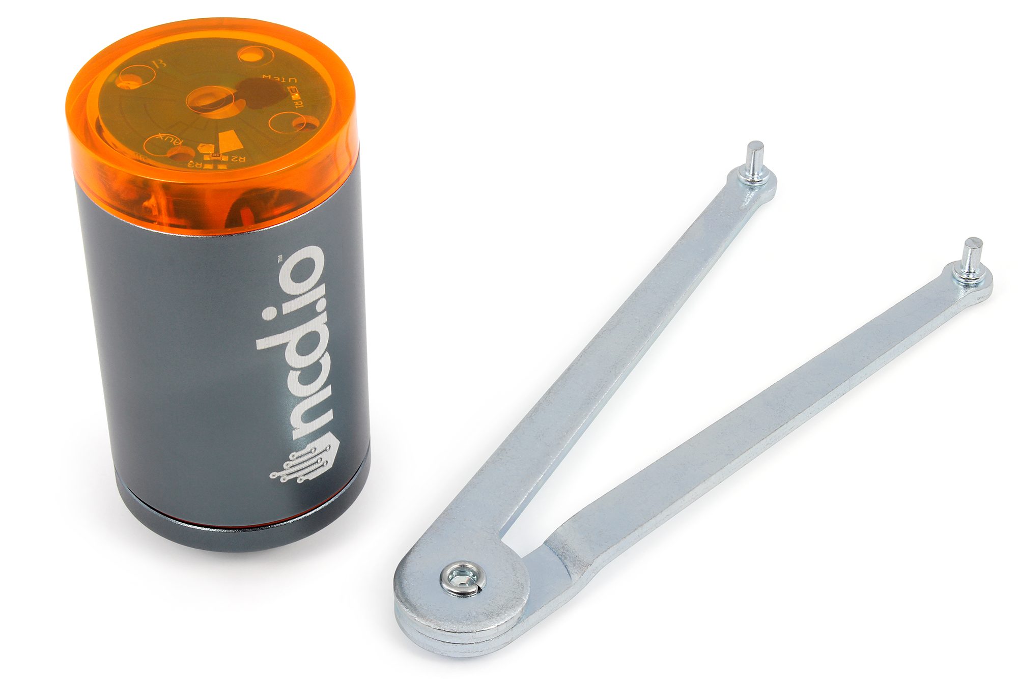

Device and Tooling​
We recommend using the special Spanner Wrench we offer in our store, specifically designed to easily take apart the Standalone Smart Vibration Sensor Gen4.
It is possible to open it up using alternative tooling, however for best results we recommend using our Spanner Wrench.

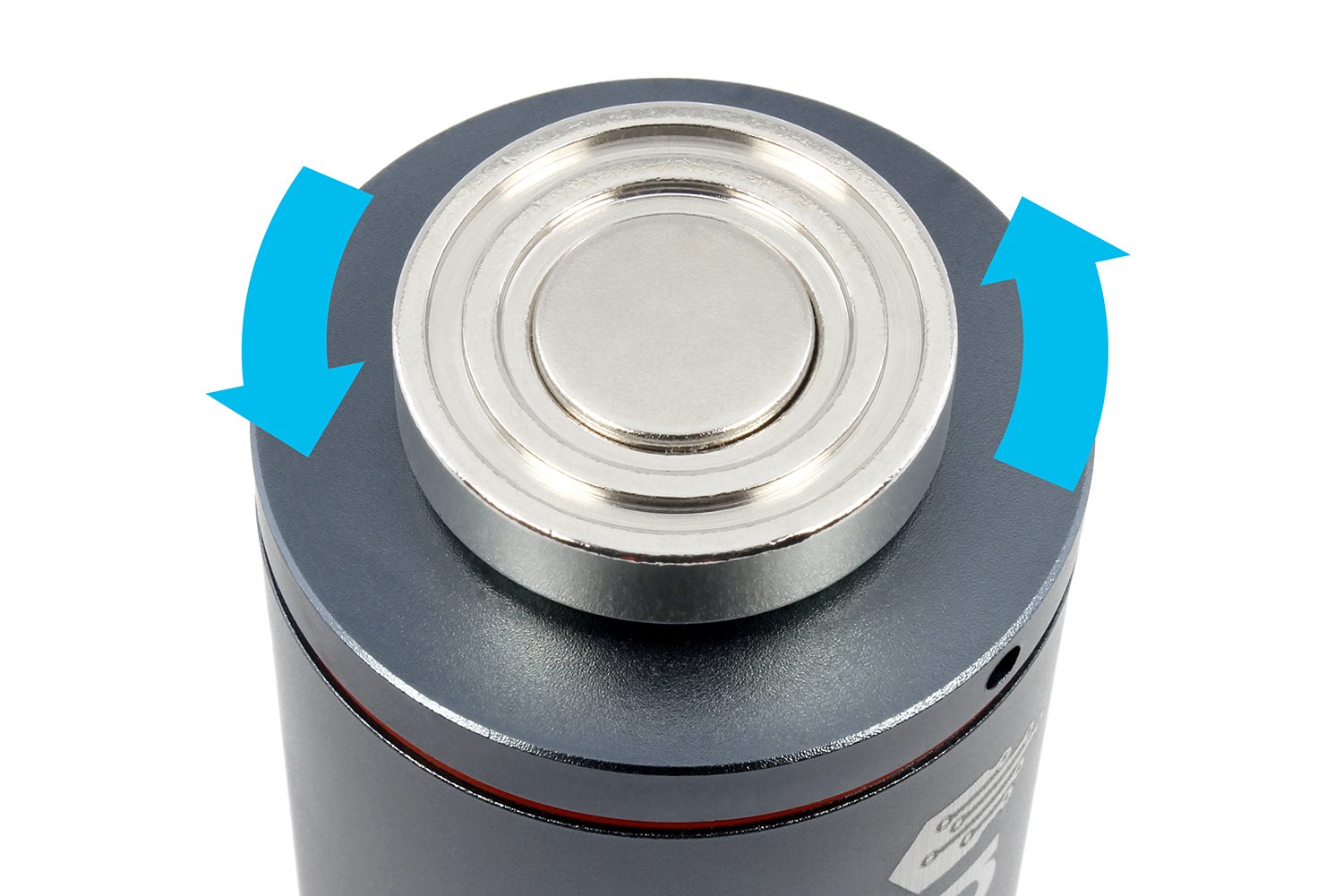

Magnetic Attachment Base
The sensor comes with a magnetic attachment base design for easy mounting to the harness of a motor for example.
In order to open up the sensor, you would need to remove it, which is easily done by hand. Simply rotate it anti-clockwise until it is separated from the body of the device.
Unscrewing the Sensor Base​
Once you have removed the magnetic attachment base, you will expose the two indents that are used as mounting points for the spanner wrench. Insert is as per the image (adjusting it as needed to fit both holes) and rotate it anti-clockwise. You need to firmly grip the other end of the sensor in order for the bottom lid where the spanner wrench is mounted to start unscrewing. Once you have made a few rotations you should be able to use your hand instead of the spanner wrench to quickly unscrew it.

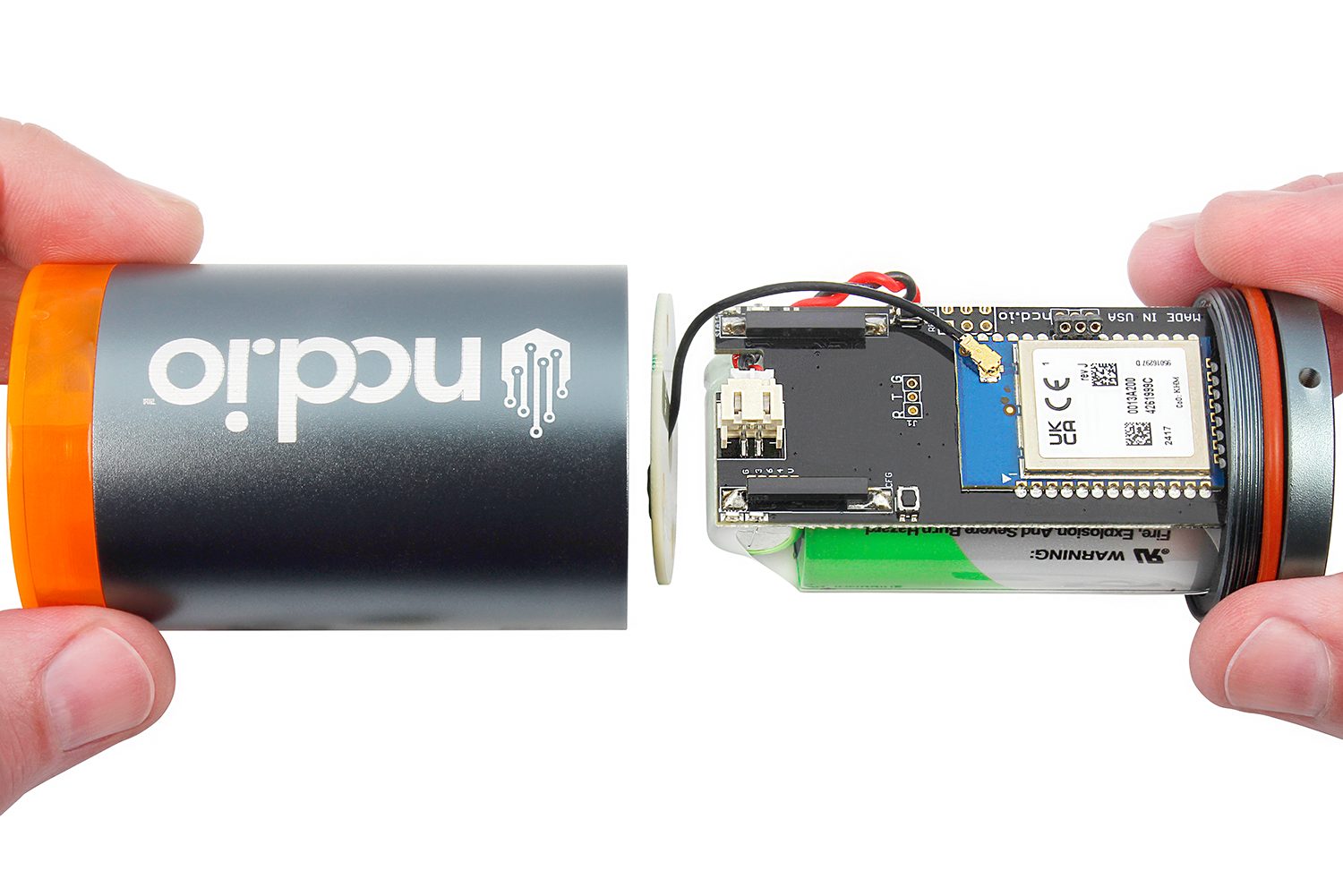

Separating the Enclosure from the Base​
The base you just unscrewed is actually the portion of the device the electronics is attached to. If you pull the top portion (gripping the device around the plastic, orange ring) and the sensor base you will separate the cylindrical part of the enclosure and the base with the electronics attached to it.
At this point you will be able to access the physical buttons, board, RF module, antenna and battery.
Refer to the next section for a detailed image and explanation of the components.

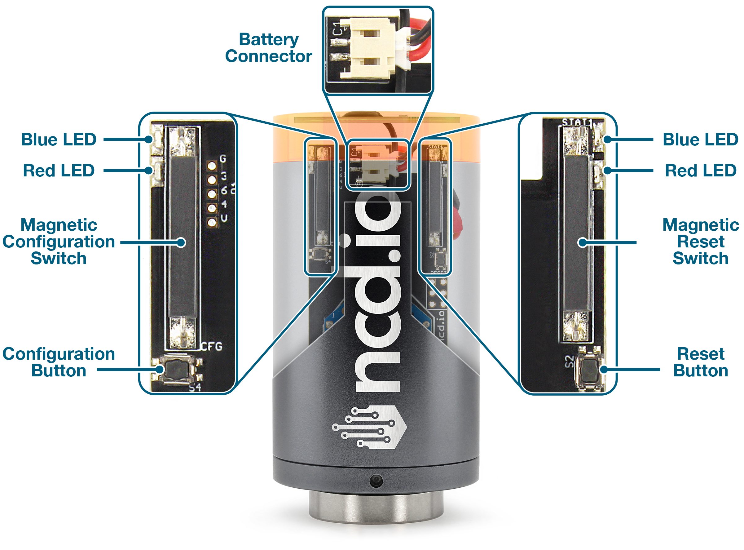

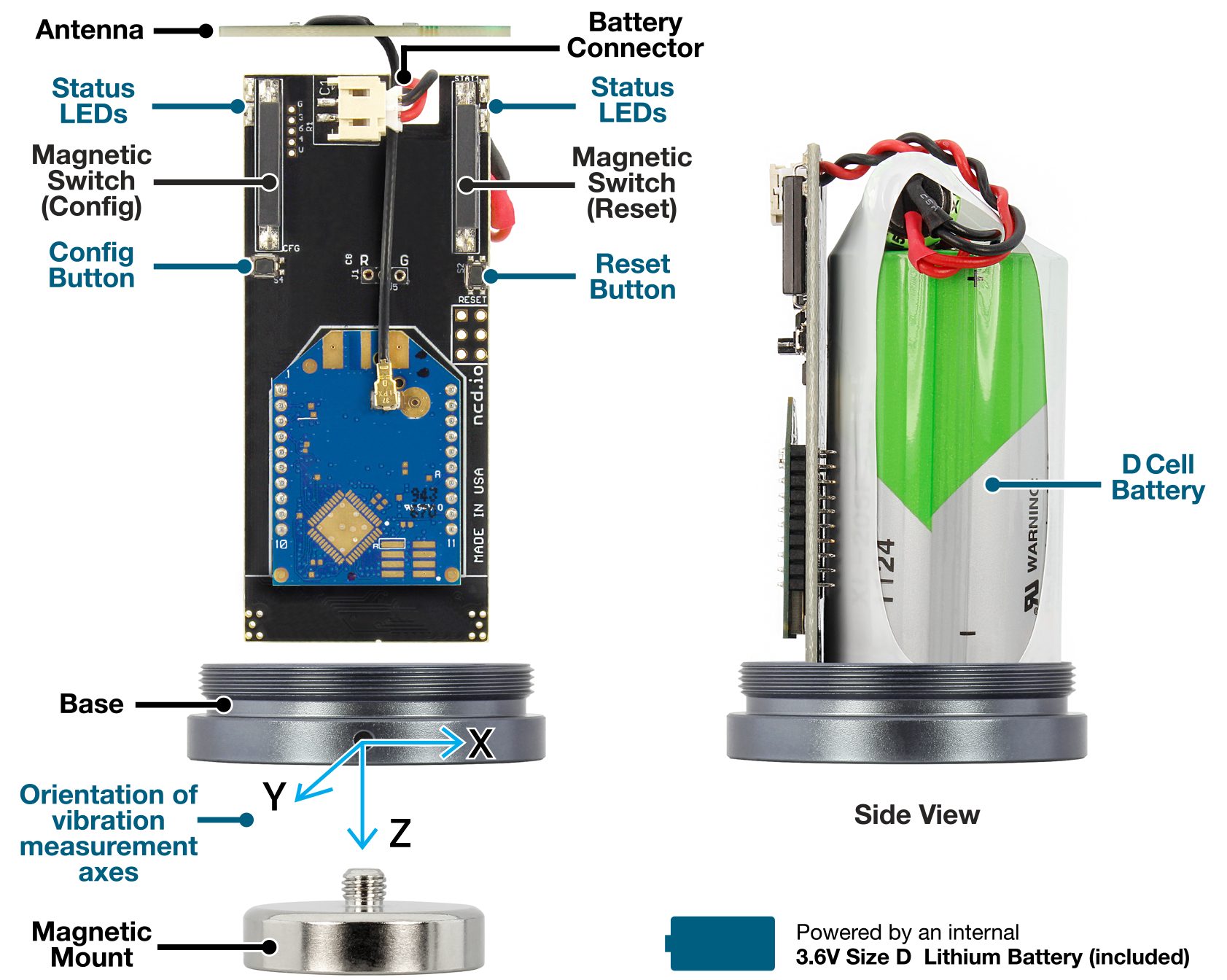

Components Breakdown​
Now that your device has been disassembled you have full access to the components.
Refer to the image for a breakdown of the specific parts and their location.

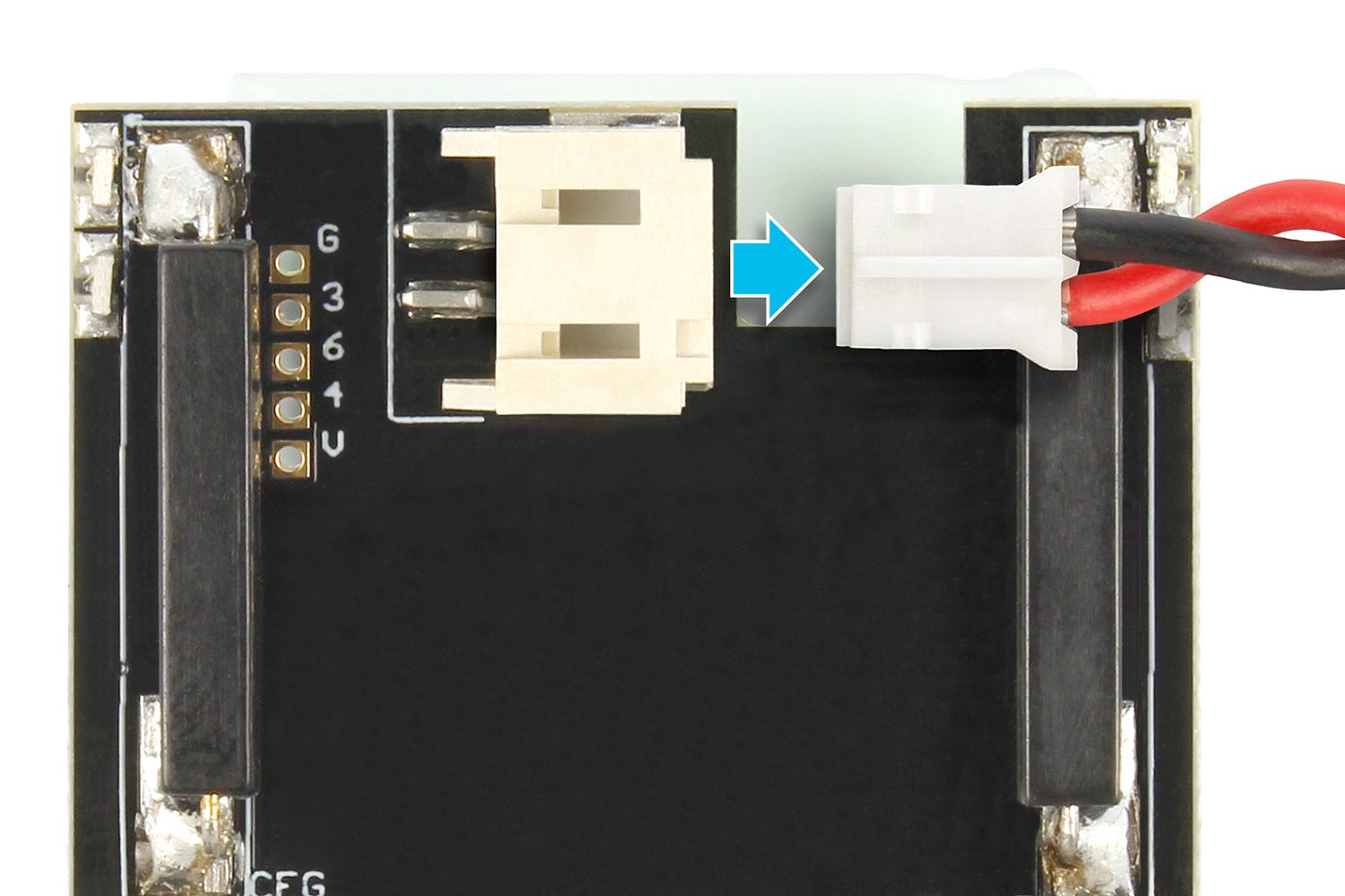

Disconnecting the Battery​
You should not need to replace the battery, for years. However, in case you need to disconnect it for some reason you can do this via the connector on the top of the PCB (refer to the image).
The connector is very solidly inserted, the best way to separate it is to pull on the wire itself, not the connector head, gently wiggling it out.
Hardware Controls​
Powering on the sensor
The device comes with the battery installed and connected, it is powered on and already broadcasting with the default network settings.
The sensor comes in Always on mode and Always sampling mode, meaning it is constantly measuring data. This is useful in case where machines operate for brief intermittent periods or where you have a sudden increase in vibration.
This device can be set up to operate in a special Smart mode, where the device will learn the vibrational pattern of the machine in nominal operation and will only measure/transmit data if the vibration is above a user defined vibration level. It will periodically wake up and check and only transmit if need be. It will also send a sample every 10 wake-up periods, as a keep-alive more than a vibration measurement frame.
RESET / CONFIGURE the sensor
Magnetic RESET Switch
The Magnetic RESET Switch will power cycle the sensor. When the sensor first powers up it will send a sensor_mode message with the mode of RUN.
Magnetic CFG Switch
Magnetic CFG Switch serves two functions.
