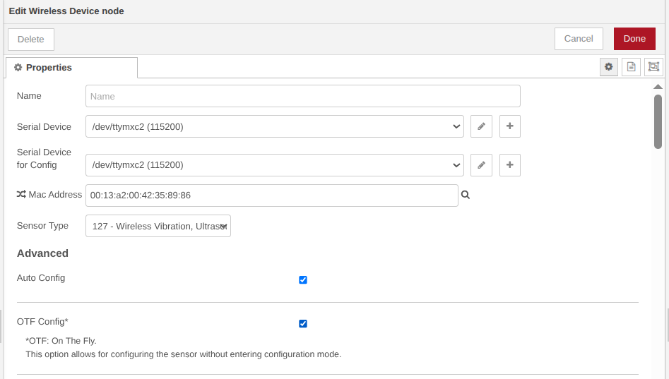

- Wireless Gateway Nodes
- Wireless Node Configuration
- Wireless Device Nodes

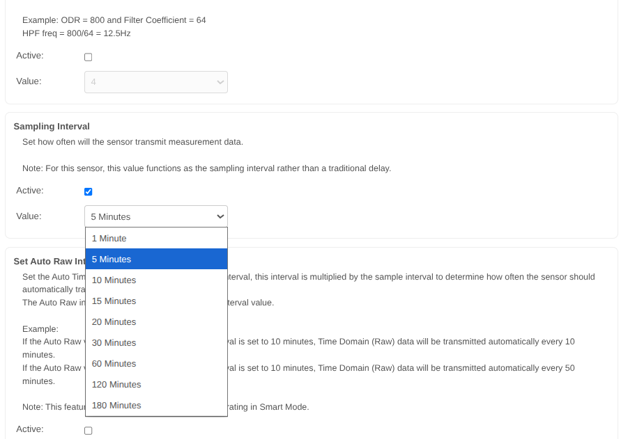

- Sampling Interval

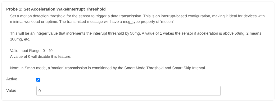

- Probe 1 Set Acceleration Wake Interrupt Threshold

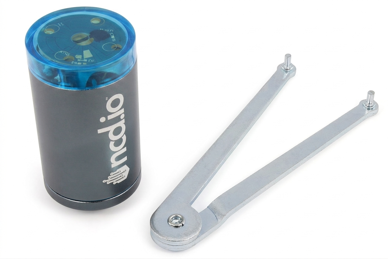

Device and Tooling
We recommend using the special Spanner Wrench we offer in our store, specifically designed to easily take apart the Wireless Vibration, Ultrasound and Temperature Sensor.
It is possible to open it up using alternative tooling, however for best results we recommend using our Spanner Wrench.

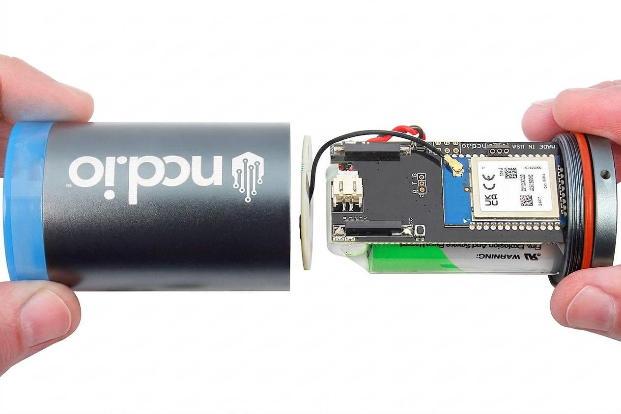

Unscrewing the Sensor Base
Once you have removed the magnetic attachment base, you will expose the two indents that are used as mounting points for the spanner wrench. Insert is as per the image (adjusting it as needed to fit both holes) and rotate it anti-clockwise. You need to firmly grip the other end of the sensor in order for the bottom lid where the spanner wrench is mounted to start unscrewing. Once you have made a few rotations you should be able to use your hand instead of the spanner wrench to quickly unscrew it.
Separating the Enclosure from the Base
The base you just unscrewed is actually the portion of the device the electronics is attached to. If you pull the top portion (gripping the device around the plastic, orange ring) and the sensor base you will separate the cylindrical part of the enclosure and the base with the electronics attached to it.

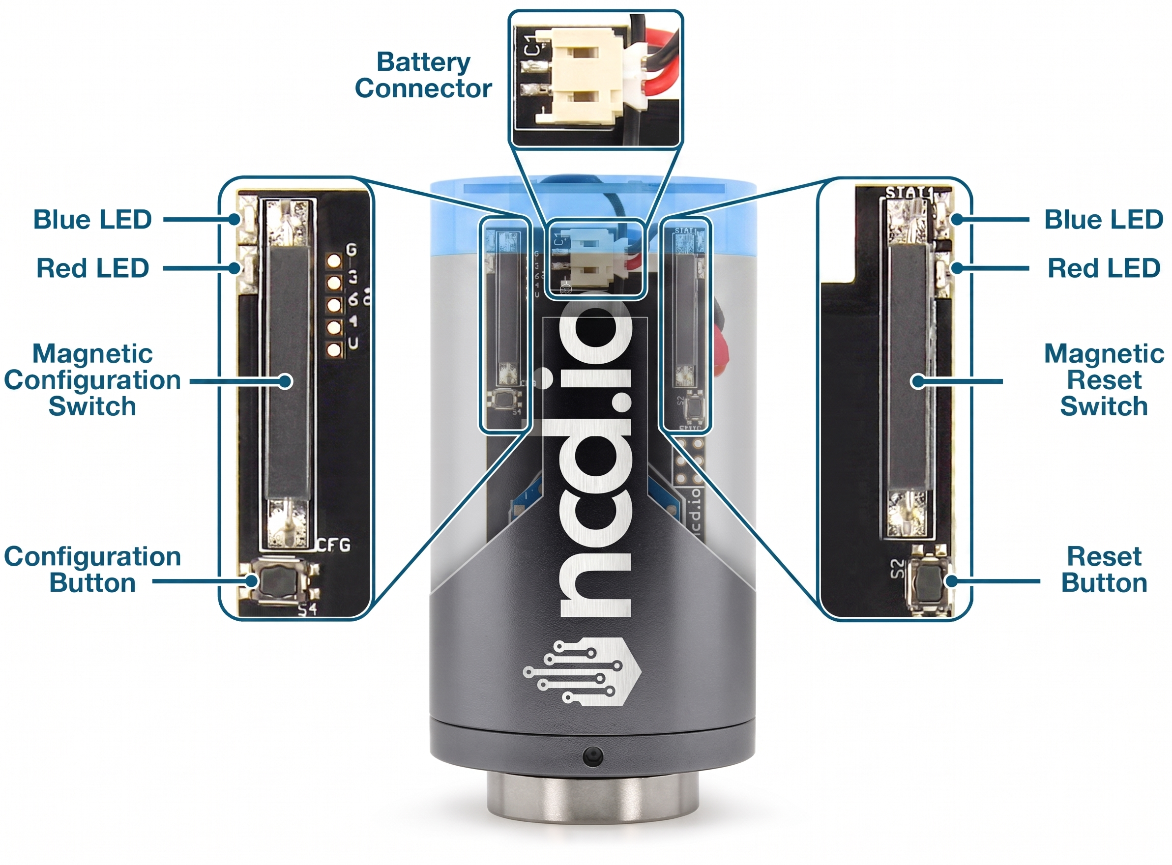

At this point you will be able to access the physical buttons, board, RF module, antenna and battery.
Refer to the next section for a detailed image and explanation of the components.
Components Breakdown
Now that your device has been disassembled you have full access to the components.
Refer to the image for a breakdown of the specific parts and their location.
Disconnecting the Battery
You should not need to replace the battery, for years. However, in case you need to disconnect it for some reason you can do this via the connector on the top of the PCB (refer to the image).
The connector is very solidly inserted, the best way to separate it is to pull on the wire itself, not the connector head, gently wiggling it out.

RESET / CONFIGURE the sensor
Magnetic RESET Switch
The Magnetic RESET Switch will power cycle the sensor. When the sensor first powers up it will send a sensor_mode message with the mode of RUN.
Magnetic CFG Switch
Magnetic CFG Switch serves two functions.
Hardware Mode Selection
Run Mode
Run Mode is the default state of the sensor when powered up. No hardware interaction is necessary to enter this state other than power. Triggering the Magnetic RESET Switch will restart the sensor and put it in the RUN Mode state if no other switches are triggered.
Configuration Mode
You can enter in this mode by briefly triggering the Magnetic RESET Switch and then immediately triggering and holding the Magnetic CFG Switch for ~5 seconds. Refer to the graph below for the precise timing of the Magnetic CFG timings.
Factory Default/Reset
Using Buttons
- Press and release the RESET button
- Wait for a second, then press and hold the CONFIGURATION button
- Hold the CONFIGURATION button for about 20 seconds
- Release the CONFIGURATION button
- Wait for 3-5 seconds
- Press and release the RESET button.
Using Magnetic Switches
- Move a magnet near the RESET switch and then move it away
- Wait for 1 second
- Hold the magnet near the CONFIGURATION switch for about 20 seconds
- Move the Magnet away from the CONFIGURATION switch

| Sampling Interval | 30 | min | |

| Acceleration Wake/Interrupt Threshold | 10 (500mg) | mg | 10*50 = 500mg |

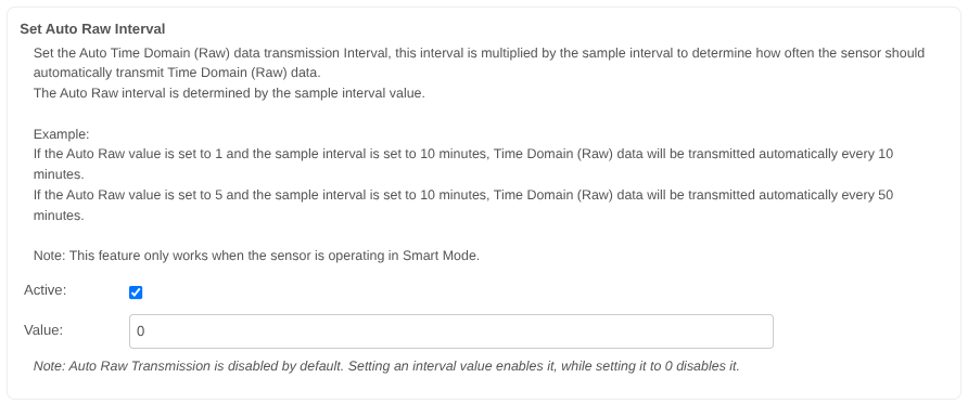

| Auto Raw Interval | Disabled | ||
| Auto Raw Destination Address | 0000FFFF | hex | |

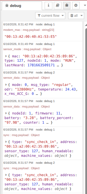

modem_mac Message
A modem_mac message indicates the unique address of the wireless module connected to the Wireless Gateway Node. This message is sent when Node-RED is deployed and when the Wireless Gateway is put into Configuration Mode or Ready Mode. An example modem_mac message can be found on the right.
- topic
- Indicates the type of message this is
- payload
- Contains the unique address of the wireless module on the Wireless Gateway Node
- time
- Timestamp of the message
"topic": "modem_mac",
"time": 1721424259706,
"_msgid": "83ad39df1328dea7"
Wireless Gateway Processed Sensor Data Message
- nodeID
- A user configurable parameter allowing a user to input a simple id for a particular sensor
- For a unique identifier it is recommended to use the “addr” property as it is tied to the individual sensor’s wireless module and will always be unique
- firmware
- This identifies the firmware version of the sensor sending the packet
- battery
- The current voltage level of the batteries at the time of transmission
- The batteries that come with the sensors drop off quickly once they reach 2.6 volts
- battery_percent
- The current battery percent at the time of transmission
- counter
- The number of transmissions since boot or counter rollover
- The counter will rollover after a counter value of 255
- sensor_type
- The machine identifiable type of the sensor
- It is recommended to use this property to dictate dashboard generation and/or data integrity checks
- sensor_data
- Object containing all sensor data related to this sensor
- See section msg.payload.sensor_data Breakdown for more information
- sensor_name
- Human Readable Sensor Type Identifier
- type
- An easily passed message type declaration
- This property will be a duplicate of msg.topic
- addr
- The unique identifier of the sensor that transmitted the data
- received
- Epoch indicator of when the data was received by Node-Red
- original
- Auxiliary information on the packet and underlying protocol
- modem_mac
- The unique identifier of the Gateway/Modem that received the data
- Primarily used to tie locations/projects to sensors/sensor data
"topic": "sensor_data",
"payload": {
"nodeId": 0,
"firmware": 10,
"battery": "3.28",
"battery_percent": "98.56",
"counter": 26,
"sensor_type": 127,
"sensor_data": {
"mode": 3,
"msg_type": "regular",
"odr":"12800Hz",
"temperature":23.67,
"x_rms_ACC_G": 0.001,
"x_max_ACC_G": 0.002,
"x_velocity_mm_sec": 0.03,
"x_displacement_mm": 0.04,
"x_peak_one_Hz": 5,
"x_peak_two_Hz": 6,
"x_peak_three_Hz": 7,
"y_rms_ACC_G": 0.008,
"y_max_ACC_G": 0.009,
"y_velocity_mm_sec": 0.1,
"y_displacement_mm": 0.11,
"y_peak_one_Hz": 12,
"y_peak_two_Hz": 13,
"y_peak_three_Hz": 14,
"z_rms_ACC_G": 0.015,
"z_max_ACC_G": 0.162,
"z_velocity_mm_sec": 1.63,
"z_displacement_mm": 1.64,
"z_peak_one_Hz": 165,
"z_peak_two_Hz": 166,
"z_peak_three_Hz": 256,
"rpm": 167,
"ultrasonic_rms_dBuV": 53,
"ultrasonic_peak_to_peak_dBuV": 67,
"crest_factor": 2.62
"sensor_name": "Wireless Vibration, Ultrasound and Temperature Sensor",
"type": "sensor_data",
"received": 1721424191583,
"original": {...},
"time": 1721424191584,
"_msgid": "d7f3341ef39225df"

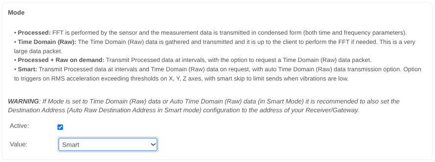

- mode
- The sensor works in one of 4 modes:
- 0 – Processed – FFT is performed by the sensor and the measurement data is presented in condensed form (both time and frequency parameters)
- 1 – Raw/Time domain – the Raw/ Time-Domain (Accelerometer) data is gathered and transmitted and it is up to the client to perform the FFT if needed. This is a very large data packet.
- 2 – On demand – sending Processed data regularly, with the option to request a RAW data packet (Accelerometer or Ultrasound data).
- 3 – Smart – a cutting-edge operational setting. In this mode, the sensor delivers Processed Data (Overall Data) at user-defined intervals, with a Time Domain on Request option for requesting detailed Raw data packets (Accelerometer and Ultrasound), complemented by an Auto Raw Interval that dictates how often the sensor automatically transmits Time-Domain (Accelerometer) measurement data for continuous insights. It features smart mode threshold, triggering data transmission when RMS acceleration exceeds a user-set value on any X, Y, or Z axis, alongside smart skip threshold, which intelligently skips sending data a specified number of times when vibrations fall below the threshold, optimizing efficiency, paired with 24/7 sampling to capture spontaneous issues—ideal for intermittent machine operation—ensuring real-time adaptability and comprehensive monitoring with precision.

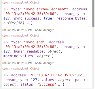

Wireless Gateway Sync Check In Message
This sync_check_in message reports sensor information and allows for sync initialization if configuration changes are necessary.
A sync_check_in message indicates that the sensor is in RUN mode, but is entering a temporary state where it can be configured. The sensor will send the sync_check_in message on boot (after RUN and sensor_data messages) and once an hour after boot to check in. Once the sensor sends a sync_check_in message Node-RED has 2 seconds to respond with a configuration Master Command.

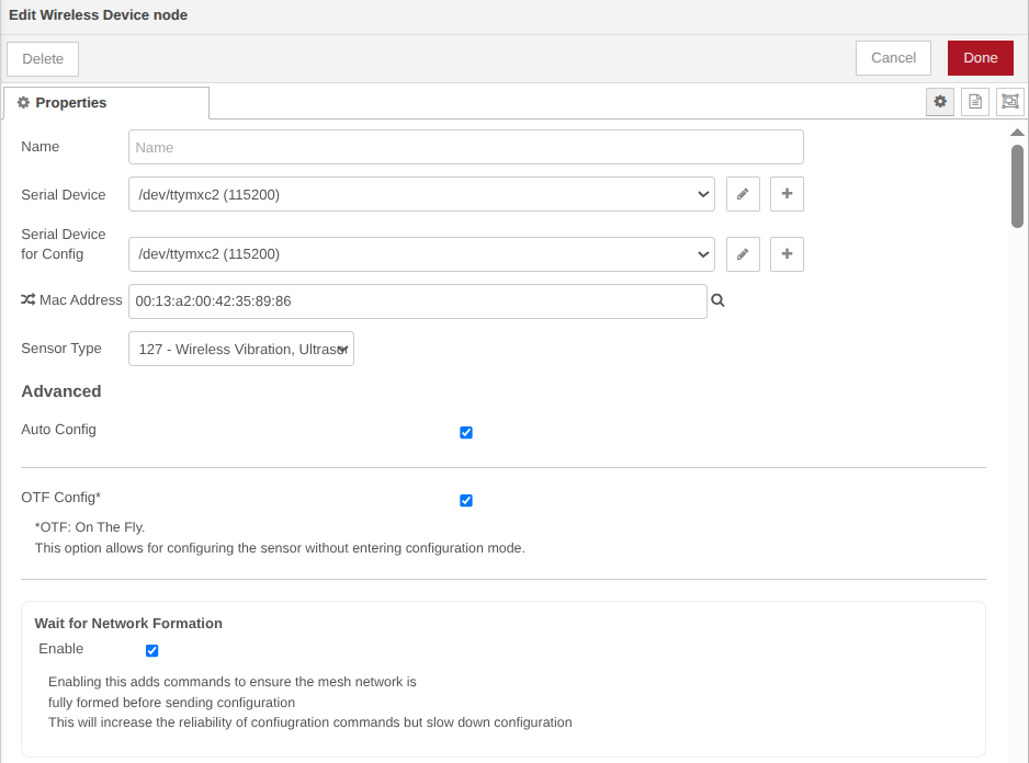

If Node-RED has a Wireless Device node with Mac Address, Auto Config and OTF Config selected corresponding to the sensor that sent the sync_check_in message then Node-RED will begin to configure that sensor.
An example sync check-in message can be found on the right.

"topic": "sync",
"payload": {
"type": "sync_check_in",
"address": "00:13:a2:00:42:35:89:86",
"sensor_type": 127,
"human_readable": {
"core_version": 23,
"firmware_version": 10,
"sensor_type": 127,
"tx_lifetime_counter": 13,
"hardware_id": {
"data": [ 99, 61, 0]
"network_id": "7fff",
"destination_address": "0000ffff",
"node_id": 0,
"odr": "3200Hz",
"sampling_duration": "150msec",
"lpf_coefficient": "4",
"hpf_coefficient": "2048",
"full_scale_range": "+/- 8g",
"axes_enabled": 7,
"sampling_interval": "60 Minutes",
"filter_status": "Disabled",
"operation_mode": "Smart",
"measurement_mode": 0,
"on_request_timeout": "5 Seconds",
"deadband": "15mg",
"motion_detection_threshold": "500mg",
"led_acceleration_alert_threshold": 10,
"led_velocity_alert_threshold": 10,
"smart_accelerometer_threshold": "500mg",
"led_alert_mode": "Acceleration",
"raw_packet_length": "180 Bytes",
"auto_raw_interval": 0,
"auto_raw_destination_address": "00000000",
"smart_mode_skip_count": 15,
"sync_interval": "18 Hours",
"rpm_compute_status": "Enabled",
"max_raw_samples": "4096 Samples",
"motion_to_sampling_delay": "5000msec",
"max_motion_tx_per_interval": 1,
"probe_uptime": "10 Seconds"
"ultrasound_max_raw_samples": "2046 Samples"
"machine_values": { ... }
"description" : "...",
"packet_info": {
"ack": 0,
"broadcast": 0,
"type": ""
"time": 1781217138869,
"_msgid": "33fd88e3ea54492c"
Wireless Gateway Edit Pane
- Name
- An arbitrary name given to this node
- Serial Device*
- A drop down to choose between configured communication interfaces
- The default Serial Device for our Enterprise Gateways is “/dev/ttymxc2”
- To add a new configuration option you will want to choose “Add new ncd-gateway-config…” from this dropdown
- Serial Device Edit Icon
- Clicking this icon will take you to a submenu to edit the particulars of the device chosen in the Serial Device dropdown
- For More information on the submenu this icon bring up see section ncd-gateway-config Nodes
- Output data from Unknown Devices
- Enabling this feature allows other devices using the Digimesh wireless protocol to send their data to Node-Red
- When selected, data from unknown devices will be output from a secondary output

Sync Acknowledgment Message
A sync acknowledgment is received from the sensor in response to a configuration command. This message provides the current sensor status or reports any errors encountered during the configuration process. You may verify the current sensor configuration by examining the human_readable property within the message.
An example of a Sync Acknowledgment message is provided for your reference on the right.

Configuration Options
Our Node-Red library lets you configure any of sensor easily, simply by adjusting a few fields in your Node-RED flow and triggering a configuration update either through the CFG button on the sensor or waiting for a FLY message sent every hour during normal operations (or when the device is reset).
Primary Configurations
- Name
- Arbitrary name of this node
- Primarily used for easy identification in the flow
- Serial Device*
- The primary communication interface used to receive data from the sensor
- Clicking the edit icon will take you to a submenu to edit the particulars of the device chosen in the Serial Device dropdown
- For More information on the submenu the edit icon brings up see section ncd-gateway-config Nodes
- Serial Device for Config
- A secondary communication interface used to configure sensors without losing sensor data
- If no option is selected the communication interface selected under Serial Device will be used for configuration
- A second modem will be required to make full use of this option
- Mac Address
- Using this field allows you to choose a specific sensor that corresponds to this Wireless Device node
- Leaving this field blank allows any sensor of the type chosen under the Sensor Type field to correspond with this Wireless Device Node
- A search icon on the right can be clicked to search for Wireless Devices that the Serial Device has heard from to auto fill information for that device
- Sensor Type*
- This field limits the sensors that correspond to this Wireless Device node to a particular type of sensor
- Auto Config
- Checking the box next to this field tells Node-Red that the sensor(s) corresponding to this Wireless Device node should be configured when put into Configuration Mode manually
- OTF Config
- Checking the box next to this field AND having Auto Config checked tells Node-Red that the sensor(s) corresponding to this Wireless Device node should be configured when a FLY message is detected
- Wait for Network Formation
- This option sends three commands to all local devices on the wireless network to help form the mesh network
- Destination Address
- This option will tell the sensor to ONLY send its data to a single receiver
- For more information on how to get the Address of the receiver module connected to Node-Red see section Wireless Gateway modem_mac Message
- Network ID
- This option allows you to change the Network ID that the sensor will use to report its data while in RUN module
- You will need to make sure that a Gateway or Modem is configured to use this network ID in order to receive sensor data from it after configuration
- Node ID
- Node ID allows you to set an easy to understand unique ID for a particular sensor
- Power
- This option allows you to set the transmission power level of the sensor
- Retries
- Sets the maximum number of retries the sensor will attempt before considering a packet transmission failed
Mode
Sets the Sensor Operation Mode:
• Processed: FFT is performed by the sensor and the measurement data is transmitted in condensed form (both time and frequency parameters).
• Time Domain (Raw): The Time Domain (Raw) data is gathered and transmitted and it is up to the client to perform the FFT if needed. This is a very large data packet.
• Processed + Raw on demand: Transmit Processed data at intervals, with the option to request a Time Domain (Raw) data packet.
• Smart: Transmit Processed data at intervals and Time Domain (Raw) data on request, with auto Time Domain (Raw) data transmission option. Option to triggers on RMS acceleration exceeding thresholds on X, Y, Z axes, with smart skip to limit sends when vibrations are low.

Set Auto Raw Interval
Set the Auto Time Domain (Raw) data transmission Interval, this interval is multiplied by the sample interval to determine how often the sensor should automatically transmit Time Domain (Raw) data.
The Auto Raw interval is determined by the sample interval value.
Example:
If the Auto Raw value is set to 1 and the sample interval is set to 10 minutes, Time Domain (Raw) data will be transmitted automatically every 10 minutes.
If the Auto Raw value is set to 5 and the sample interval is set to 10 minutes, Time Domain (Raw) data will be transmitted automatically every 50 minutes.
Set a motion detection threshold for the sensor to trigger a data transmission. This is an interrupt-based configuration, making it ideal for devices with minimal workload or uptime. The transmitted message will have a msg_type property of ‘motion’.
This will be an integer value that increments the interrupt threshold by 50mg. A value of 1 wakes the sensor if acceleration is above 50mg, 2 means 100mg, etc.
Valid Input Range: 0 – 40
A value of 0 will disable this feature.

If you have a Wireless Device node with Mac address, Auto Config and OTF Config corresponding to the sensor that sent the sync message then Node-Red will begin configuring that sensor according to the settings entered on the Wireless Device node.
Example Auto Configuration Process
If you have entered the sensor Mac address, selected the Auto Config and OTF Config boxes, your sensor will pick up any configuration changes you have made to the Sensor Specific parameters and automatically apply them.
This process is not immediate and requires the device send a sync Message to the Gateway (this happens once every hour or when the device is reset).
Once the sync message has been received the device will enter OTN mode (indicated by a corresponding message) and update any parameters that have been changed.
Once done the device will continue its normal operating with the updated parameter values.

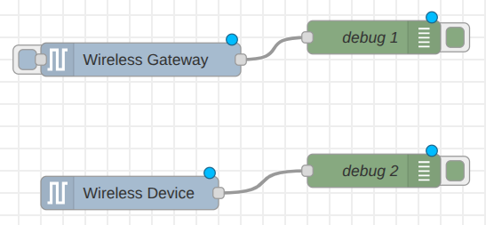

Step 1
Draw and drop a Wireless Device node and connect a debug node at the Wireless Device node, then double click on Wireless Device node to access its properties. Enter the Mac Address of the target sensor, check the two boxes, the one next to “Auto Config” and the one next to “OTF Config”. This will allow the device to work in a mode where it will Automatically pick up the configuration changes.

Select the parameter you want to modify.
Let’s go to the “Sampling Interval” and change its value. This parameter determines how often the sensor wakes up, performs a vibration measurement and transmits the data.
The default value is 30 minutes, let’s change it to 5 minutes (keep in mind this will drain the battery faster, but it is a good example as it is easy to observe the change).
Make sure you check the “Active” check box, this will let the sensor know that it needs to update this parameter.
Select the value from the drop down menu, in this case 5 minutes.
Press the “Done” button to close the Wireless Device node.
Press the “Deploy” button so you can update the flow.

Reset the sensor in order to trigger a sync message (this will speed things up so you don’t need to wait for the 1 hour automatic sync message time).
You will receive a series of messages which are normally sent after deploy and the sensor starts (modem_mac, RUN, sensor_data, then sync_check_in).
The most important element here is the sync_check_in message, which reports the device’s current configuration at the moment it is transmitted. You can view an example of this message on the right for your reference.
Once the sensor sends a sync_check_in message, Node-RED receives it and compares the sensor’s current settings with your newly desired settings. If they do not match, Node-RED recognizes that an update is needed and automatically sends a master command to apply the new configuration.
For example, in this specific case, the sensor’s current sampling_interval is set to 30 minutes, but we want to update it to 5 minutes. Because Node-RED detects this difference, it will automatically initiate the sync configuration process to update your device.

After the sync configuration has finished, you can verify the new sensor settings by expanding the sync_end message in the debug window. There, you can review the human-readable properties to see the actual configurations applied to the sensor. In this example, the sampling_interval will now show as 5 minutes.

Check Sensor Power
Press the CFG button on the sensor. If the TEST LED on the sensor lights up then the sensor has power. If the LED does not light up try swapping out the battery.
If the LED still doesn’t light up after changing the battery contact us for additional troubleshooting steps.
Factory Reset Sensor
- Factory Reset the Sensor
- Factory reset by pressing and release the RESET button, wait for a second, then press and hold the CONFIGURATION button, hold the CONFIGURATION button for more than 15 seconds, release CONFIGURATION button, then Wait for 3-5 seconds, finally press and release the RESET button.
- You should receive a sensor_mode message with the mode of PUM and then a second sensor_mode message with the mode of RUN
- It is recommended to have a Debug node connected directly to the Wireless Gateway node to see these messages
