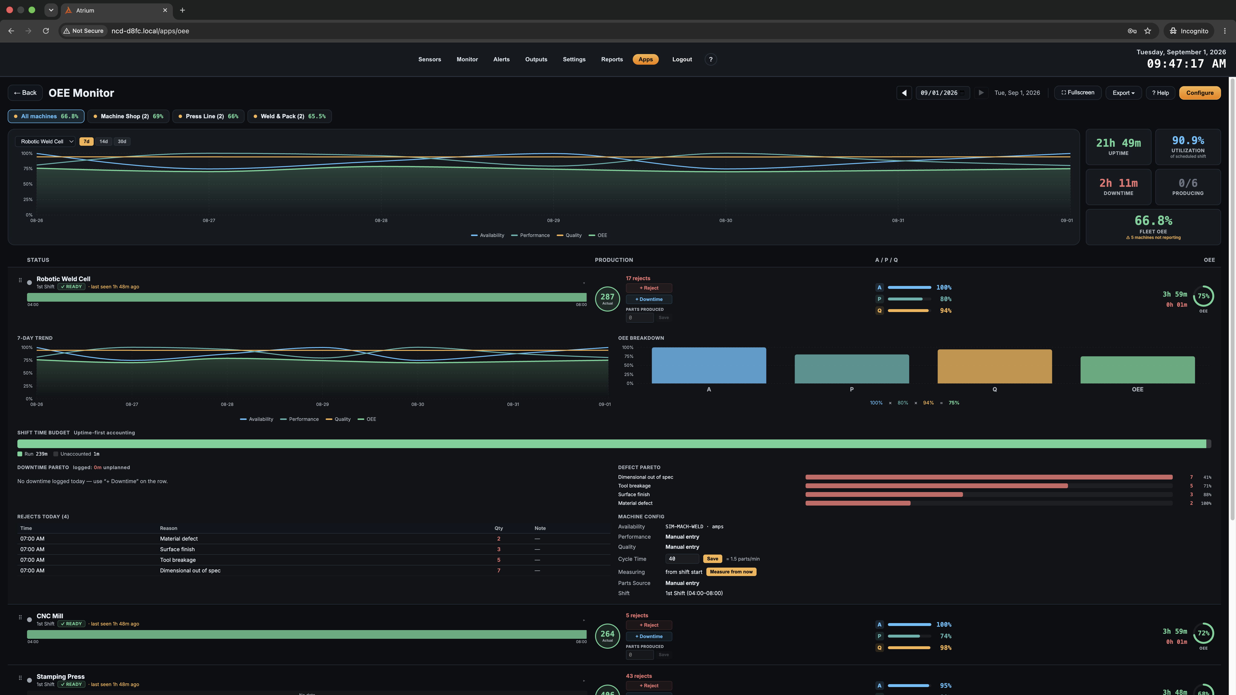

10 oee dashboard

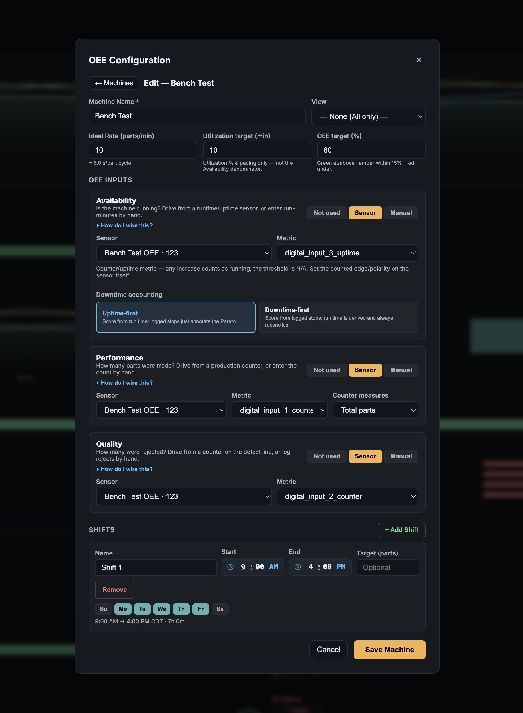

The OEE app — fleet OEE and each machine’s score, broken into Availability × Performance × Quality with reject counts.
When you add a machine in the OEE app, you map each factor to the counter: an uptime metric drives Availability, a counter drives Performance (parts made), and a second counter or logged rejects drives Quality.
11 oee machine config
Configuring a machine in the OEE app — the production counter feeds Availability (an uptime metric), Performance (a counter), and Quality (a second counter).
