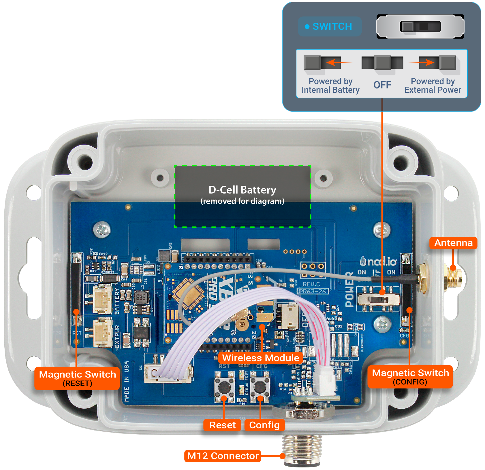

Powering On
  1. 1
    Open the enclosure
    Remove the four screws on the top of the enclosure and lift the lid to access the PCB, the power switch, the RESET and CFG buttons, and the TEST LED.
  2. 2
    Set the power switch
    Slide the 3-position power switch to Battery Power, or to External Power if you are powering the sensor from the barrel-connector supply (external power runs with battery backup). The Off position disconnects power for storage.
  3. 3
    Confirm power
    Activate the CFG magnetic switch by holding a magnet to it — or, with the lid off, press the on-board CFG button. The TEST LED illuminates while activated, confirming the board has power. If it does not light, re-check the power switch position and the battery or external supply.
01 sensor enclosure open
Inside the wireless enclosure: the PCB and wireless module, the D-cell battery bay, the 3-position Battery / Off / External power switch, the RESET and CONFIG controls, the antenna connection, and the M12 connector that the pressure probe plugs into.

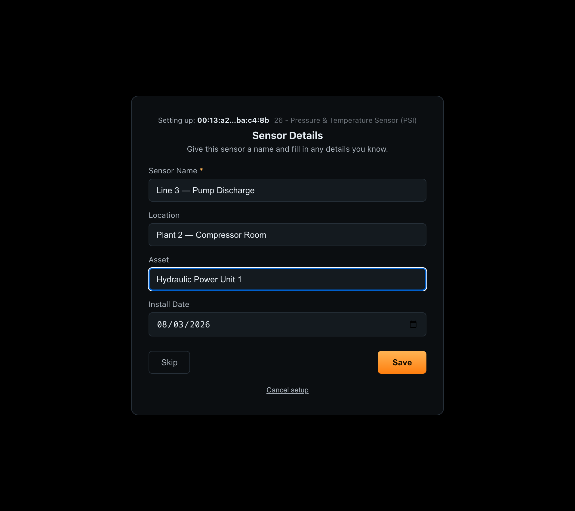

    Open Atrium and go to Sensors
    Navigate to your gateway’s local address (e.g. http://ncd-[last-4-of-MAC].local) and click Sensors in the top navigation. A banner shows “X sensors need setup” with detected sensors grouped by type. Your unit appears under the Pressure sensor type.
  3. 3
    Open the Sensor Details wizard
    Click the sensor in the banner (or in the Sensors table) to open the Sensor Details wizard. New sensors start pending (blacklisted) — completing the wizard whitelists the sensor so Atrium begins logging its data.
  4. 4
    Enter details and save
    Give the sensor a Sensor Name, Asset, and Location (see Section 6). Use Save to whitelist and finish, Save & Next to move to the next pending sensor, or Skip to leave a sensor pending for now.

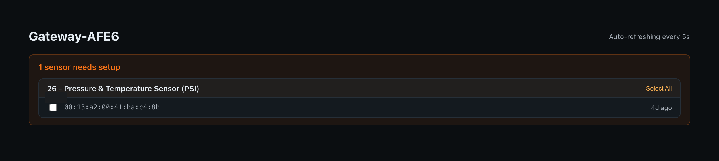

02 sensors needs setup
Atrium detects new sensors automatically and lists them in the “sensors need setup” banner, grouped by type.
03 setup wizard sensors
The Sensor Details wizard — complete it to whitelist the sensor. Use Save, Save & Next, or Skip.

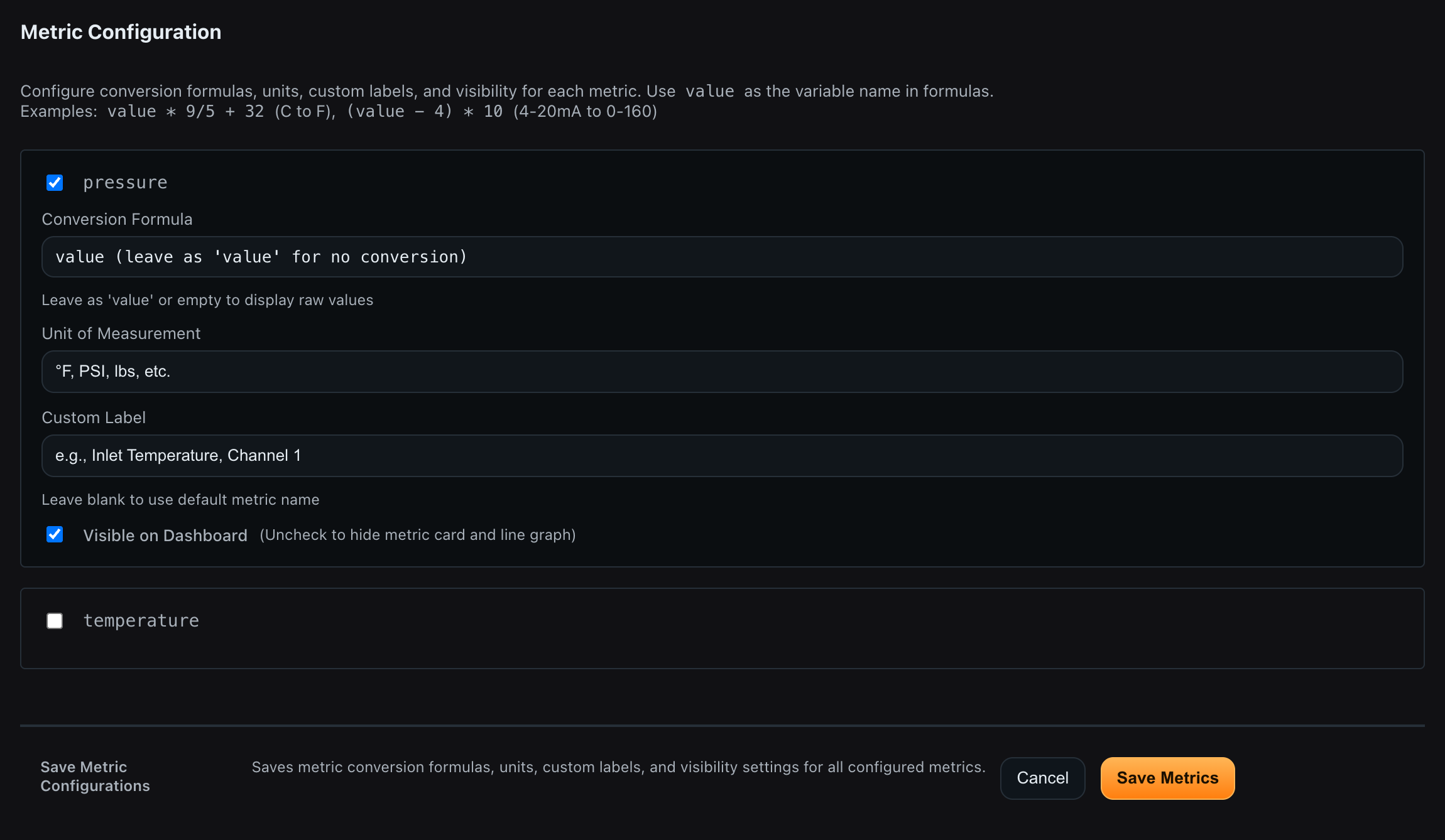

07Metric Configuration
The Metrics tab lets you configure conversion formulas, units, custom labels, and dashboard visibility for each data channel. Access it via Configure → Metrics. This sensor reports pressure and temperature, plus battery and packet-metadata channels.

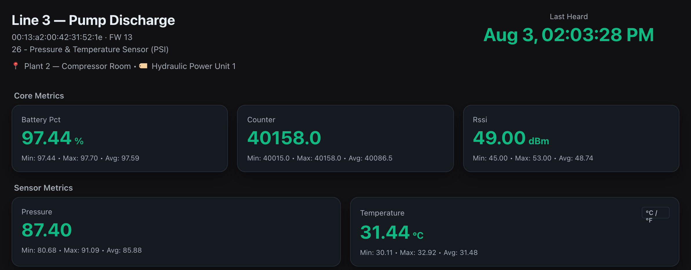

MetricUnitDescription
pressurePSIProcess pressure on the selected range
temperature°C or °FOn-board temperature (display unit set globally — see Section 9)
battery_pct%Estimated remaining battery capacity
battery_vVBattery voltage (separate from battery_pct)
rssidBmReceived signal strength — reported as a positive magnitude; higher values mean a weaker signal
counter—Transmission counter (0–255, then rolls over); useful for detecting missed packets
Custom Conversion Formulas
Each metric supports a custom conversion formula using value as the variable name. Leave the formula as value or blank to display raw data. Examples for converting the pressure reading to other units:
Formula examples
value * 0.0689476     // Convert pressure from PSI to bar
value * 6.89476       // Convert pressure from PSI to kPa
value / 14.5038       // Convert pressure from PSI to MPa
value * 2.03602       // Convert pressure from PSI to inches of mercury (inHg)
Custom Labels & Visibility
Each metric can be assigned a Custom Label that replaces the default metric name throughout Atrium. Unchecking Visible on Dashboard hides that metric’s card and chart without deleting data — useful for focusing a dashboard on the pressure and temperature channels that matter for a given asset.
04 metrics config
Metric Configuration — each metric exposes a conversion formula, unit, custom label, and a dashboard-visibility toggle.
