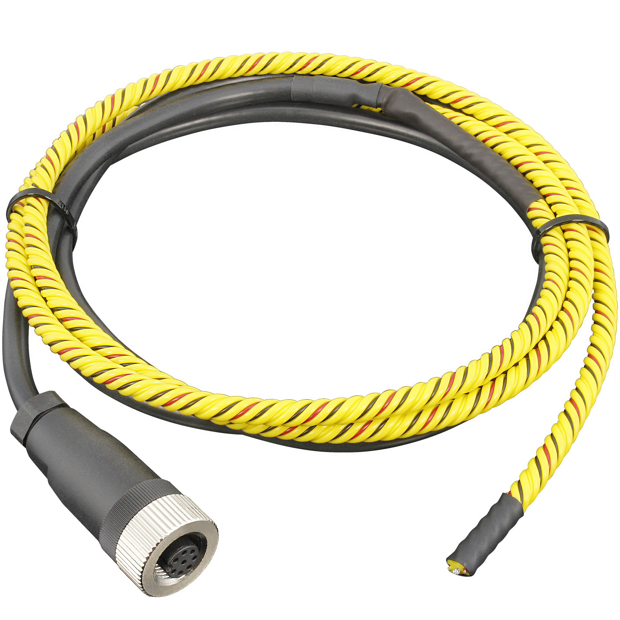

probe rope
Water rope (linear) probe — a conductive sensing cable; route it along a perimeter or pipe run to detect water anywhere along its length.

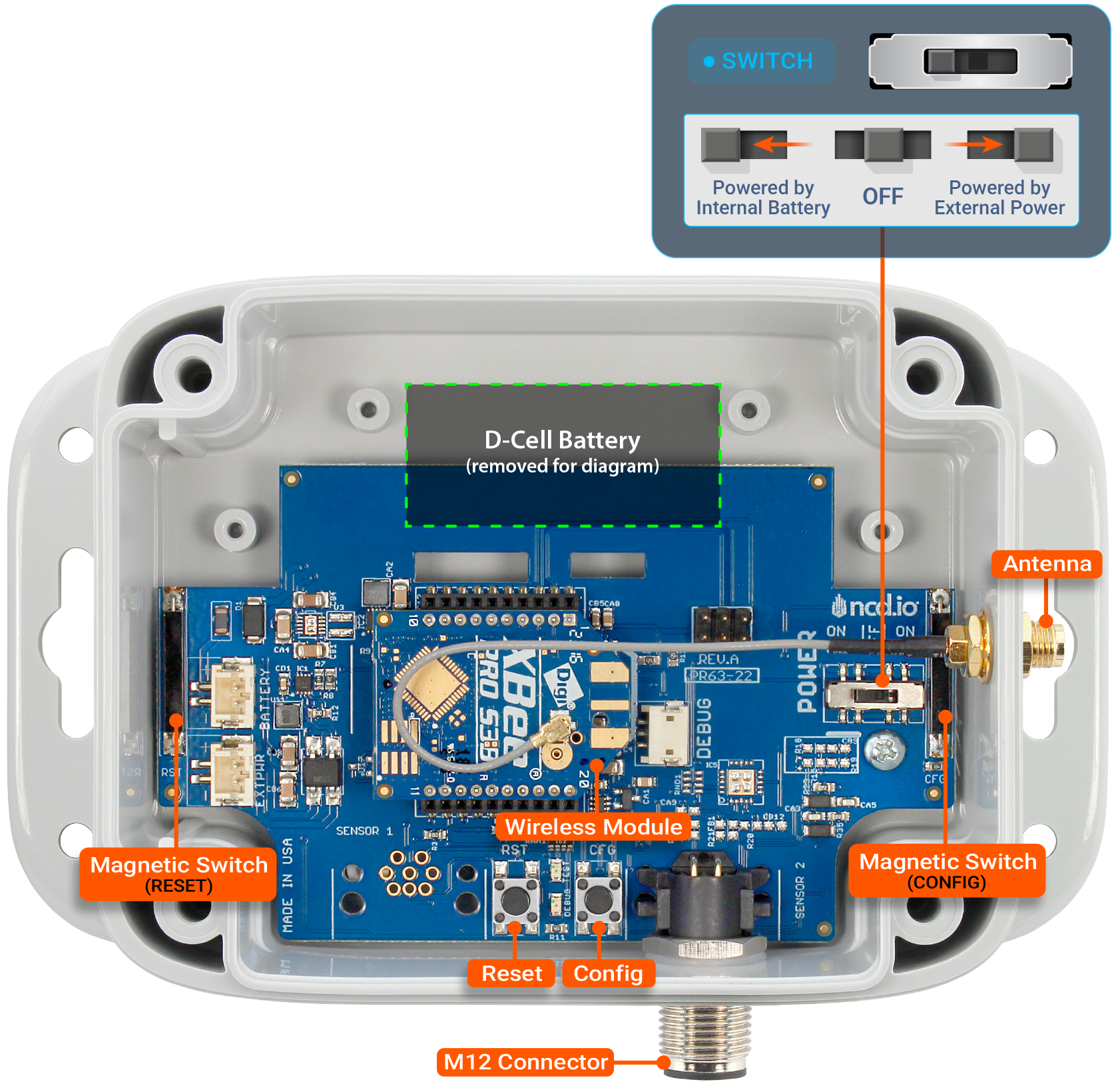

Powering On
The sensor ships with its battery already installed and the power switch in the Off position — there is no battery to insert.
  1. 1
    Open the enclosure
    Remove the screws securing the enclosure lid and lift the cover to reach the 3-position power switch (and the external-power connector, if you are powering the unit externally).
  2. 2
    Set the power switch
    The 3-position switch ships in the Off position. Set it to Battery to run on the installed battery, or to External if you are using an external supply (connect the supply to the power connector first).
  3. 3
    Confirm power
    Activate the magnetic CFG switch with a magnet, or press and hold the CFG button on the PCB — the TEST LED illuminates while active, confirming the unit is powered. If it does not light, re-check the switch position and, for external power, the supply connection.
  4. 4
    Close and seal the enclosure
    Replace the lid and tighten all screws evenly to maintain the IP65 seal.
01 sensor enclosure open
The sensor enclosure open — battery, power switch, and the probe terminal(s). The probe cable exits through the gland to the monitored area.

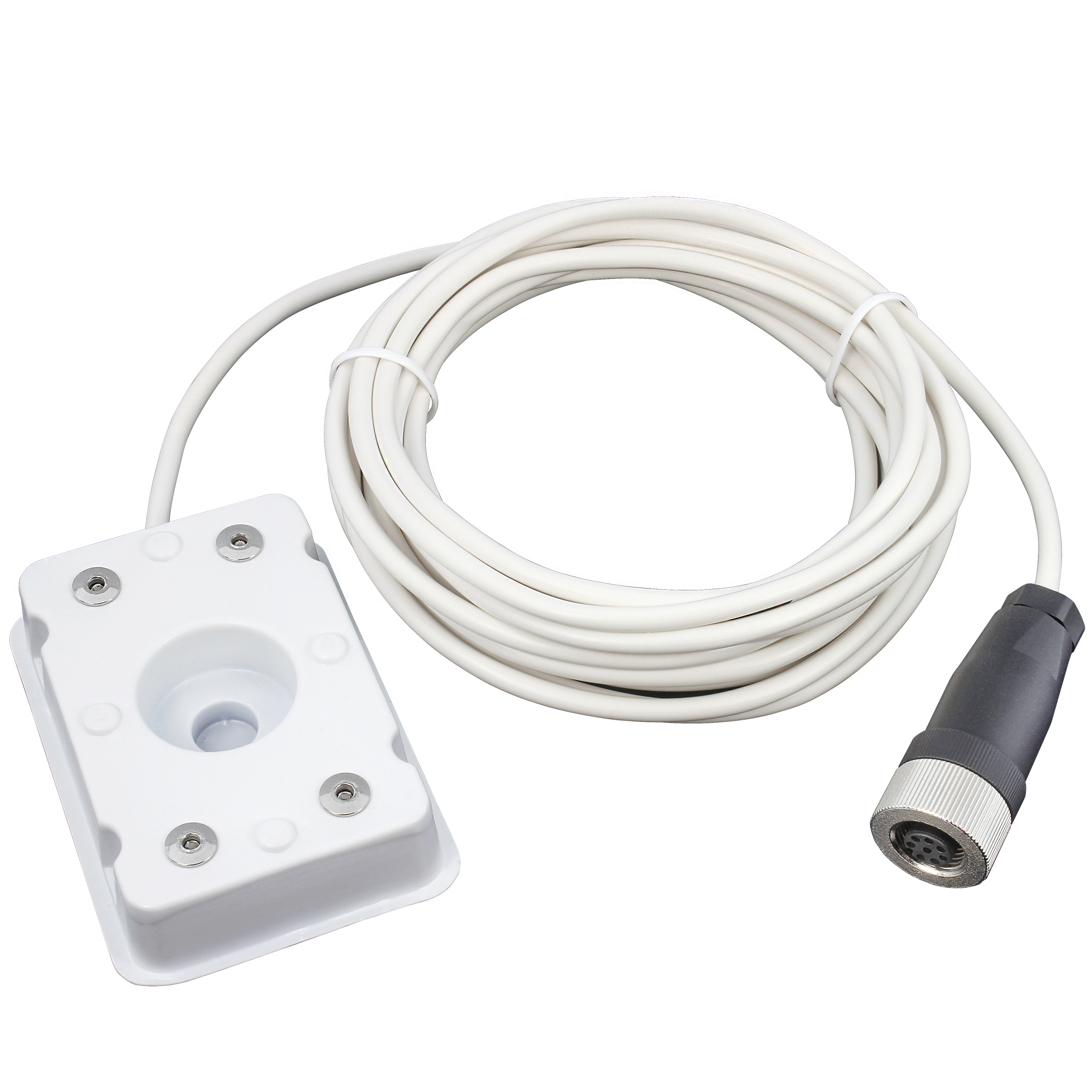

  • Puck probe — place at the low point. Lay the puck flat at the lowest point where liquid will pool first: a drip pan, floor drain, or the base of a pump, tank, or valve, with its labeled side up so all four stainless-steel contacts on the underside sit against the surface. Water bridging any two of the four contacts reads as wet.
  • Water rope probe — run the perimeter. The rope is 2 m total: a 1 m active sensing section plus a 1 m non-sensing leader wire that runs back to the sensor. Connect the sensing rope’s black wires to the leader wire, then route the sensing section along the area you want to protect — around the base of equipment, along a wall, or beside a pipe run. It detects water contacting the rope anywhere along its 1 m sensing length. Keep the rope flat on the surface so it makes contact with pooling water.

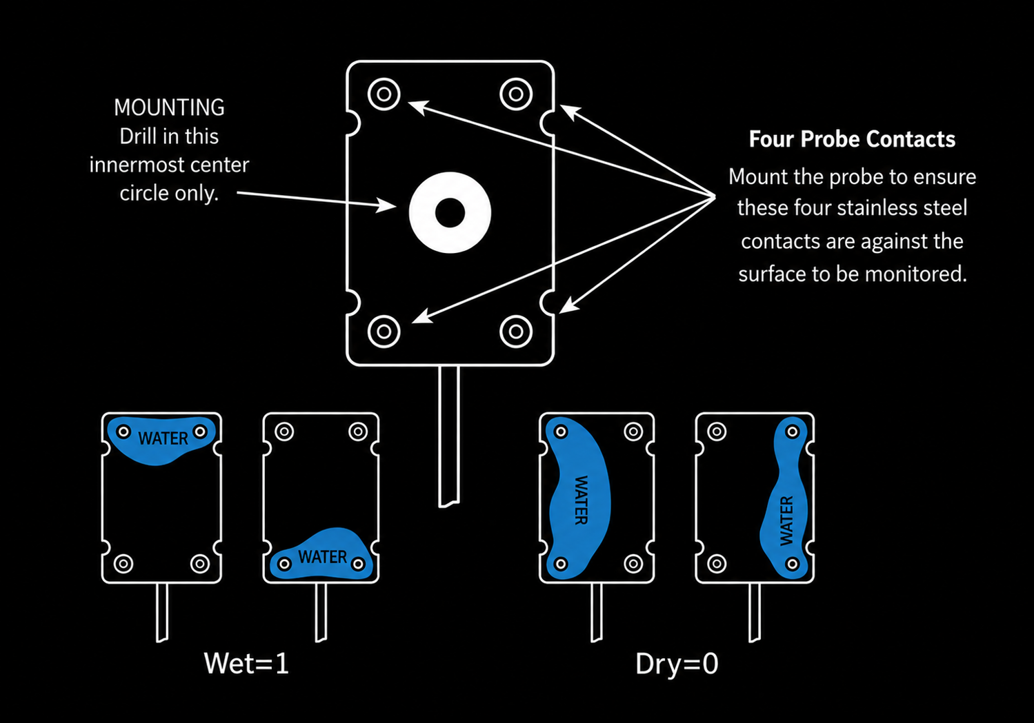

Mounting the Puck Probe
Lay the puck flat, labeled side up, so all four stainless-steel contacts sit against the surface being monitored at the lowest point where water collects. Water bridging any two of the four contacts triggers detection, so mounting it flat (not on edge) lets even a thin, spreading film of water reach the contacts.
puck mounting diagram
Puck mounting — drill only through the center hole, and mount flat so all four stainless-steel contacts sit against the surface. Water bridging any two reads wet (1); with no bridge across the contacts the channel stays dry (0).

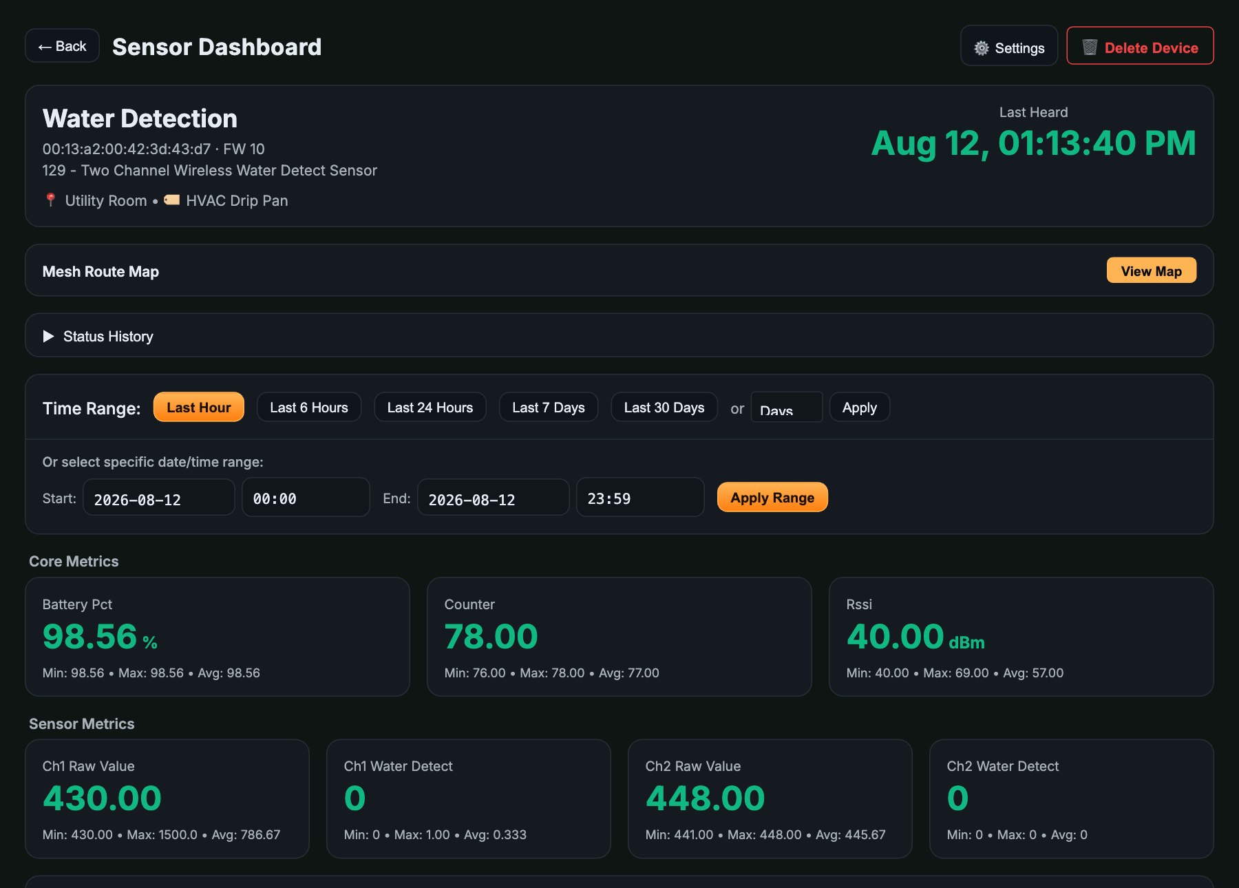

    The whitelisted sensor now appears in the Sensors table with a recent Last Heard timestamp. Open its Dashboard to confirm the live wet/dry state for each channel.

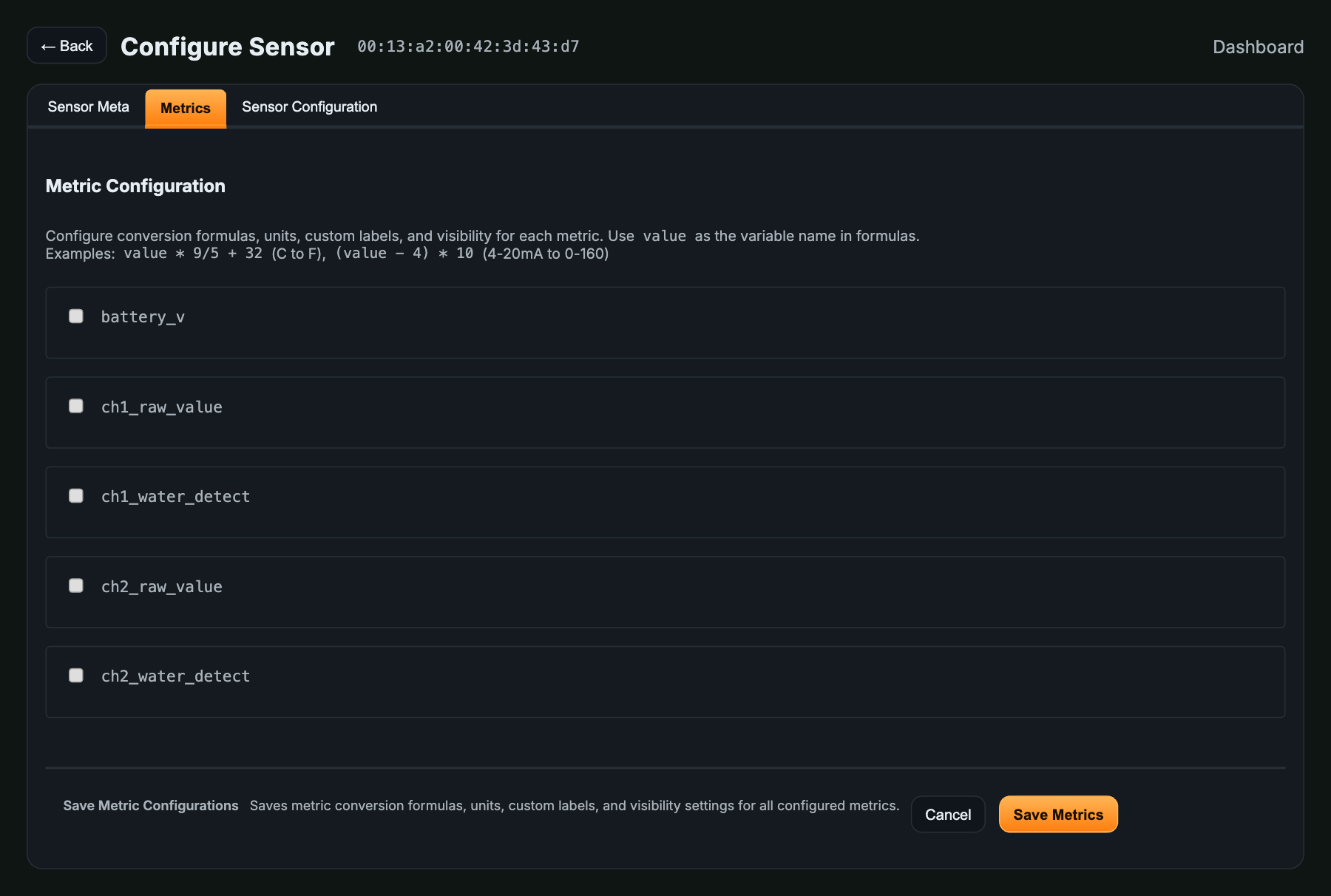

07Metric Configuration
The Metrics tab lets you configure conversion formulas, units, custom labels, and dashboard visibility for each data channel. Access it via Configure → Metrics. This sensor reports a small, discrete set of metrics — the wet/dry state of each channel plus power and packet metadata.
MetricRaw DataApplies ToOn Dashboard by Default
ch1_water_detectChannel 1 water state — 1 = water detected (wet), 0 = dryBoth modelsShown
ch1_raw_valueChannel 1 raw conductivity reading — the analog value the wet/dry state is derived from against a thresholdBoth modelsShown
ch2_water_detectChannel 2 water state — 1 = water detected (wet), 0 = dry2-Channel onlyShown
ch2_raw_valueChannel 2 raw conductivity reading (as above)2-Channel onlyShown
battery_pctEstimated remaining battery capacity (%)Both modelsShown
battery_vBattery voltage (V) — separate field from battery_pct (~3.28 V nominal)Both modelsHidden
rssiReceived signal strength (dBm), positive magnitude — higher = weaker signalBoth modelsShown
counterTransmission counter (0–255, then rolls over); useful for detecting missed packetsBoth modelsShown
msg_typeMessage type — regular for a scheduled transmission (on the configured interval) or Interrupt for an event transmission sent immediately when a channel changes state (dry→wet or wet→dry)Both modelsShown
Custom Conversion Formulas
Each metric supports a custom conversion formula using value as the variable name. Leave the formula as value or blank to display raw data. The water inputs are discrete states, so most deployments leave them unconverted; a formula is only useful if you want to rescale the 1/0 for a particular gauge style. Examples:
Formula examples
value                  // Pass the raw 1/0 water state through unchanged
value * 100            // Scale 0/1 to 0/100 for a percentage-style gauge
Custom Labels & Visibility
Each metric can be assigned a Custom Label that replaces the default metric name throughout Atrium. Unchecking Visible on Dashboard hides that metric’s card and chart without deleting data — useful for hiding the channel-2 metrics on a 2-channel unit when you are only using one probe, or hiding the raw-value channels to keep the dashboard to just the wet/dry states.
04 metrics config
Metric Configuration — each metric exposes a conversion formula, unit, custom label, and a dashboard-visibility toggle (one metric shown).

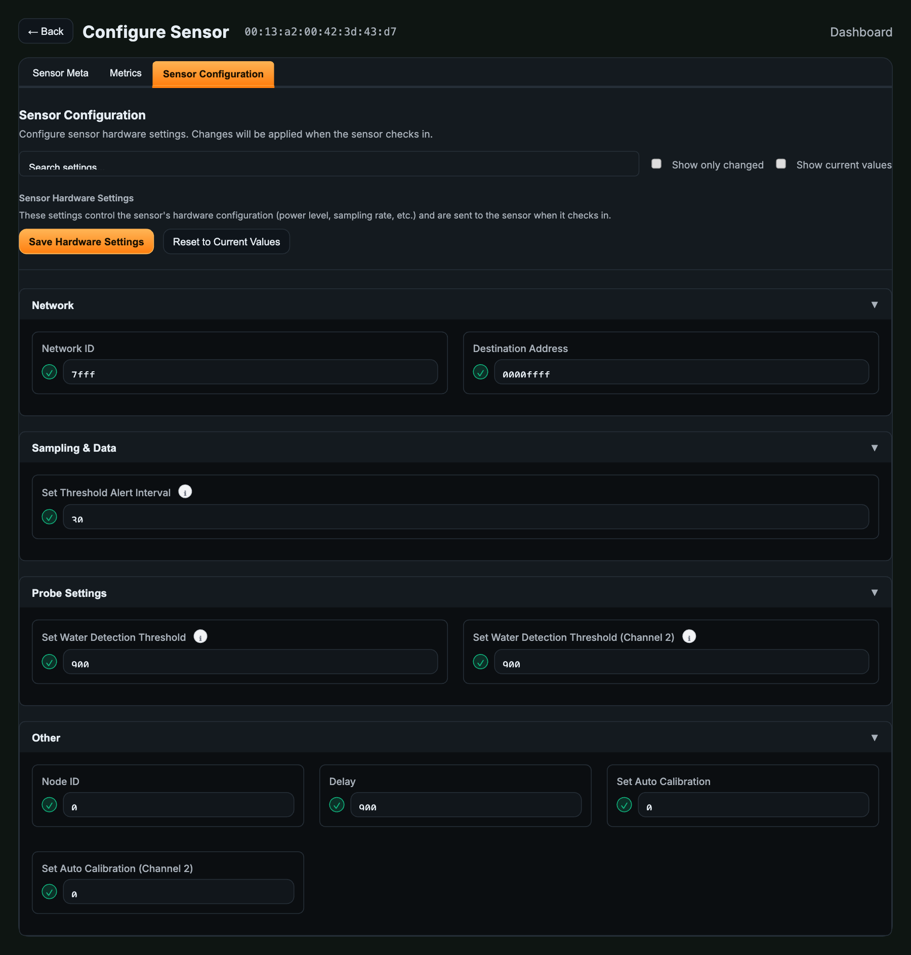

08Hardware Settings
Hardware settings control the sensor’s on-board configuration — scheduled transmission interval, network addressing, and node identity. Changes are staged in Atrium and pushed to the sensor on its next check-in. Access via Configure → Sensor Configuration.
SettingGroupDefaultDescription
Network IDNetwork7fffThe wireless network ID. Must match the gateway’s network ID for the sensor to communicate.
Destination AddressNetwork0000ffffThe broadcast address the sensor transmits to. Typically left at default unless using a custom mesh topology.
Set Threshold Alert IntervalSampling & Data30How often the sensor evaluates and reports on the water-detection threshold between scheduled transmissions.
Set Water Detection ThresholdProbe Settings900Channel 1 sensitivity: the raw conductivity level the reading must cross for the channel to report wet (ch1_water_detect = 1). Raise it to require more water/conductivity before triggering; lower it for higher sensitivity.
Set Water Detection Threshold (Channel 2)Probe Settings900Channel 2 detection threshold (2-channel model), as above for ch2_water_detect.
Node IDOther0Optional human-readable node identifier within the mesh network.
DelayOther900 sec (15 min)Scheduled transmission interval in seconds. The sensor also transmits immediately on any wet/dry change, independent of this value. Lower values report status more often at the cost of battery life.
Set Auto CalibrationOther0Channel 1 auto-calibration of the dry baseline. Leave at default unless the probe environment needs re-baselining.
Set Auto Calibration (Channel 2)Other0Channel 2 auto-calibration (2-channel model).
Adjusting the Transmission Interval
  1. 1
    Go to Sensor Configuration
    Navigate to Sensors → [your sensor] → Configure → Sensor Configuration.
  2. 2
    Update the Delay value
    Enter your desired scheduled-report interval in seconds. Because a leak is reported immediately regardless of this setting, a longer Delay is usually fine for water monitoring and greatly extends battery life.
  3. 3
    Click Save Hardware Settings
    The new value is staged and pushed to the sensor on its next check-in (shown as Pending until confirmed).
  4. 4
    Update the Report Interval in Sensor Meta
    Update the Report Interval on the Sensor Meta tab to match your new Delay so offline detection stays accurate.

05 hardware settings
Sensor Configuration tab showing network and timing settings.

10Sensor Dashboard
The Sensor Dashboard provides a real-time and historical view of all data from this sensor. Access it by clicking the sensor in the Sensors list and selecting Dashboard.
Live Metrics
MetricUnitDescription
Ch1 Water Detect (ch1_water_detect)1 / 0Channel 1 water state — 1 = water detected (wet), 0 = dry
Ch1 Raw Value (ch1_raw_value)—Channel 1 raw conductivity reading behind the wet/dry decision
Ch2 Water Detect (ch2_water_detect)1 / 0Channel 2 water state (2-channel model) — 1 = water detected (wet), 0 = dry
Ch2 Raw Value (ch2_raw_value)—Channel 2 raw conductivity reading (2-channel model)
Battery Pct%Estimated remaining battery capacity
RSSIdBmSignal strength as a positive magnitude — higher values mean a weaker signal
Counter—Packet counter that increments with each transmission; useful for detecting missed packets
Message Type (msg_type)—regular = scheduled interval transmission; Interrupt = event-driven, sent immediately on a wet/dry state change
Time Range & Charts
Use the time range selector to view historical data for the last hour, 6 hours, 24 hours, 7 days, or 30 days. A custom date/time range is also available. Each channel’s Water Detect metric plots as a step chart — flat at 0 (dry) with a step up to 1 for the duration of each detected event — making it easy to see exactly when water was present and when it cleared. The Raw Value chart shows the underlying conductivity reading. Drag to zoom into a time window, double-click to reset.

  • Confirm the sensor is powered — activate the magnetic CFG switch with a magnet (or press and hold the CFG button) and check that the TEST LED illuminates.
  • Verify the sensor’s wireless frequency (900/868 MHz or 2.4 GHz) matches the gateway’s radio.
  • Verify the sensor’s Network ID matches the gateway’s Network ID.
  • Move the sensor closer to the gateway to rule out range issues — test within 10 feet first.
  • Trigger a transmission by briefly bridging a probe’s contacts (or wetting the rope) so the sensor reports right away instead of waiting for the next scheduled interval.

  • Stuck reading wet: check for residual water, condensation, or conductive residue bridging the probe contacts. Dry and clean the probe; mineral scale or an oil film can hold a false wet reading or, conversely, insulate the contacts.
  • Never reads wet during a known leak: confirm the probe is flat on the surface at the true low point (puck) or that the rope actually contacts the pooling water along its run. Verify the probe is connected to the expected channel terminal.
  • Wrong channel: on a 2-channel unit, confirm which probe is on channel 1 (ch1_water_detect) vs channel 2 (ch2_water_detect) and that the Custom Labels match the physical placement.

  • To apply changes immediately, wake the sensor with the magnetic RESET switch (or the PCB RESET button), or by triggering a wet/dry change on a probe.
  • Confirm the sensor is actively transmitting by checking the Last Heard timestamp on the dashboard.

Option A — Magnetic Switches (no disassembly)
  1. 1
    Trigger the RESET switch
    Hold a magnet near the magnetic RESET switch, then move it away.
  2. 2
    Wait ~1 second
    Allow approximately 1 second before proceeding.
  3. 3
    Hold the CFG switch for ~15–20 seconds
    Hold the magnet near the magnetic CFG switch for at least ~15 seconds (a shorter hold does not fully reset), then move it away. This restores factory defaults.
  4. 4
    Wait 3–5 seconds
    Allow 3–5 seconds for the reset to complete.
  5. 5
    Trigger RESET again
    Hold the magnet near the RESET switch once more, then move it away. This returns the sensor to normal Run Mode. Re-pair it in Atrium (Section 5) and confirm the Network ID matches your gateway.
Option B — Physical Buttons (open enclosure)
  1. 1
    Open the enclosure
    Remove the lid screws and lift the cover to expose the PCB RESET and CFG buttons.
  2. 2
    Press and release RESET
    Press and release the RESET button on the PCB.
  3. 3
    Hold CFG for ~15 seconds
    Within about 1 second of the reset, press and hold the CFG button for approximately 15 seconds, then release. This restores factory defaults.
  4. 4
    Wait 3–5 seconds
  5. 5
    Press RESET, close, and re-pair
    Press and release RESET once more to return to normal operation, re-seal the enclosure, then re-pair the sensor in Atrium (Section 5). Confirm the Network ID matches your gateway.
