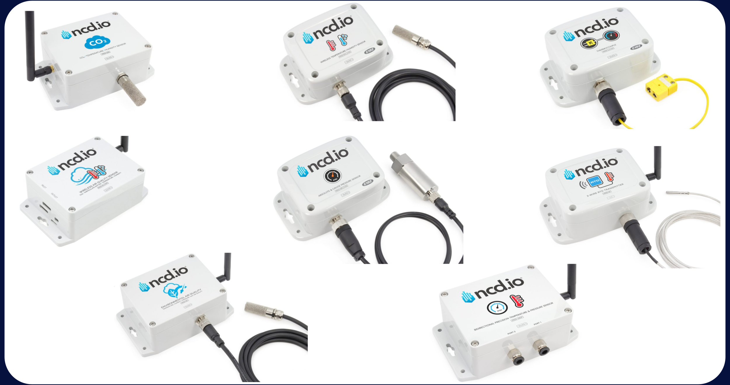

- Environmental: Temperature, Humidity, Air Quality, CO2, and Air Velocity.

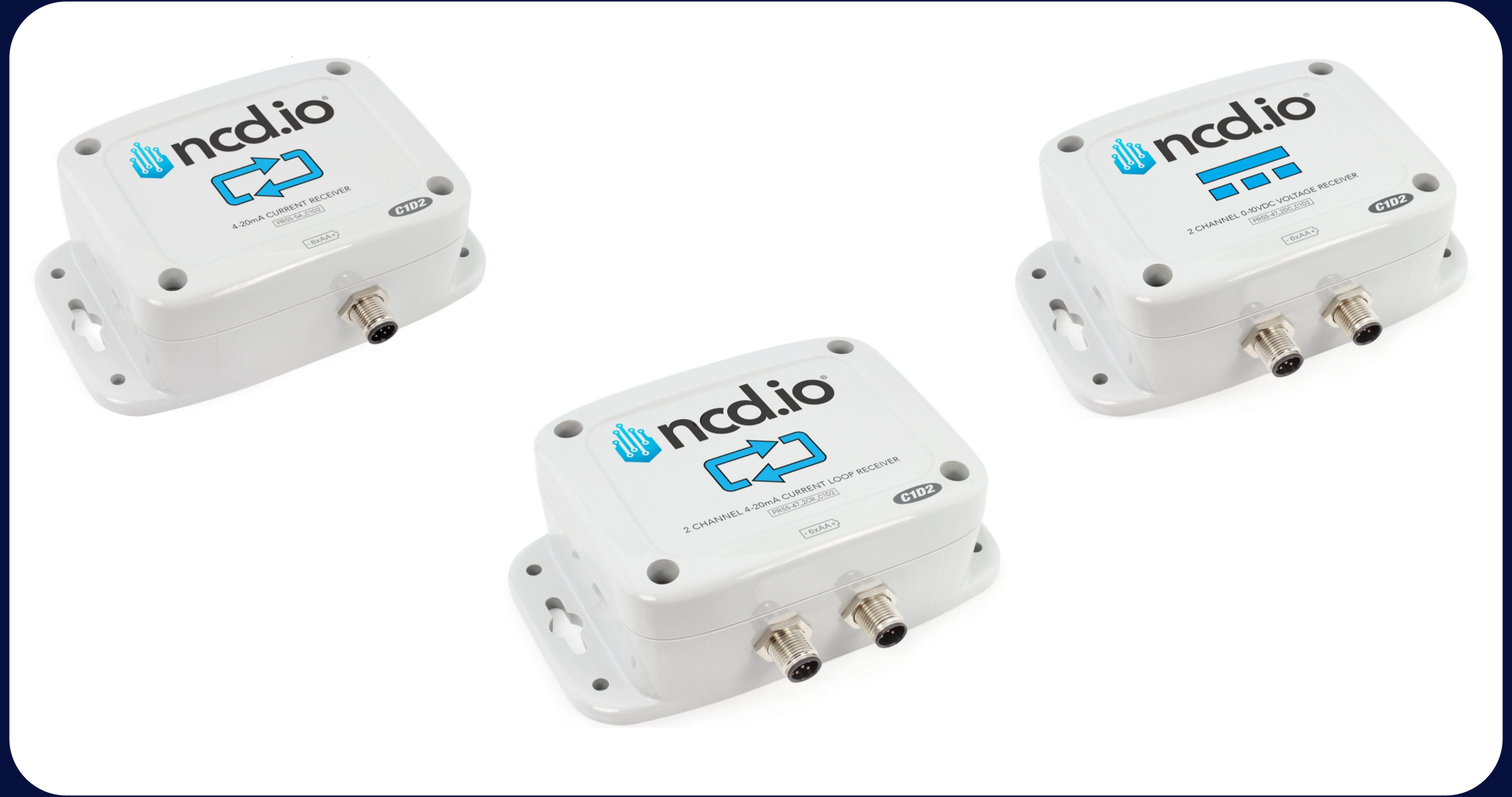

- Industrial Communication: 4-20mA/0-10V Receivers – RS485 Modbus Transmitters.

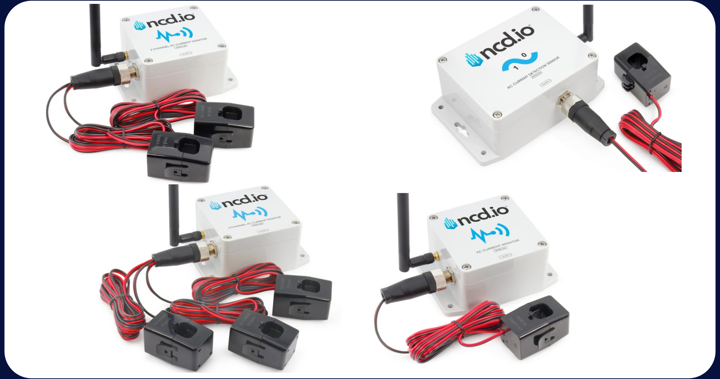

- Predictive: AC Current Monitor, Vibration, Temperature.

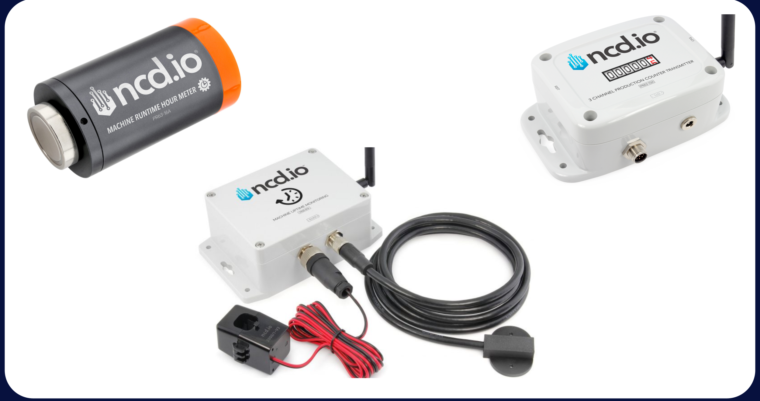

- Operational: Production and machine runtime (OEE focused) transmitters.
- Specialized: Pressure, pH and custom-built solutions tailored to your specific needs.

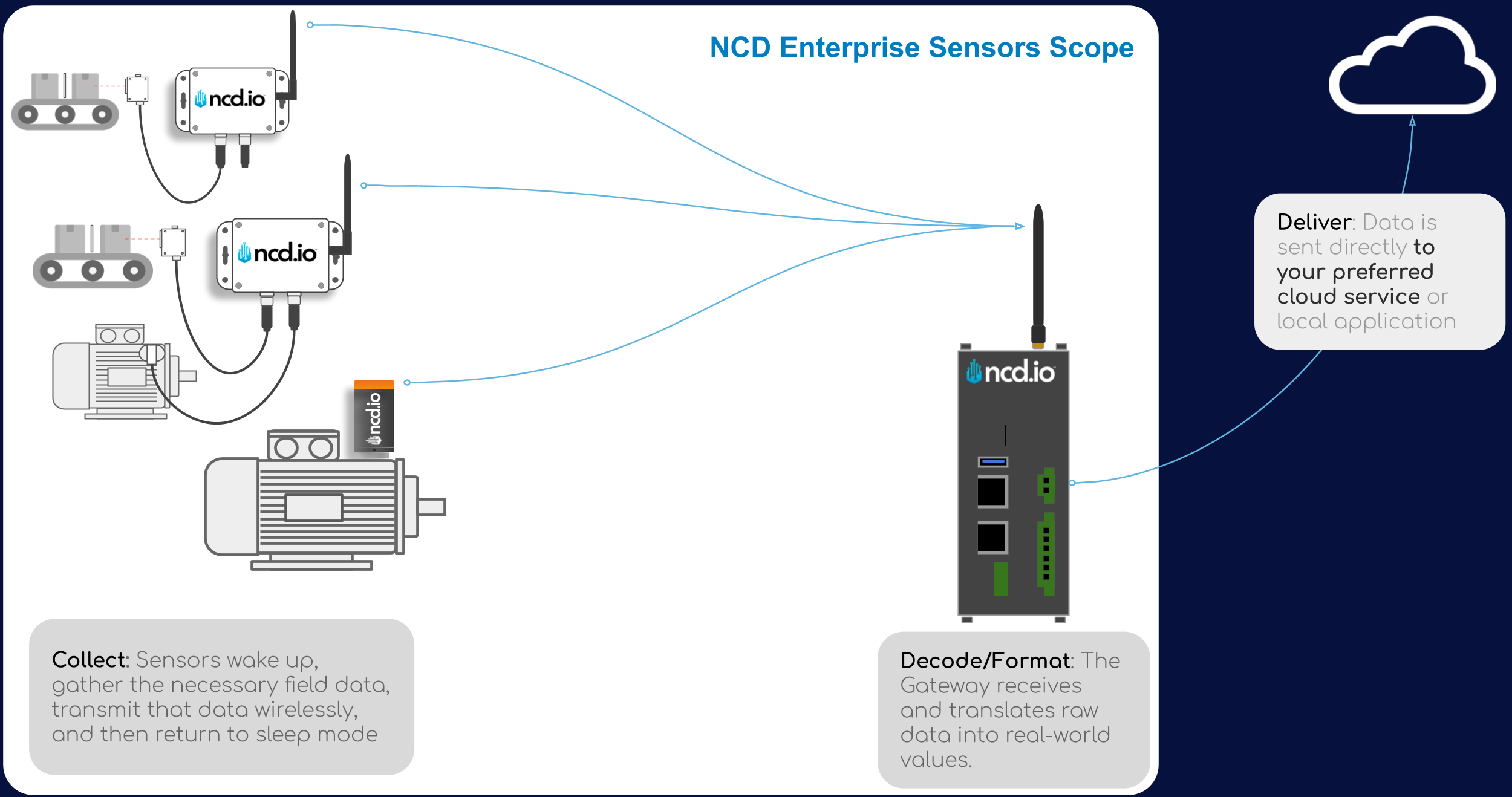

Enterprise sensors are engineered for maximum power efficiency utilizing a sophisticated “Sleep-Wake” cycle. The majority of our sensors operate according to the following behavior:
- Wake Up: The sensor wakes up at your user-defined interval.
- Process: It reads and processes field variables (like temperature, AC current or vibration).
- Transmit: It wirelessly sends that data to the gateway.
- Sleep: The sensor enters a low-power sleep mode to preserve battery life until the next scheduled interval.
- This loop repeats indefinitely, ensuring long-term autonomous operation.

The Basic NCD Architecture:
The Enterprise IIoT Gateway is a powerful Edge Computer that serves as the “brain” of your sensor network. You need it because sensors communicate in raw data bytes that require translation before they can be used.
Key Functions:
- Translation: It receives raw wireless signals and converts them into JSON (human-readable) format using the pre-installed NCD Library and Node-RED.
- Engineering Units: It translates raw bytes into meaningful values like Celsius, PSI, or G-force.
- Data Routing: Once translated, the gateway can send your data to almost any platform, including AWS, Azure, Google Cloud, Ubidots, Losant, MQTT, or local SCADA systems via protocols like OPC-UA and REST API.
- Network Management: It allows you to perform remote sensor configurations and firmware updates without needing to physically access each device.

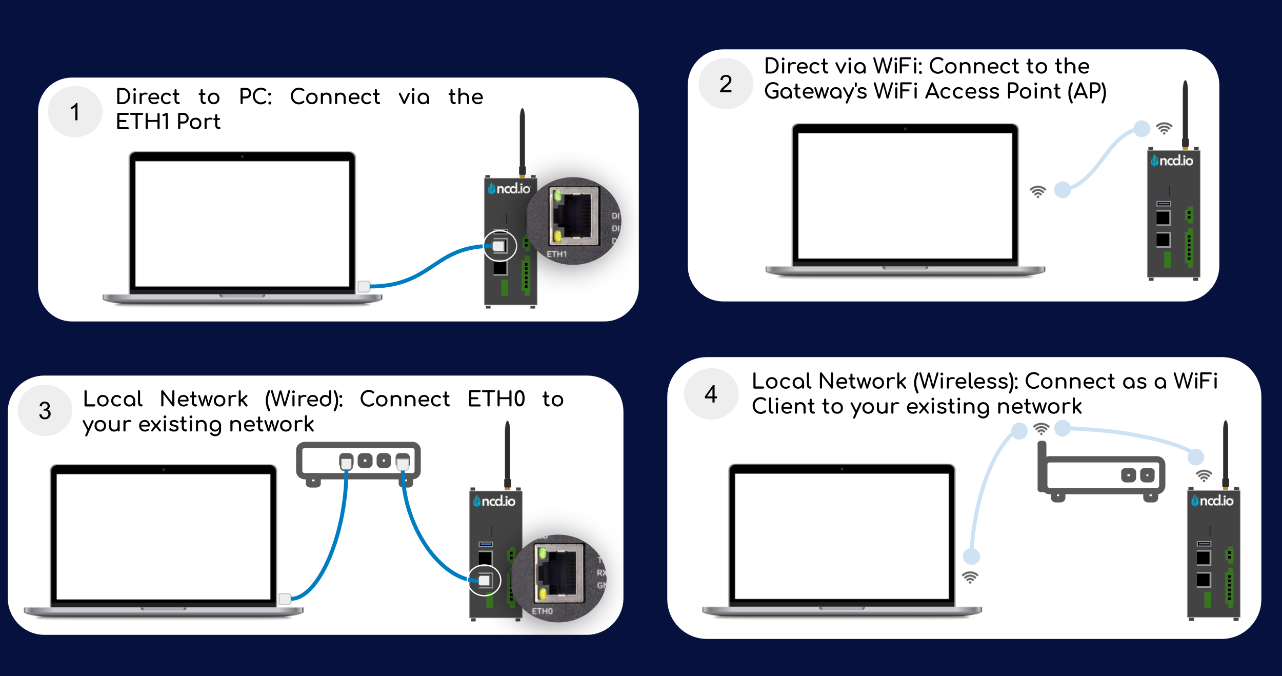

The Enterprise IIoT Gateway is designed for flexible connectivity. You can access the configuration interface and connect the device to your network using the following methods:
- Initial Setup via Wi-Fi (Access Point Mode): By default, the gateway creates its own Wi-Fi hotspot. You can connect any Wi-Fi-enabled PC or tablet directly to this network to access the internal settings and Node-RED interface without needing an existing network.
- Ethernet Connectivity (Dual Ports):
- ETH0 Port: Connect this to your existing local network. It is configured for DHCP by default, allowing the gateway to receive an IP address automatically from your router or switch.
- ETH1 Port: This port is configured to act as a Network Router. You can plug a PC directly into this port with an Ethernet cable to gain immediate access to the gateway’s configuration page, similar to how you would manage a home router.
- Cellular Connectivity: Most of our standard Enterprise Gateways come equipped with built-in cellular modems. This allows the gateway to transmit data to the cloud independently, which is ideal for environments where corporate IT policies restrict Wi-Fi or Ethernet usage.
