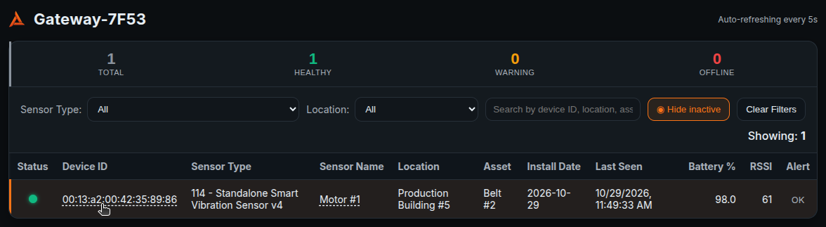

Step 1: Select the Target Device

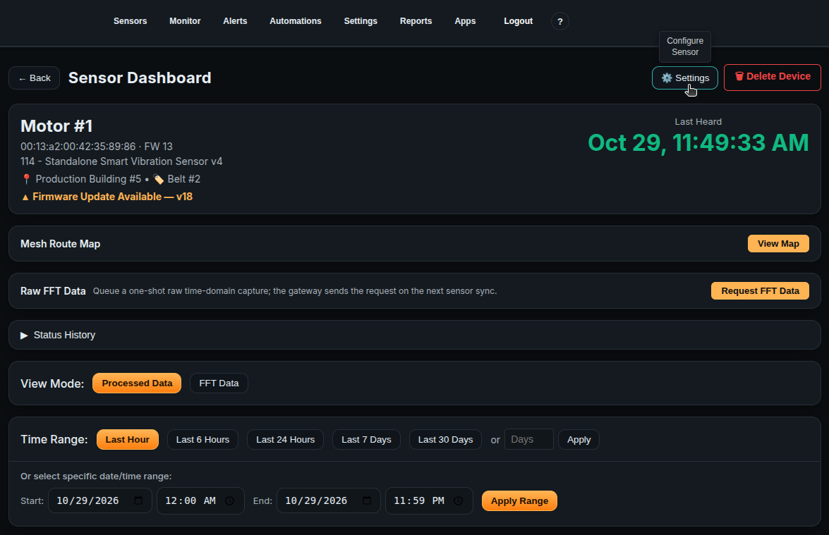

Log in to your Atrium Interface and click on the specific Device ID you wish to configure.

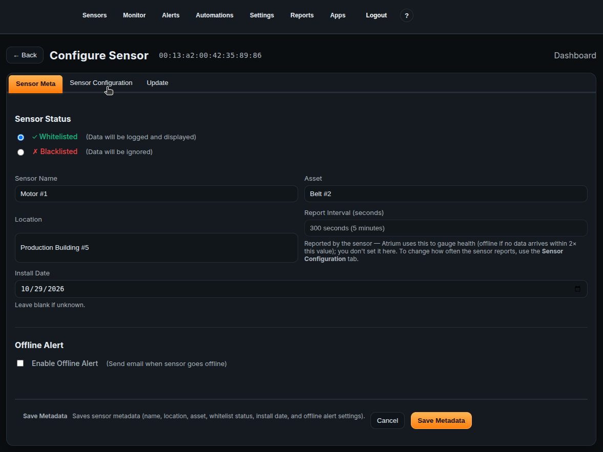

Step 2: Open the Sensor Settings
From the Sensor Dashboard window, click the Settings button located in the top right corner.
Step 3: Access the Configuration Tab

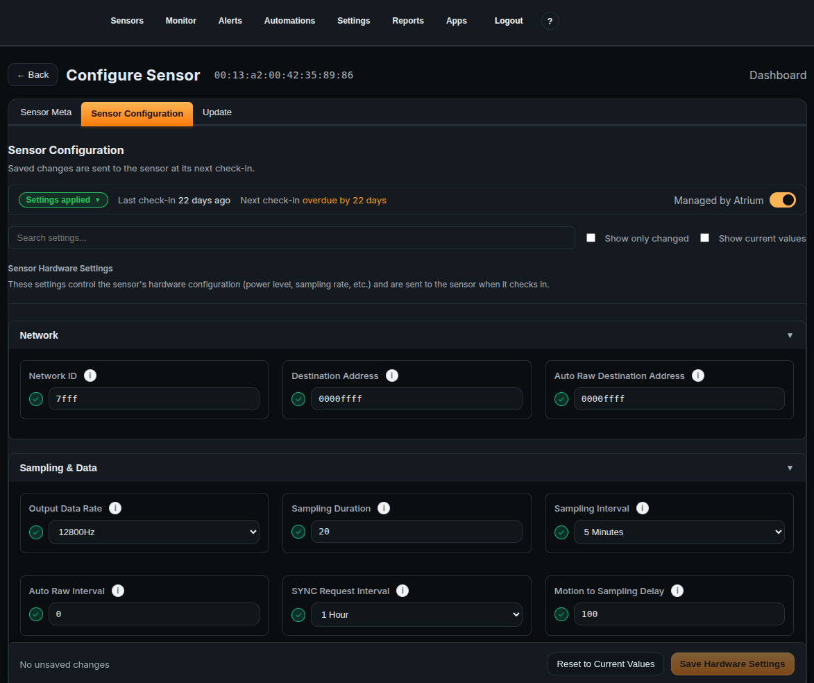

Navigate to the Sensor Configuration tab.
Step 4: Review the Configuration Interface
This window provides a consolidated view where you can:
  • View all available settings for your specific NCD sensor, including detailed descriptions.
  • Check the current settings active on the sensor (captured during its last sync message).
  • Use the provided inputs (text fields, dropdowns) to modify any desired parameters.

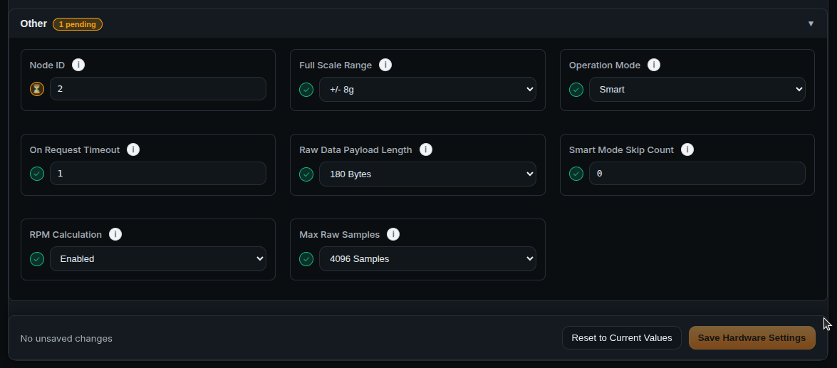

Step 5: Modify Your Desired Settings

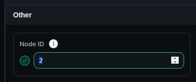

Example: Changing the Node ID. Scroll down to the ‘Other’ section and locate the Node ID setting. This is a user-defined identifier. The factory default is 0. Change this value to 2 (valid range is 0-255).

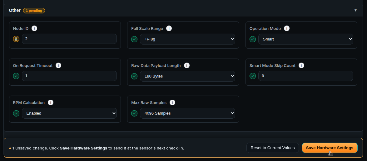

Note: You can modify multiple settings during a single configuration session. Once all desired changes are staged, click the Save Hardware Settings button in the bottom right corner.
Step 6: Queue Settings on the Gateway
At this stage, the new settings are saved to the Atrium Gateway and marked as pending. They have not been applied to the physical sensor yet. The Gateway is now holding the payload, waiting for the sensor to check in.

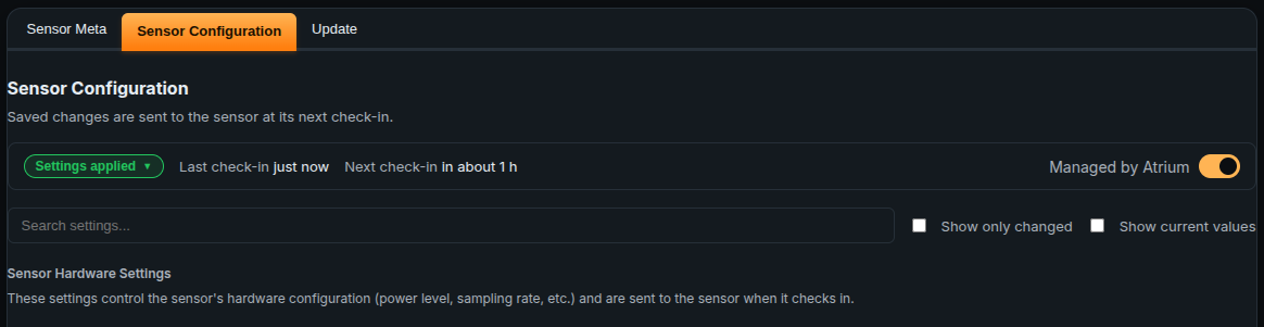

The Atrium Gateway will push the settings the next time the sensor enters Configuration Mode.
  • Automatic (Hourly): Check the “Next check-in” timer in the UI for an estimate of when the sensor will auto-sync.
  • Manual (Immediate): To apply settings immediately, physically reset the sensor to force it into Configuration Mode.
During the transfer, the Atrium interface will display an “Applying settings” status. Once the configuration is successful, the status will update to “Settings applied”, and the pending hourglass icon will change to a green check mark.
