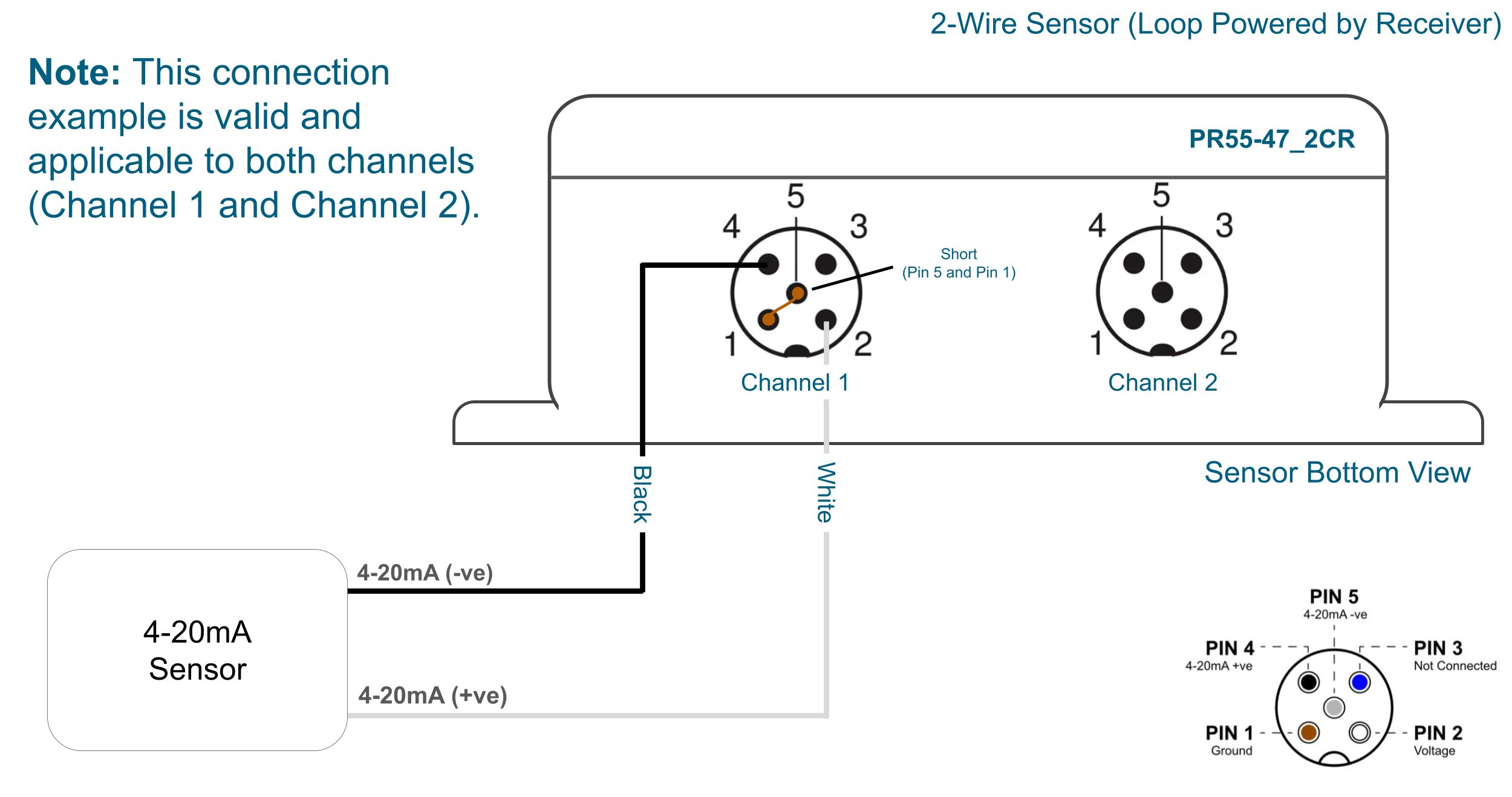

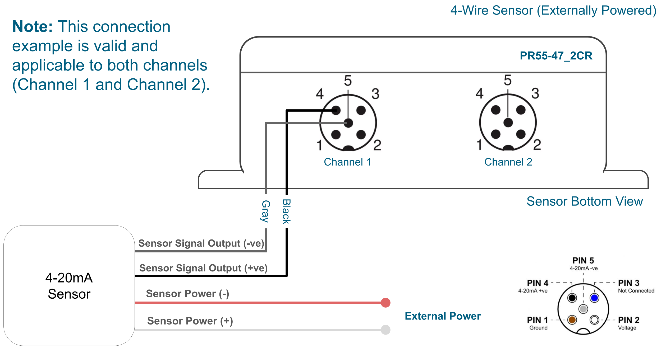

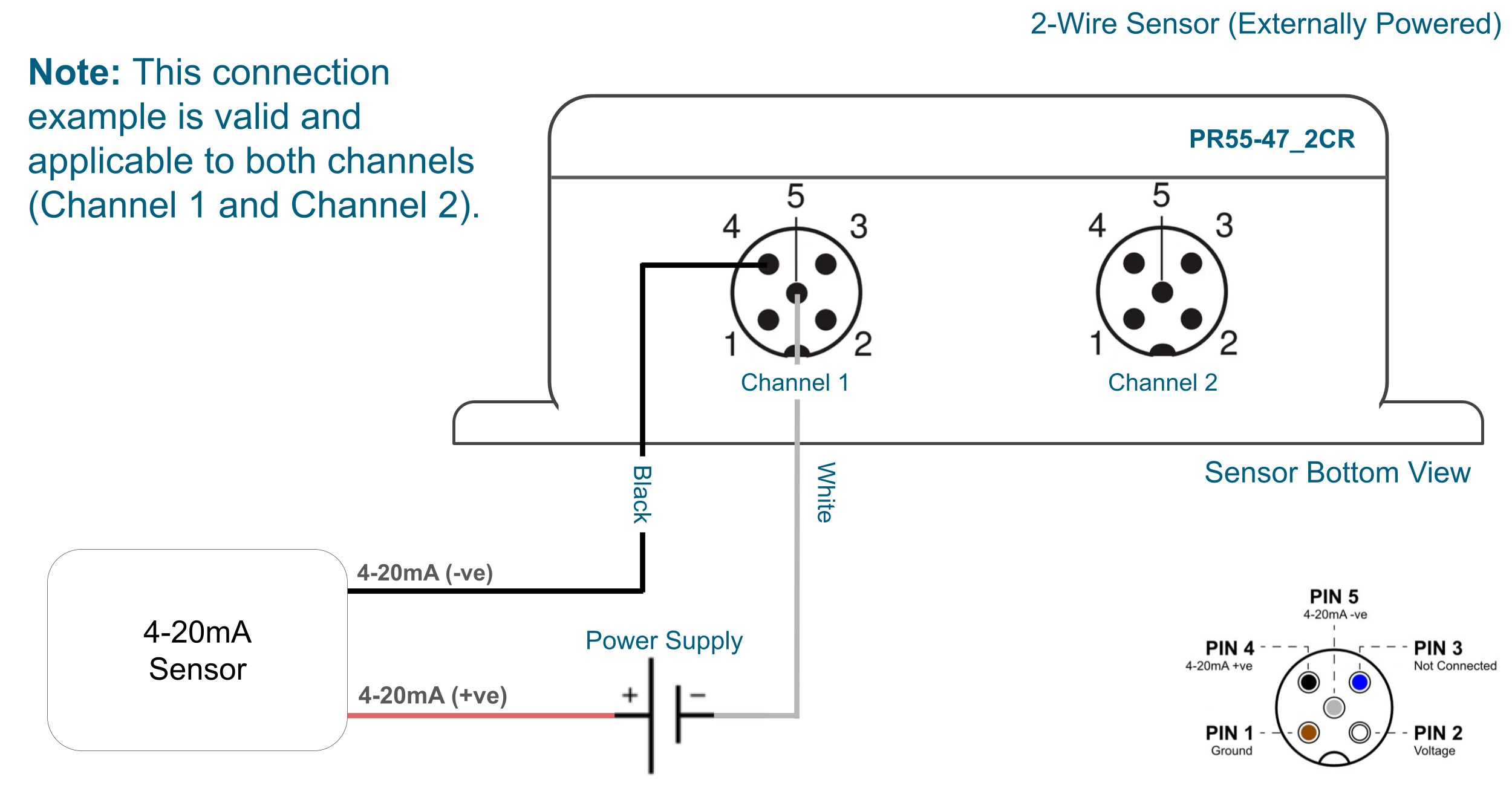

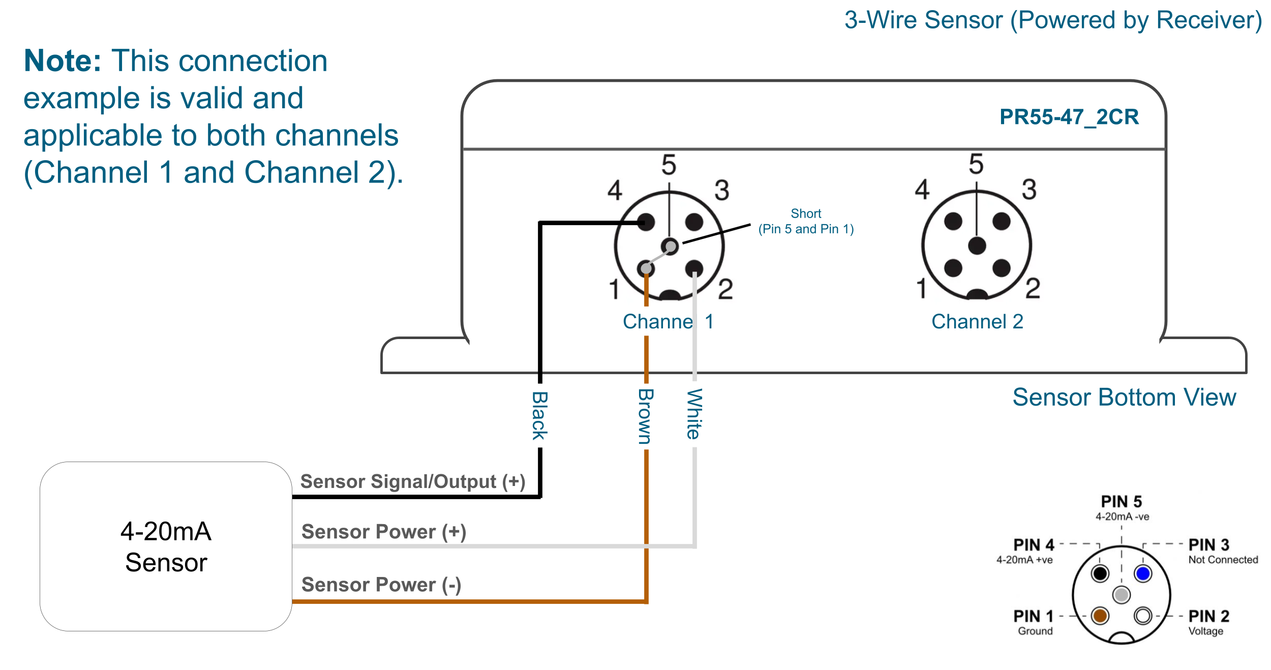

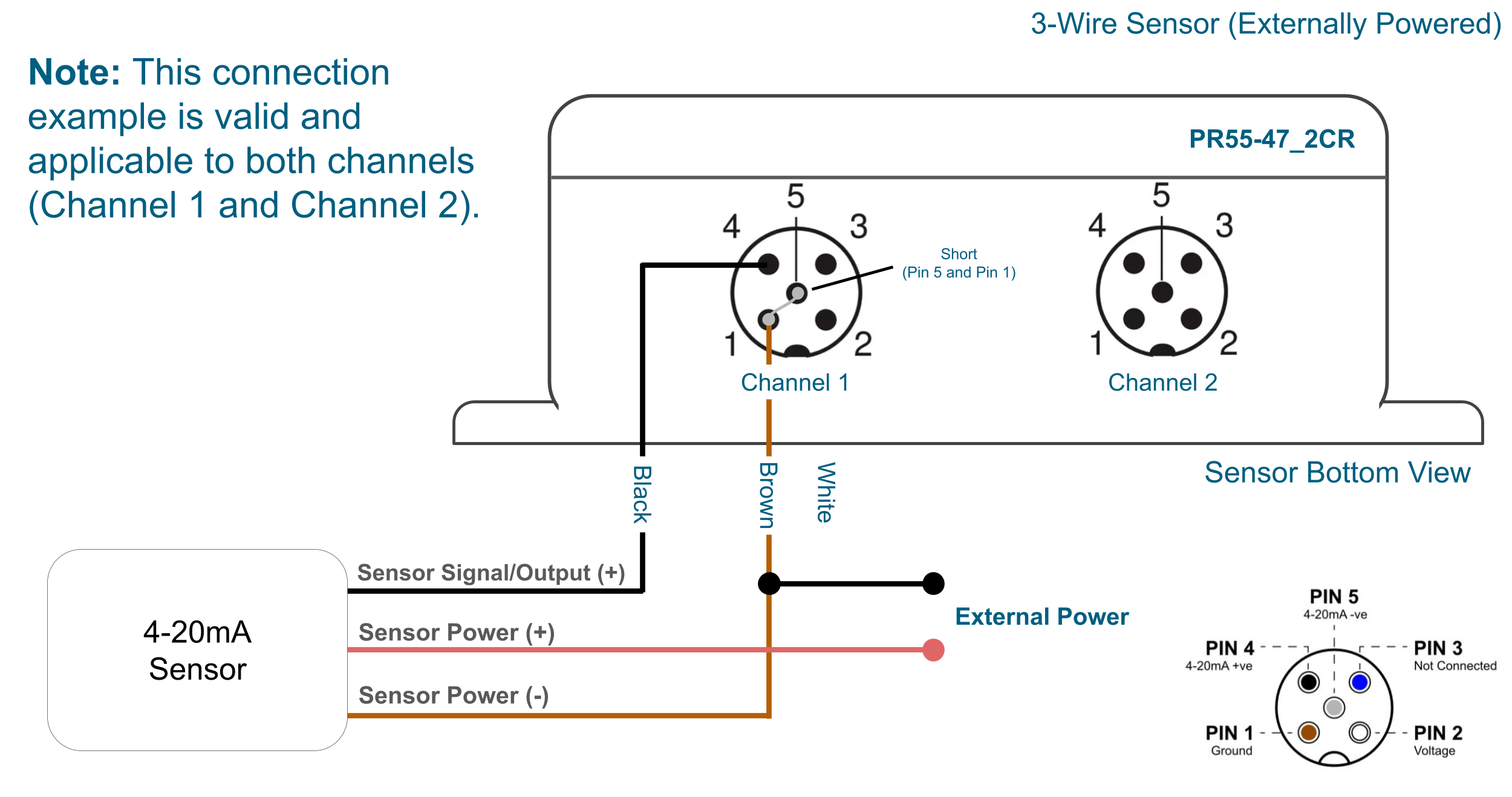

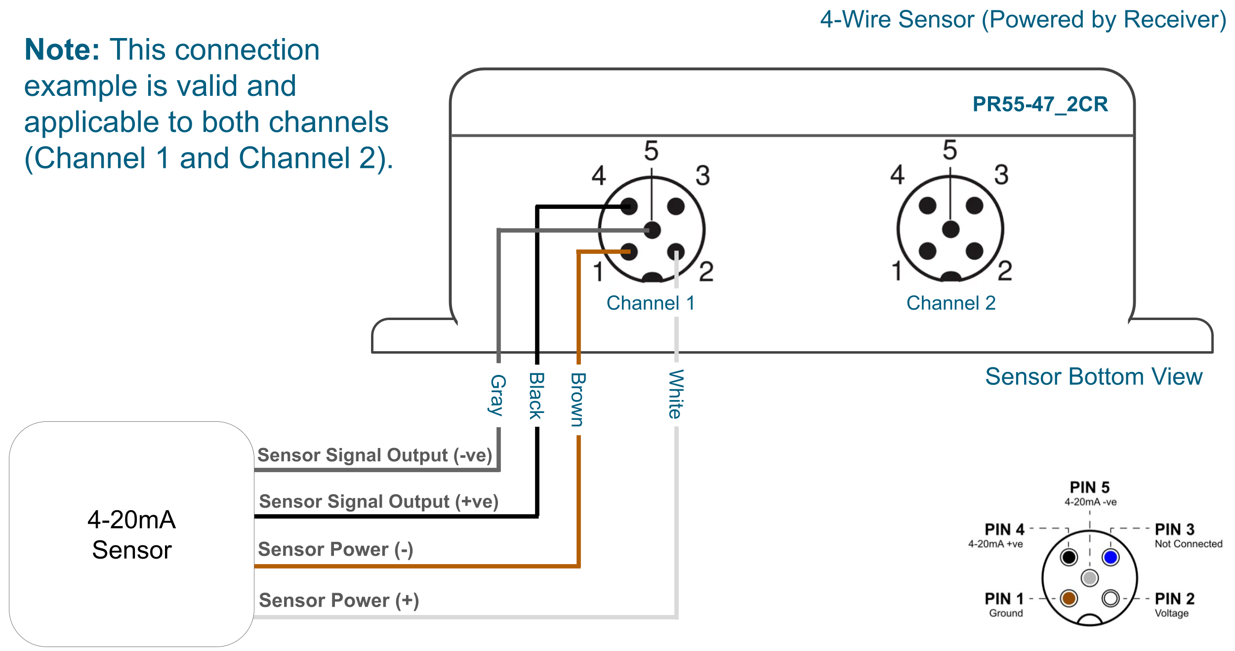

Probes Specifications
Pinout Info
Diagram Examples
