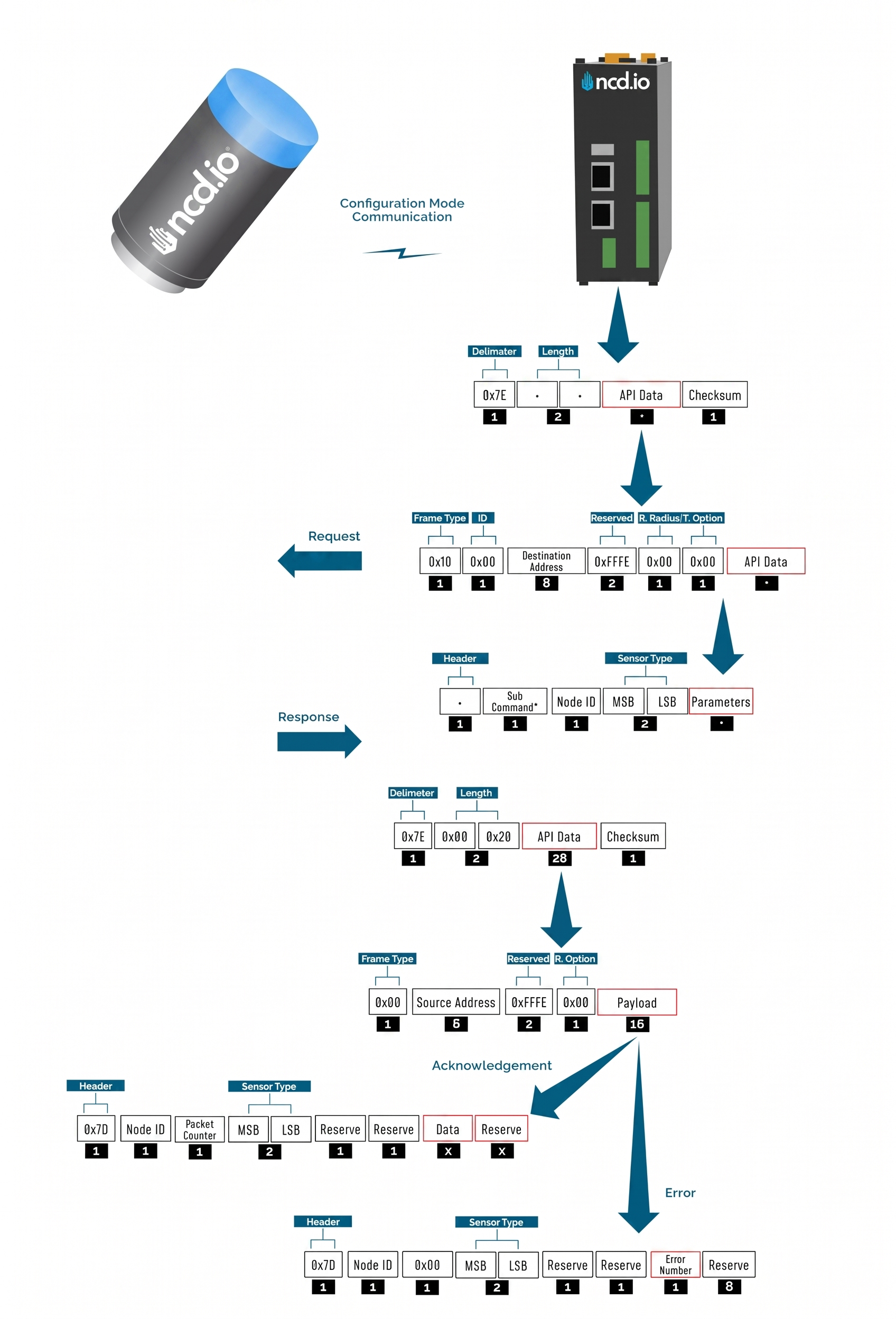

Frame Structure
| 8 | 0x55 | |||
| 9 | 0x4E | |||
| 8 | 0x47 | |||
| 9 | 0x4D | |||
| 8 | 0x55 | |||
| 9 | 0x4D |

Configuration Mode Frame
| 7E 00 44 90 00 13 A2 00 42 35 89 86 FF FE C2 4F 00 00 17 0B 00 72 00 00 00 01 63 3D 00 7F FF 00 00 FF FF 01 0E 14 00 09 02 07 00 01 00 00 01 14 0A 0A 05 0C 00 03 00 00 00 FF FF 03 00 3C 01 00 00 64 01 00 00 00 00 5F | Example frame | |

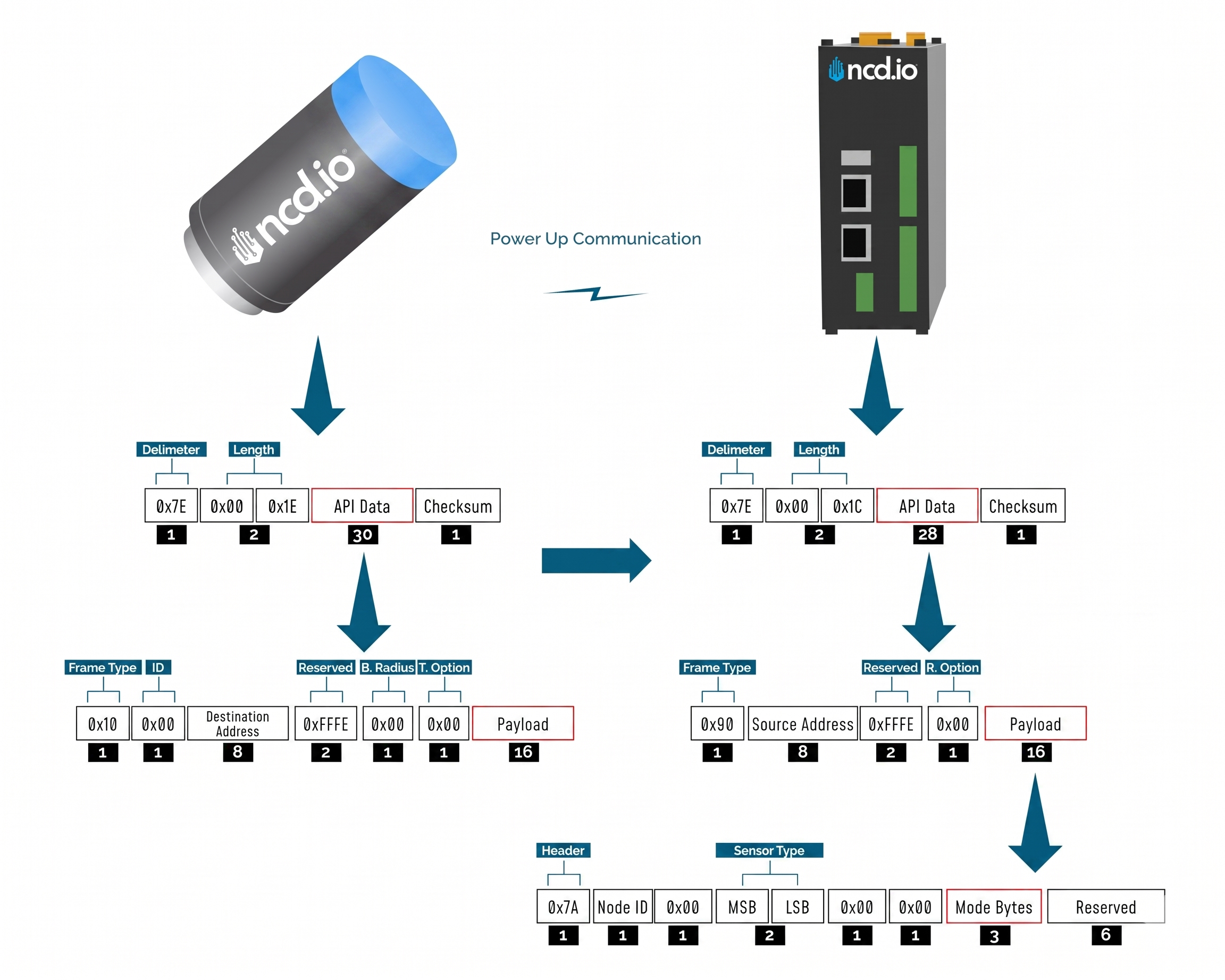

Factory Reset Mode Frame
| 7E 00 1C 90 00 13 A2 00 42 53 64 53 FF FE C2 7A 00 00 00 72 00 00 50 55 4D 00 00 00 00 00 00 D1 | Example frame | |
| 0x7E | 1 | Delimiter |
| 0x001C | 2 | Length |
| 0x90 | 1 | Frame Type |
| 0xFFFE | 2 | Reserved |
| 0xC2 | 1 | R. Option |
| 0x7A | 1 | Header |
| 0x00 | 1 | Node ID |
| 0x00 | 1 | Separator |
| 0x007F | 2 | Sensor Type |
| 0x0000 | 2 | Separator |
| 0x50554D | 3 | Mode Byte for Factory Reset Mode |
| 0xD1 | 1 | Checksum |

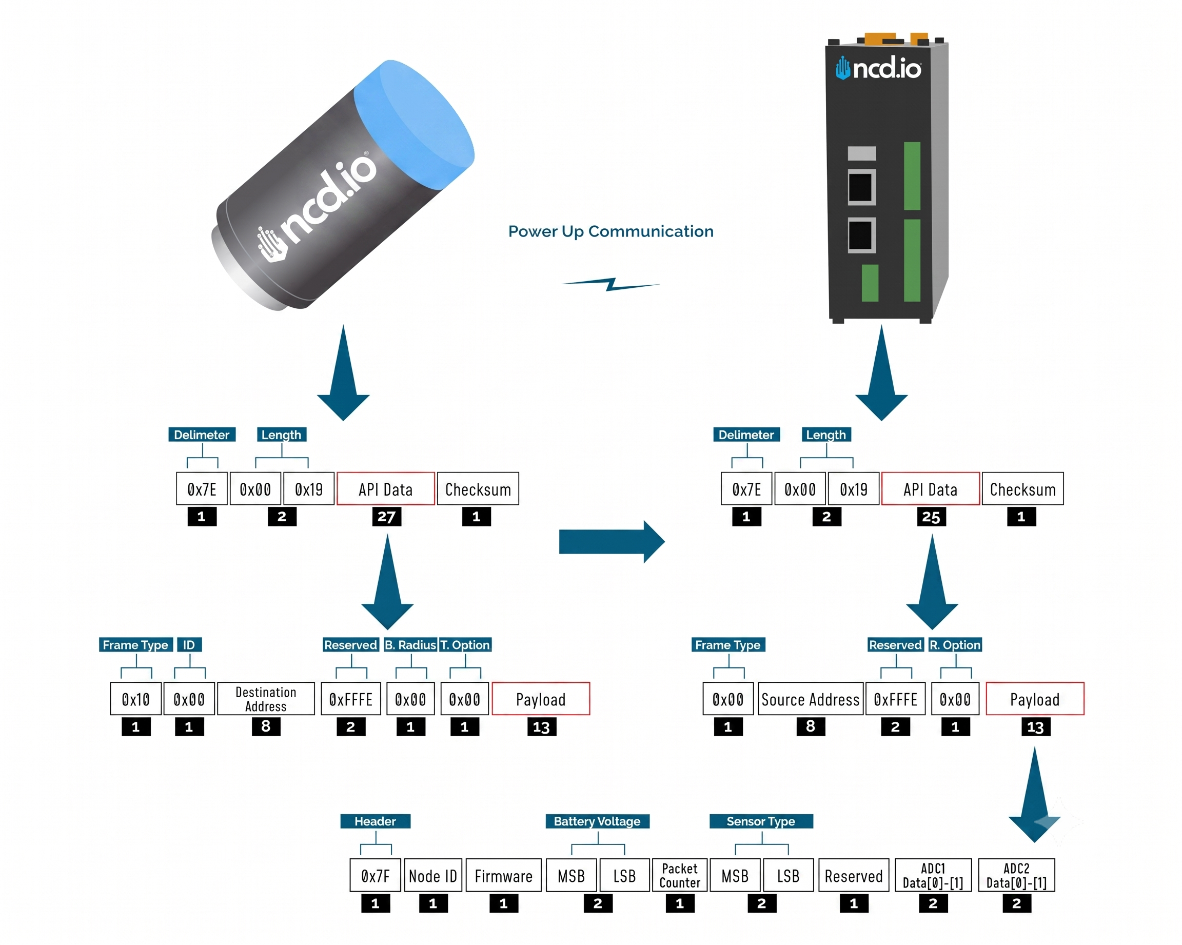

UPTHWRN Mode Frame
| 7E 00 1C 90 00 13 A2 00 42 53 64 53 FF FE C2 7F 00 0E 03 E9 12 00 72 00 55 50 54 48 57 52 4E 7A | Example frame | |
| 0x00 | 1 | R. Option |
| 0x7F | 1 | Header |
| 0x0E | 1 | Firmware Version |
| 0x03E9 | 2 | Battery Voltage |
| 0x12 | 1 | Packet Counter |
| 0x00 | 1 | Reserved |
| 0x5550544857524E | 7 | Mode Byte for UPTHWRN Mode |
| 0x7A | 1 | Checksum |

Configuration Mode
Manual Configuration Mode (enter via CFG key press for 7 seconds at power up) is intended to setup the device over the wireless link, you can change parameter values that are subject to change via downlink master command.
To put an NCD.io wireless sensor into configuration mode, you can do the following:
Using Button
1. Press and release the RESET button
2. Immediately press and hold the CONFIGURATION button
3. Hold the CONFIGURATION button for about 5–8 seconds
4. Release the CONFIGURATION button
Using Magnetic
1. Bring the magnet into close proximity to the designated RESET point on the device housing, then remove it immediately.
2. Immediately place the magnet against the designated CONFIGURATION activation point on the device housing and hold it in place.
3. Maintain the magnet’s position at the CONFIGURATION point for approximately 5 to 8 seconds.
4. Remove the magnet from the CONFIGURATION position.
The following is an example on how to read and change some of the parameters that affect the operation of the NCD Sensor.
Master Command
The Master Command is a comprehensive command that allows you to configure all of the device’s settings in a single transmission.
Below, you will find the structure of the master command, along with a detailed payload description for each byte.
7E 00 38 10 01 00 00 00 00 00 00 FF FF FF FE 00 00 6C 00 00 7F FF 00 00 FF FF 00 0E 28 00 09 02 07 04 01 03 00 01 14 0A
0A 05 0C 00 03 00 00 00 00 00 03 00 3C 01 10 00 64 01 00 C9
Complete Payload
6C 00 00 7F FF 00 00 FF FF 00 0E 28 00 09 02 07 04 01 03 00 01 14 0A 0A 05 0C 00 03 00 00 00 00 00 03 00 3C 01 10 00 64
01 00
Payload Description
| Index | Byte | Size (bytes) | Setting | Valid Options | Description |
| [0] | 6C | 1 | Header | ||
| [1:2] | 00 00 | 2 | Reserved | ||
| [3:4] | 7F FF | 2 | Network ID | 0x00 -- 0x7FFF | Network ID Valid Range: 0-0x7FFF. |
| [5:8] | 00 00 FF FF | 4 | Destination Address | Default value: 0000FFFF for Broadcast Mode Example of targeted address: 41D5EC37 | Sets the Destination Address of the sensor. The sensor will send Run mode Data packets to this Address |
| [9] | 00 | 1 | Node ID | 0x00 -- 0xFF | Sets the Device node ID and Data Transmission Interval. The node id value can go from 0-255 and The Data transmission value can go from 3-0xFFFFFF Seconds |
| [10] | 0E | 1 | Output Data Rate | 0x07--100Hz 0x08--200Hz 0x09--400Hz 0x0A--800Hz 0x0B--1600Hz 0x0C--3200Hz 0x0D--6400Hz 0x0E--12800Hz 0x0F--25600Hz | This would determine how many samples the output data has, which is directly related to the highest frequency components that can be measured. In accordance with the Nyquist equation: f_max = ODR/2.56 Hz Note: Increasing the ODR to 25600Hz introduces significant noise in the vibration data as it allows more frequencies in the resulting data. |
| [11] | 28 | 1 | Sampling Duration | 0x01 -- 0x64 | Set the amount of time which the samples are taken. Note: The sampling duration depends on the ODR. 1= 50msec, 2= 100msec |
| [12] | 00 | 1 | Low Frequency Sampling Ratio | 0x00 -- 4 Filter Coefficient 0x01 -- 8 Filter Coefficient 0x02 -- 16 Filter Coefficient 0x03 -- 32 Filter Coefficient 0x04 -- 64 Filter Coefficient 0x05 -- 128 Filter Coefficient 0x06 -- 256 Filter Coefficient 0x07 -- 512 Filter Coefficient 0x08 -- 1024 Filter Coefficient 0x09 -- 2048 Filter Coefficient | This setting will set the LPF freq to ODR divided by Selected Value Example: ODR = 800 and Filter Coefficient = 4 LPF freq = 800/4 = 200Hz |
| [13] | 09 | 1 | High Frequency Sampling Ratio | 0x00 -- 4 Filter Coefficient 0x01 -- 8 Filter Coefficient 0x02 -- 16 Filter Coefficient 0x03 -- 32 Filter Coefficient 0x04 -- 64 Filter Coefficient 0x05 -- 128 Filter Coefficient 0x06 -- 256 Filter Coefficient 0x07 -- 512 Filter Coefficient 0x08 -- 1024 Filter Coefficient 0x09 -- 2048 Filter Coefficient | This setting will set the HPF freq to ODR divided by Selected Value Example: ODR = 800 and Filter Coefficient = 64 HPF freq = 800/64 = 12.5Hz |
| [14] | 02 | 1 | Full Scale Range | 0x00 -- +/- 2g 0x01 -- +/- 4g 0x02 -- +/- 8g 0x03 -- +/- 16g 0x04 -- +/- 32g 0x05 -- +/- 64g | Set how large of a range the device can measure acceleration in. Example: +/- 8g would mean that it would measure at most up to 8g and down to -8g. |
| [15] | 07 | 1 | Axis Enabled | ||
| [16] | 04 | 1 | Sampling Interval | 0x08 -- Every 1 minutes 0x00 -- Every 5 minutes 0x01 -- Every 10 minutes 0x02 -- Every 15 minutes 0x03 -- Every 20 minutes 0x04 -- Every 30 minutes 0x05 -- Every 60 minutes 0x06 -- Every 120 minutes 0x07 -- Every 180 minutes | Set how often will the sensor transmit measurement data. Note: For this sensor, this value functions as the sampling interval rather than a traditional delay. |
| [17] | 01 | 1 | Filter Status | 0x01 -- Enable 0x00 -- Disable | Enable/Disable built-in filters |
| [18] | 03 | 1 | Operation Mode | 0x00 -- Processed Mode 0x01 -- Raw Mode 0x02 -- Processed + Raw on Request 0x03 -- Smart Mode | • Processed: FFT is performed by the sensor and the measurement data is transmitted in condensed form (both time and frequency parameters). • Time Domain (Raw): The Time Domain (Raw) data is gathered and transmitted and it is up to the client to perform the FFT if needed. This is a very large data packet. • Processed + Raw on demand: Transmit Processed data at intervals, with the option to request a Time Domain (Raw) data packet. • Smart: Transmit Processed data at intervals and Time Domain (Raw) data on request, with auto Time Domain (Raw) data transmission option. Option to triggers on RMS acceleration exceeding thresholds on X, Y, Z axes, with smart skip to limit sends when vibrations are low. WARNING: If Mode is set to Time Domain (Raw) data or Auto Time Domain (Raw) data (in Smart Mode) it is recommended to also set the Destination Address (Auto Raw Destination Address in Smart mode) configuration to the address of your Receiver/Gateway. |
| [19] | 00 | 1 | Measurement Mode | ||
| [20] | 01 | 1 | Data on request timeout | 0x00 to 0x0A | Set how long device will stay awake and wait for Time Domain (Raw) request from command. |
| [21] | 14 | 1 | Accelerometer deadband | Valid Range: 0x00 -- 0xFF | |
| [22] | 0A | 1 | Motion detect | Valid Range: 0x00 -- 0x28 | The sensor will wake up and take samples when vibration goes above this threshold(Set threshold 400mg, Multiple of 50mg) |
| [23] | 0A | 1 | Acceleration alert threshold | Valid Range: 0x00 -- 0xFF | Set the minimum acceleration value to make LED indicator red.This will be an integer value that increments the threshold by 50mg. A value of 1 means turn the LED red if acceleration is above 50mg, 2 means 100mg, etc.**Only applies if LED Alert Mode is set to Acceleration.RED Alert Led Will Blink If the RMS acceleration readings go above this threshold(Set threshold 400mg, Multiple of 50mg) |
| [24] | 05 | 1 | Velocity Alert | Valid Range: 0x00 -- 0xFF | Set the minimum velocity value to make LED indicator red.This will be an integer value that increments the threshold by 2mm/second. A value of 1 means turn the LED red if velocity is above 2mm/sec, 2 means 4mm/second, etc.**Only applies if LED Alert Mode is set to Velocity.RED Alert Led Will Blink If the RMS Velocity readings go above this threshold(Set threshold 20mm/sec, Multiple of 2mm/sec) |
| [25] | 0C | 1 | Smart accelerometer threshold | Valid Range: 0x00 -- 0xFFFE | If RMS acceleration is above this in any axis, it will send data. This will be an integer value that increments the interrupt threshold by 50 mg. A value of 1 means to wake the sensor if acceleration is above 50 mg, 2 means 100 mg, etc. |
| [26] | 00 | 1 | Alert mode | 0x00 -- Acceleration 0x01 -- Velocity | Alert LED will blink if readings go above set threshold |
| [27] | 03 | 1 | Raw packet length | 0x00 -- 55 Bytes 0x01 -- 100 Bytes 0x02 -- 150 Bytes 0x03 -- 180 Bytes | Set the amount of Time Domain Data included in each RAW transmission sent by the sensor. |
| [28] | 00 | 1 | Auto Time-Domain interval | Valid Range: 0x00 -- 0xFF | The interval is determined by the sample interval. If the value is set to 1 and the sample interval is 10 minutes, raw data will be sent every 10 minutes. If the value is set to 5, raw data will be sent every 50 minutes. |
| [29:32] | 00 00 00 00 | 4 | Auto Time-Domain destination address | Valid Range: 0x00 -- 0xFFFFFFFF | Each time the sensor automatically transmits Time-Domain (raw) data, it will be sent either in broadcast mode or unicast mode (targeted address).Default value: 0000FFFF for Broadcast Mode |
| [33] | 03 | 1 | Smart mode skip count | Valid Range: 0x00 -- 0xFF | Sensor will skip sending data this many times if vibration is below the smart threshold. |
| [34:35] | 00 3C | 2 | Sync rate | 0x003C -- 1 Hour 0x0078 -- 2 Hours 0x00F0 -- 4 Hours 0x01E0 -- 8 Hours 0x02D0 -- 12 Hours 0x0438 -- 18 Hours 0x05A0 -- 24Hours | Set the interval at which the sensor performs Sync Mode transmissions. |
| [36] | 01 | 1 | Rpm status | 0x01 -- Enable 0x02 -- Disable | Enable/disable whether the sensor calculates and reports the Rotations Per Minute (RPM) of a rotating machine or component during its measurements. |
| [37:38] | 10 00 | 2 | Max raw tx samples | 0x0400 -- 1024 Samples 0x8000 -- 2048 Samples 0x1000 -- 4096 Samples 0x1900 -- 6400 Samples 0x1FA4 -- 8100 Samples. | Defines the maximum number of samples the sensor captures for time-domain data |
| [39] | 64 | 1 | Motion to sampling delay | Valid Range: 0x00 -- 0xFF | Once motion is detected, the sensor will wait for the configured duration before sampling and computing vibration data. 1= 50msec, 2= 100msec, 100= 5000msec (5sec). Default value: 100 (5000msec) |
| [40] | 01 | 1 | Max number of motions per transmition interval | Valid Range: 0x01 -- 0xFF | Set Number of times it will send data due to motion triggers. Default value: 1 Note: Setting this to a higher value will drain the battery. |
| [41] | 00 | 1 | Ultrasound Max Time-Domain Samples | 0x00 -- 2048 Samples 0x01 -- 4096 Samples 0x02 -- 8192 Samples 0x03 -- 16384 Samples |
