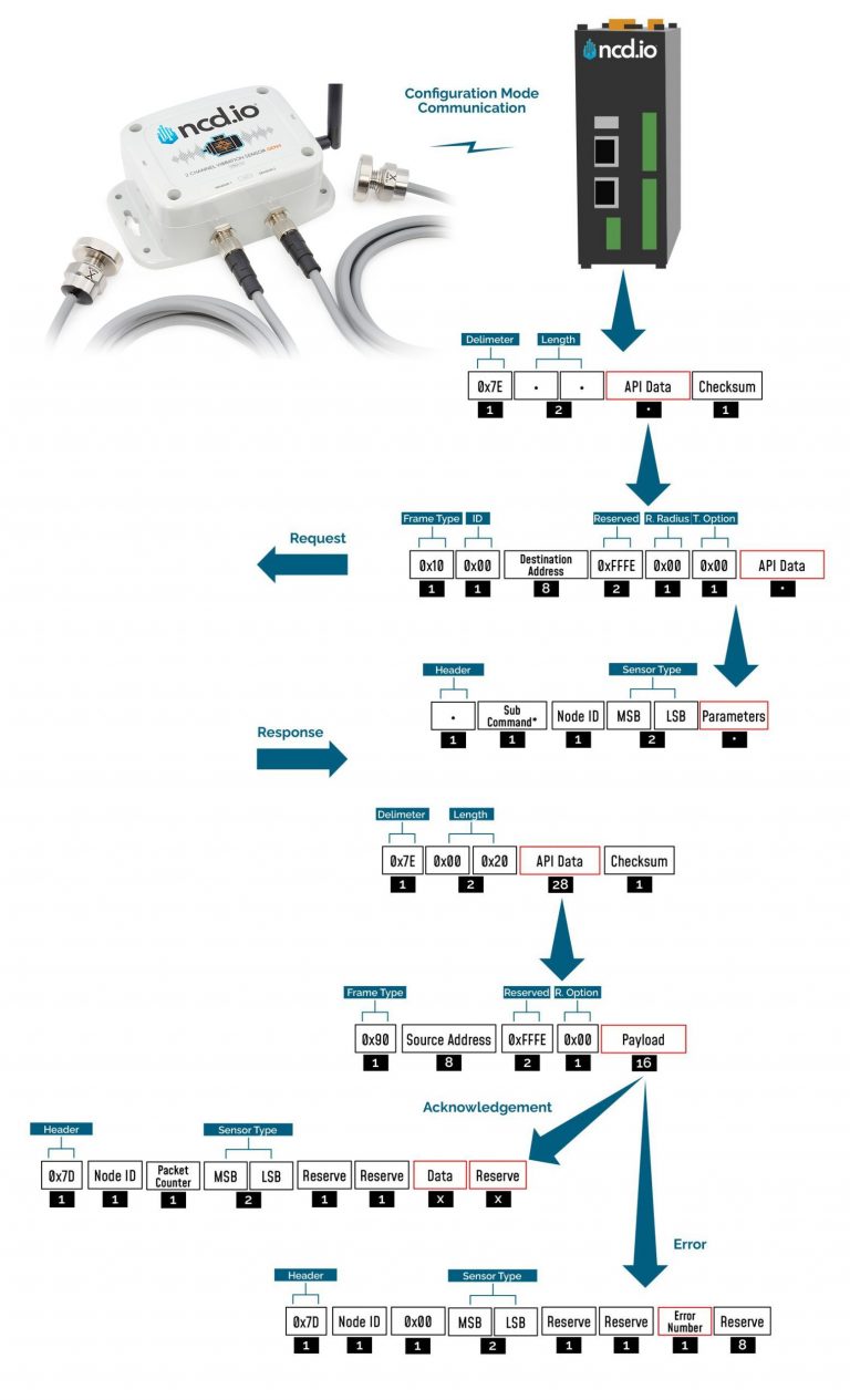

Configuration Mode Communication
A standard configuration packet and its fields are explained in Figure 5. Its possible responses are also shown. The complete set of commands supported by this sensor are shown in the Appendix, these can be used in the Parameters field of the Payload section. The sensor responds to these commands with an acknowledgement if the process completed successfully or with an error if it failed to setup a parameter. The respective Data and Reserve section length and values are shown in Table 6 for the case of acknowledgement. In the case of error, the reserved section will be fixed and not used, while the Error number byte will determine the type of error returned. These errors are in a separate section in the Appendix.
The following set of commands are an example on how to change some of the parameters that affect the operation of the Two Channel Vibration Sensor Gen4 (these are parameters that are general in nature, more on a network protocol/device level than device specific). You can find them in Appendix together with the Device/Application Specific commands.
