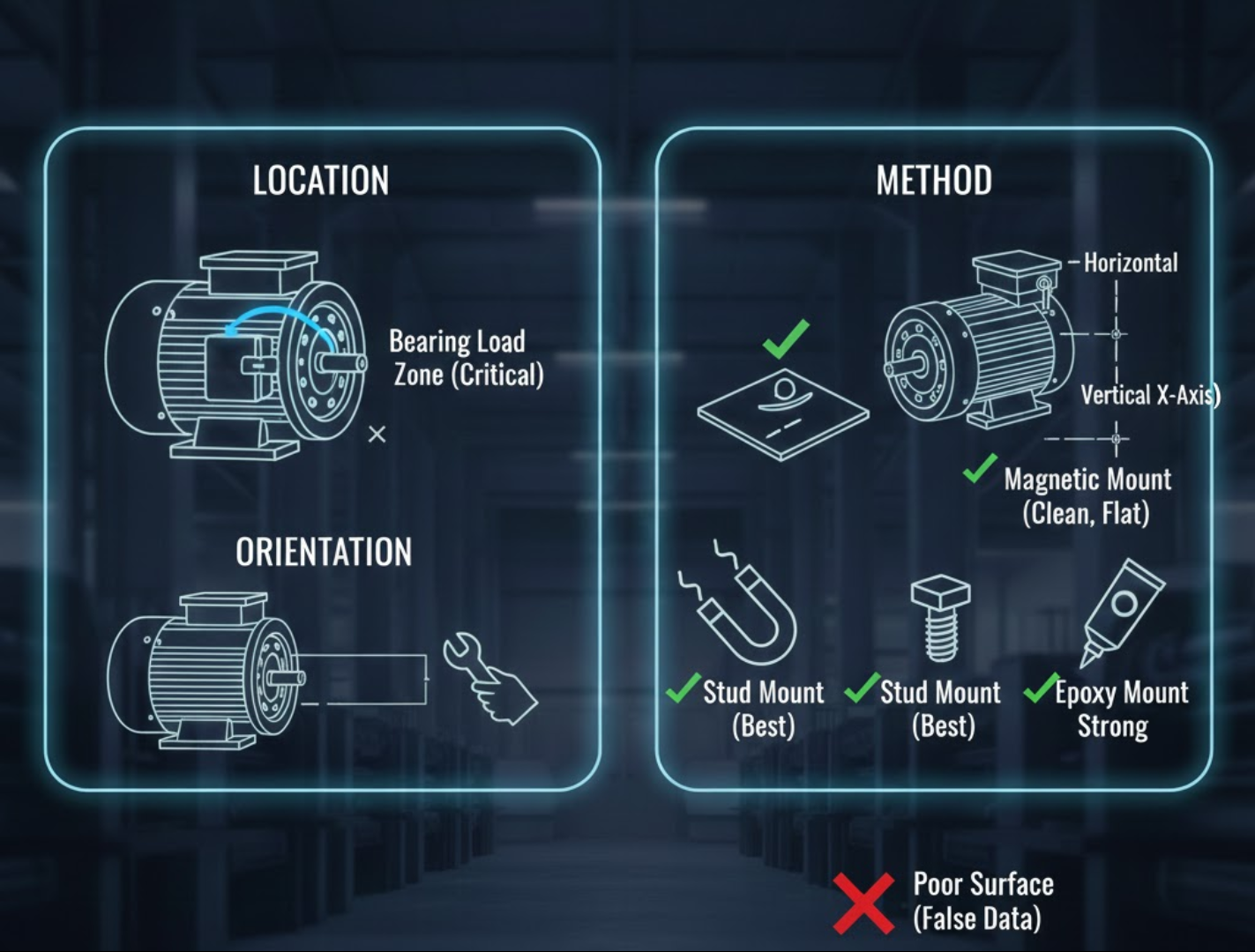

Step 5: Strategic Installation & Mounting
This is the most critical step. A vibration sensor is only as good as its mechanical connection to the machine. Poor mounting leads to dampened signals and false data.
- Location: Mount the sensor as close to the bearing load zone as possible.
- Orientation: Ensure you are measuring the correct axis. For radial bearings, you typically want horizontal and vertical readings.
- Method: While magnetic mounts are convenient for easy setup, ensure the surface is clean, flat, and free of thick paint. For the highest frequency response, stud mounting or industrial epoxy is recommended.
Reference: Getting this wrong invalidates your data. Review our Sensor Installation Best Practices before you begin.

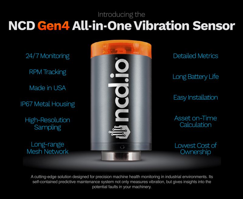

Why the NCD is the Industry Standard
We designed the Gen4 Wireless Vibration & Temperature Sensor specifically to bridge the gap between complex vibration analysis and easy-to-use IoT.
- Complete Visibility: Fuses 3-Axis MEMS accelerometers with a precision surface temperature sensor.
- No Hidden Costs: We believe your data belongs to you. No monthly subscriptions, no licensing traps.
- Open Architecture: Whether you use AWS, Azure, Node-RED, or a custom SCADA, our sensors speak your language.
- Smart & Efficient: Configurable Smart Mode ensures you get the data you need without draining the battery or flooding your bandwidth.
