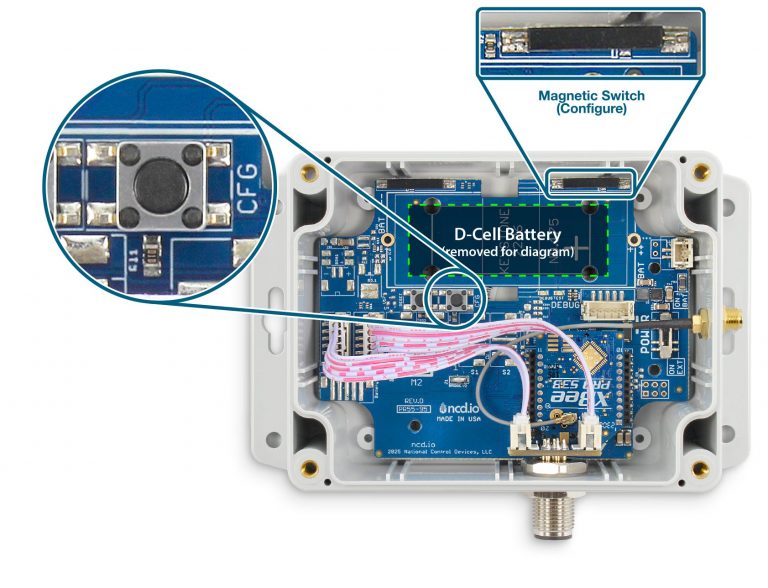

Hardware Controls
Power Switch
- Battery Power
- Off
- External Power
RESET Button
CFG Button
Hardware Mode Selection
Run Mode
Configuration Mode
Factory Default/Reset
You can perform a Factory Reset by pressing and release the RESET button, wait for a second, then press and hold the CONFIGURATION button, hold the CONFIGURATION button for more than 15 seconds, release CONFIGURATION button.
Immediately after a factory reset the sensor will go into Configuration Mode in order to be reconfigured with the desired settings. To activate RUN Mode, please wait for 3-5 seconds and then press the RESET button.
Refer to the graph below for the precise timing of the CONFIGURATION button press.
- Press and Release the RESET button
- Configuration Button Pressed and held 1 second after reset for:
- < 2 second – device starts normally in RUN Mode
- 2 to 15 seconds – device goes into Configuration Mode
- > 15 seconds – the device reverts back to the Factory Default Settings, which is followed by a Configuration Mode Frame
