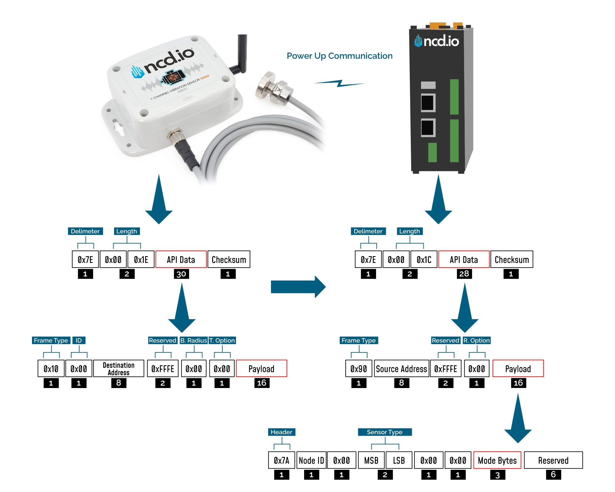

Frame Structure
Mode Type | PAN ID set by Sensor (ASCII) | Frame field | Offset (Payload section) | Value |
Run | ID save by user / Default | Mode bytes | 7 | 0x52 |
8 | 0x55 | |||
9 | 0x4E | |||
Configuration | 7BCD | Mode bytes | 7 | 0x50 |
8 | 0x47 | |||
9 | 0x4D | |||
Factory Reset | 7FFF | Mode bytes | 7 | 0x50 |
8 | 0x55 | |||
9 | 0x4D |

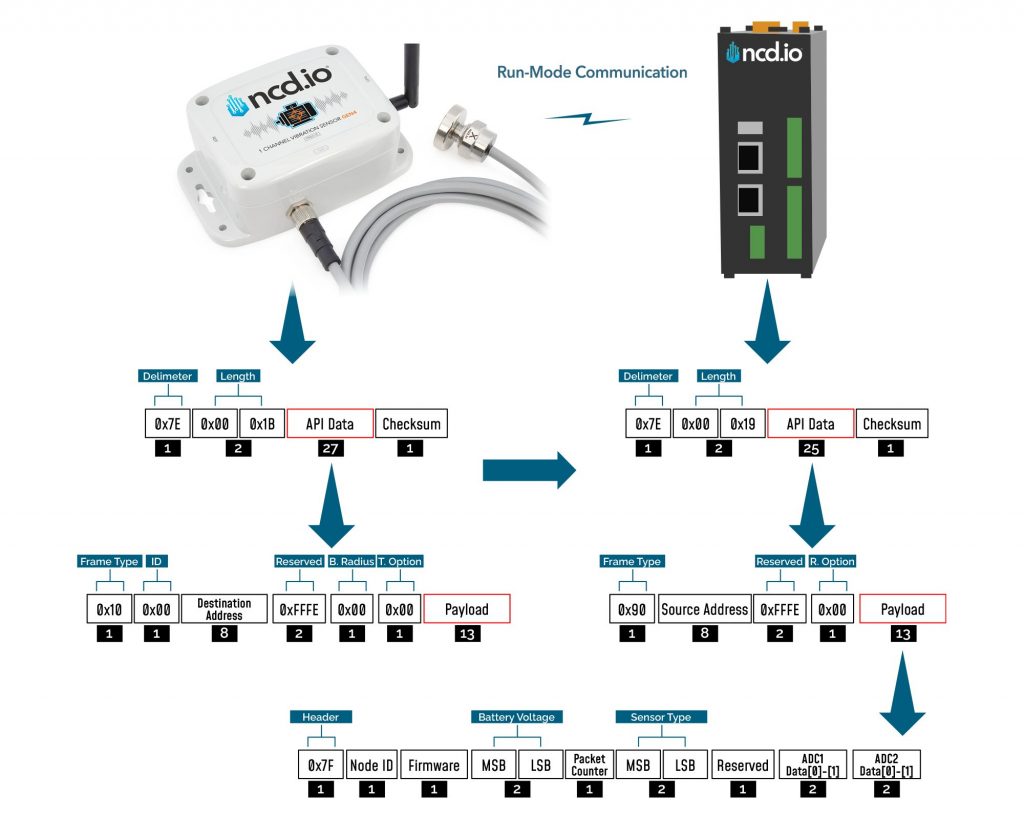

Run Mode Frame
Field | Number of bytes | Description |
7E 00 1C 90 00 13 A2 00 42 53 64 53 FF FE C2 7A 00 00 00 6E 00 00 52 55 4E 00 00 00 00 00 00 D2 | Example frame | |
0x7E | 1 | Delimiter |
0x001C | 2 | Length |
0x90 | 1 | Frame Type (Power Up) |
0x0013A20042536453 | 8 | Source Address |
0xFFFE | 2 | Reserved |
0xC2 | 1 | R. Option |
0x7A | 1 | Header with Power Up value |
0x00 | 1 | Node ID |
0x00 | 1 | Separator |
0x006E | 2 | Sensor Type |
0x0000 | 2 | Separator |
0x52554E | 3 | Mode Byte for Run Mode |
0x000000000000 | 6 | Reserved |
0xD2 | 1 | Checksum |

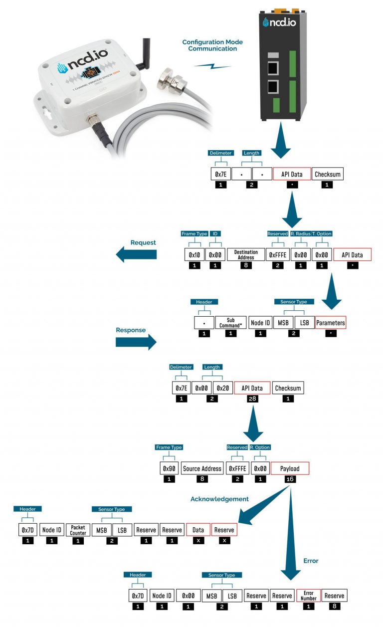

Configuration Mode Frame
7E 00 1C 90 00 13 A2 00 42 53 64 53 FF FE C2 7A 00 00 00 6E 00 00 50 47 4D 00 00 00 00 00 00 E3 | Example frame | |
0x90 | 1 | Frame Type |
0x7A | 1 | Header |
0x50474D | 3 | Mode Byte for Configuration Mode |
0xE3 | 1 | Checksum |

Sensor Data Frame
As this sensor has two possible frame structures for the Processed and RAW mode, we are detailing each one below:
Processed Data Frame
Frame Field | Offset (Payload section) | Fixed Value (if any) | Length | Description |
Header | 0 | 0x7F | 1 | Header to differentiate various types of packets |
Node ID | 1 | 0x00 | 1 | Node ID to differentiate up to 256 nodes in a network. User configurable values |
Firmware | 2 | 0x01 | 1 | Used to determine firmware version programmed in the device |
Battery Voltage | MSB 3 | 0x03 | 2 | Battery Voltage = 0.00322*(03*FF+FE) |
LSB 4 | 0xFE | Battery Voltage = ((Battery Voltage MSB x 256) + Battery Voltage LSB) x 0.00322 V | ||
Packet Counter | 5 | - | 1 | It is an 8-bit counter that increments with each packet transmission. It can be used to detect missing packets |
Sensor Type | MSB 6 | 0x00 | 2 | Two bytes to determine sensor type. It can be used in conjunction with Node ID to create sensor networks of up to 256 nodes for a single type of sensor and multiple such networks can coexist and can be differentiated in processing software on PC end. |
LSB 7 | 0x6E | Sensor Type 110 | ||
Error/Reserved byte | 8 | 0x00 | 1 | Bit 1: Validity of Data for sensor: - 0: Data is valid - 1: Error in accessing sensor |
In Processed Packet. Bit 4: Message Type: - 1: Motion Report - 0: Regular Report |
Sensor Data | 9/ Data[0] | 0x00 | 1 | Mode of Operation: 0x00 - Processed 0x01 - Raw 0x02 - On Demand 0x03 - Smart |
Output Data Rate | 10/ Data[0] | - | 1 | Vibration Sample Rate: 0x08 - 200Hz 0x09 - 400Hz 0x0A - 800Hz 0x0B - 1600Hz 0x0C - 3200Hz 0x0D - 6400Hz 0x0E - 12800Hz 0x0F - 25600Hz |
Temperature | 11/ Data[0] | - | 2 | Temperature value (Unsigned 16 bit int) |
12/ Data[1] | - | Temperature in Celsius = (Data[0] * FF + Data[1]) / 100 | ||
RMS ACC in X Axis in mg | 13/ Data[0] | - | 2 | rms_acc_x_mg value |
14/ Data[1] | - | rms_acc_x_mg = (Data[0] * FF + Data[1]) / 1000 | ||
MAX ACC in X Axis in mg | 15/ Data[0] | - | 2 | max_acc_x_mg value |
16/ Data[1] | - | max_acc_x_mg = (Data[0] * FF + Data[1]) / 1000 | ||
RMS Velocity in X Axis in mm/sec | 17/ Data[0] | - | 2 | rms_vel_x_mm_sec value |
18/ Data[1] | - | rms_vel_x_mm_sec = (Data[0] * FF + Data[1]) / 100 | ||
RMS Displacement in X Axis in mm | 19/ Data[0] | - | 2 | rms_disp_x_mm value |
20/ Data[1] | - | rms_disp_x_mm = (Data[0] * FF + Data[1]) / 100 | ||
Frequency of Highest Peak in X direction | 21/ Data[0] | - | 2 | X1 Hz Value |
22/ Data[1] | - | X1_Hz = (Data[0] * FF + Data[1]) | ||
Frequency of Second Highest Peak in X direction | 23/ Data[0] | - | 2 | X2_Hz Value |
24/ Data[1] | - | X2_Hz = (Data[0] * FF + Data[1]) | ||
Frequency of Third Highest Peak in X direction | 25/ Data[0] | - | 2 | X3_Hz Value |
26/ Data[1] | - | X3_Hz = (Data[0] * FF + Data[1]) | ||
RMS ACC in Y Axis in mg | 27/ Data[0] | - | 2 | rms_acc_y_mg value |
28/ Data[1] | - | rms_acc_y_mg = (Data[0] * FF + Data[1]) / 1000 | ||
MAX ACC in Y Axis in mg | 29/ Data[0] | - | 2 | max_acc_y_mg value |
30/ Data[1] | - | max_acc_y_mg = (Data[0] * FF + Data[1]) / 1000 | ||
RMS Velocity in Y Axis in mm/sec | 31/ Data[0] | - | 2 | rms_vel_y_mm_sec value |
32/ Data[1] | - | rms_vel_y_mm_sec = (Data[0] * FF + Data[1]) / 100 | ||
RMS Displacement in Y Axis in mm | 33/ Data[0] | - | 2 | rms_disp_y_mm value |
34/ Data[1] | - | rms_disp_y_mm = (Data[0] * FF + Data[1]) / 100 | ||
Frequency of Highest Peak in Y direction | 35/ Data[0] | - | 2 | Y1 Hz Value |
36/ Data[1] | - | Y1_Hz = (Data[0] * FF + Data[1]) | ||
Frequency of Second Highest Peak in Y direction | 37/ Data[0] | - | 2 | Y2_Hz Value |
38/ Data[1] | - | Y2_Hz = (Data[0] * FF + Data[1]) | ||
Frequency of Third Highest Peak in Y direction | 39/ Data[0] | - | 2 | Y3_Hz Value |
40/ Data[1] | - | Y3_Hz = (Data[0] * FF + Data[1]) | ||
RMS ACC in Z Axis in mg | 41/ Data[0] | - | 2 | rms_acc_z_mg value |
42/ Data[1] | - | rms_acc_z_mg = (Data[0] * FF + Data[1]) / 1000 | ||
MAX ACC in Z Axis in mg | 43/ Data[0] | - | 2 | max_acc_z_mg value |
44/ Data[1] | - | max_acc_z_mg = (Data[0] * FF + Data[1]) / 1000 | ||
RMS Velocity in Z Axis in mm/sec | 45/ Data[0] | - | 2 | rms_vel_z_mm_sec value |
46/ Data[1] | - | rms_vel_z_mm_sec = (Data[0] * FF + Data[1]) / 100 | ||
RMS Displacement in Z Axis in mm | 47/ Data[0] | - | 2 | rms_disp_z_mm value |
48/ Data[1] | - | rms_disp_z_mm = (Data[0] * FF + Data[1]) / 100 | ||
Frequency of Highest Peak in Z direction | 49/ Data[0] | - | 2 | Z1 Hz Value |
50/ Data[1] | - | Z1_Hz = (Data[0] * FF + Data[1]) | ||
Frequency of Second Highest Peak in Z direction | 51/ Data[0] | - | 2 | Z2_Hz Value |
52/ Data[1] | - | Z2_Hz = (Data[0] * FF + Data[1]) | ||
Frequency of Third Highest Peak in Z direction | 53/ Data[0] | - | 2 | Z3_Hz Value |
54/ Data[1] | - | Z3_Hz = (Data[0] * FF + Data[1]) | ||
Revolutions Per Minute (RPM) | 55/ Data[0] | - | 2 | Revolutions Per Minute Value |
56/ Data[1] | - | RPM = (Data[0] << 8) + Data[1] |
Error/Reserved byte | 8 | 0x00 | 1 | Bit 1: Validity of Data for sensor: - 0: Data is valid. - 1: Error in accessing sensor |
In Time Domain Data (RAW) Packet. Bit 4: Message Type: - 1: Motion Report - 0: Regular Report |
Sensor Data | 9/ Data[0] | 0x01 | 1 | Mode of Operation: 00 - Processed 01 - Raw 02 - On Demand 03 - Smart |
Output Data Rate | 10/ Data[0] | - | 2 | Output Data Rate Value |
11/Data[1] | - | ODR = (Data[0] * FF + Data[1]) | ||
Full Scale Range and Eabled Axis | 12/Data[0] | - | 1 | Three MSB bit of the Axis byte to indicate FSR And 3 LSB bits indicates Axis |
Hour | 13/Data[0] | - | 1 | Hour = Data[0] |
Minute | 14/Data[0] | - | 1 | Minute = Data[0] |
Device Temperature | 15/Data[0] | - | 2 | Device Temperature Value |
16/Data[1] | - | Temperature = (Data[0] * FF + Data[1]) / 100 | ||
Total Number of RF Packets | 17/Data[0] | - | 2 | Total Number of RF Packets Value |
18/Data[1] | - | Total Number of RF Packets = ((Data[0] << 8) + Data[1]) | ||
Current Packet Count value | 19/Data[0] | - | 2 | Current Packet Count value |
20/Data[1] | - | Current Packet Count = ((Data[0] << 8 ) + Data[1]) | ||
Time Domain Data Packets | - | - | - | - |
X1-Axis RAW ACC Data | - | - | - | X1= (01*0xFF+ 0xDE)*FSR coefficient |
Y1-Axis RAW ACC Data | - | - | - | Y1= (01*0xFF+ 0x7A)*FSR coefficient |
Z1-Axis RAW ACC Data | - | - | - | Z1= (3F*0xFF+ 0x8B)*FSR coefficient |
Configuration Mode Communication
The following set of commands are an example on how to change some of the parameters that affect the operation of the One Channel Vibration Sensor Gen4 (these are parameters that are general in nature, more on a network protocol/device level than device specific). You can find them in Appendix together wit the Device/Application Specific commands.
Read Sleep Duration
Read Sleep Duration Command
00 00 00 00 00 00 FF FF

This Command may be used to set the sensor node and sleep duration, note that both values are stored together using the same command. The Node ID is a user-defined value from 00 to FF that may be used to help easily identify a sensor. The Sleep Duration indicates the amount of time (in seconds) the sensor will sleep before waking up, taking a sample, sending a transmission, and going back to sleep.
In the above command, the remote device address is set to broadcast mode. The broadcast address is 00 00 00 00 00 00 FF FF, which will target all sensors in configuration mode. Change the broadcast address to the MAC address of a individual sensor to target a particular sensor with this command (this is usually not required). The Command Contains a Sensor payload which contains a Sensor Node ID and Delay value.
Payload
F7 02 00 00 00 01 00 01 2C
Note that F7 is the command header byte and 02 is the sub command for storing the Node ID and Sleep Duration.

Read Sensor Network ID
A. Sensor MAC Address
00 13 A2 00 41 91 1B 83
B. Complete Sensor Payload
C. Network ID
0x07FF (data bytes 23 and 24)
This command may be used to set the sensor Network ID. Please note, Network ID 0x7BCD is reserved for configuration and should NEVER be used as a network ID for general use. Please note the Modem/Gateway must also use a matching Network ID to communicate with the sensor.
Above Command Contains the following payload:
F7 05 00 00 00 7C DE
Note that F7 is the command header byte and 05 is the sub command for setting the Sensor Network ID.

Every sensor is designed to send sensor data either in broadcast mode or to a particular destination address (modem or gateway). By default, NCD sensors broadcast data to all available modems and gateways. Data may be restricted to a single destination address (modem or gateway), though this configuration does not provide any form of redundancy in the event of a Modem or Gateway outage. For this reason, we strongly advise against using this command. Please consider setting the Network ID (PAN ID) to Setup Zones which will allow for redundancy in the event of a service outage. The following command is provided for reference ONLY and should be used with caution as a modem or gateway failure will necessitate reconfiguration of each sensor (which would not be required if the Pan ID/Network ID were used).
What is a Destination Address? Every sensor, gateway, and modem have a unique MAC address which cannot be changed. This MAC address is also known as the destination address (printed on the side of the enclosure). By default, all sensors send data in broadcast mode. This allows all the gateways and modems in the area to receive sensors data provided they are all on the same PAN ID (Network ID) and use the same encryption key.
When a specific destination address is stored in the sensor, the sensor will send data to that specific destination address only. The sensor CANNOT communicate with any other modem or gateway in the area. The following command may be used to specify a specific destination address (modem or gateway) for all sensor data:
This command we will send only the lower 4 bytes of the destination address (the upper 4 bytes do not change).
Complete Payload
F7 03 00 00 00 12 34 56 78
F7 is the command header byte and 03 is the sub command for setting a specific destination address. In this example, the new Destination Address is 12345678.

No. | Command | Header | Sub Command | Parameter Field | Default Value | Description |
1 | Set Broadcast Transmission | 0XF7 | 0x01 | - | 0000FFFF | This will set the address to Broadcast mode. All the receiver with same ENY key and PAN ID will get the data packets |
2 | Set ID and Sleep Interval | 0XF7 | 0x02 | NODE ID, D0 MSB,D1, D2 LSB | 0x00,0x00,0x02,0x58 | Sets the Device node ID and Data Transmission Interval. The node id value can go from 0-255 and The Data transmission value can go from 3-0xFFFFFF Seconds |
3 | Set Destination Address | 0XF7 | 0x03 | A0 MSB, A1, A2, A3 | 00,00,FF,FF | Sets the Destination Address of the sensor. The sensor will send Run mode Data packets to this Address |
4 | Set Power | 0XF7 | 0x04 | Power ( range 1-4) | 0x04 | Sets the RF power of the Sensor Radio |
5 | Set PAN ID aka Network ID | 0XF7 | 0x05 | ID0 MSB, ID1 LSB | 0x7FFF | Sets the PAN ID aka Network ID in the sensor. Only sensors, Gateway, and Modes with Same ID can communicate with each other |
6 | Set Retries | 0XF7 | 0x06 | Retries | 0x0A | Sets the number of Retries after unsuccessful transmission for the Sensor Radio |
7 | Read Sleep Interval | 0XF7 | 0x15 | - | 0x00,0x02,0x58 | Reads the stored Sleep Interval value from the sensor |
8 | Read Power | 0XF7 | 0x16 | - | 0x04 | Reads the stored RF Power value from the sensor |
9 | Read Retries | 0XF7 | 0x17 | - | 0x0A | Reads the stored Retries value from the sensor |
10 | Read Destination Address | 0XF7 | 0x18 | - | 00,00,FF,FF | Reads the stored Destination value from the sensor |
11 | Read PAN ID aka Network ID | 0XF7 | 0x19 | - | 0x7FFF | Reads the PAN ID aka Network ID |
12 | Enable Encryption | 0XF2 | 0x01 | - | 0x01 | Enables the Encryption of the Frame Transmitted from the Sensor |
13 | Disable Encryption | 0XF2 | 0x02 | - | - | Disables the Encryption of the Frame Transmitted from the Sensor |
14 | Set Encryption Key | 0XF2 | 0x03 | 00,K0 MSB, K1,K2,K3,K4,K5,K6,K7,K8,K9,K10,K11,K12,K13,K14,K15 | 55AA55AA55AA55AA55AA55AA55AA55AA | Sets the 128 bit AES Encryption Key |
Command Acknowledgement Data
No. | Command | Data bytes | Reserved bytes | Data | Calculation (if any) |
1 | Set Broadcast Transmission | 1 | 8 | 0xFF (OK) | |
2 | Set ID and Sleep Interval | 1 | 8 | 0xFF (OK) | |
3 | Set Destination Address | 1 | 8 | 0xFF (OK) | |
4 | Set Power | 1 | 8 | 0xFF (OK) | |
5 | Set PAN ID aka Network ID | 1 | 8 | 0xFF (OK) | |
6 | Set Retries | 1 | 8 | 0xFF (OK) | |
7 | Read Sleep Interval | 3 | 6 | D0 MSB, D1, D2 LSB | Delay = (D0 x 65536) + (D1 x 256) + D2 |
8 | Read Power | 1 | 8 | Power | DEC value |
9 | Read Retries | 1 | 8 | Retries | DEC value |
10 | Read Destination Address | 4 | 5 | A0 MSB, A1, A2, A3 | |
11 | Read PAN ID aka Network ID | 2 | 7 | ID0 MSB, ID1 | |
12 | Enable Encryption | 1 | 8 | 0xFF (OK) | |
13 | Disable Encryption | 1 | 8 | 0xFF (OK) | |
14 | Set Encryption Key | 1 | 8 | 0xFF (OK) |
