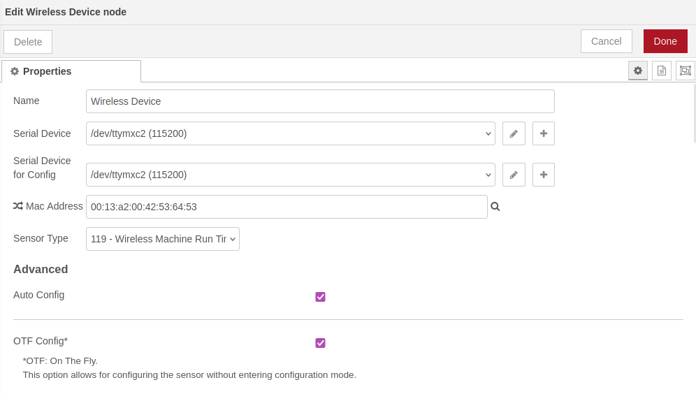

					{ "_msgid": "d7f3341ef39225df",

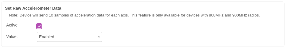

  • raw_data
    • Enabled – the message contains the raw accelerometer data (all samples of the measurement)
    • Disabled – the message does not contain the raw accelerometer data (all samples of the measurement), Just Counters, Uptimers and input status

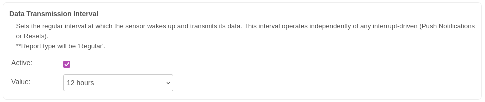

      • Regular – Data transmission occurred at the configured Data Transmission Interval

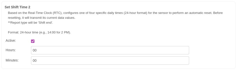

  • reported_config.shift_end_1
    • The current Shift Time 1 configured on the sensor
  • reported_config.shift_end_2
    • The current Shift Time 2 configured on the sensor
  • reported_config.shift_end_3
    • The current Shift Time 3 configured on the sensor
  • reported_config.shift_end_4
    • The current Shift Time 4 configured on the sensor

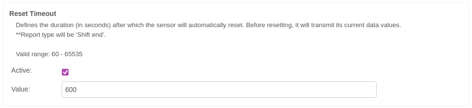

  • reported_config.reset_timeout
    • The current Reset Timeout in minutes configured on the sensor

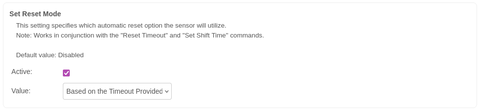

  • reported_config.counter_reset_mode: The current Reset Mode status

Wireless Gateway Edit Pane
  1. Name
  2. Serial Device*
  3. Serial Device Edit Icon
Click to enlarge

  • Name
    • Arbitrary name of this node
  • Serial Device*
    • For More information on the submenu the edit icon brings up see section ncd-gateway-config Nodes
  • Serial Device for Config
  • Mac Address
  • Sensor Type*
  • Auto Config
  • OTF Config
    • Checking the box next to this field AND having Auto Config checked tells Node-Red that the sensor(s) corresponding to this Wireless Device node should be configured when a FLY message is detected

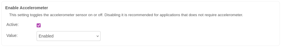

Enable Accelerometer
This setting toggles the accelerometer sensor on or off. Disabling it is recommended for applications that do not require measurement of vibrations.

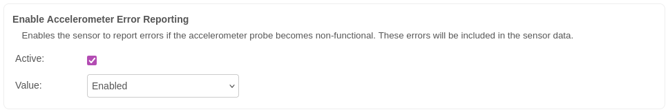

Enable Accelerometer Error reporting
Enables error reporting for the accelerometer probe. If this option is enabled errors will be reported when the accelerometer probe is non-functional. It is recommended to enable this feature when using the Accelerometer probe.

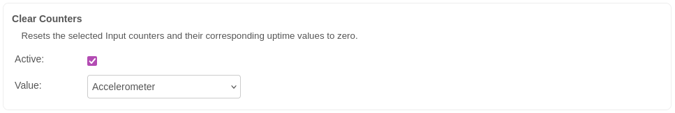

Clear Counters
Resets the values of the specified counters
Options:
– Magnetometer
– Accelerometer
Default value: Disabled

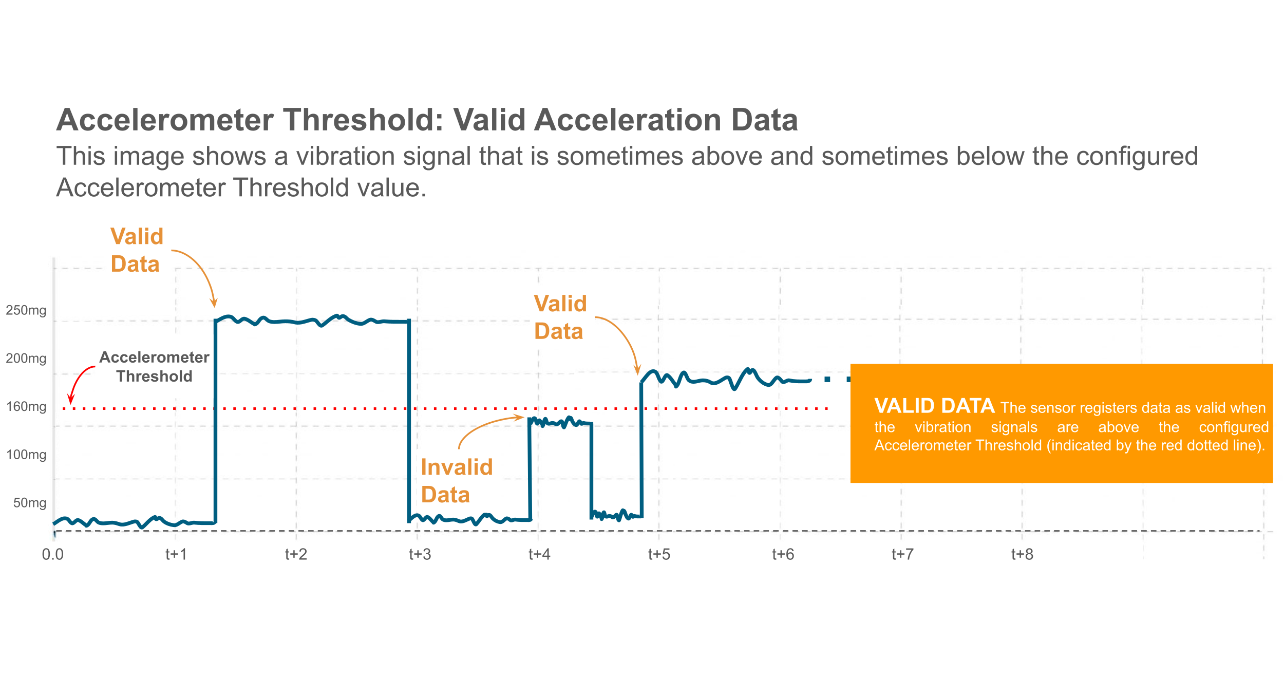

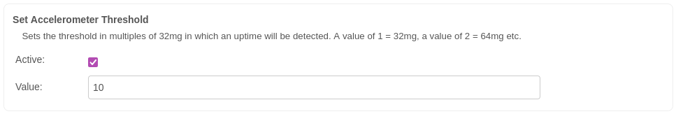

Set Accelerometer Threshold
Sets the threshold in multiples of 32mg in which an uptime will be detected. A value of 1 = 32mg, a value of 2 = 64mg etc. This is what determines if you properly measure you uptime cycle while using the accelerometer probe, make sure you adjust it based on the vibration you expect your machine to produce while active.

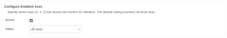

Configure Enabled Axes
Specify which axes (X, Y, Z) the sensor will monitor for vibration. The default setting monitors all three axes.
Set Raw Accelerometer Data
The device will send 10 samples of acceleration data for each axis if this is enabled. This feature is only available for devices with 868MHz and 900MHz radios.

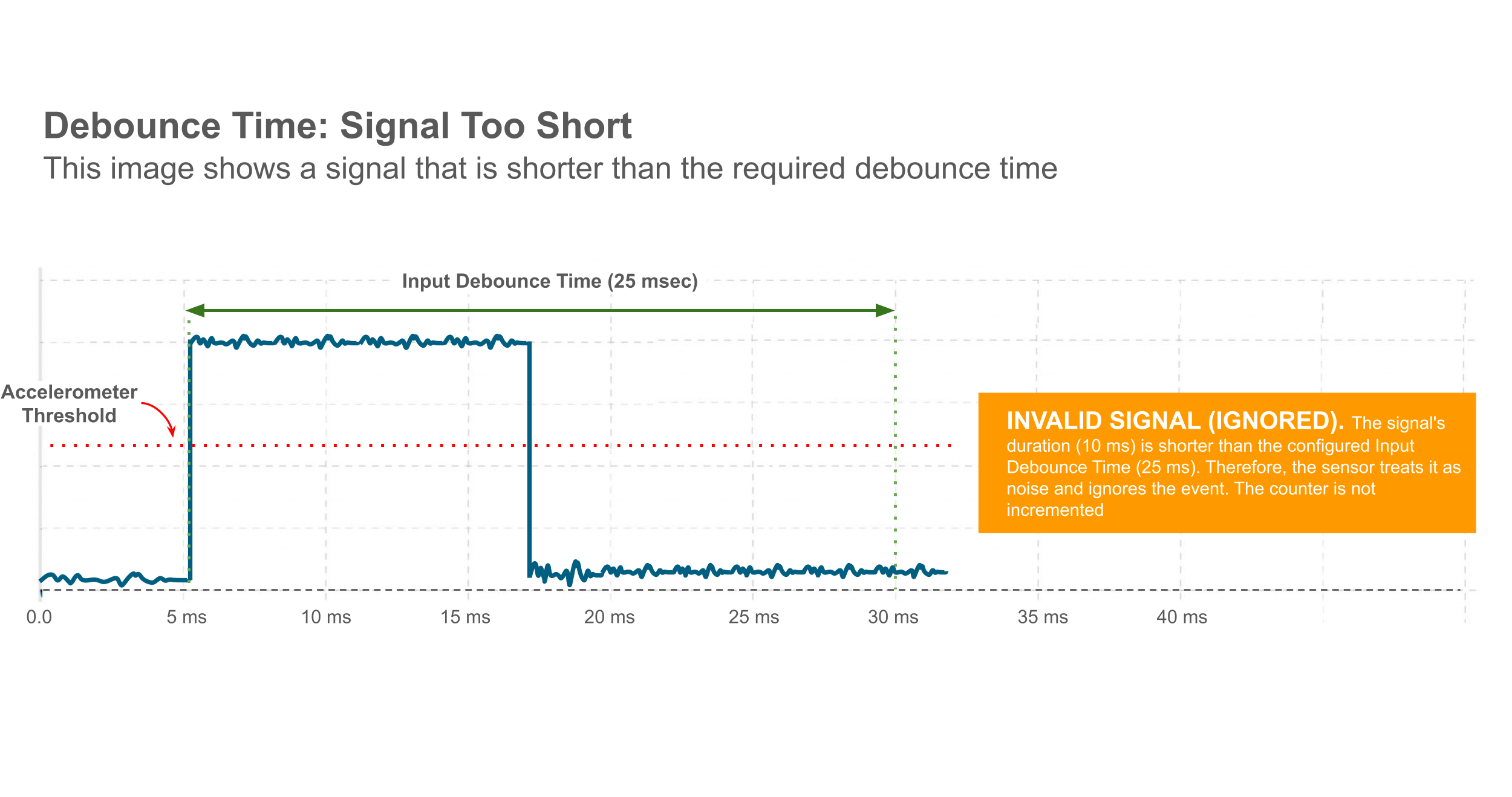

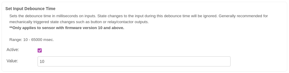

Set Input Debounce Time

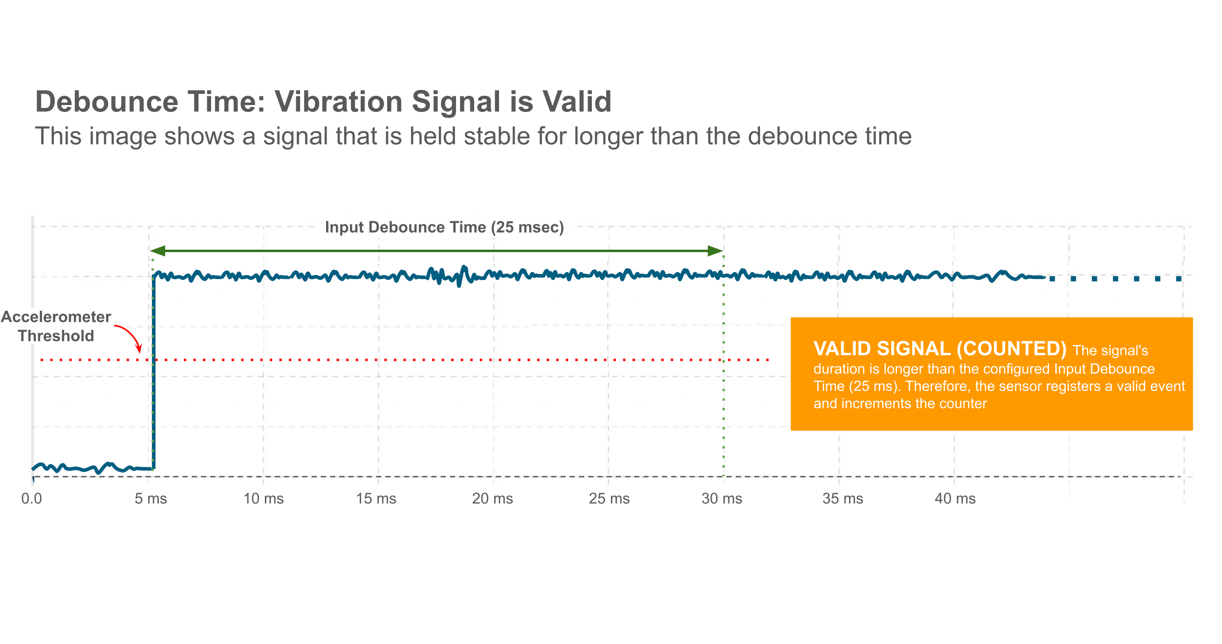

Sets the debounce time in milliseconds on inputs. State changes to the input during this debounce time will be ignored. Generally recommended for mechanically triggered state changes such as button or relay/contactor outputs.
**Only applies to sensor with firmware version 10 and above.
NCD Debounce Time
NCD Debounce Time

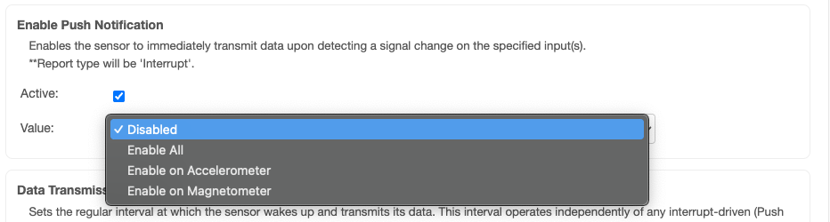

Enable Push Notification
Enables the sensor to immediately transmit data upon detecting a signal change on the specified input(s).
**Report type will be ‘interrupt’.
Options:
– Disabled
– Enable all
– Enable on Accelerometer
– Enable on Magnetometer
Set Reset Mode
This works in conjunction with Reset Timeout and Shift Time commands. It specifies which reset option the sensor will apply.
Sets the regular interval at which the sensor wakes up and transmits its data. This interval operates independently of any interrupt-driven (Push Notifications or Resets).
Note: Report type will be ‘Regular’
Reset Timeout
The sensor will reset after the specified time, and before resetting, it will set the data value. (Valid range: 60 – 65535 seconds).

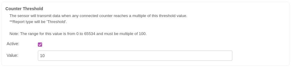

Counter Threshold
Sets an interrupt transmission threshold based on counter value. If any counter hits a multiple of the configured value a transmission will be sent by the sensor independent of the configured transmission interval configured under the Delay.
Set Shift Time 1
Based on the RTC (Real-Time Clock). Set 1 of 4 specific times (24-hour time format) in which the sensor will apply a reset. Before resetting, it will transmit its current data values.
**Report type will be ‘Shift end’.
Format: 24-hour time (e.g., 14:00 for 2 PM).

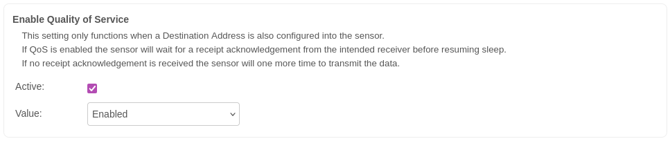

Enable Quality of Service
This setting only functions when a Destination Address is also configured into the sensor.
If QoS is enabled the sensor will wait for a receipt acknowledgement from the intended receiver before resuming sleep.
If no receipt acknowledgement is received the sensor will one more time transmit the data.

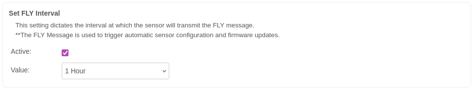

Set FLY Interval
This setting dictates the interval at which the sensor will transmit the FLY message.
Note: The FLY Message is used to trigger automatic sensor configuration and firmware updates.

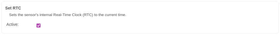

Set RTC
Sets the sensor’s internal Real-Time Clock (RTC) to the current time.

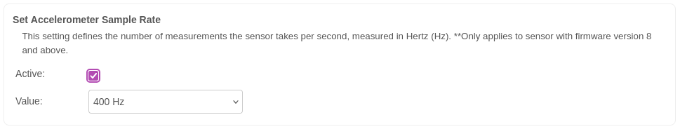

Set Accelerometer Sample Rate
This setting defines the number of measurements the sensor takes per second, measured in Hertz (HZ)
Note: Only applies to sensors with firmware version 8 and above.

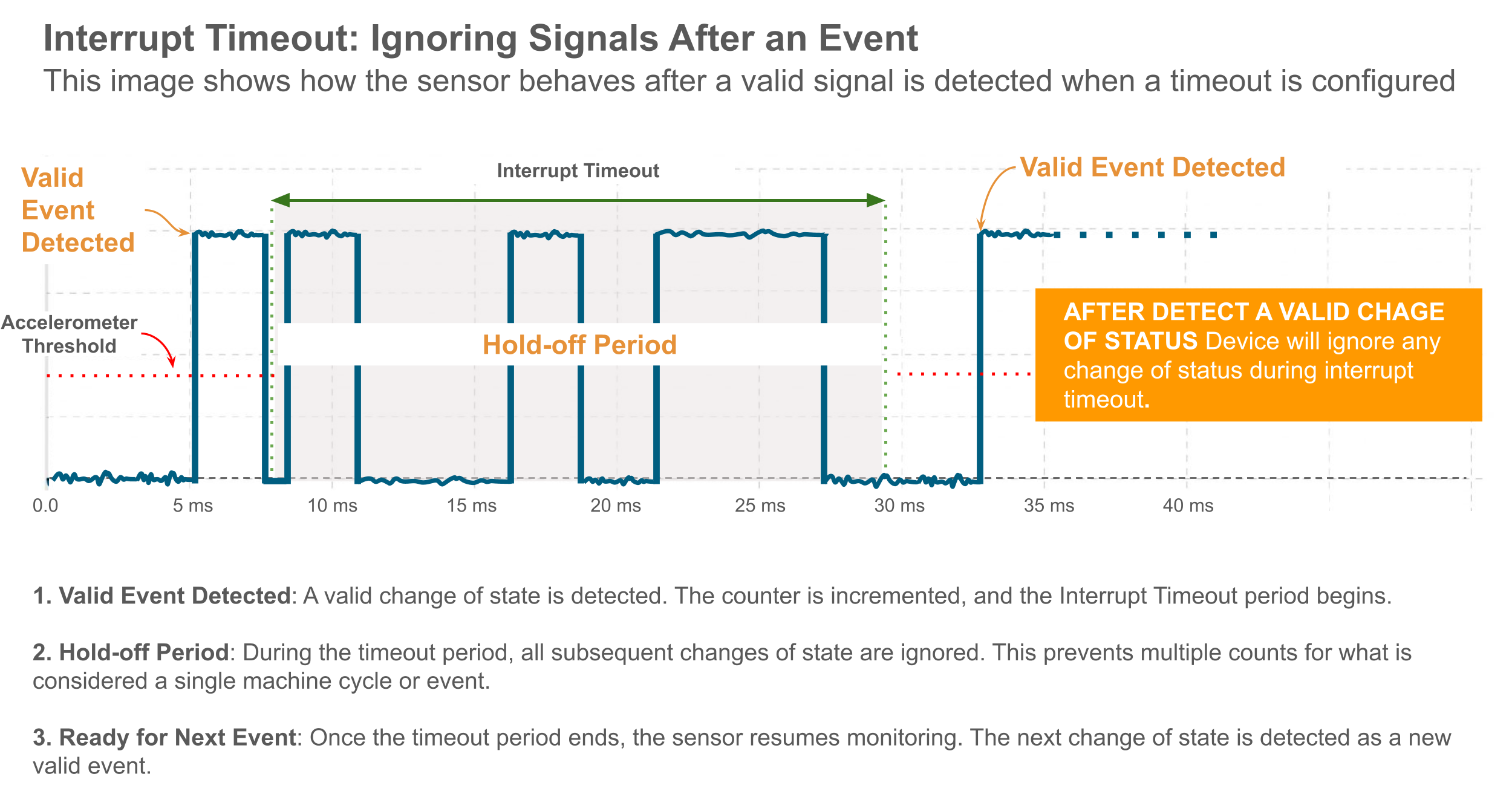

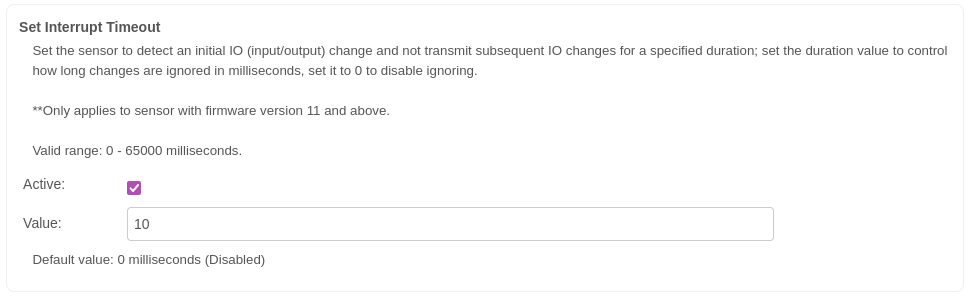

Set Interrupt Timeout
Set the sensor to detect an Initial IO (input/output) change and not transmit subsequent IO changes for a specified duration.
Set the duration value to control how long changes are ignored in milliseconds, set it to 0 to disable ignoring.
Note: Only applies for sensors with firmware version 11 and above.
Valid range: 0 – 65000 milliseconds
NCD Interrupt Timeout vs Debounce Time
