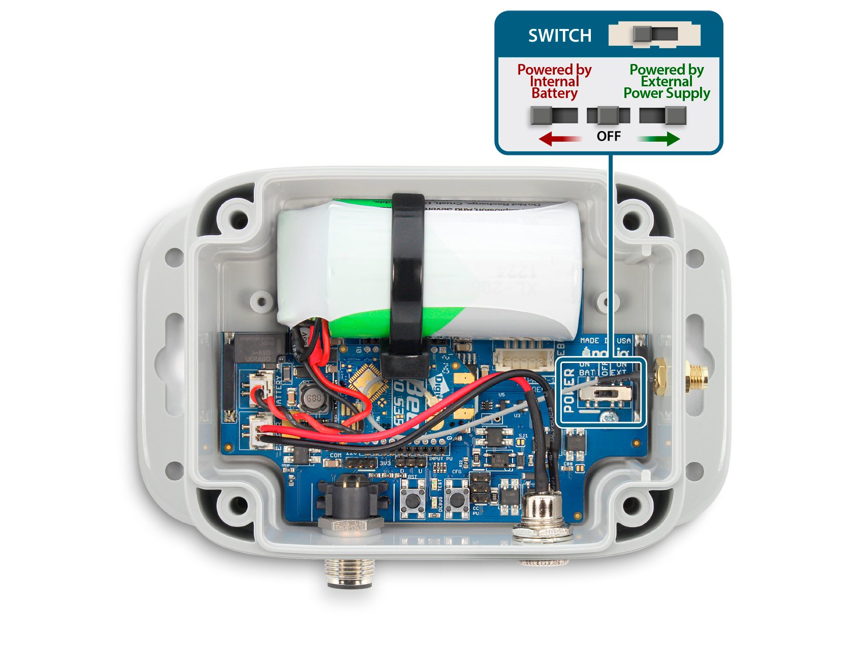

Hardware Controls
Power Switch
  • Battery Power
  • Off
  • External Power

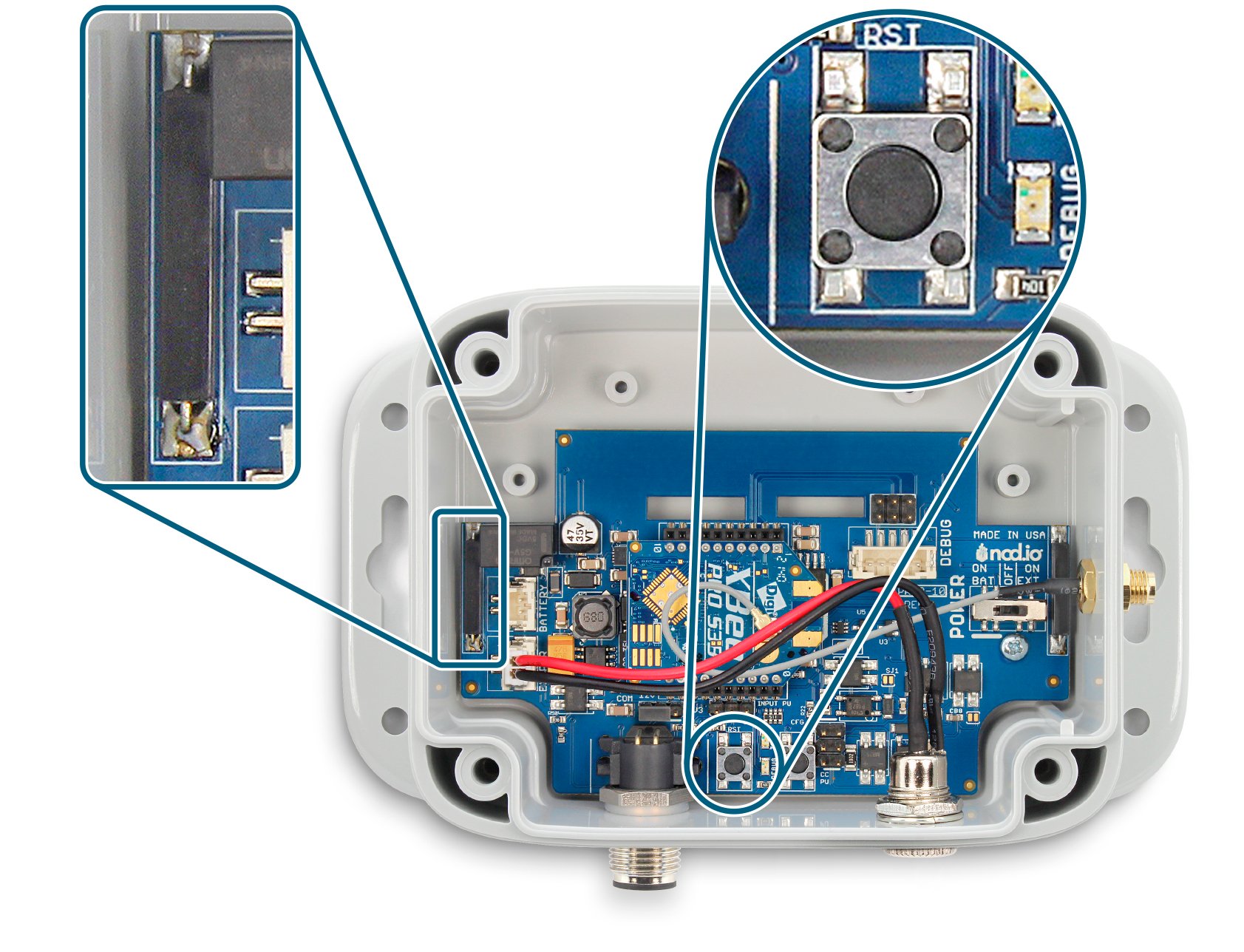

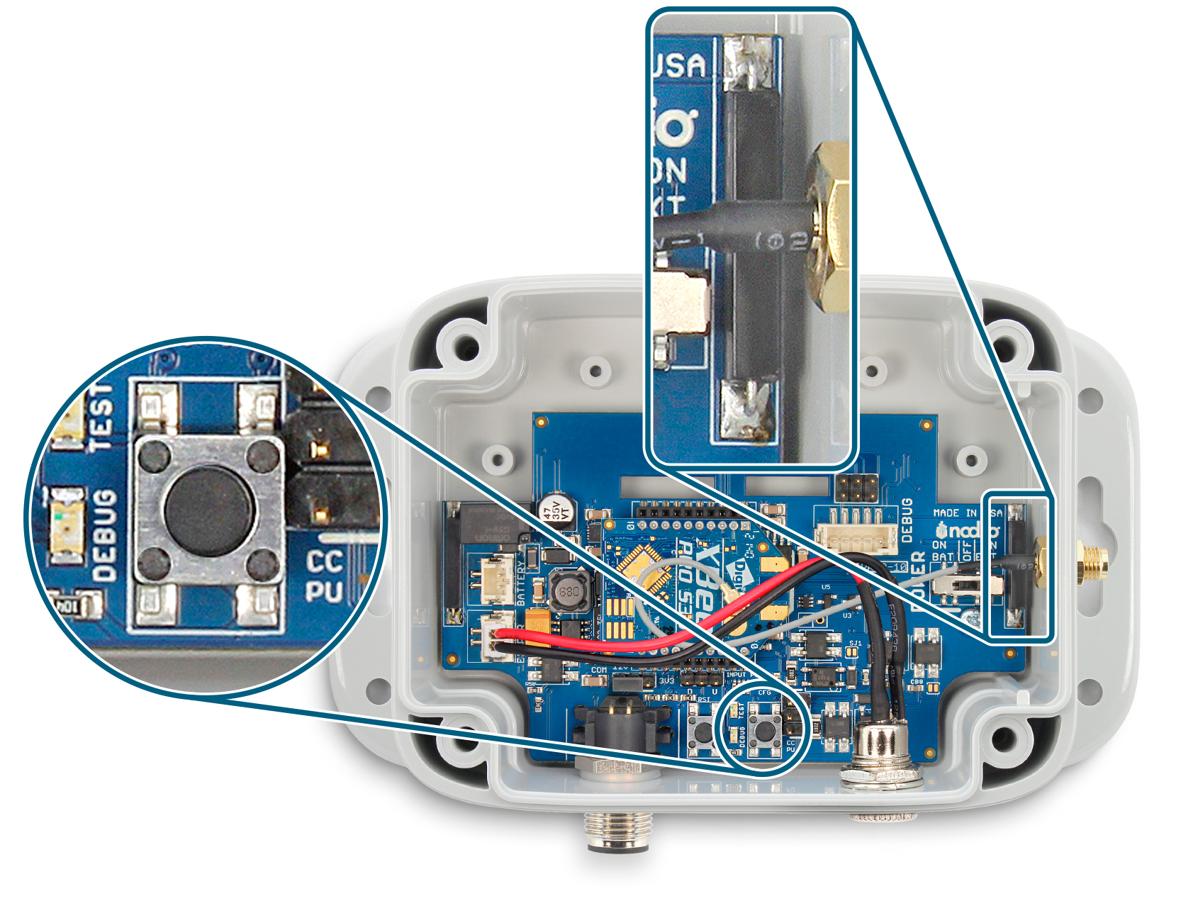

RESET Button
CFG Button

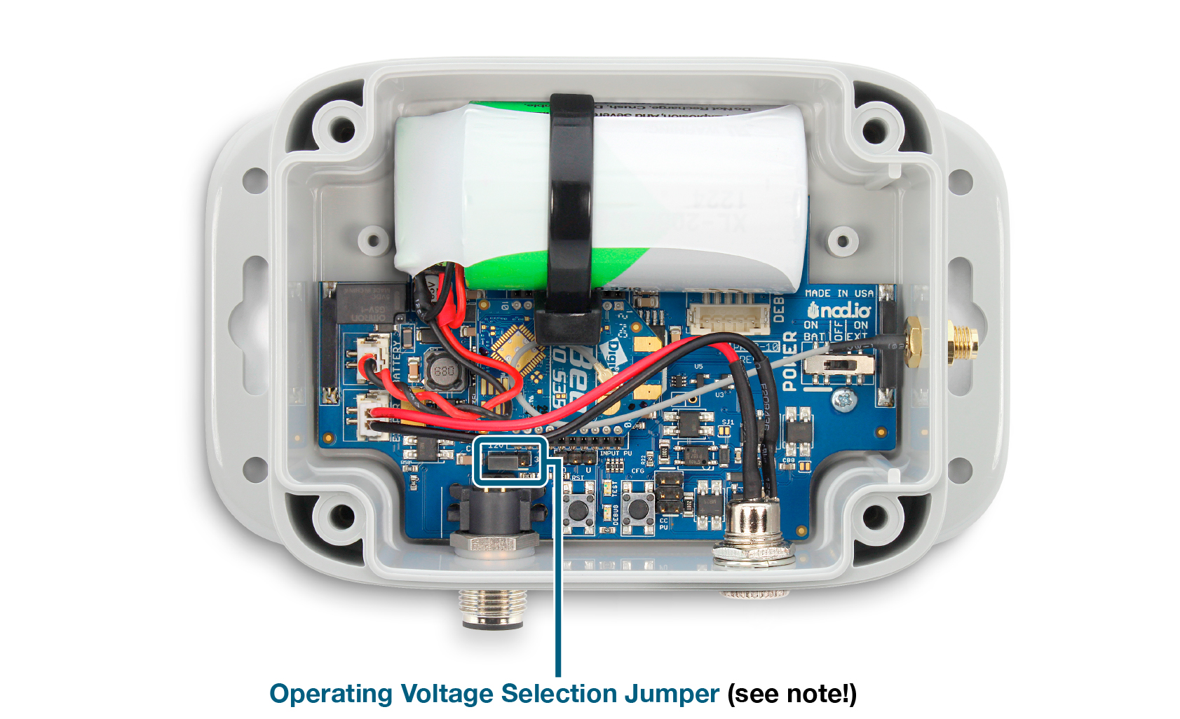

Operating Voltage Selection Jumper
This jumper is used to select between the two possible levels you can set PIN8 of the M12 connector to use. Depending on the jumper position you can have either 12V or 3V3.
  1. Bridge the left and middle pin with the jumper -> set PIN8 level to 12V
  2. Bridge the middle and right pin with the jumper -> set PIN8 level to 3V3

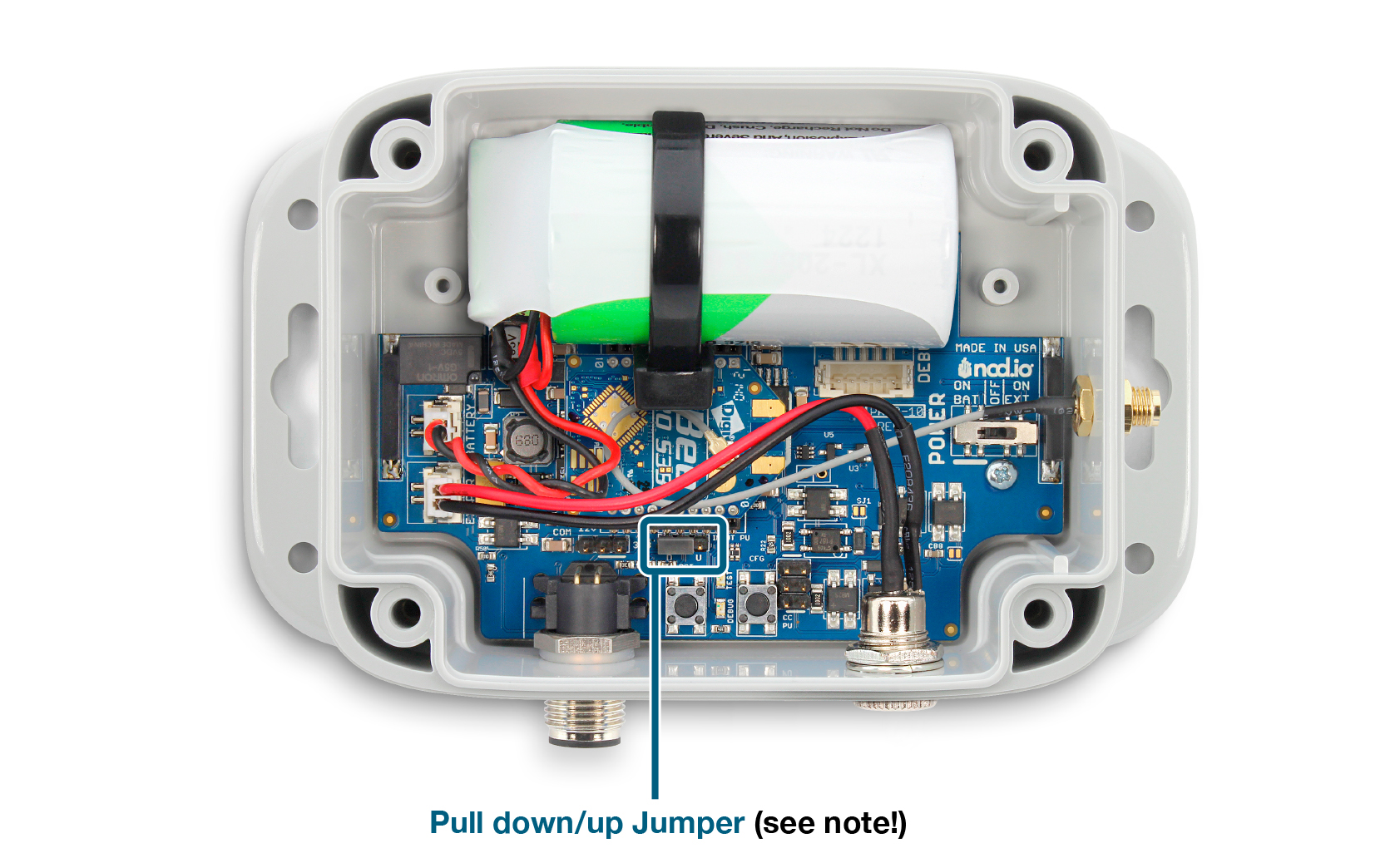

Pull down/up Jumper
This jumper is used to either Pull down or Pull up the inputs, where:
  1. Bridge the left and middle pin with the jumper -> pull inputs down
  2. Bridge the middle and right pin with the jumper -> pull inputs up

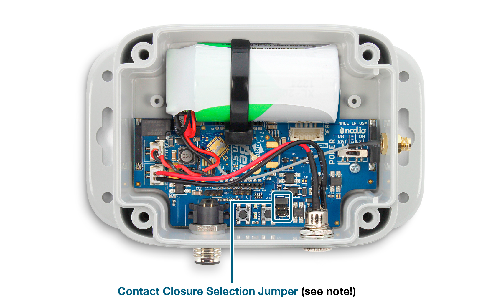

Contact Closure Selection Jumper
This jumper is used to select which pins of the M12 connector are going to be used as the inputs for attaching a contact closure sensor, where:
  1. Bridge the top two jumpers (top row) -> use PIN1 and PIN8 as Contact closure sensor inputs
  2. Bridge the middle two jumpers (middle row) -> use PIN3 and PIN8 as Contact closure sensor inputs
  3. Bridge the bottom two jumpers (bottom row) -> use PIN5 and PIN8 as Contact closure sensor input
Hardware Mode Selection
Run Mode
Configuration Mode
Factory Default/Reset
Using Buttons
  • Wait for 3-5 seconds
Using Magnetic Switches
  • Wait for 1 second

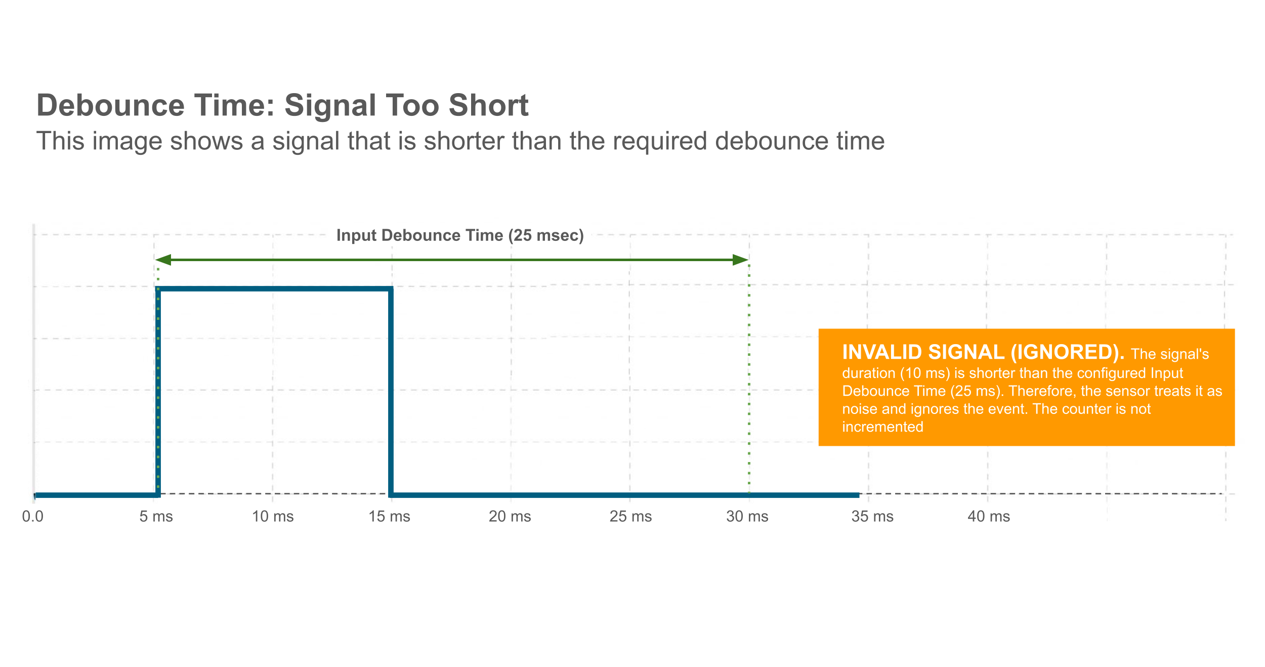

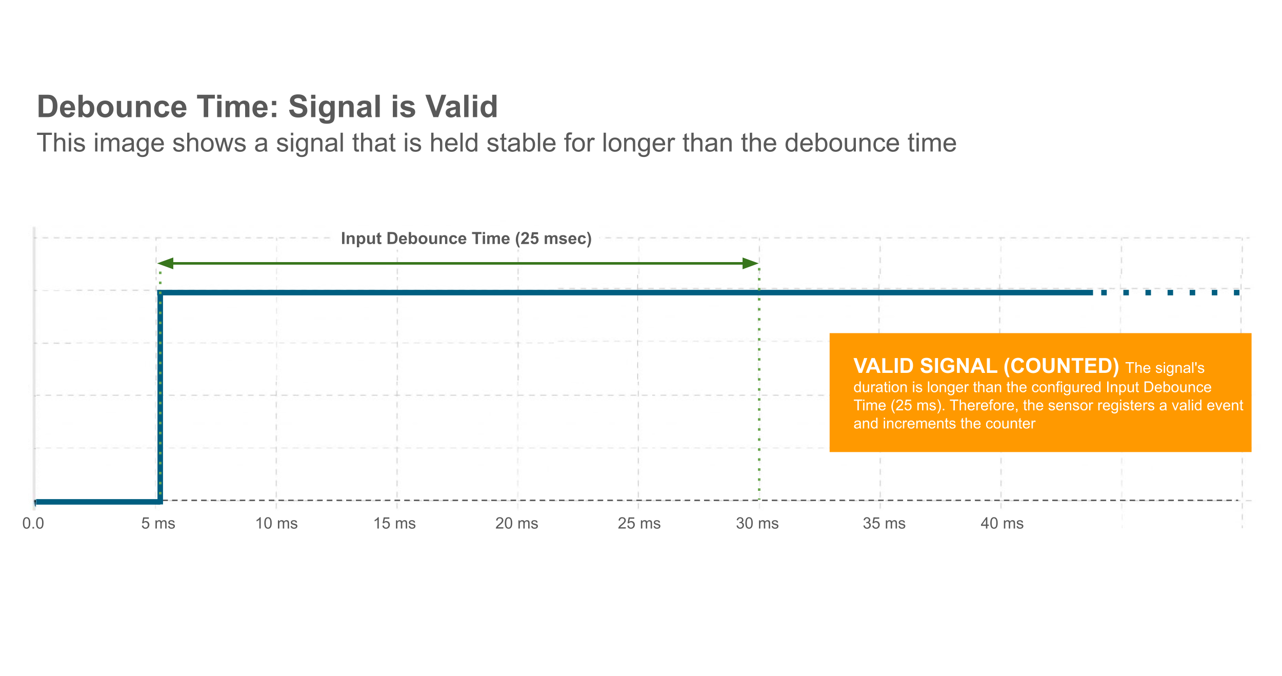

Set Input Debounce Time
Sets the debounce time in milliseconds on inputs. State changes to the input during this debounce time will be ignored. Generally recommended for mechanically triggered state changes such as button or relay/contactor outputs. This settings will apply to the Dry Contact, Wet Contact/Optical Sensor, and the Current Transducer.
NCD Debounce Time
NCD Debounce Time

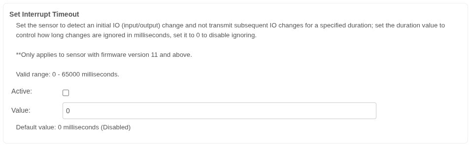

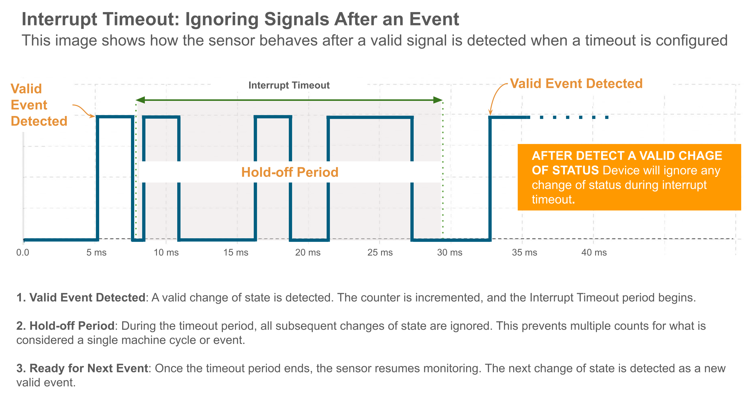

Set Interrupt Timeout​
Set the sensor to detect an initial IO (input/output) change and not transmit subsequent IO changes for a specified duration; set the duration value to control how long changes are ignored in milliseconds, set it to 0 to disable ignoring.
**Only applies to sensors with firmware version 11 and above.
Valid range: 0 – 65000 milliseconds.
Default value: 0 ms (Disabled)
NCD Interrupt Timeout vs Debounce Time
