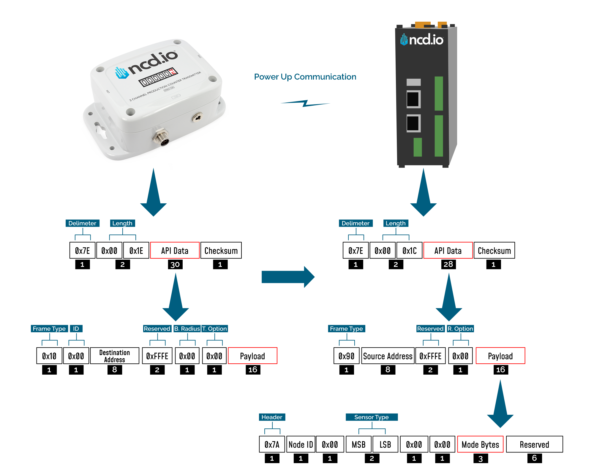

Run Mode Power Up Frame
| 7E 00 1C 90 00 13 A1 00 41 58 1C CB FF FE 00 7A 01 00 00 01 00 00 52 55 4E 00 00 00 00 00 00 0B | Example frame | |

Factory Reset Mode Power Up Frames
| 7E 00 1C 90 00 13 A1 00 41 58 1C CB FF FE 00 7A 01 00 00 01 00 00 50 55 4D 00 00 00 00 00 00 0E | Example frame | |

| 0x50554D | 3 | Mode Byte for Factory Default Mode |
| 0x0E | 1 | Checksum |

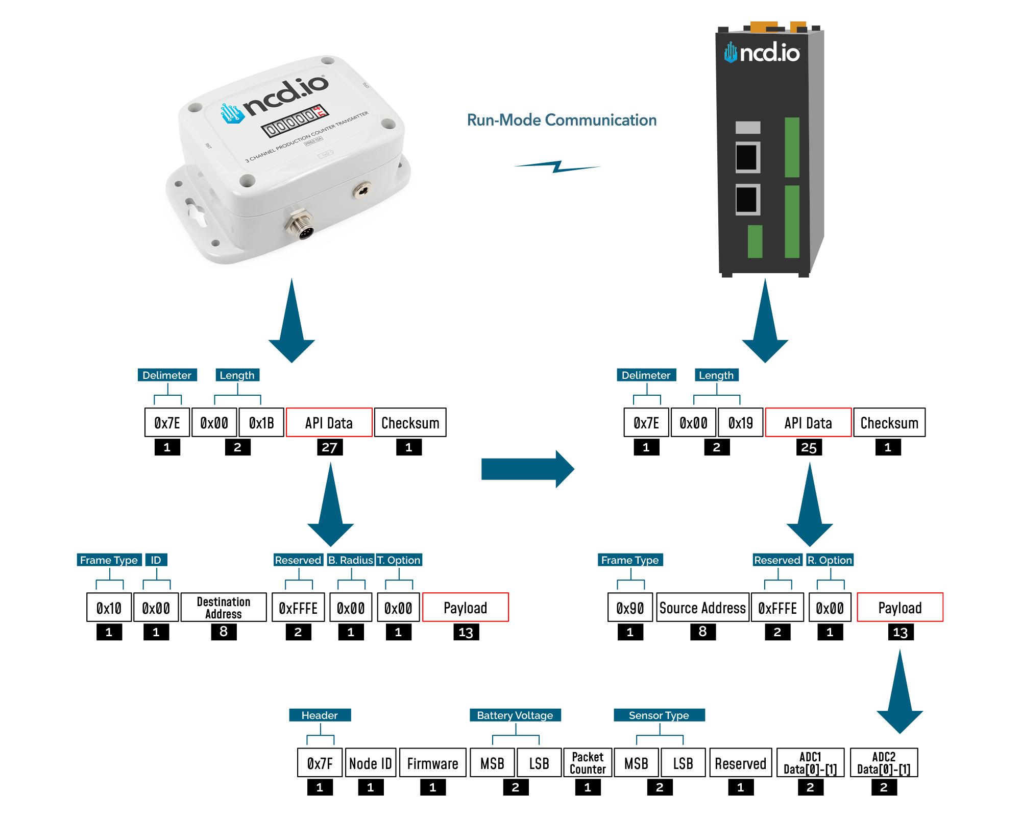

Sensor Data Frame
The detail of Payload section of packet is shown in table below:
| LSB 7 | 0x7B | Sensor Type 123 | ||
| Error/Reserved byte | 8 | 0x00 | 1 | Bit 1: Validity of Data for sensor: - 0: Data is valid - 1: Error in accessing sensor |
| Digital Input 1 Counter | 9/ Data[0] | - | 4 | Counter 1 = Data[0] << 24 | Data[1] << 16 | << Data[2] << 8 | Data[3] |

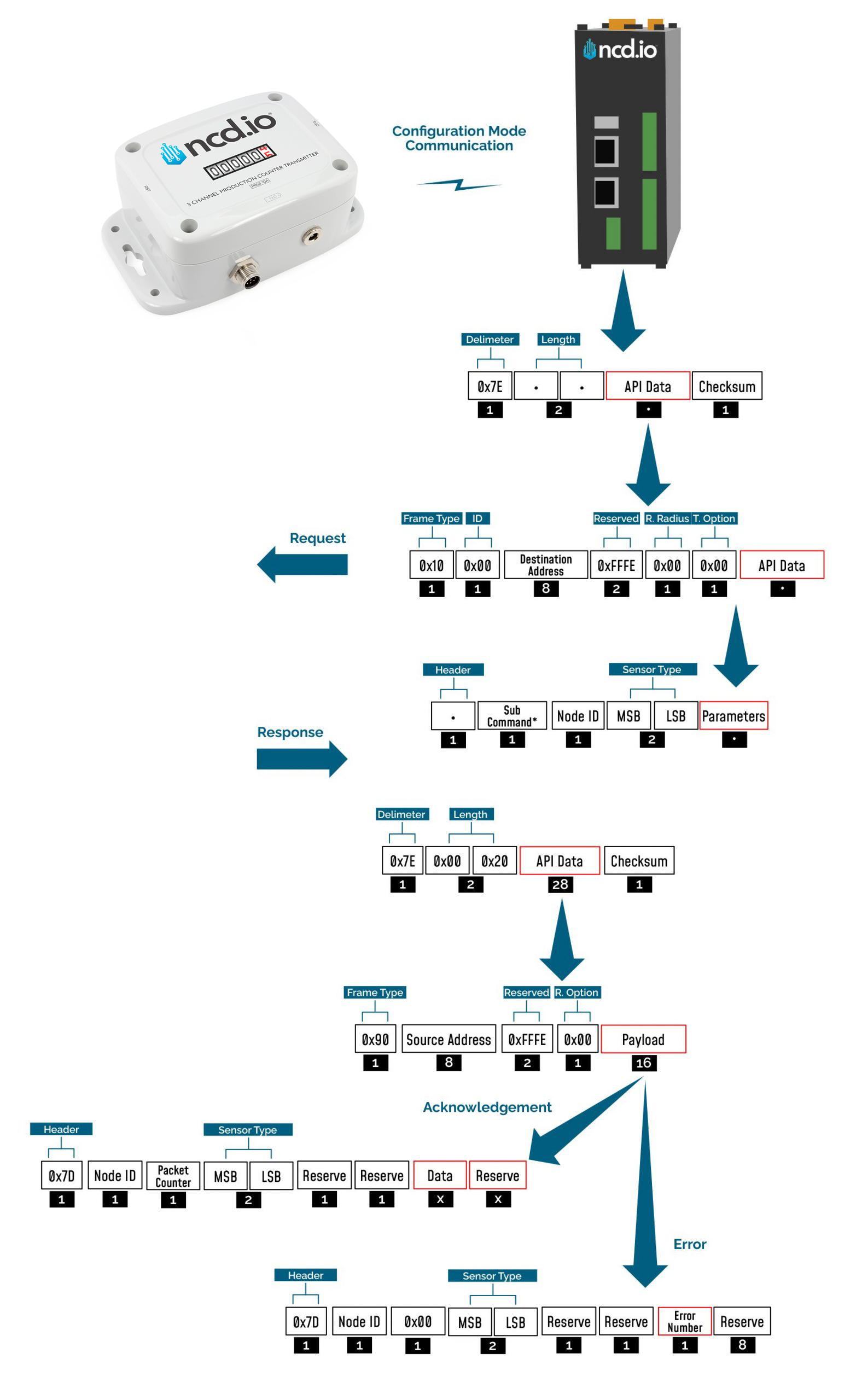

Configuration Mode Frame
Let us look at the 2 possible configuration frames to give an example:
FLY Mode Frame
| 7F 00 0A 00 00 00 00 7B 01 46 4C 59 00 00 00 00 01 32 01 01 01 00 00 03 E8 00 00 00 00 00 00 00 00 00 02 58 00 0A 63 01 0A 00 00 00 00 00 00 01 31 | Example frame | |

The following set of commands are an example on how to change some of the parameters that affect the operation of the device (these are parameters that are general in nature, more on a network protocol/device level than device specific). The relate to settings that are independent of the type of probe used. You can find them in Appendix together wit the Device/Application Specific commands.
Read Sleep Duration
Read Sleep Duration Command
00 00 00 00 00 00 FF FF
A. Sensor MAC address
00 13 A2 00 41 91 1B 83
