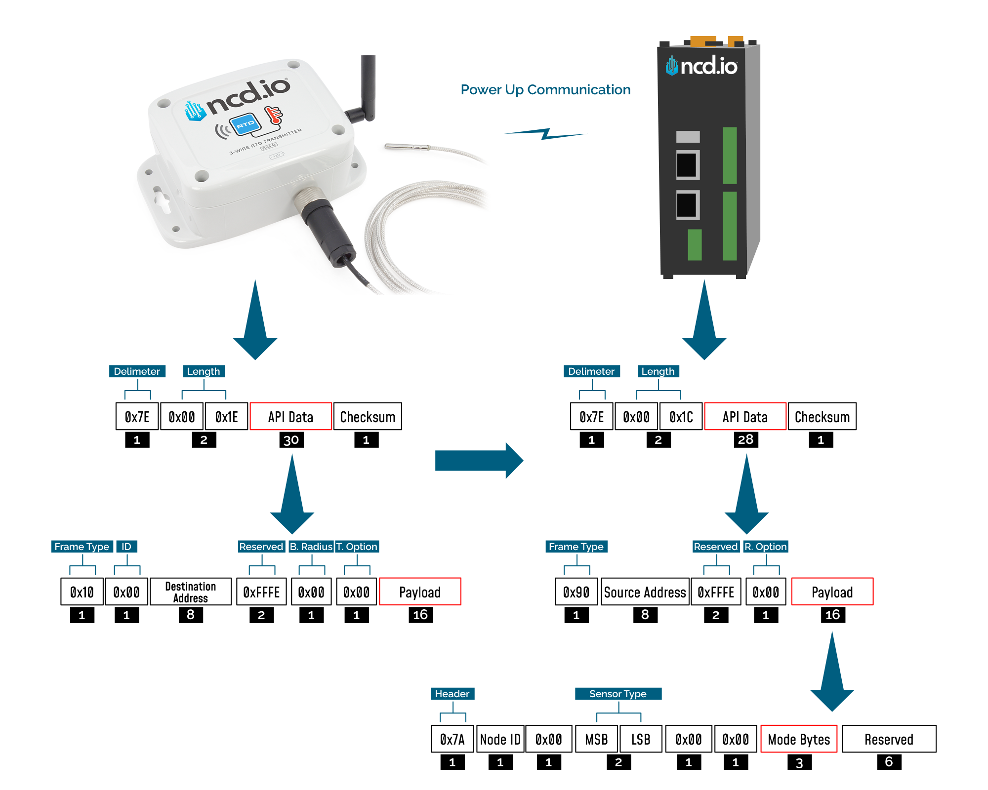

Run Mode Power Up Frame
| 7E 00 1C 90 00 13 A1 00 41 58 1C CB FF FE 00 7A 01 00 00 01 00 00 52 55 4E 00 00 00 00 00 00 0B | Example frame | |
| 0x7E | 1 | Delimiter |
| 0x001C | 2 | Length |
| 0xFFFE | 2 | Reserved |
| 0x00 | 1 | R. Option |
| 0x01 | 1 | Node ID |
| 0x00 | 1 | Separator |
| 0x0001 | 2 | Sensor Type |
| 0x0000 | 2 | Separator |
| 0x0B | 1 | Checksum |
| 7E 00 1C 90 00 13 A1 00 41 58 1C CB FF FE 00 7A 01 00 00 01 00 00 50 47 4D 00 00 00 00 00 00 1C | Example frame | |
| 0x0E | 1 | Checksum |
Factory Reset Mode Power Up Frames

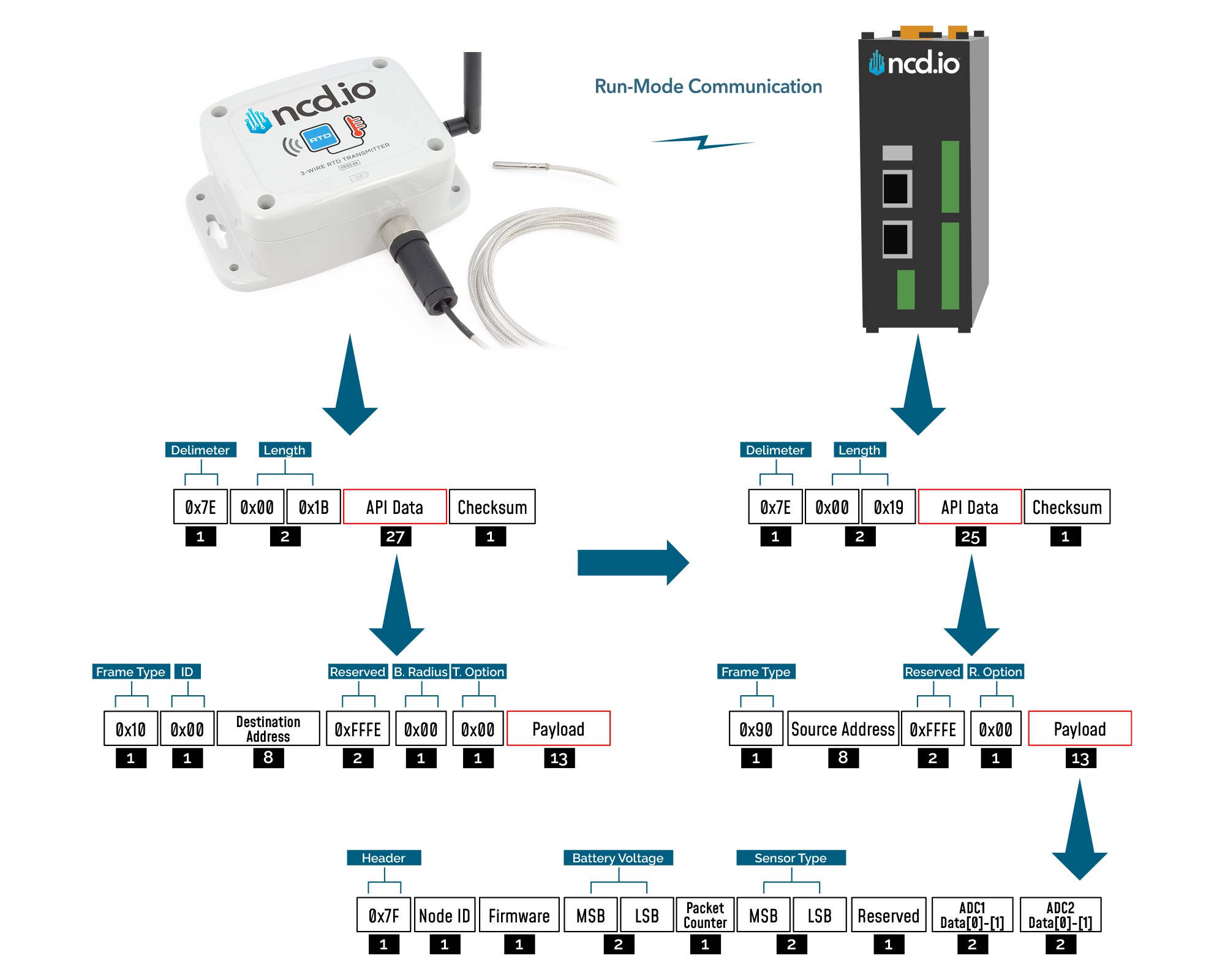

Sensor Data Frame
Data Payload
| LSB 7 | 0x27 | Sensor Type 39 | ||
| Error/Reserved byte | 8 | 0x00 | 1 | RTD Fault Status (1-bit left shifted) 0x00 - Channel data valid 0x0F - Channel data invalid Bit 0 and 1: Channel Number -0b01 - Channel 1 Bit 2: Fault Status D2 - 0: No Fault - 1: Over-voltage / under-voltage Fault Bit 3: Fault Status D3 - 0: No Fault - 1: VBIAS (FORCE- open) Fault Bit 4: Fault Status D4 - 0: No Fault - 1: VBIAS (FORCE- close) Fault Bit 5: Fault Status D5 - 0: No Fault - 1: VBIAS Fault |
| Temperature | 9/Data[0] | - | 4 | Temperature = (Data[0] << 24 | Data[1] << 16 | << Data[2] << 8 | Data[3]) / 100 |
| 10/Data[1] | ||||
| 11/Data[2] | ||||
| 12/Data[3] |

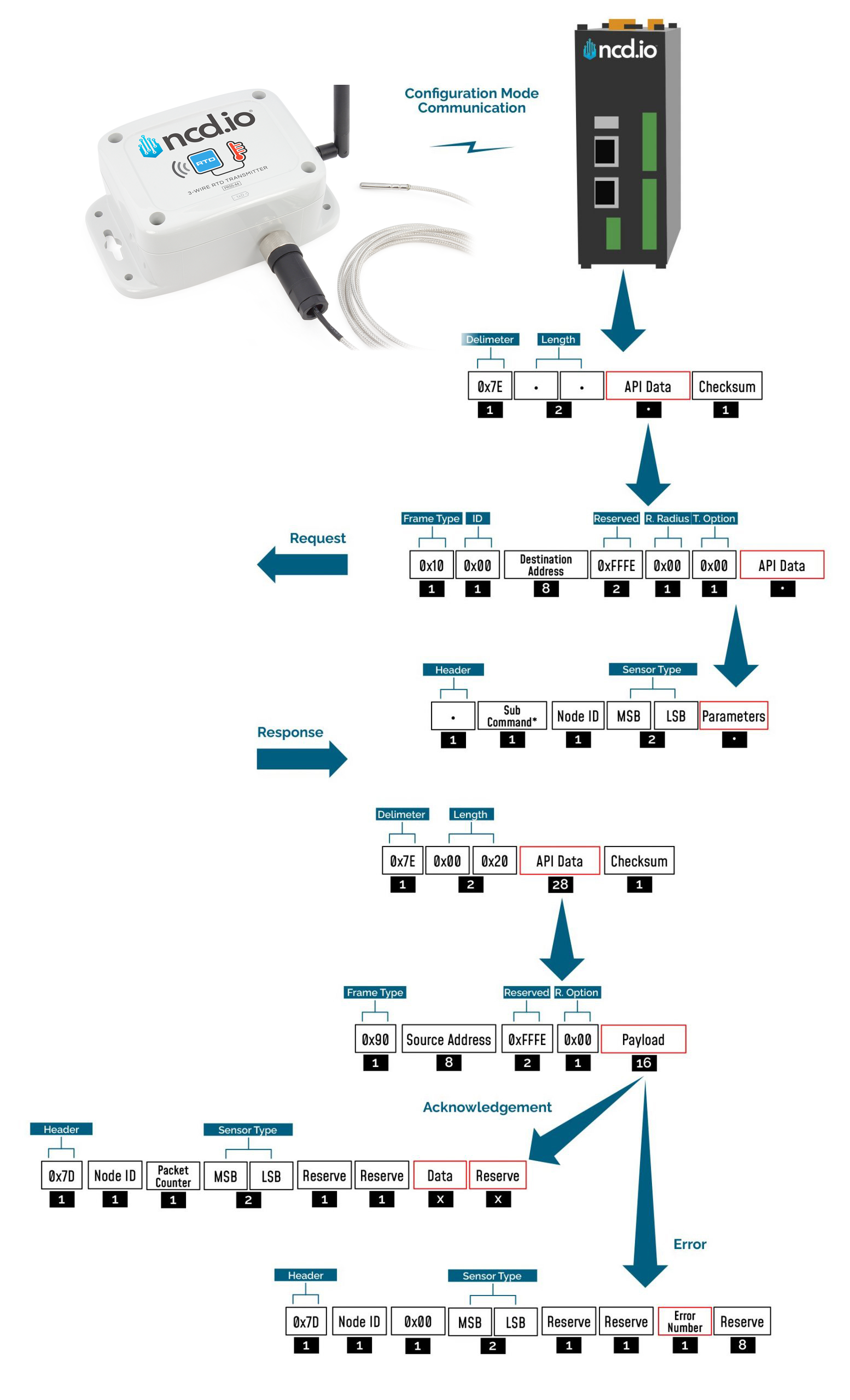

Configuration Mode Frame
The following set of commands are an example on how to change some of the parameters that affect the operation of the Machine Uptime device (these are parameters that are general in nature, more on a network protocol/device level than device specific). The relate to settings that are independent of the type of probe used. You can find them in Appendix together wit the Device/Application Specific commands.
Read Sleep Duration
Read Sleep Duration Command
00 00 00 00 00 00 FF FF
A. Sensor MAC address
00 13 A2 00 41 91 1B 83
B. Sensor Over-all Payload
C. Delay Value
This Command may be used to set the sensor node and sleep duration, note that both values are stored together using the same command. The Node ID is a user-defined value from 00 to FF that may be used to help easily identify a sensor. The Sleep Duration indicates the amount of time (in seconds) the sensor will sleep before waking up, taking a sample, sending a transmission, and going back to sleep.
In the above command, the remote device address is set to broadcast mode. The broadcast address is 00 00 00 00 00 00 FF FF, which will target all sensors in configuration mode. Change the broadcast address to the MAC address of a individual sensor to target a particular sensor with this command (this is usually not required). The Command Contains a Sensor payload which contains a Sensor Node ID and Delay value.
Payload
F7 02 00 00 00 01 00 01 2C
Note that F7 is the command header byte and 02 is the sub command for storing the Node ID and Sleep Duration.
