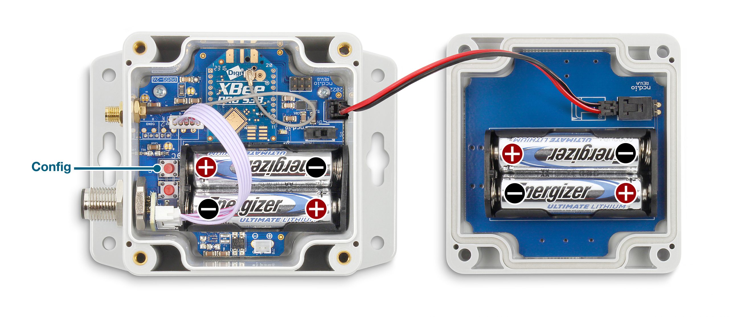

Hardware Controls

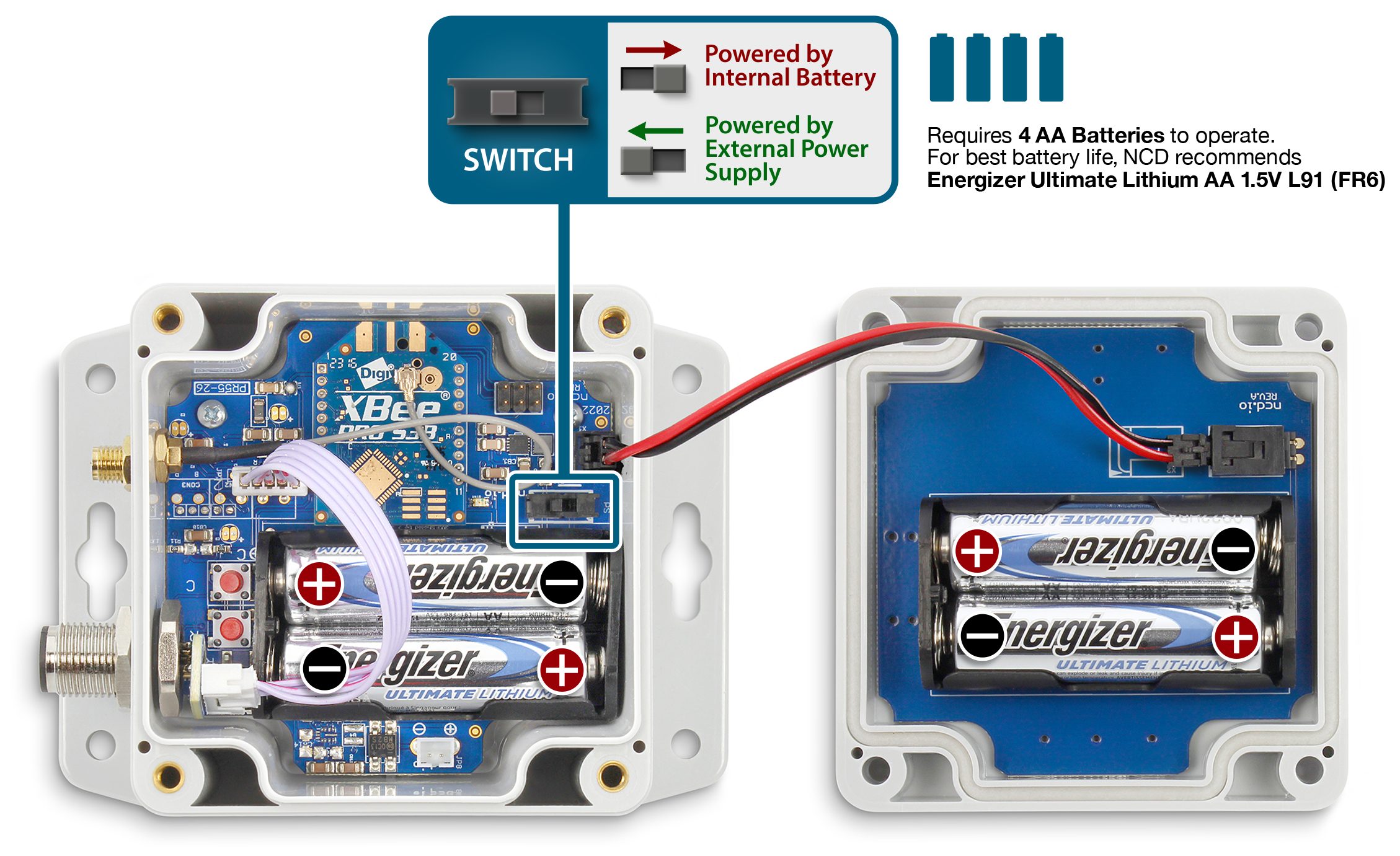

Power Switch
  • Battery Power
  • External Power

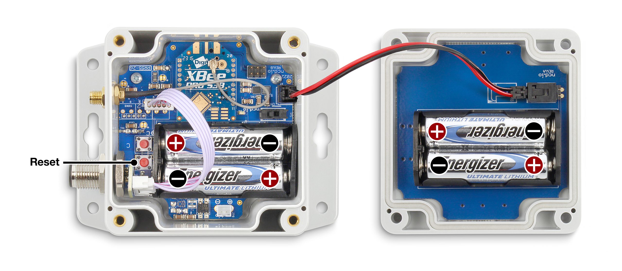

RESET Button
CFG Button
Hardware Mode Selection
Run Mode
Configuration Mode
Factory Default/Reset
Using Buttons

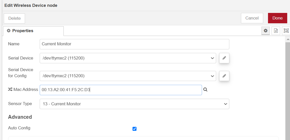

Wireless Gateway Edit Pane
  1. Name
  2. Serial Device*
  3. Serial Device Edit Icon
Click to enlarge

  • Name
    • Arbitrary name of this node
  • Serial Device*
    • For More information on the submenu the edit icon brings up see section ncd-gateway-config Nodes​
  • Serial Device for Config
  • Mac Address
  • Sensor Type*
  • Auto Config
*Required
