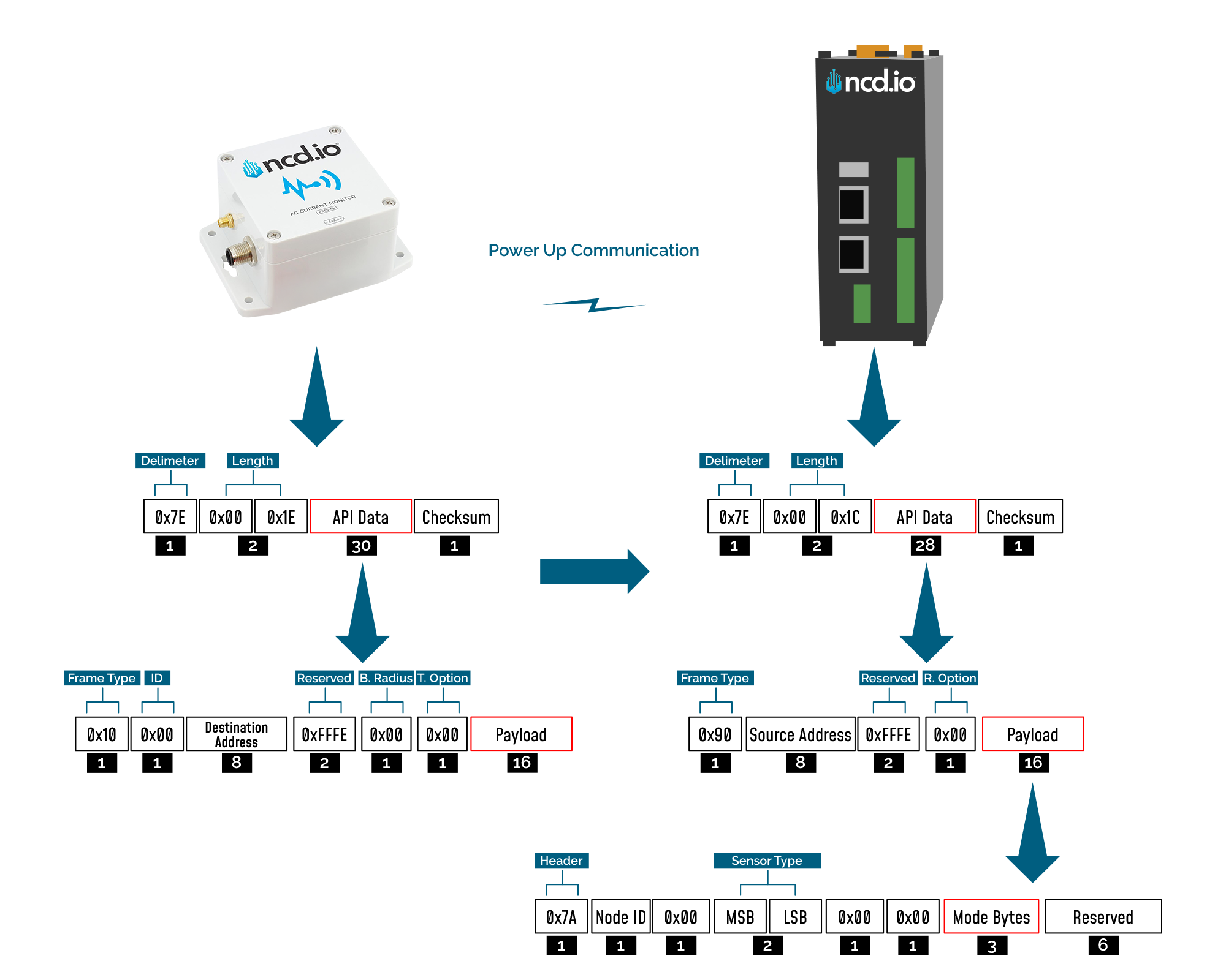

Run Mode Power Up Frame
| 7E 00 1C 90 00 13 A1 00 41 58 1C CB FF FE 00 7A 01 00 00 01 00 00 52 55 4E 00 00 00 00 00 00 0B | Example frame | |
| 0x7E | 1 | Delimiter |
| 0x001C | 2 | Length |
| 0xFFFE | 2 | Reserved |
| 0x00 | 1 | R. Option |
| 0x01 | 1 | Node ID |
| 0x00 | 1 | Separator |
| 0x0001 | 2 | Sensor Type |
| 0x0000 | 2 | Separator |
| 0x0B | 1 | Checksum |
| 7E 00 1C 90 00 13 A1 00 41 58 1C CB FF FE 00 7A 01 00 00 01 00 00 50 47 4D 00 00 00 00 00 00 1C | Example frame | |
| 0x0E | 1 | Checksum |

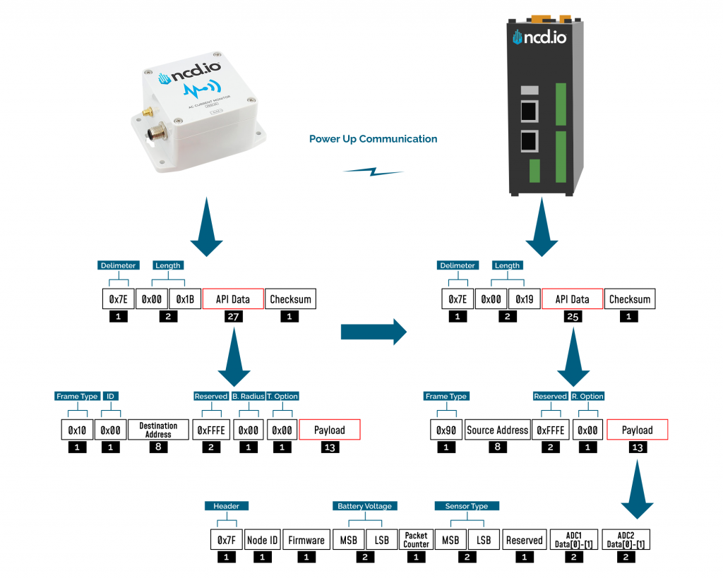

Sensor Data Frame
The detail of Payload section of packet is shown in table below:
| Frame Field | Offset (Payload section) | Fixed Value (if any) | Description |
| Header | 0 | 0x0F | Header to differentiate various types of packets |
| Node ID | 1 | 0x00 (Factory Default) | Node ID to differentiate up to 256 nodes in a network. User configurable values |
| Firmware | 2 | 01 | Used to determine firmware version programmed in the device |
| Battery Voltage | MSB 3 | 03 | Battery Voltage = 0.00322*(03*FF+FE) |
| LSB 4 | FE | Battery Voltage = ((Battery Voltage MSB x 256) + Battery Voltage LSB) x 0.00322 V | |
| Packet Counter | 5 | - | It is an 8-bit counter that increments with each packet transmission. It can be used to detect missing packets |
| Sensor Type | MSB 6 | 0x00 | Two bytes to determine sensor type. It can be used in conjunction with Node ID to create sensor networks of up to 256 nodes for a single type of sensor and multiple such networks can coexist and can be differentiated in processing software on PC end. |
| LSB 7 | 0x0D | Sensor type 13 | |
| Error/Reserved byte | 8 | 0x00 | For future use |
| Sensor Data | MSB 9/ Data[0] | - | Current data for Sensor 1 |
| 10/ Data[1] | - | Current (unsigned) – mA | |
| 11/ Data[2] | - | Current (mA) = ((Datata[0]<<16)+(Datata[1]<8)+Data[2])/1000 | |
| Reserved | - |

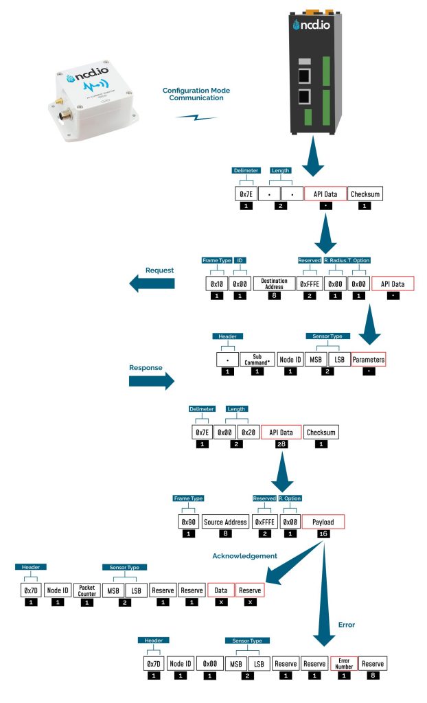

Configuration Mode Frame
The following set of commands are an example on how to change some of the parameters that affect the operation of the device (these are parameters that are general in nature, more on a network protocol/device level than device specific). The relate to settings that are independent of the type of probe used. You can find them in Appendix together wit the Device/Application Specific commands.
Read Sleep Duration
This command may be used to read the sensor sleep duration. The sleep duration determines how frequently the sensor wakes up and send sensor data. The interval is set in seconds. Short intervals will drain the battery faster while longer intervals will provide a very long battery life.
Read Sleep Duration Command
00 00 00 00 00 00 FF FF
When sending this command to a particular sensor, replace the MAC address of the sensor. Again, the sensor MUST be in configuration mode.
