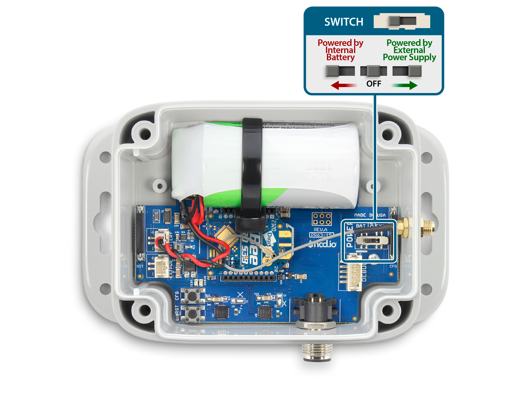

Hardware Controls
Power Switch
  • Battery Power
  • Off
  • External Power

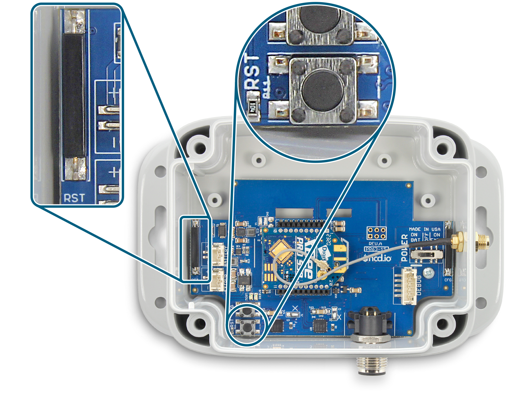

RESET Button

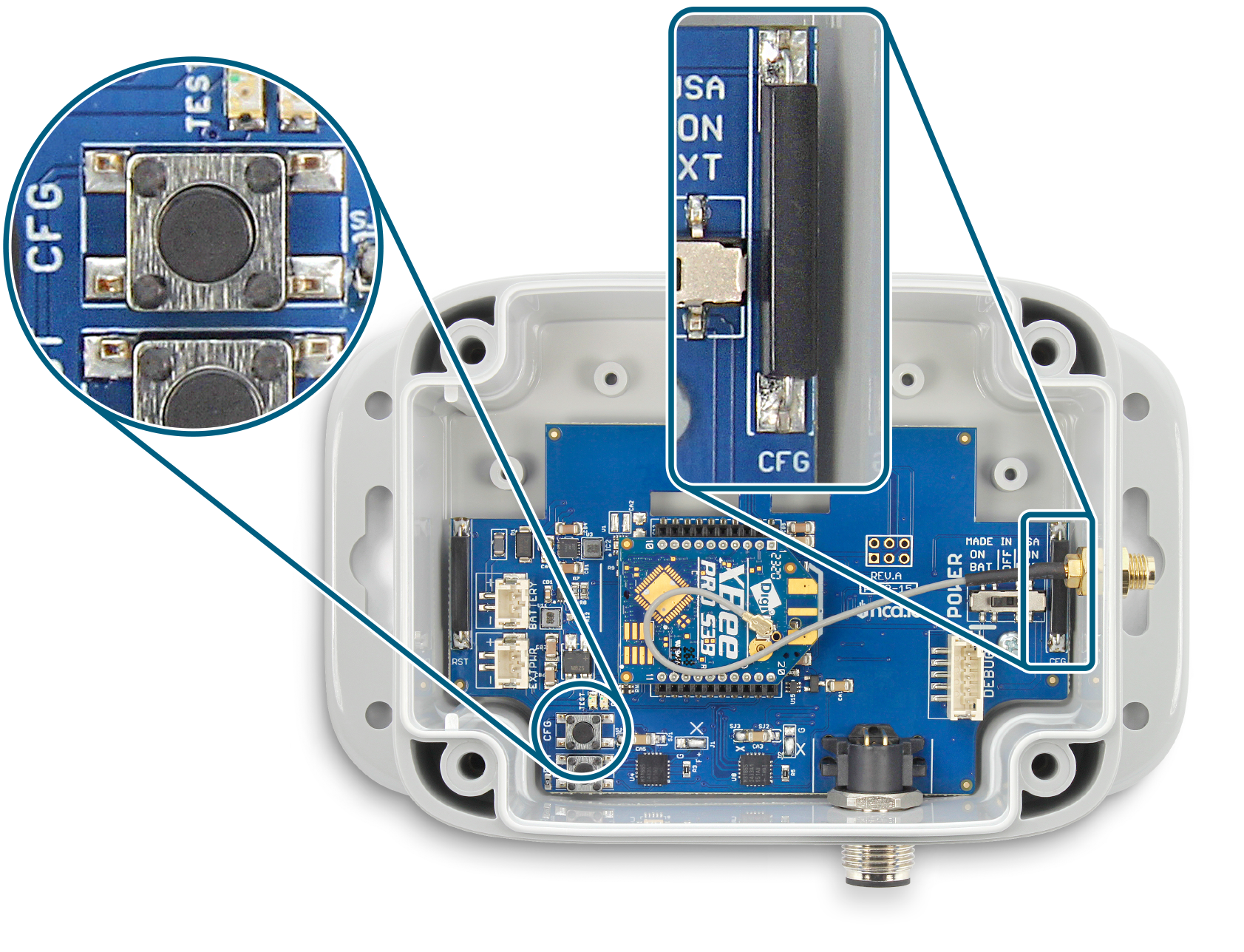

CFG Button

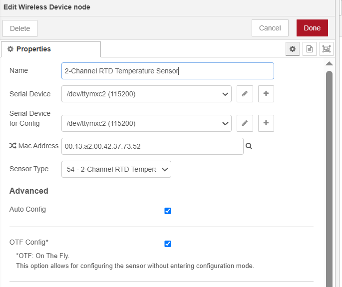

  • Name
    • Arbitrary name of this node
  • Serial Device*
    • For More information on the submenu the edit icon brings up see section ncd-gateway-config Nodes​
  • Serial Device for Config
  • Mac Address
  • Sensor Type*
  • Auto Config
  • OTF Config
    • Checking the box next to this field AND having Auto Config checked tells Node-Red that the sensor(s) corresponding to this Wireless Device node should be configured when a FLY message is detected
*Required

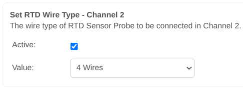

Set RTD Wire Type - Channel 2
The wire type of RTD Sensor Probe to be connected in Channel 2.

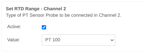

Set RTD Range - Channel 2
Type of PT Sensor Probe to be connected in Channel 2.

OTF/Automatic Configuration

  2. Import
  5. Expand Type 54 – 2-Channel RTD Temperature Sensor
  8. Click on Import
