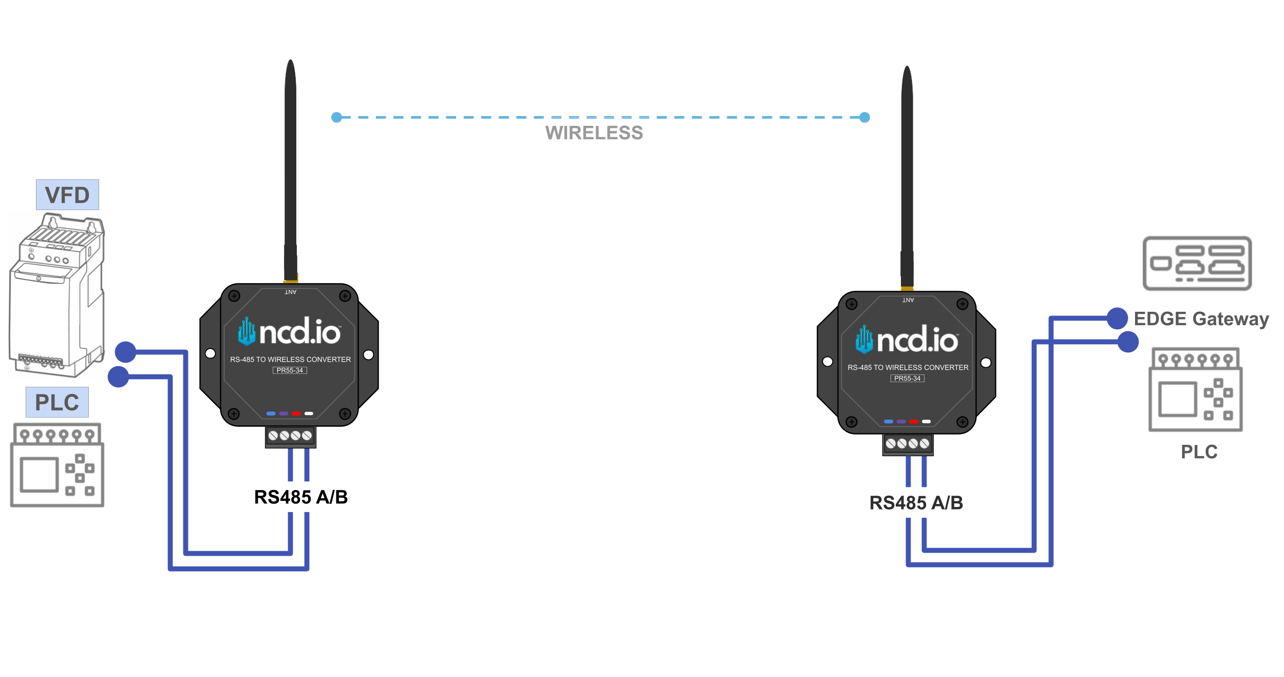

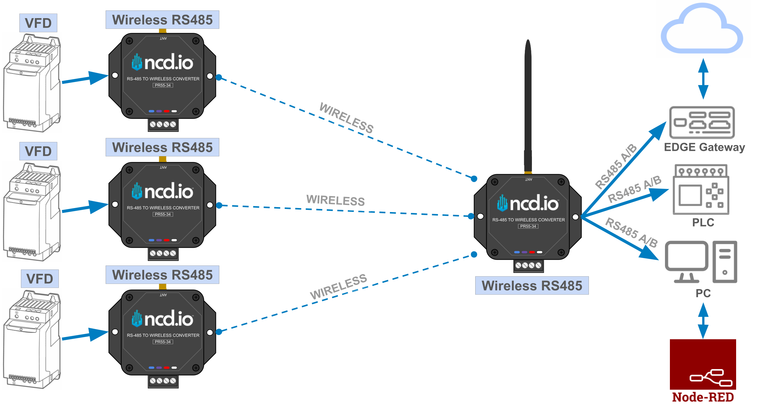

1. The "Wireless Cable": RS485 to RS485 Bridge
Best for: Replacing long, expensive, or impossible cable runs between two serial devices.
If you have two devices (like a PLC and a remote VFD) that need to talk to each other via RS485, you would normally have to run a twisted-pair cable between them. With two PR55-34 units, you can “cut the cord.”
RS485 Wireless Converter
Replace RS485 wired connections example
NCD RS485 Wire Replacement Diagram Example
Replace RS485 Wired Connections Example
How it works: One unit connects to Device A, and the second unit connects to Device B. The wireless link acts as a transparent virtual cable.
The Benefit: You save on conduit, labor, and troubleshooting physical wire breaks. With a long Wireless range, it reaches where cables can’t.

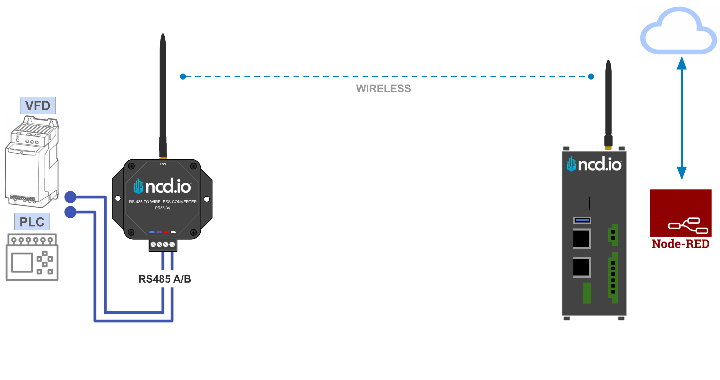

2. The Modernizer: Making Legacy RS485 Devices Wireless
Best for: Bringing old sensors or Modbus RTU devices into a modern Industrial IoT protocol.
Do you have a 10-year-old RS485 flow meter that isn’t wireless? The PR55-34 can “wrap” that legacy device in a wireless bubble, allowing it to communicate with a central NCD Gateway.
How it works: You connect the PR55-34 to your legacy sensor. From your central computer (using Node-RED), you send a Modbus command wirelessly. The PR55-34 receives it, passes it to the sensor, grabs the response, and beams it back.
RS485 Wireless Converter with Edge Device
NCD Wireless Converter device wireless
RS485 Wireless Converter with Gateway
Logic Handling: The data transmission is conditioned by the connected RS485 device. It acts as a reactive “client-server” flow, perfect for request-response protocols like Modbus.

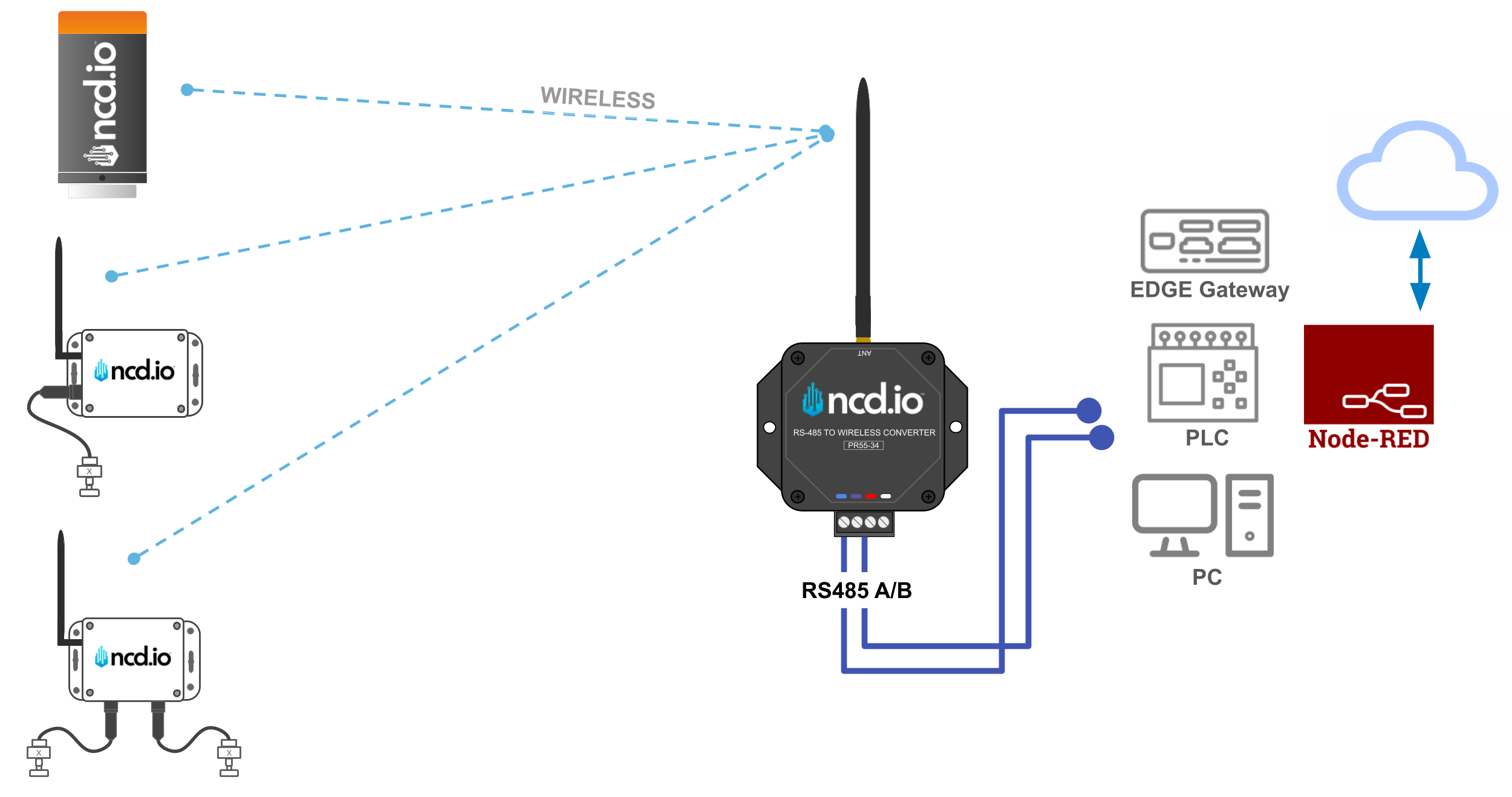

3. The Access Point: Bringing NCD Sensors to Wired Systems
Best for: Integrating NCD Wireless Sensors into an existing PLC, SCADA, or Edge Gateway.
If you already have a control system that uses RS485 (like a Siemens PLC or an industrial PC), you can use the PR55-34 as a “receiver” for the entire NCD wireless sensor ecosystem.
NCD Integrating Sensors
Integrating NCD Wireless Sensors into an existing RS485 System
How it works: Connect the PR55-34 to your PLC’s RS485 port. When an NCD wireless vibration or temperature sensor broadcasts its data, the PR55-34 captures it and outputs the API bytes directly into your controller.

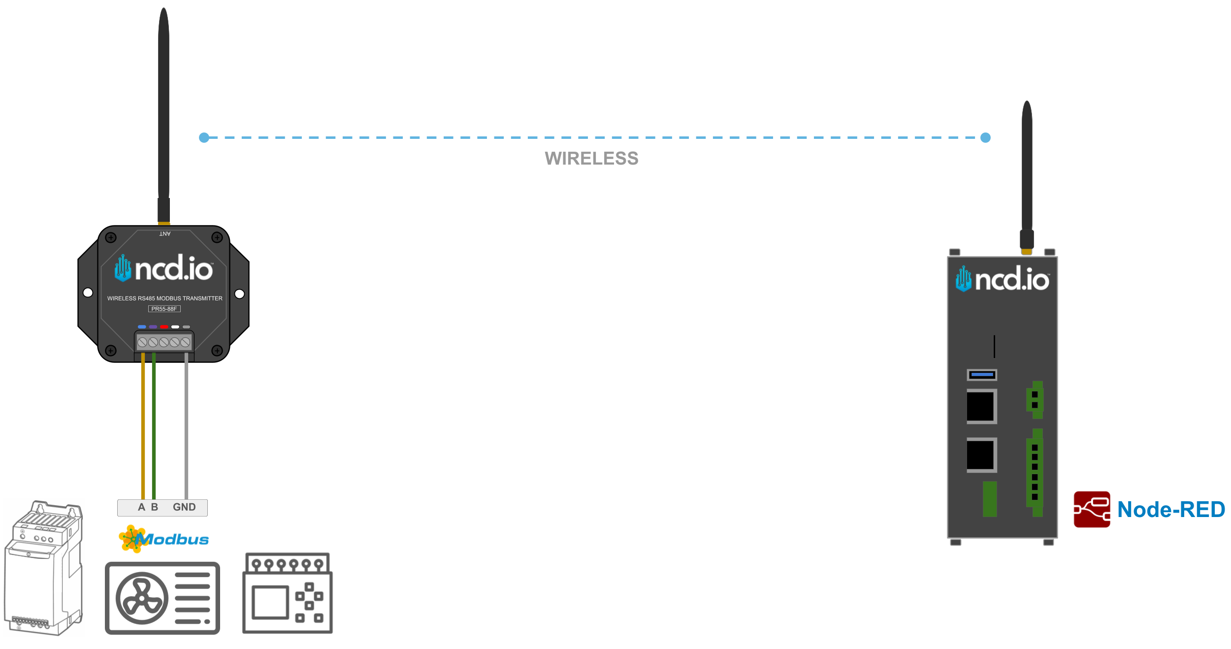

1. The Proactive Poller: How it Works
The PR55-88F is designed to be the “Master” of an RS485 loop. Instead of waiting for a command from your gateway, it follows a pre-configured schedule. To get started, you’ll connect the PR55-88F to your RS485 device and use Node-RED to set the Baud Rate, Slave ID, and the specific Registers you want to read. Once those settings are saved into the device’s internal memory, it will run autonomously—no further “orders” from the gateway required.
NCD Modbus Transmitter Architecture
The Operational Cycle:
  • Wake Up: The device wakes up from standby mode based on a user-defined interval (e.g., every 15 minutes).
  • Request: It automatically sends a Modbus RTU command (Function Code 03 or 04) to your connected RS485 device.
  • Listen: It waits for the RS485 device to respond with the register data.
  • Transmit: It packages that Modbus data into a standard NCD wireless packet and beams it to your Gateway.
  • Standby: It goes back into standby mode until the next interval.
