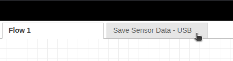

Step 6. A few nodes in the imported flow may already exist in your workspace. You should click ‘Import copy’ to avoid overwriting them. After the import is complete, a new tab will appear in your workspace. Clicking this tab will reveal the flow.
NCD USB Data logging Node-RED Flow

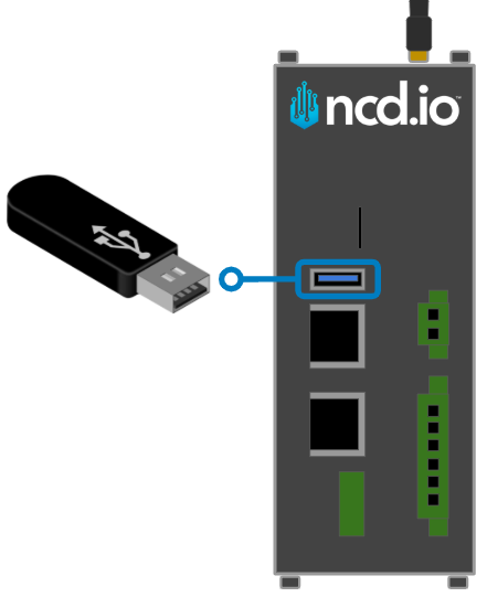

Step 3. Connect a FAT32-formatted USB drive to the Gateway’s USB Port.
NCD USB Data Logging Connect USB

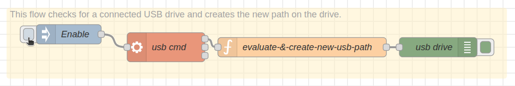

Step 4. Once a valid FAT32 USB drive is connected to the Enterprise IIoT Gateway, enable the first flow to automatically check if the system recognizes the USB drive and to create the necessary USB path.
NCD USB Data Logging flow to check USB

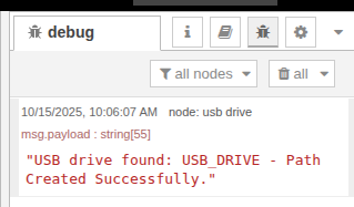

  • If the system recognizes a valid connected FAT32 USB drive, you should see the following success message in the debug window:
NCD USB Data Logging USB Drive Found Message

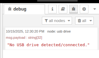

  • If the system does not recognize a valid FAT32 USB, you will see ‘No USB drive detected/connected’ in the debug window.
NCD USB Data Logging no USB Drive Connected Message

Enable (inject) node: This node allows you to manually trigger the flow to check for the USB drive and create the necessary USB path.
NCD USB Data Logging Enable Node
usb cmd node: This node executes the following command, which lists mount points, filters for those under /media/, and extracts the portion of the path that comes after:
					/media/: lsblk -o MOUNTPOINT | grep '/media/' | awk -F'/media/' '{print $2}'
NCD USB Data Logging usb command node

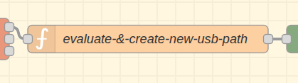

evaluate-&-create-new-usb-path node: This node checks for a connected USB drive and creates the file path on the drive.
If a valid USB drive is not connected, it sends “No USB drive detected/connected.” to the debug window.
If a valid USB drive is found, it sends “USB drive found: <usb_drive_id> – Path Created Successfully.”
NCD USB Data Logging function node

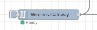

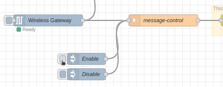

Wireless Gateway node: This is a virtual representation of the wireless protocol connected to your Gateway. It outputs all incoming data from the wireless network and all sensors on that network into the connected flows from a single entry point.
NCD Wireless Gateway node

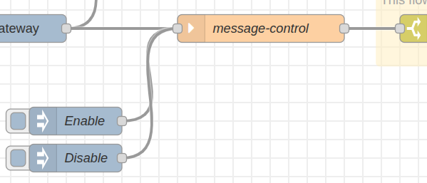

Message-control node: This node controls whether incoming sensor data flows to the next node, using the Enable and Disable inject nodes to control the flow. It displays ‘Enabled’ when data is allowed to pass and ‘Disabled’ when it is not.
NCD USB Data Logging Message control node
