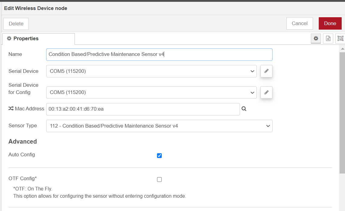

  • Fully open Node-RED library for configuration and data ingestion

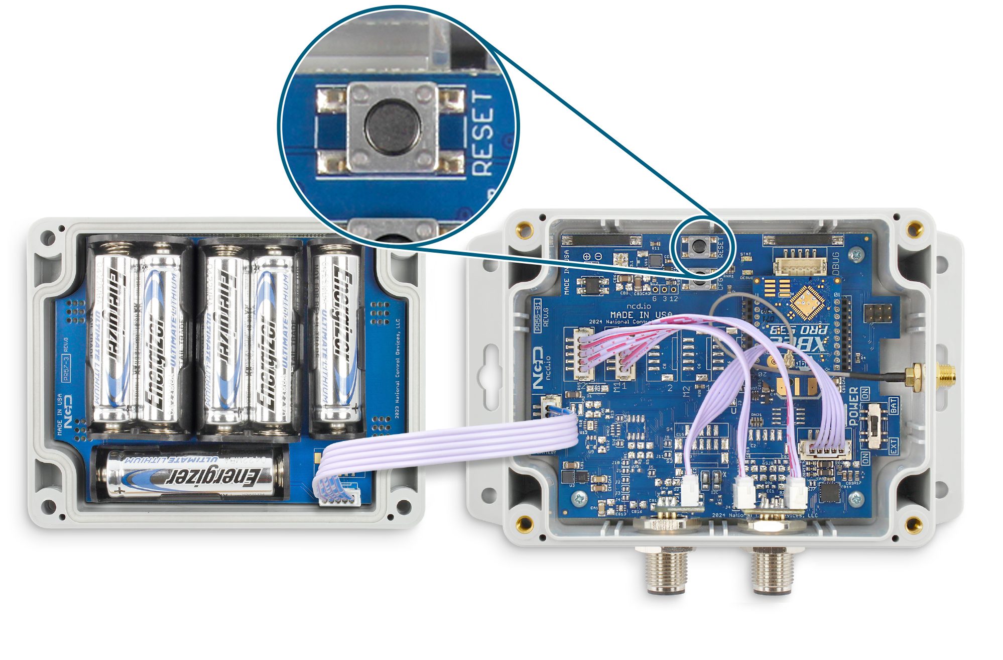

RESET Button

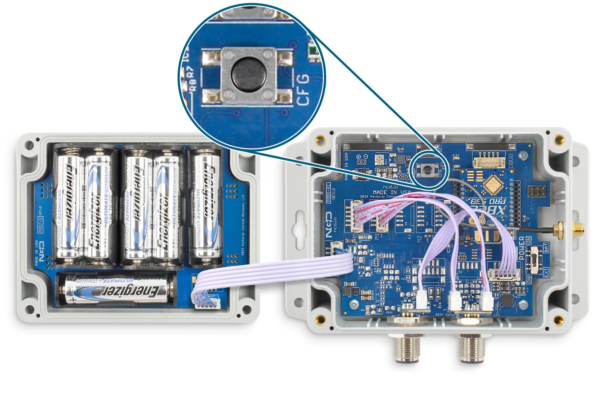

CFG Button

Configuration Mode
Factory Default/Reset
You can perform a Factory Reset by pressing and release the RESET button, wait for a second, then press and hold the CONFIGURATION button, hold the CONFIGURATION button for more than 15 seconds, release CONFIGURATION button.
Immediately after a factory reset the sensor will go into Configuration Mode in order to be reconfigured with the desired settings. To activate RUN Mode, please wait for 3-5 seconds and then press the RESET button.
Refer to the graph below for the precise timing of the CONFIGURATION button press.
  • Configuration Button Pressed and held 1 second after reset for:
    • < 2 second – device starts normally in RUN Mode
    • 2 to 15 seconds – device goes into Configuration Mode

Wireless Gateway Nodes
Ready State
Configuring State
Failed to Connect State
Connecting State
No State

  1. Name
  2. Serial Device*
  3. Serial Device Edit Icon

  • Name
    • Arbitrary name of this node
  • Serial Device*
    • For More information on the submenu the edit icon brings up see section ncd-gateway-config Nodes​
  • Serial Device for Config
  • Mac Address
  • Sensor Type*
  • Auto Config
  • OTF Config
    • Checking the box next to this field AND having Auto Config checked tells Node-Red that the sensor(s) corresponding to this Wireless Device node should be configured when a FLY message is detected
*Required

Factory Reset Sensor
  1. Factory Reset the Sensor
    • Factory reset by pressing and release the RESET button, wait for a second, then press and hold the CONFIGURATION button, hold the CONFIGURATION button for more than 15 seconds, release CONFIGURATION button, then Wait for 3-5 seconds, finally press and release the RESET button.

We have built an example dashboard to display the sensor data from a single Vibration Sensor. You can find it by importing it directly into Node-Red.
  2. Import
  5. Expand Type 112 – Condition Based Predictive Maintenance Sensor Gen4
  8. Click on Import
