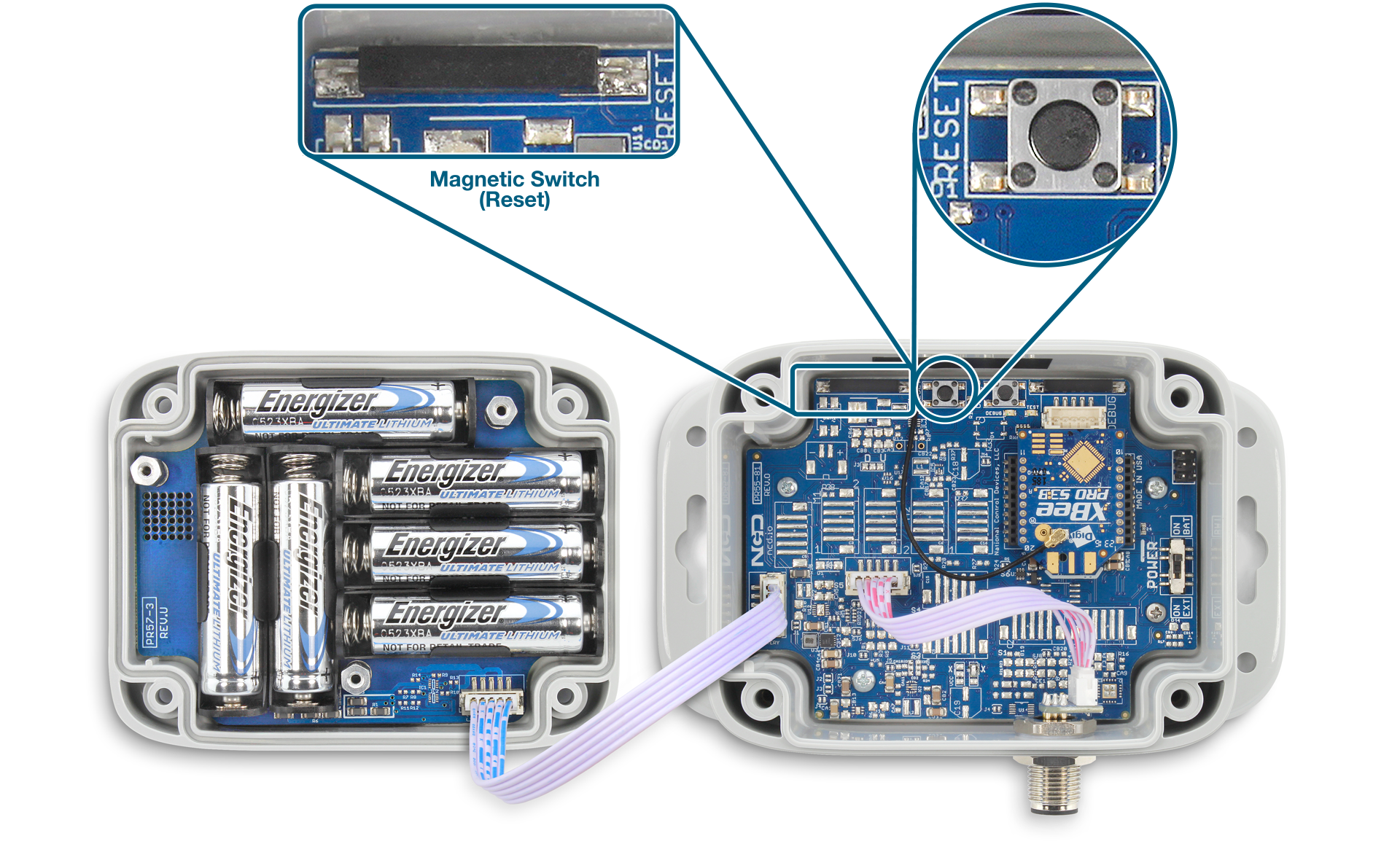

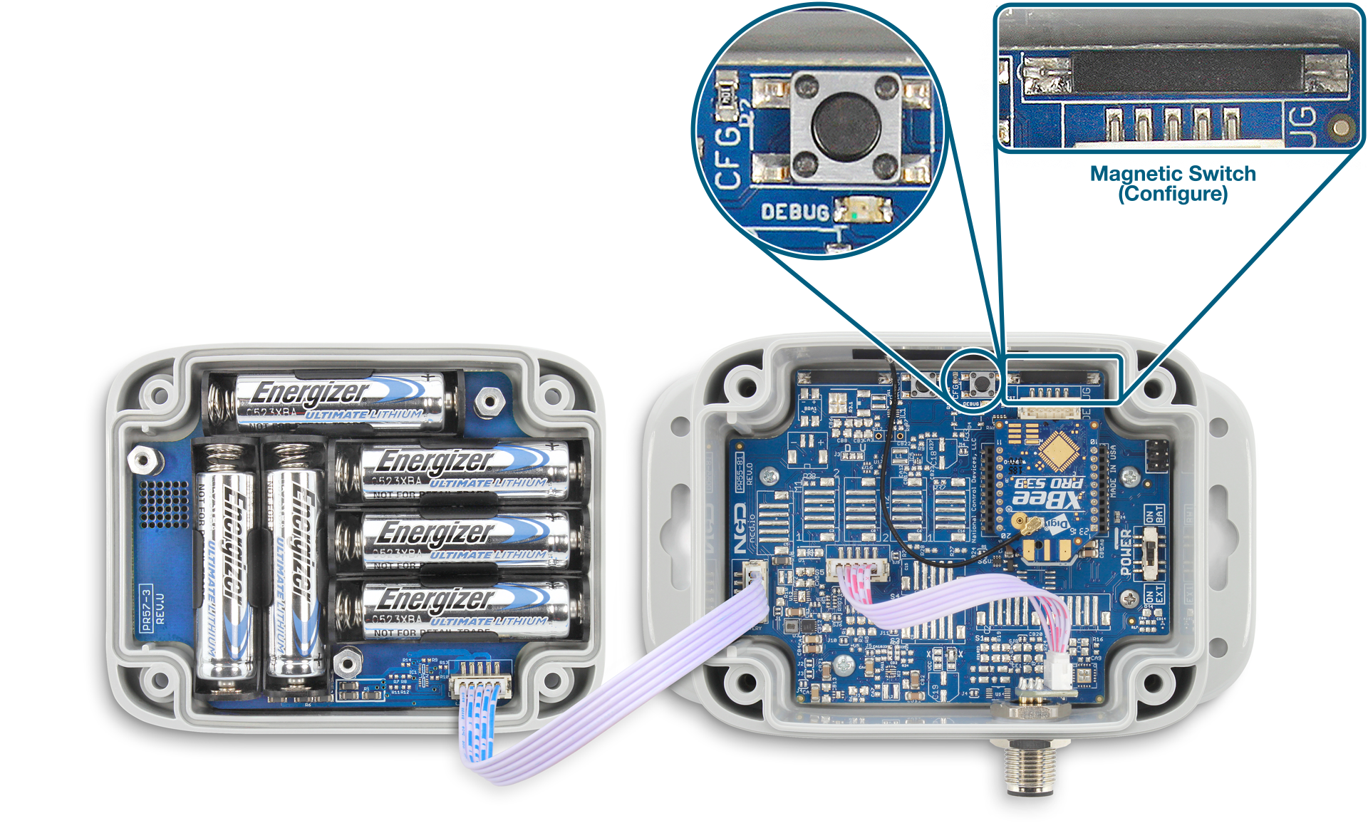

Hardware Controls
Power Switch
  • Battery Power
  • External Power
RESET Button
CFG Button
Hardware Mode Selection
Run Mode
Configuration Mode
Factory Default/Reset
Using Buttons
  • Wait for 3-5 seconds
Using Magnetic Switches
  • Wait for 1 second

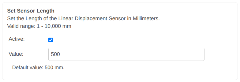

Set Sensor Length
Set the Length of the Linear Displacement Sensor in Millimeters.
Valid range: 1 – 10,000 mm
Default value: 500 mm.
