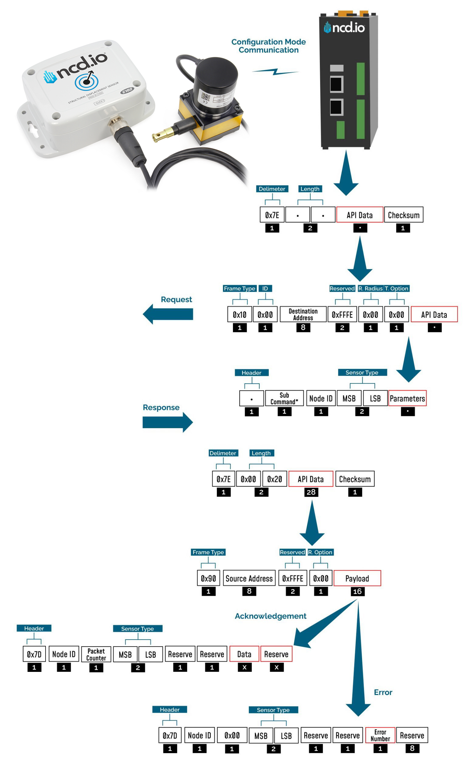

Frame Structure
| 8 | 0x55 | |||
| 9 | 0x4E | |||
| 8 | 0x47 | |||
| 9 | 0x4D | |||
| 8 | 0x55 | |||
| 9 | 0x4D |

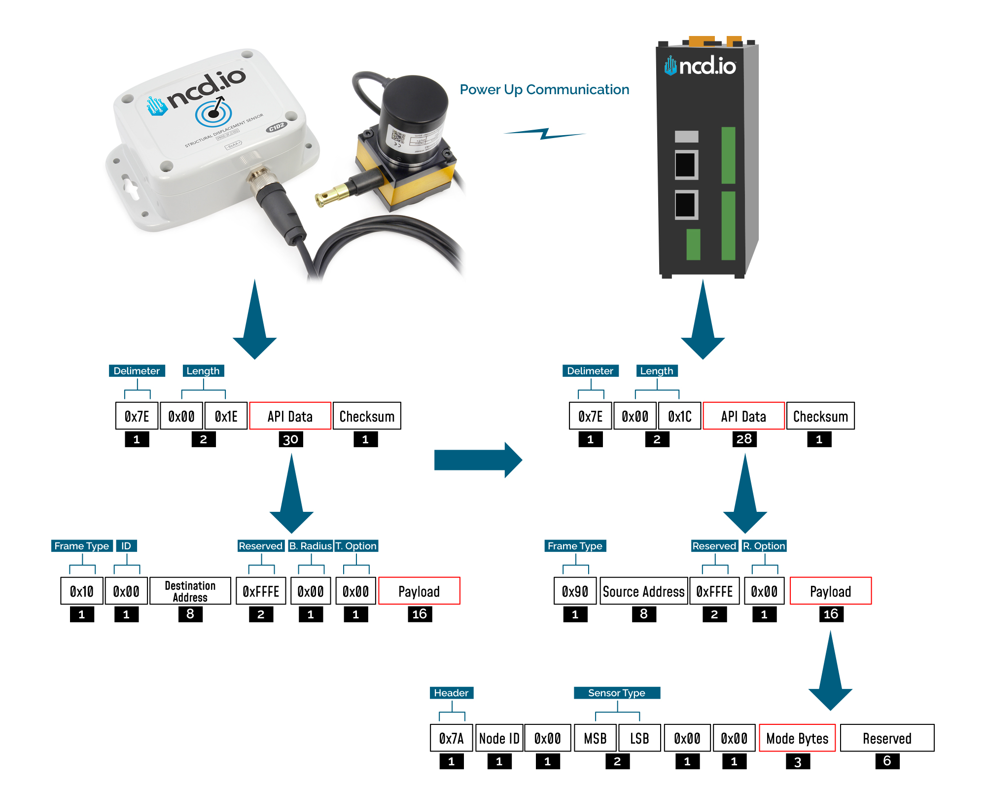

Run Mode Power Up Frame
| 7E 00 1E 10 01 00 13 A2 00 42 53 64 53 FF FE 00 00 7A 00 00 00 1E 00 00 52 55 4E 00 00 00 00 00 00 06 | Example frame | |
| 0x7E | 1 | Delimiter |
| 0x1001 | 2 | Length |
| 0x10 | 1 | Frame Type (Power Up) |
| 0xFFFE | 2 | Reserved |
| 0xC2 | 1 | R. Option |
| 0x00 | 1 | Node ID |
| 0x00 | 1 | Separator |
| 0x001E | 2 | Sensor Type |
| 0x0000 | 2 | Separator |
| 0x06 | 1 | Checksum |
| 7E 00 1E 10 01 00 13 A2 00 42 53 64 53 FF FE 00 00 7A 00 00 00 1E 00 00 50 47 4D 00 00 00 00 00 00 17 | Example frame | |
| 0x001C | 2 | Length |
| 0x90 | 1 | Frame Type |
| 0x7A | 1 | Header |
| 0x17 | 1 | Checksum |
Factory Reset Mode Power Up Frames (PUM)
| 7E 00 1C 90 00 13 A2 00 42 53 64 53 FF FE C2 7A 00 00 00 1E 00 00 50 55 4D 00 00 00 00 00 00 D5 | Example frame | |
| 0x7A | 1 | Header |
| 0x50554D | 3 | Mode Byte for Factory Reset Mode |
| 0xD5 | 1 | Checksum |

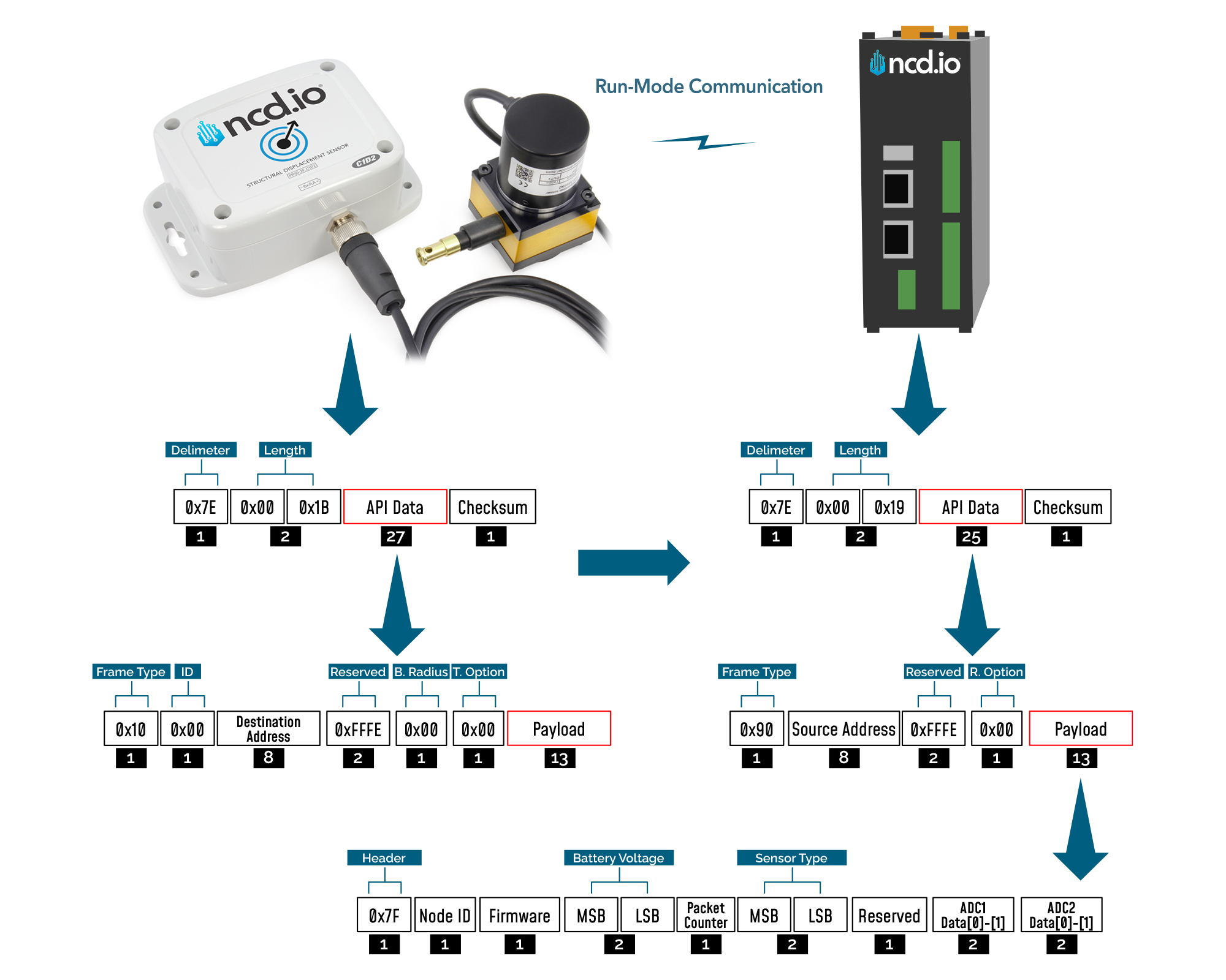

Sensor Data Frame
The detail of Payload section of packet is shown in table below:
| LSB 7 | 0x1E | Sensor Type 30 | ||
| Error/Reserved byte | 8 | 0x00 | 1 | Reserved |
| Position | 9/Data[0] | - | 2 | Position = ((Data[0] << 8 | Data[1]) / 1023 * 100) |
| 10/Data[1] |
Configuration Mode Frame
The following set of commands are an example on how to change some of the parameters that affect the operation of the device (these are parameters that are general in nature, more on a network protocol/device level than device specific). The relate to settings that are independent of the type of probe used. You can find them in Appendix together wit the Device/Application Specific commands.
Read Sleep Duration
This command may be used to read the sensor sleep duration. The sleep duration determines how frequently the sensor wakes up and send sensor data. The interval is set in seconds. Short intervals will drain the battery faster while longer intervals will provide a very long battery life.
Read Sleep Duration Command
00 00 00 00 00 00 FF FF
When sending this command to a particular sensor, replace the MAC address of the sensor. Again, the sensor MUST be in configuration mode.
