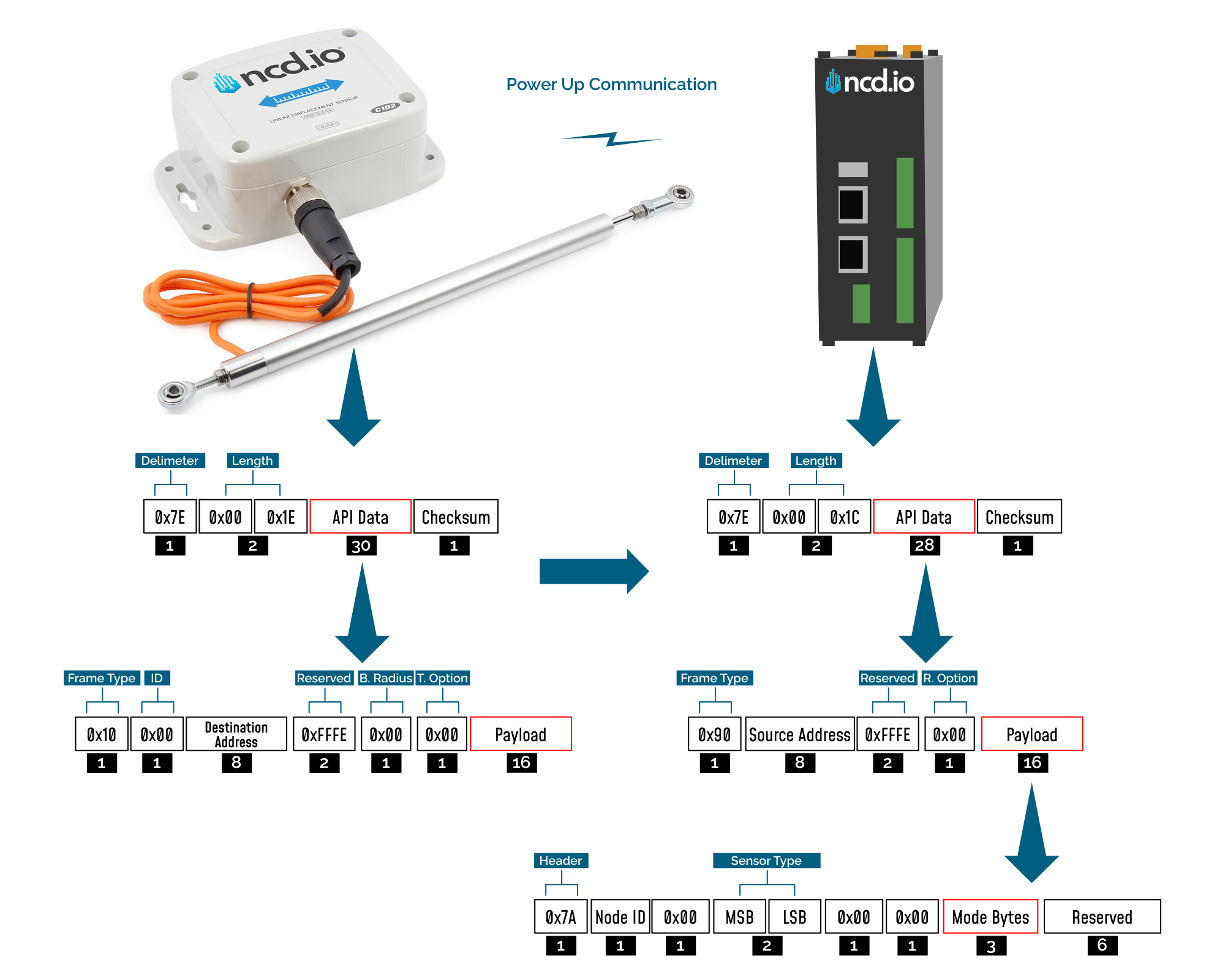

Frame Structure

Run Mode Power Up Frame
| 7E 00 1E 10 01 00 13 A2 00 42 53 64 53 FF FE 00 00 7A 00 00 00 1D 00 00 52 55 4E 00 00 00 00 00 00 06 | Example frame | |
| 0x7E | 1 | Delimiter |
| 0x1001 | 2 | Length |
| 0x10 | 1 | Frame Type (Power Up) |
| 0xFFFE | 2 | Reserved |
| 0xC2 | 1 | R. Option |
| 0x00 | 1 | Node ID |
| 0x00 | 1 | Separator |
| 0x001D | 2 | Sensor Type |
| 0x0000 | 2 | Separator |
| 0x06 | 1 | Checksum |
| 7E 00 1E 10 01 00 13 A2 00 42 53 64 53 FF FE 00 00 7A 00 00 00 1D 00 00 50 47 4D 00 00 00 00 00 00 17 | Example frame | |
| 0x001C | 2 | Length |
| 0x90 | 1 | Frame Type |
| 0x7A | 1 | Header |
| 0x17 | 1 | Checksum |

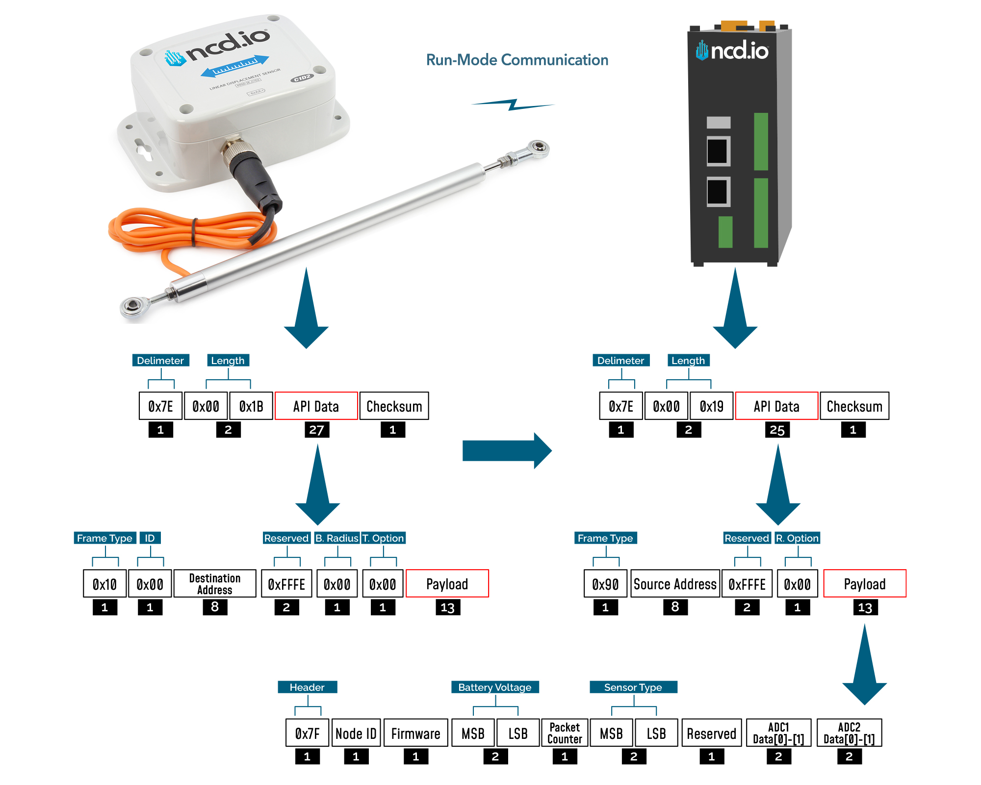

Sensor Data Frame
The detail of Payload section of packet is shown in table below:
| LSB 7 | 0x1D | Sensor Type 29 | ||
| Error/Reserved byte | 8 | 0x00 | 1 | Reserved |
| Position | 9/Data[0] | - | 2 | Position = ((Data[0] << 8 | Data[1]) / 1023 * 100) |
| 10/Data[1] |

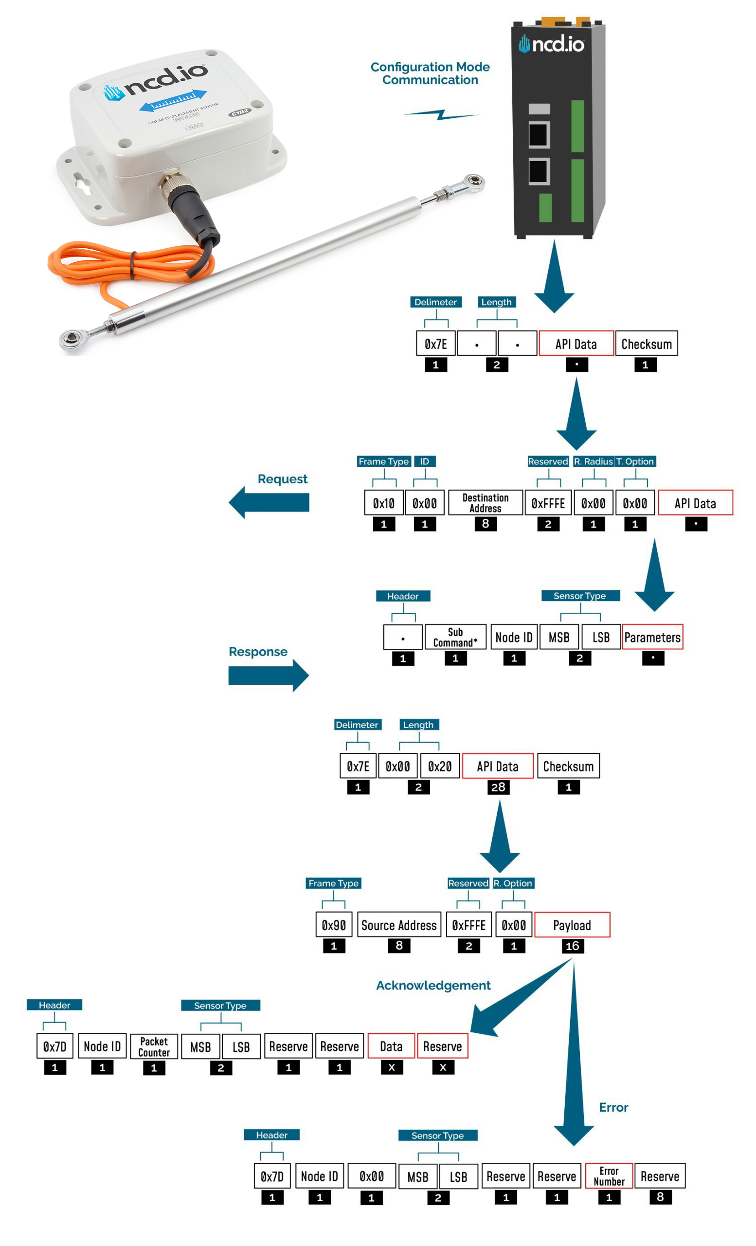

Configuration Mode Frame
The following set of commands are an example on how to change some of the parameters that affect the operation of the device (these are parameters that are general in nature, more on a network protocol/device level than device specific). The relate to settings that are independent of the type of probe used. You can find them in Appendix together wit the Device/Application Specific commands.

Payload
F7 02 00 00 00 01 00 01 2C
Note that F7 is the command header byte and 02 is the sub command for storing the Node ID and Sleep Duration.
