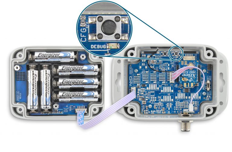

Hardware Controls
Power Switch
  • Battery Power
  • Off
  • External Power
RESET Button
CFG Button
Hardware Mode Selection
Run Mode
Configuration Mode
Factory Default/Reset
Using Buttons
  • Wait for 3-5 seconds
Using Magnetic Switches
  • Wait for 1 second
Timing Using Buttons
Click to enlarge

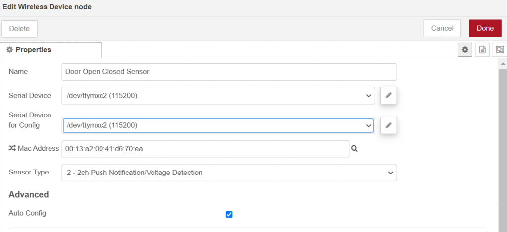

Wireless Device Node Configuration Options​
  • Name
    • Arbitrary name of this node
  • Serial Device*
    • For More information on the submenu the edit icon brings up see section ncd-gateway-config Nodes​
  • Serial Device for Config
  • Mac Address
  • Sensor Type*
  • Auto Config
*Required

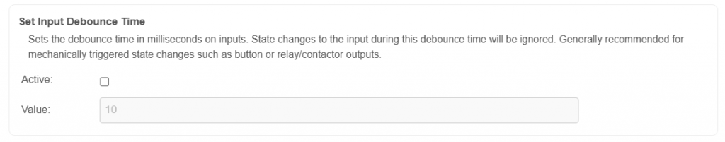

Set Input Debounce Time
Sets the debounce time in milliseconds on inputs. State changes to the input during this debounce time will be ignored. Generally recommended for mechanically triggered state changes such as button or relay/contactor outputs.
