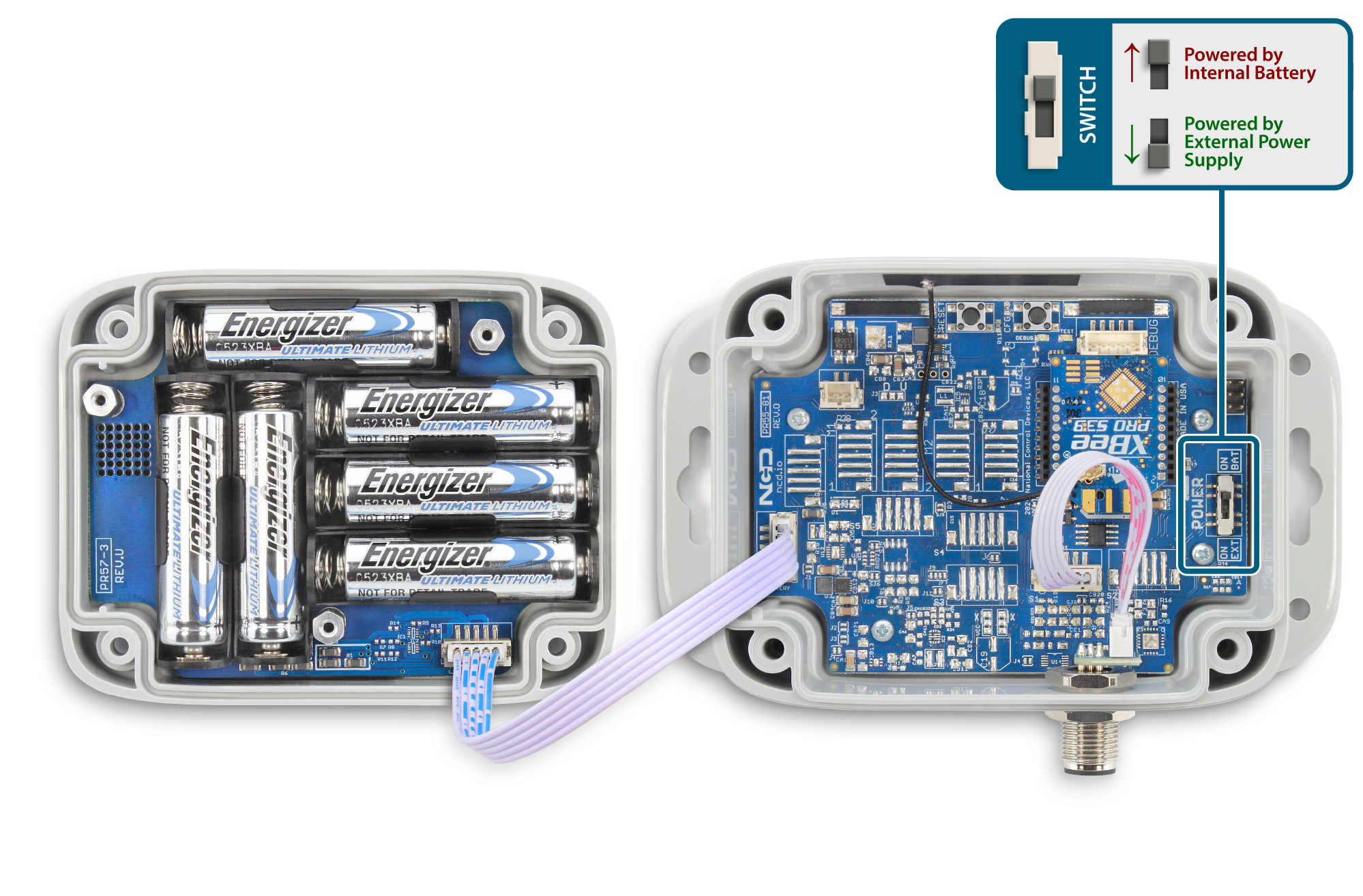

Power Switch
  • Battery Power
  • OFF
  • External Power
The OFF position will power down all components of the sensor and no data will be transmitted
External Power – Not available in C1D2 products

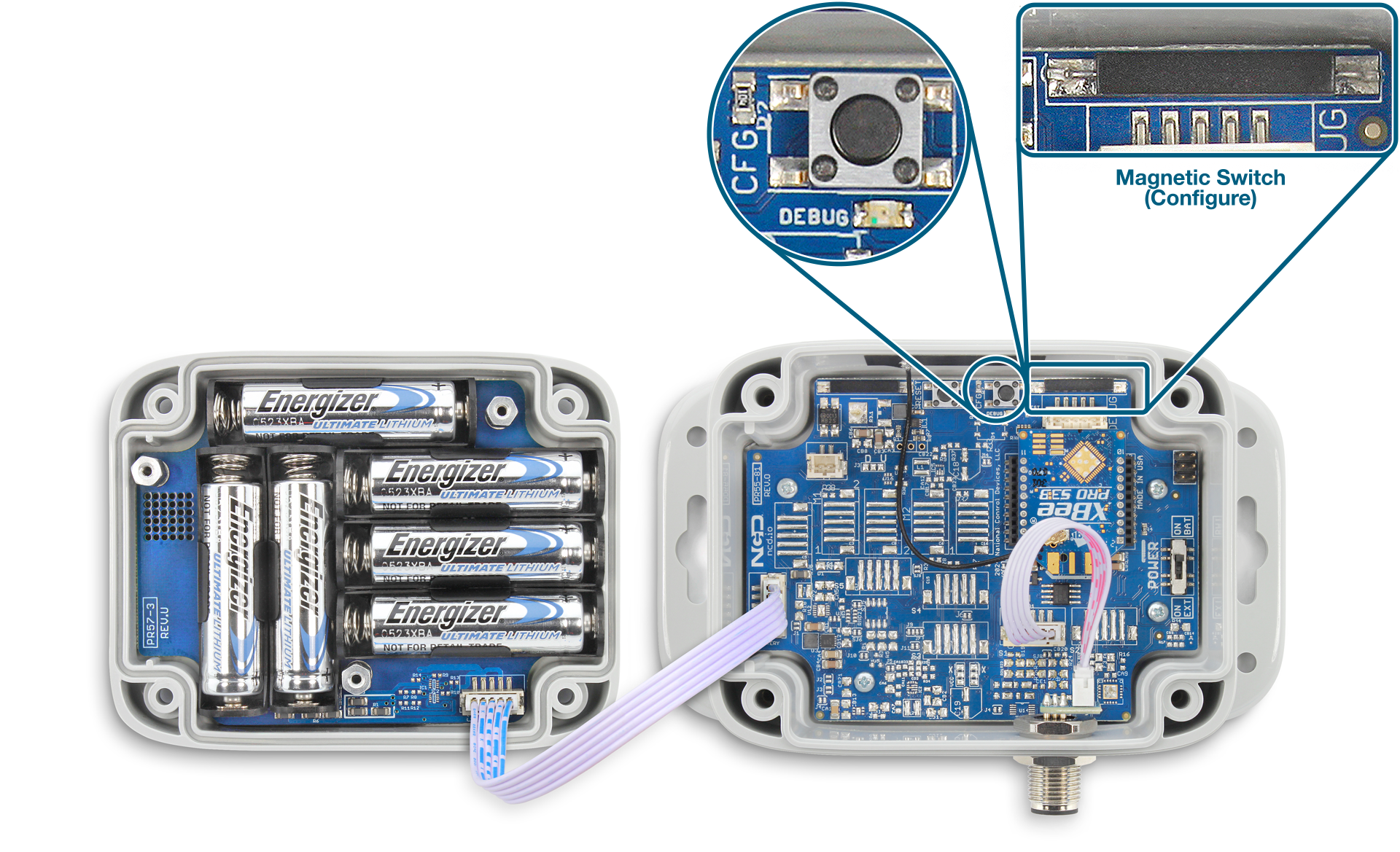

RESET Button
CFG Button
Hardware Mode Selection
Run Mode
Configuration Mode
Factory Default/Reset
Using Buttons
  • Wait for 3-5 seconds
Using Magnetic Switches
  • Wait for 1 second

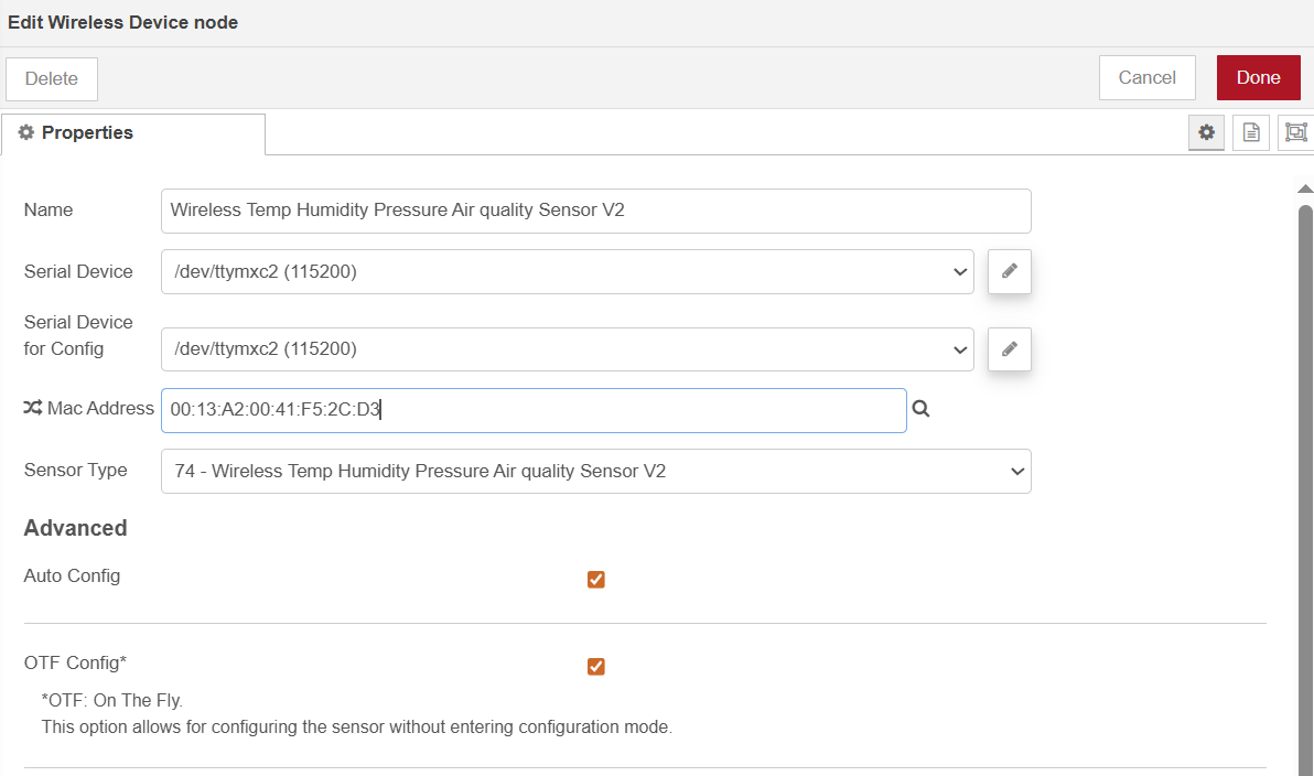

  • Name
    • Arbitrary name of this node
  • Serial Device*
    • For More information on the submenu the edit icon brings up see section ncd-gateway-config Nodes​
  • Serial Device for Config
  • Mac Address
  • Sensor Type*
  • Auto Config
  • OTF Config
    • Checking the box next to this field AND having Auto Config checked tells Node-Red that the sensor(s) corresponding to this Wireless Device node should be configured when a FLY message is detected
