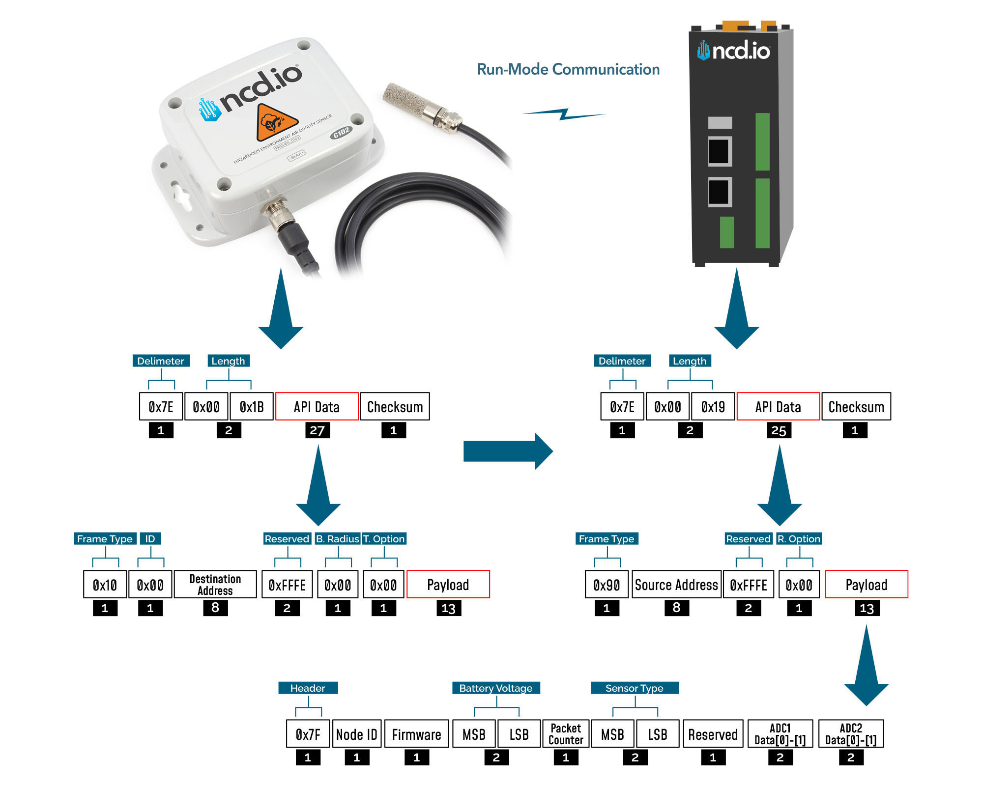

Frame Structure
| 8 | 0x55 | |||
| 9 | 0x4E | |||
| 8 | 0x47 | |||
| 9 | 0x4D | |||
| 8 | 0x55 | |||
| 9 | 0x4D |
Run Mode Power Up Frame
| 7E 00 1E 10 01 00 13 A2 00 42 53 64 53 FF FE 00 00 7A 00 00 00 4A 00 00 52 55 4E 00 00 00 00 00 00 06 | Example frame | |
| 0x7E | 1 | Delimiter |
| 0x1001 | 2 | Length |
| 0x10 | 1 | Frame Type (Power Up) |
| 0xFFFE | 2 | Reserved |
| 0xC2 | 1 | R. Option |
| 0x00 | 1 | Node ID |
| 0x00 | 1 | Separator |
| 0x004A | 2 | Sensor Type |
| 0x0000 | 2 | Separator |
| 0x06 | 1 | Checksum |
