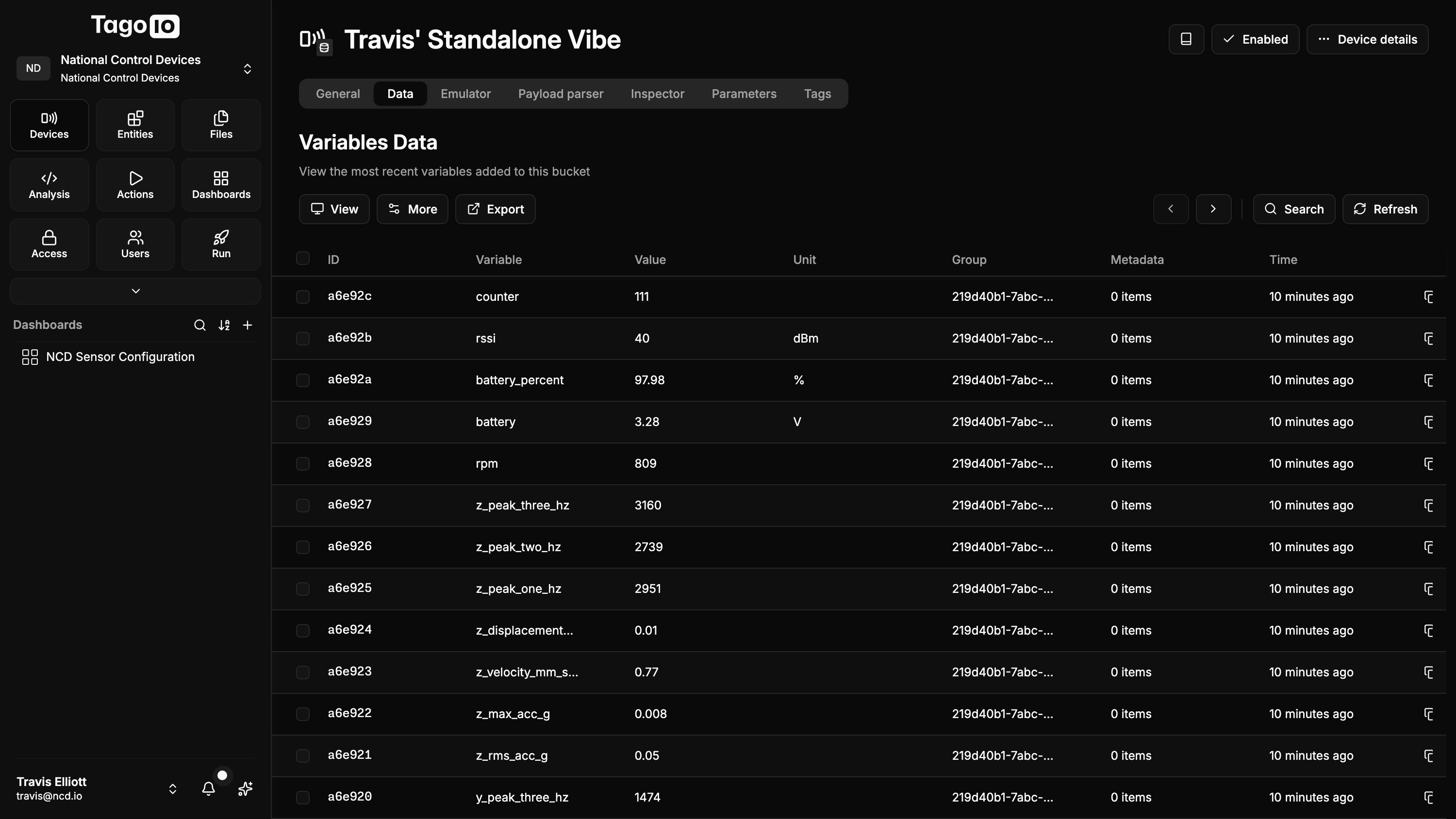

Devices created for you
Enabling a sensor creates its TagoIO device, with a permanent serial and ten tags describing where it is and what it is. Nothing is created in TagoIO until you enable something.

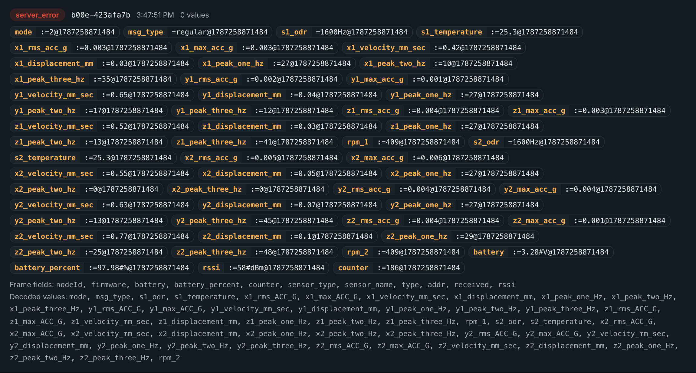

Readings as they arrive

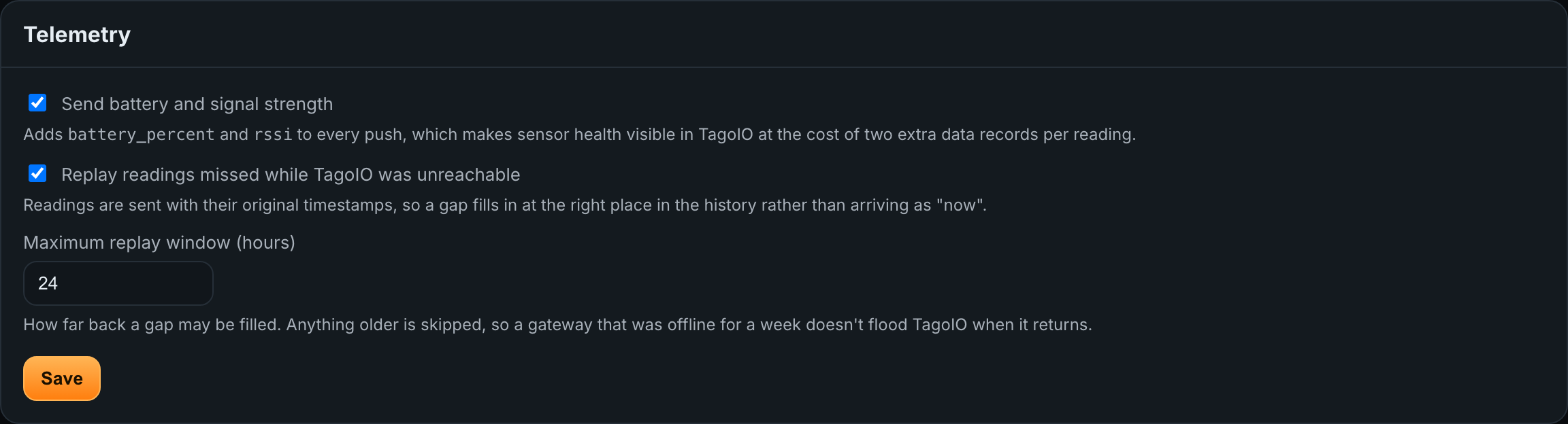

Each sensor frame is pushed the moment the gateway decodes it. Anything a failed push missed is replayed later with its original timestamp, so a gap fills in where it belongs.

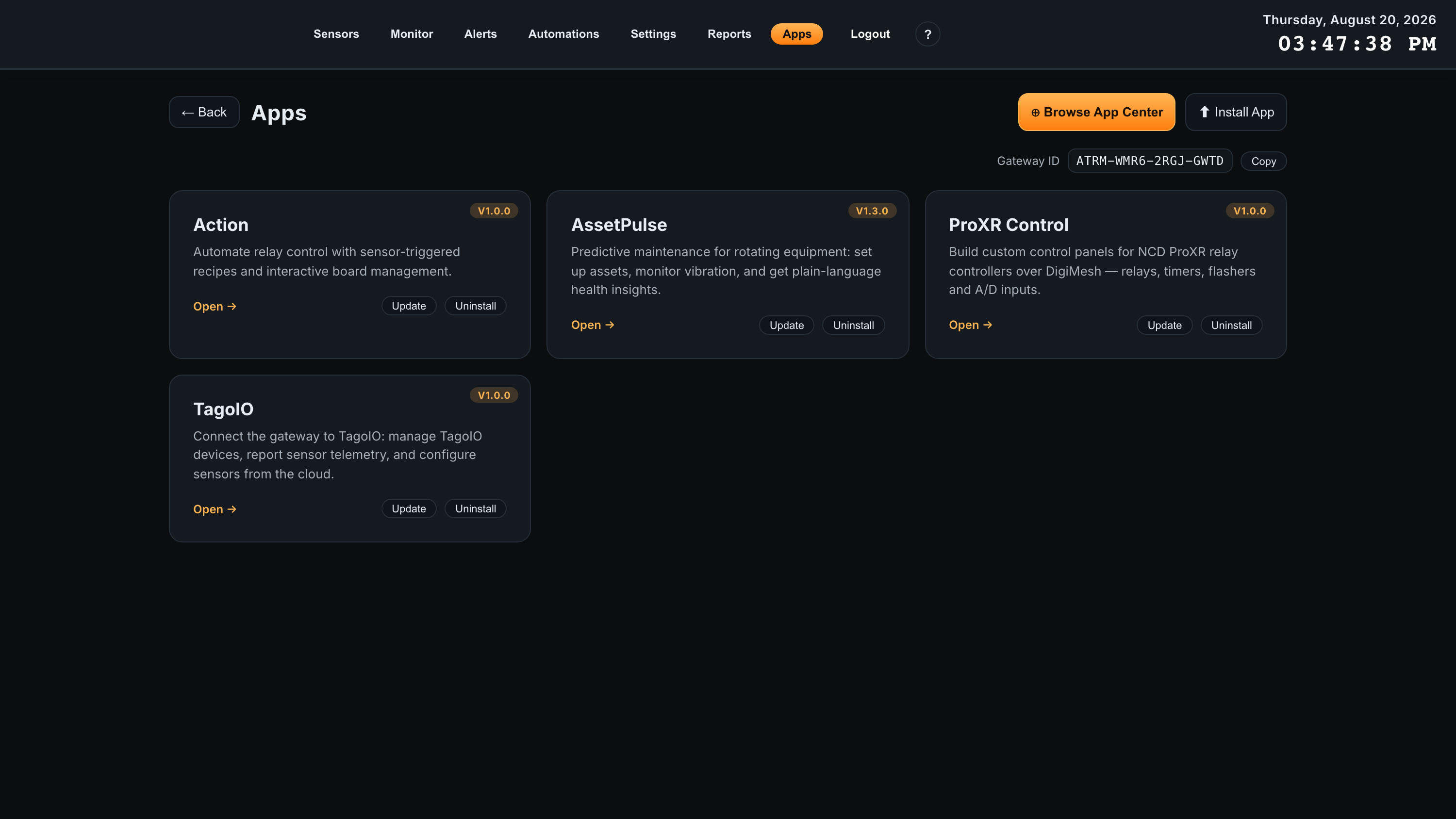

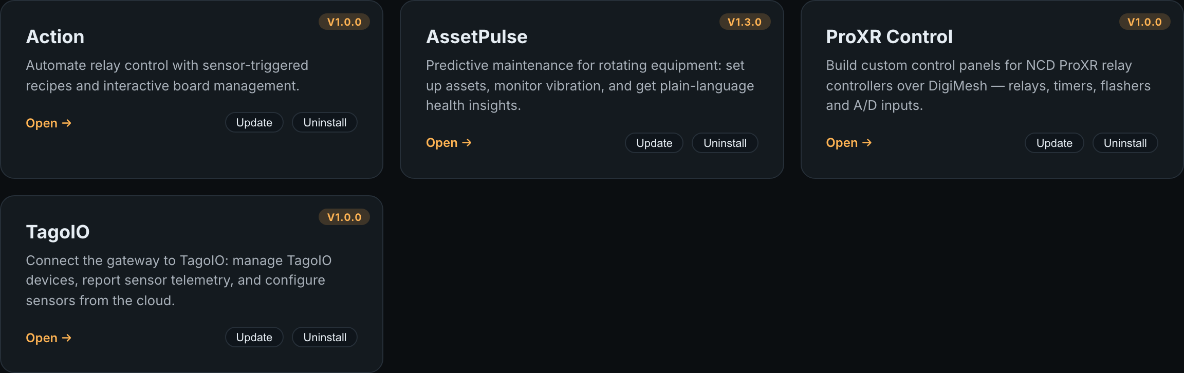

TagoIO installs from the Atrium App Center like any other app.
  1. 1
    Open the Apps tab
    In Atrium, click Apps in the top navigation, then Browse App Center.
  2. 2
    Find TagoIO
    It is listed with the subtitle TagoIO and the badge TI. There is no PAID badge, so no license step.
  3. 3
    Install it
    Both platform services restart, so the gateway API is briefly unavailable. The card then reads INSTALLED.
  4. 4
    Click Open on the TagoIO card
    The app opens on its Connection screen. Alongside Open the card also carries Update and Uninstall.

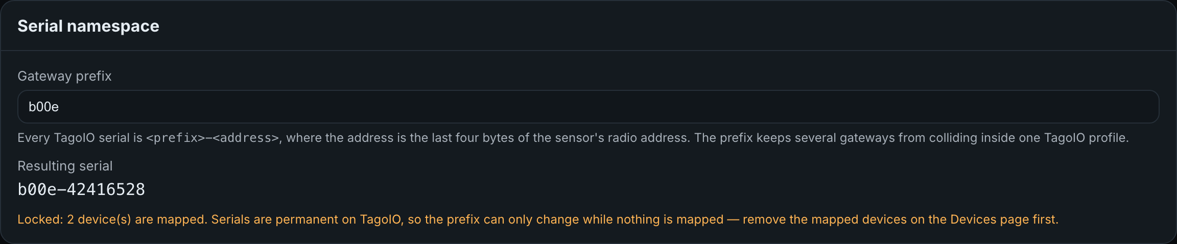

  • The app derives a gateway prefix for TagoIO serials from the gateway’s name — “Gateway B00E” becomes b00e. See Serial namespace.

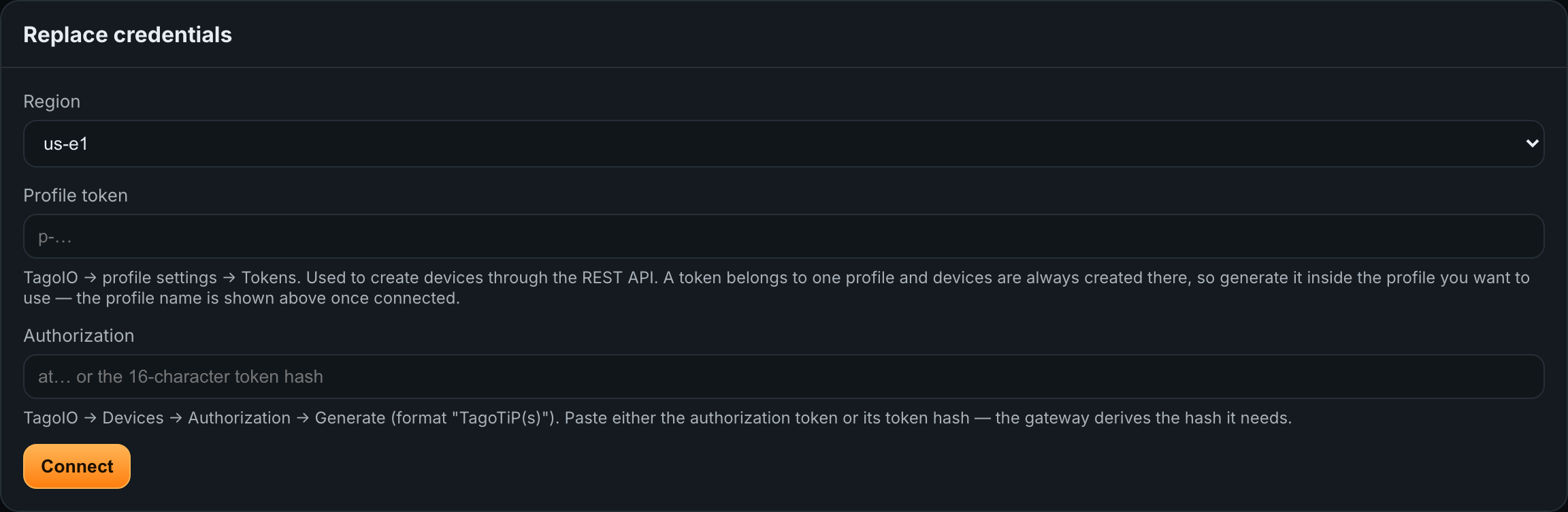

2. Connect the gateway
  1. 1
    Open the Connection screen
    It is the app’s first screen. The panel reads Not connected and the form below is headed Connect to TagoIO.
  2. 2
    Choose your Region
    us-e1 or eu-w1, matching the region your TagoIO account lives in. This decides which TagoIO hosts the gateway talks to.
  3. 3
    Paste the Profile token and Authorization
    Both fields are masked. Connect stays disabled until both contain something.
  4. 4
    Click Connect
    The button reads Verifying… while the gateway checks the token against TagoIO. On success the message Connected to TagoIO. appears, the chip turns Connected, and the panel fills in your account and profile name.
TagoIO > Connection > credentials form

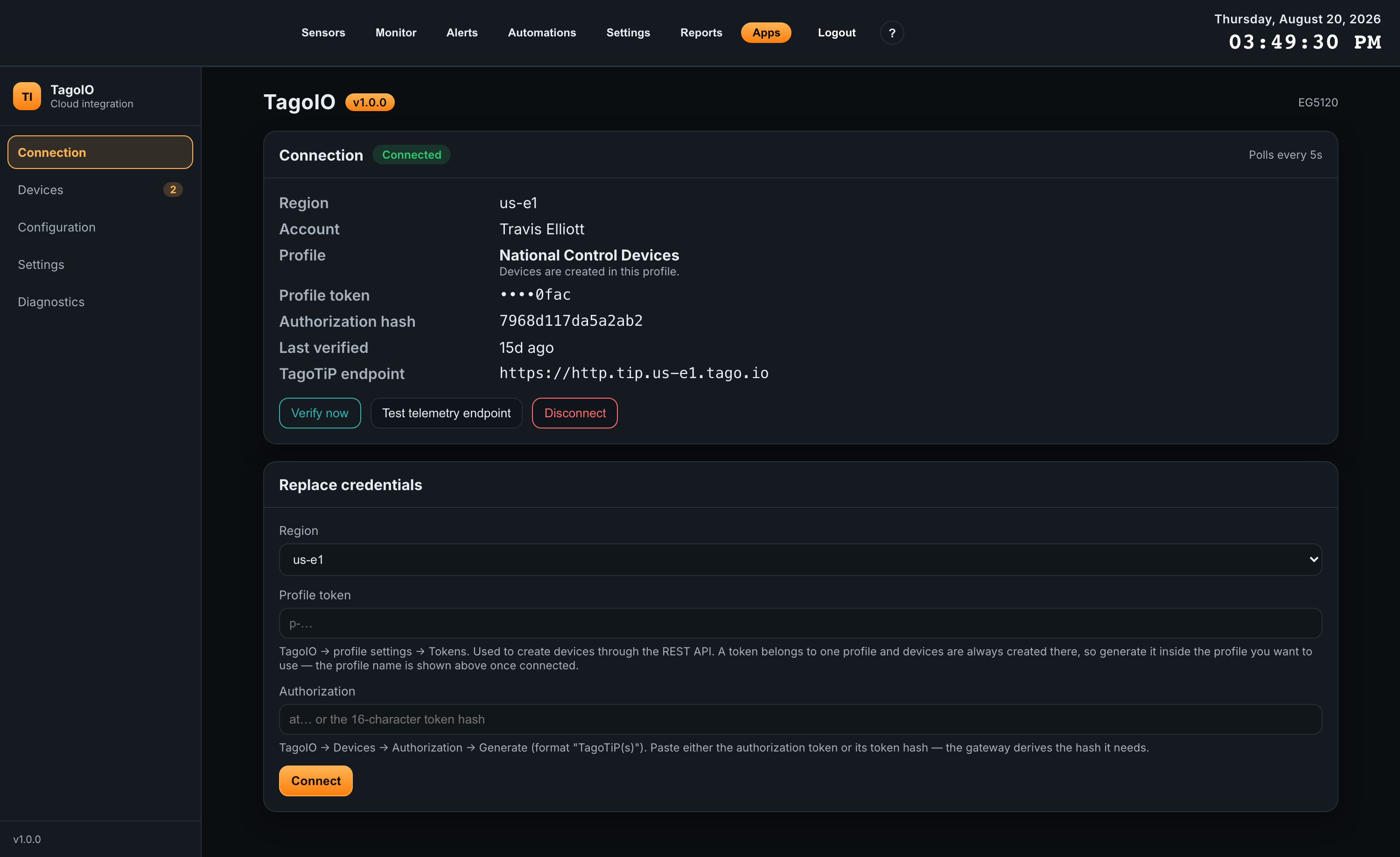

05Connection
The Connection screen is where the gateway’s link to TagoIO is established and checked. It refreshes itself every 5 seconds, which the panel states as Polls every 5s.
TagoIO > Connection
TagoIO > Connection
Status panel
The chip beside the word Connection is the one-glance summary.
ChipMeans
Not connectedNo credentials have been stored. Nothing is reported and nothing is created in TagoIO.
ConnectedCredentials are stored and TagoIO accepted them the last time they were checked.
UnverifiedCredentials are stored but have not been confirmed against TagoIO yet.
ErrorThe last attempt failed. The reason is shown in the Last error row.
The rows beneath it are:
RowWhat it tells you
RegionThe TagoIO region in use, us-e1 or eu-w1.
AccountThe TagoIO account name the profile token resolved to. Useful confirmation you connected the account you meant to.
ProfileThe TagoIO profile devices are created in, with the reminder Devices are created in this profile.
Profile tokenThe last four characters only, as ••••0fac. The token itself is never shown again, and never appears in the app’s API responses or logs.
Authorization hashThe 16-character hash the gateway derived. This is shown in full because the TagoTiP protocol treats it as public, and quoting it helps support.
Last verifiedHow long ago TagoIO last confirmed the credentials. This does not go stale on its own — a large value simply means nobody has clicked Verify recently.
TagoTiP endpointThe host telemetry is sent to, derived from the region.
Last errorOnly present when something failed. It is cleared by the next success.
Verify, test, disconnect
Three buttons appear once credentials are stored. None of them writes data to TagoIO.
Verify now
Re-checks the stored profile token against the TagoIO REST API and refreshes the account and profile names. On success it reports Credentials verified. This is the check to run when device creation is failing.
Test telemetry endpoint
Checks the other half — the Authorization hash used for telemetry, which Verify now does not cover. It pushes to a randomly named serial that cannot exist. TagoIO resolves the profile before it looks up the serial, so a device_not_found answer proves the hash is valid, while invalid_token proves it is not. No data is written either way, and no real device is touched.
Success reads Authorization hash accepted by the TagoTiP endpoint. Failure reads The TagoTiP endpoint rejected this authorization hash.
TagoIO > Connection > Test telemetry endpoint
Disconnect
Deletes the stored credentials from the gateway. Reporting stops immediately. Your TagoIO devices and their data are left exactly as they are, and so are the gateway’s device mappings, so reconnecting the same profile resumes where it left off.
Replacing credentials
Once connected, the lower panel is headed Replace credentials and works the same way. Use it to rotate a token, or to move to a different region or profile.
The gateway keeps no copy of what you type: the fields are cleared as soon as it has accepted them.

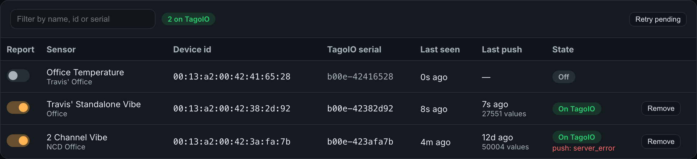

06Devices

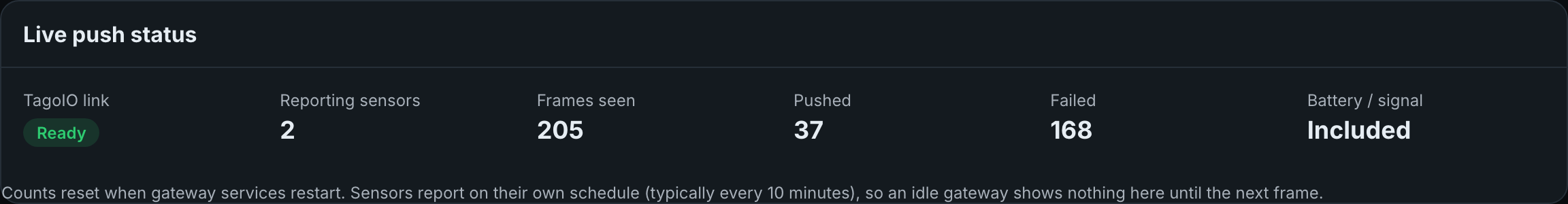

Devices is where you decide which sensors reach TagoIO, and where you check that they are getting there. The heading counts the sensors Atrium has set up, for example 3 whitelisted sensor(s); the count on the sidebar item is how many are enabled for TagoIO.
TagoIO > Devices
TagoIO > Devices
Reading the table
ColumnWhat it shows
ReportThe switch that enables or disables reporting for this sensor.
SensorThe sensor’s Atrium name, with its location beneath it when one is set. This is also the name given to the TagoIO device.
Device idThe sensor’s 64-bit radio address, colon-delimited.
TagoIO serialThe serial this sensor has, or would get. Shown grey until a serial is actually assigned.
Last seenWhen the gateway last heard from the sensor over the radio. Nothing to do with TagoIO — a sensor can be seen recently and still be failing to push.
Last pushWhen the gateway last delivered readings to TagoIO, with the cumulative count of values sent beneath it. Shown as — unless the device is enabled and created.
StateThe sync state chip, plus any error. Errors are prefixed to say which stage failed: push: for telemetry, tags: for the metadata sync.
Above the table, the Filter by name, id or serial box narrows the list, and the chips summarise the fleet: how many are on TagoIO, how many pending, how many failed. Retry pending is enabled only when there is something pending or failed to retry.
Turning reporting on and off
Switching on assigns a permanent serial and attempts the TagoIO device creation straight away, so you get immediate feedback. If the sensor was enabled before, its existing TagoIO device is reused rather than duplicated — and the app checks the device still exists in TagoIO first, so one deleted from the TagoIO dashboard is rebuilt instead of being trusted as present.
Switching off stops the sensor reporting but leaves the TagoIO device and its data in place. The app confirms this as Device disabled. It stays on TagoIO but stops reporting. Its state chip becomes Off.
If the gateway is not connected, a notice at the top of the page says so and enabling a device queues it until the connection is restored.
Sync states and retries
ChipMeaningWhat to do
OffNot enabled for TagoIO.Nothing. This is the resting state for sensors you do not want in TagoIO.
PendingEnabled, but the TagoIO device does not exist yet.Wait. A background worker retries every 60 seconds in batches of 5, backing off to at most one hour between attempts.
On TagoIOThe TagoIO device exists and the sensor is reporting to it.Nothing. Check Last push to confirm data is flowing.
FailedCreation was attempted and TagoIO refused it. The reason is shown under the chip.Read the error. Retry on the row clears the backoff and tries immediately.
Retry pending in the toolbar reconciles everything outstanding at once and reports the outcome, for example Created 2 device(s); 0 failed. A row that is enabled but not yet created also carries its own Retry button.

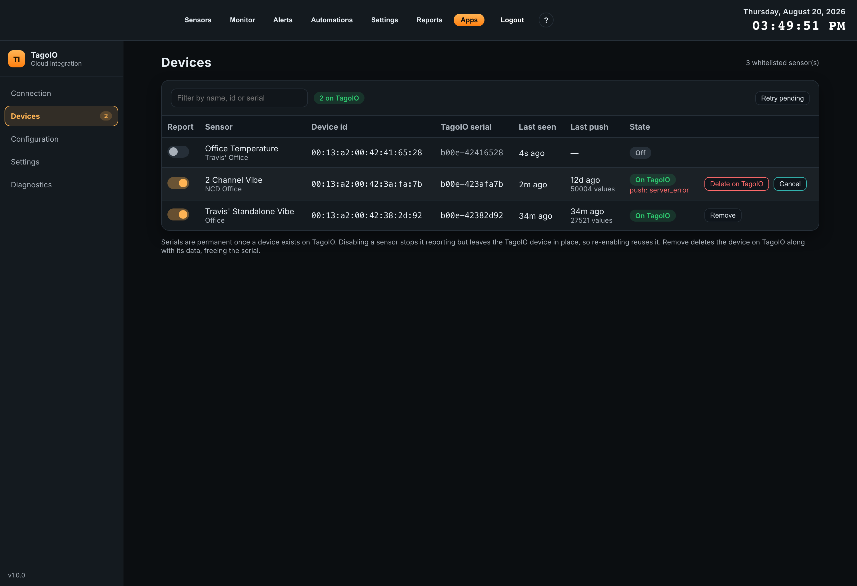

Removing a device
Remove is the only way to free a serial, which matters if a sensor was mapped by mistake. Because serials are permanent on TagoIO, this is a real deletion, so it is confirmed inline: the row’s buttons become Delete on TagoIO and Cancel.
TagoIO > Devices > Remove
If TagoIO refuses the delete, the app offers a second path rather than leaving you stuck: a panel explains that TagoIO would not delete the device and offers Forget the mapping, which frees the serial locally and leaves the TagoIO device, if any, alone. Use it when you already deleted the device in the TagoIO dashboard yourself.

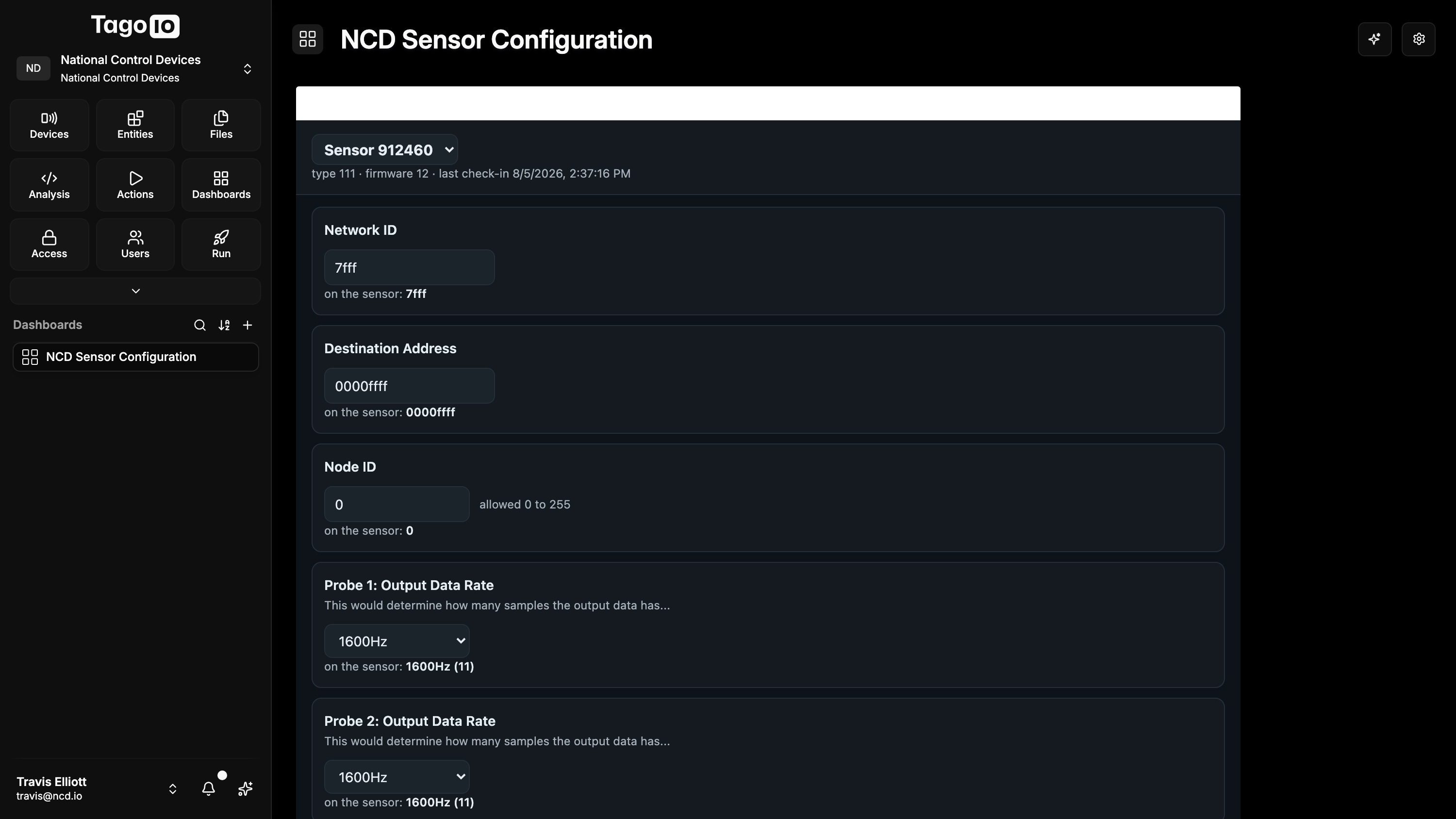

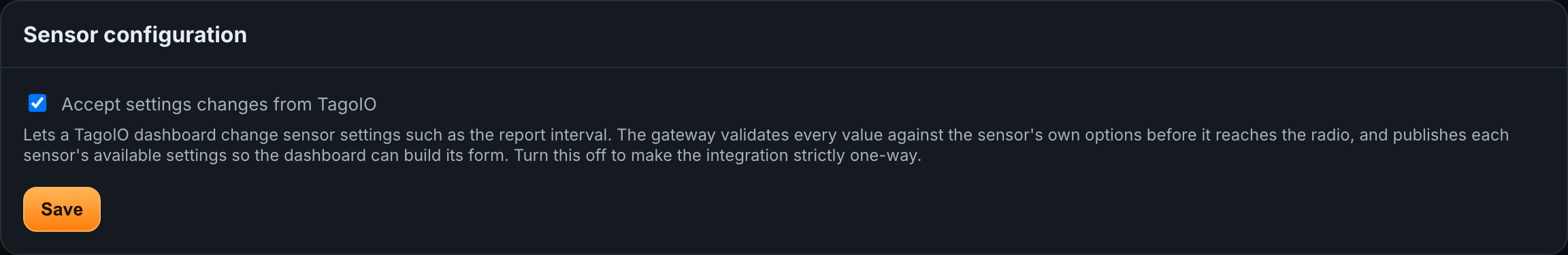

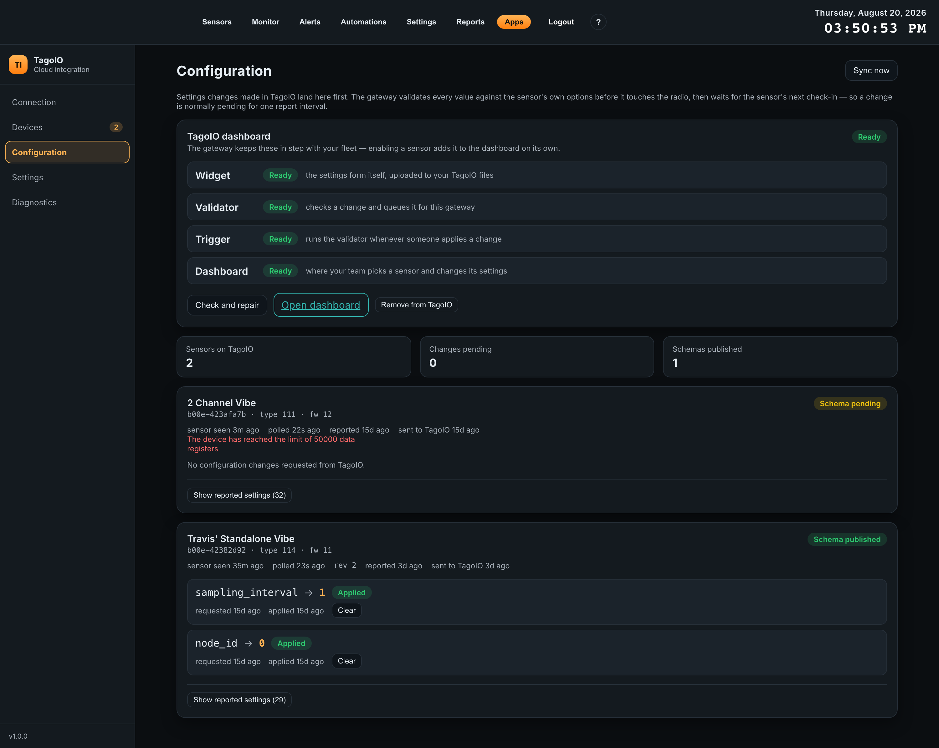

07Configuration
Configuration is the gateway’s side of two-way sensor settings. As the page itself says: settings changes made in TagoIO land here first, the gateway validates every value against the sensor’s own options before it touches the radio, then waits for the sensor’s next check-in — so a change is normally pending for one report interval.
This is the screen to open when someone says “I changed the interval in TagoIO and nothing happened”. Sync now in the header runs a pull, acknowledge and publish pass immediately instead of waiting for the next minute, and reports what it did.
TagoIO > Configuration

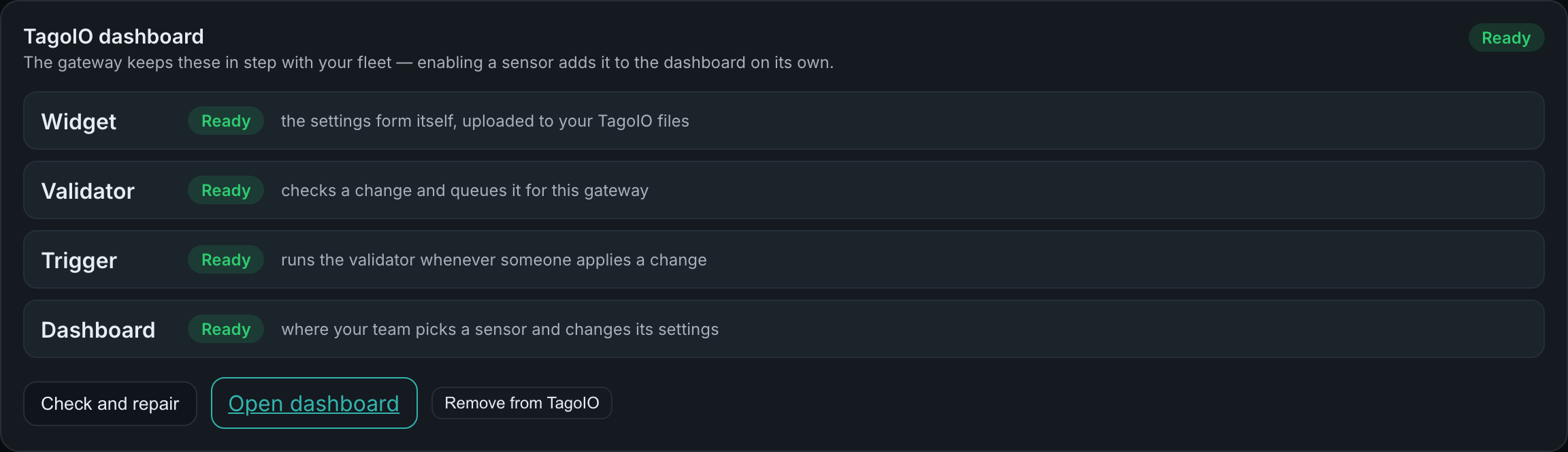

TagoIO dashboard setup
Sensor configuration needs four things to exist in your TagoIO account. The card describes each by what it does for you rather than by its TagoIO type.
ItemCard descriptionWhat it actually is in TagoIO
Widgetthe settings form itself, uploaded to your TagoIO filesAn HTML file in the account’s Files, at atrium/sensor-config/<content-hash>/index.html.
Validatorchecks a change and queues it for this gatewayAn Analysis named NCD Sensor Configuration.
Triggerruns the validator whenever someone applies a changeAn Action named NCD Sensor Configuration.
Dashboardwhere your team picks a sensor and changes its settingsA dashboard labelled NCD Sensor Configuration carrying the widget.
Each item carries a state chip:
ChipMeaning
ReadyPresent and current.
Working…Being created. TagoIO bundles an Analysis after accepting it, so the validator legitimately sits here for a while.
WaitingBlocked on something else finishing first.
FailedThe reason replaces the description text on that row.
Not createdDoes not exist yet.
The buttons
  • Set up in TagoIO — shown when nothing has been provisioned. Creates all four. This is the first thing the app ever writes to your TagoIO account.
  • Check and repair — replaces the above once provisioned. Safe to press twice, and the way to retry a stalled bundle. It rebuilds anything that has gone missing, including an Analysis you deleted by hand.
  • Open dashboard — opens the TagoIO dashboard in a new tab.
  • Remove from TagoIO — confirms inline to Delete the validator and trigger. As the note beside it says, the dashboard, its widget and every sensor stay exactly as they are.
With nothing enabled yet, the card notes: Enable a sensor on the Devices page and the dashboard will pick it up within a minute.
The three counters
CounterMeaning
Sensors on TagoIOHow many mapped sensors this page is tracking. Only devices that exist in TagoIO appear.
Changes pendingRequested settings not yet applied — those queued or waiting for a sensor.
Schemas publishedHow many sensors have had their settings list delivered to TagoIO. A dashboard form cannot be built for a sensor until this has happened.
Schemas published being lower than Sensors on TagoIO is normal for a short while after enabling a sensor, and is the usual reason a widget shows no form yet.

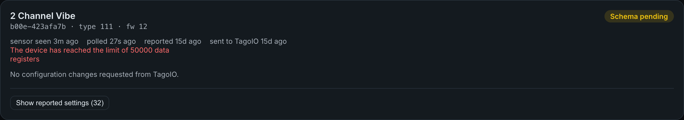

Per-sensor cards
Each mapped sensor gets a card headed with its name, then its serial, sensor type and firmware version.
TagoIO > Configuration > sensor card
The schema chip
ChipMeaning
Schema publishedThe gateway knows this sensor type’s settings and TagoIO has the current list.
Schema pendingThe gateway knows the settings but TagoIO does not have the current list yet.
No schemaThe gateway has not read this sensor type’s options yet, so it will not forward changes at all — it refuses to send values it cannot validate. This resolves on its own once the ingestion daemon has seen the sensor.
The timing line
Five values, and they mean genuinely different things:
ValueMeaning
sensor seenWhen the sensor last checked in over the radio. A change cannot be delivered until this happens again.
polledWhen the gateway last checked TagoIO for requested changes for this sensor.
revThe revision counter the gateway has processed. It moves when someone applies a change in TagoIO.
reportedWhen the sensor last told the gateway what its settings actually are.
sent to TagoIO / not sent to TagoIO yet / nothing to send yetWhether TagoIO holds that reported set. This is deliberately separate from reported, because a sensor reporting successfully while TagoIO never receives the values looks identical otherwise — and is exactly the case where a widget shows a form with no current values.

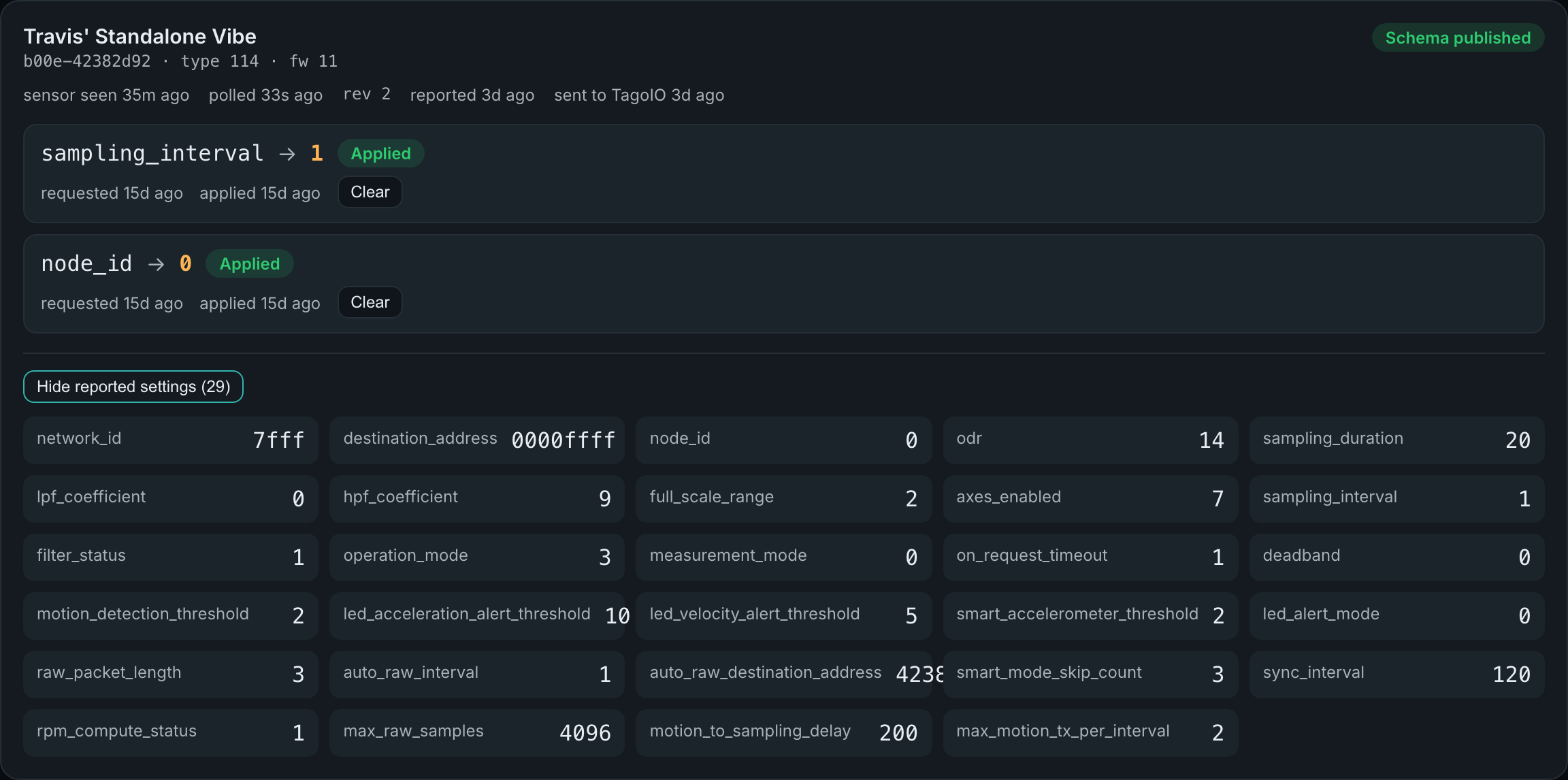

Reported settings
Show reported settings (n) expands the sensor’s current configuration as the sensor itself reports it. This is ground truth from the hardware, not what was requested.
TagoIO > Configuration > Show reported settings

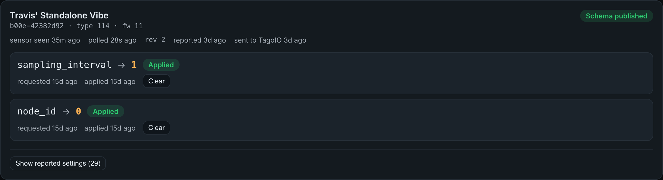

The life of a change
Each requested setting appears as a row reading setting → value with a state chip, when it was requested, and when it was applied.
ChipMeaning
QueuedCollected from TagoIO and validated, waiting to be sent to the radio.
Waiting for sensorHanded to the radio. The sensor has not confirmed it yet.
AppliedThe sensor confirmed the change. If it also shows confirming to TagoIO…, the acknowledgement has not reached TagoIO yet, so a dashboard may still show it as pending for a moment.
RejectedThe value did not pass validation against the sensor’s own options. The reason is shown beneath the row.
Clear on a row abandons that request. Use it for a change that is stuck — typically a sensor that is no longer reachable. The app confirms Cleared <setting>. and also tells TagoIO, so the dashboard stops showing it as pending.
When a sensor has nothing outstanding, the card reads No configuration changes requested from TagoIO.

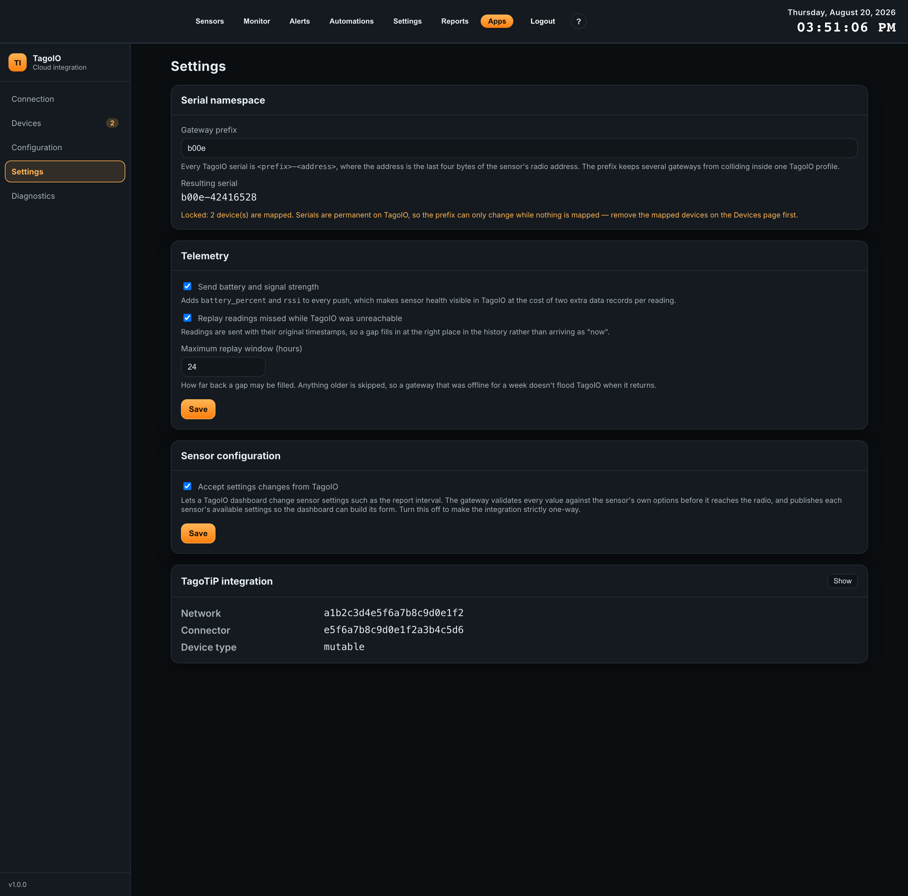

08Settings
Four panels, each with its own Save button. Saving one panel does not affect the others.
TagoIO > Settings
TagoIO > Settings
Serial namespace
Every TagoIO serial is <prefix>-<address>, where the address is the last four bytes of the sensor’s radio address. The prefix keeps several gateways from colliding inside one TagoIO profile.
FieldDetail
Gateway prefixDerived at install from the last word of the gateway’s name — “Gateway B00E” becomes b00e. Editable only while nothing is mapped. The value is lower-cased, characters outside a-z 0-9 _ – become a hyphen, and leading and trailing hyphens are dropped.
Resulting serialA live preview built from a real sensor on this gateway, so you can see the effect before saving.
TagoIO > Settings > Serial namespace
Telemetry
TagoIO > Settings > Telemetry
SettingDefaultEffect
Send battery and signal strength On Adds battery_percent and rssi to every push. Makes sensor health visible in TagoIO at the cost of two extra data records per reading. Turn it off to reduce TagoIO consumption.
Replay readings missed while TagoIO was unreachable On Readings are sent with their original timestamps, so a gap fills in at the right place in the history rather than arriving as “now”.
Maximum replay window (hours) 24 How far back a gap may be filled, from 1 to 168 hours. Anything older is skipped, so a gateway offline for a week does not flood TagoIO when it returns. Disabled while replay is off.
TagoIO > Settings > Sensor configuration
Accept settings changes from TagoIO (default on) lets a TagoIO dashboard change sensor settings such as the report interval. The gateway validates every value against the sensor’s own options before it reaches the radio, and publishes each sensor’s available settings so the dashboard can build its form.
Clear it to make the integration strictly one-way — readings out, nothing in. Set up in TagoIO is refused while it is off.

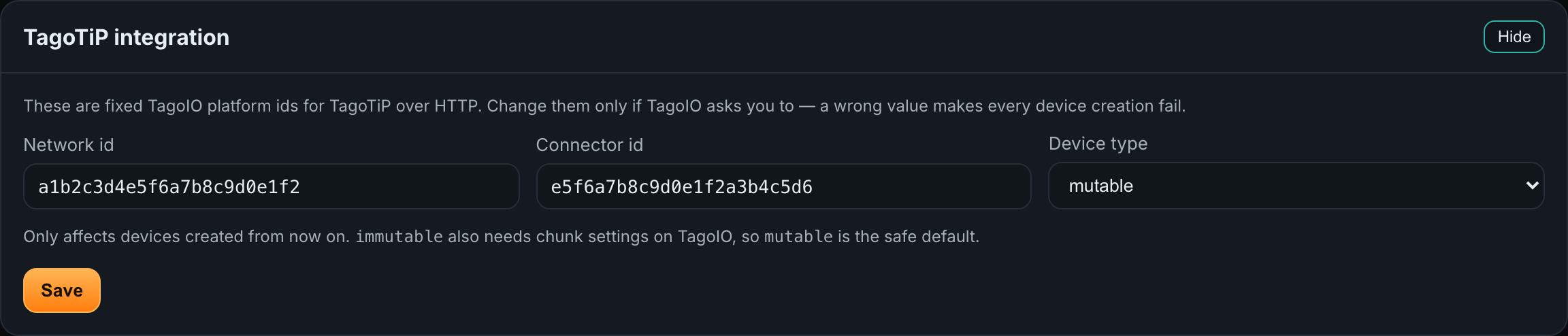

TagoTiP integration
Collapsed by default behind a Show button, because these are fixed TagoIO platform ids for TagoTiP over HTTP. As the panel warns: change them only if TagoIO asks you to — a wrong value makes every device creation fail.
TagoIO > Settings > TagoTiP integration
FieldDetail
Network idThe TagoIO network id for TagoTiP over HTTP.
Connector idThe matching connector id.
Device typemutable (default), immutable or hybrid. Only affects devices created from now on. immutable also needs chunk settings on TagoIO, so mutable is the safe default.

Live push status
TagoIO > Diagnostics > Live push status
CounterMeaning
TagoIO linkReady or Not connected — whether the daemon has usable credentials.
Reporting sensorsHow many sensors the daemon is watching for.
Frames seenSensor frames received for those sensors.
PushedFrames successfully delivered to TagoIO.
FailedFrames TagoIO rejected or that could not be delivered.
Battery / signalIncluded or Off, reflecting the Telemetry setting.

The last 25 pushes, newest first. Each entry shows the outcome chip (Sent, or the failure code), the serial, the time, and how many values the push carried. Beneath that is the actual TagoTiP payload, with each variable name and value shown as its own pill so you can pick a name out of the frame.
TagoIO > Diagnostics > Recent pushes
Two lists follow each payload, and the difference between them is the point:
  • Frame fields — the metadata the sensor’s frame carried, such as battery, RSSI and counter. Sensors disagree about which of these they send.
  • Decoded values — the measurements the sensor’s decoder produced.
If a variable you expect is missing from a TagoIO dashboard, check here first. A name absent from both lists was never sent by the sensor, which is a sensor or decoder question rather than a TagoIO one.
With nothing to show, the panel reads No frames pushed yet. Enable a sensor on the Devices page and wait for its next report.
10Changing Settings from TagoIO
This section is the TagoIO side of the integration — the dashboard the gateway built for you in step 4 of First-Time Setup, and what your team does with it.
Open it from Configuration → Open dashboard, or find the dashboard named NCD Sensor Configuration in your TagoIO account.

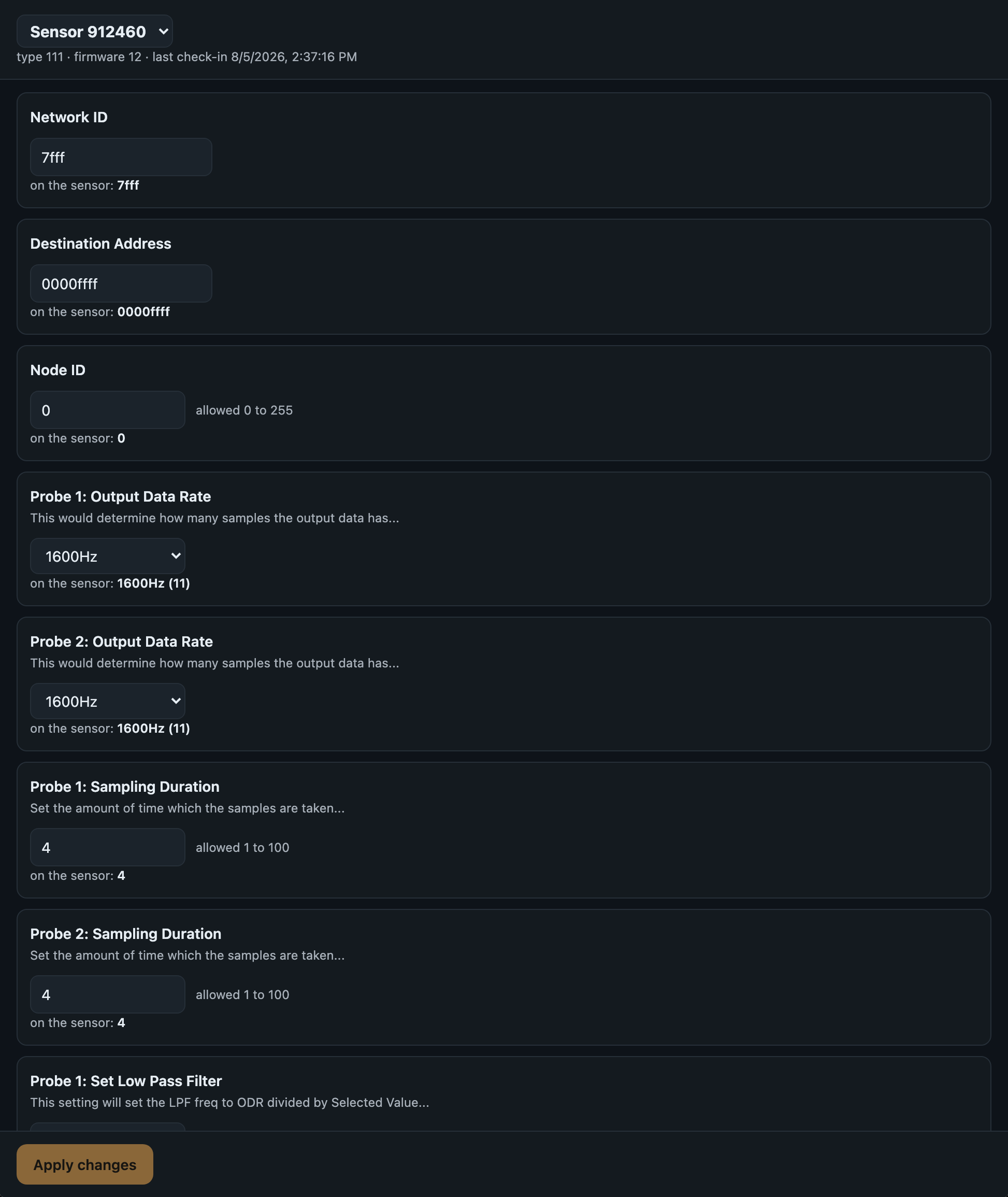

The widget
The dashboard carries one custom widget. When more than one sensor is bound to it, the widget’s title is replaced by a sensor picker, so one widget serves the whole fleet rather than needing one per sensor.
Under the picker is a line reading the sensor’s type, firmware version and last check-in time. That header stays pinned while the settings list scrolls, so you always know which sensor you are editing.
Below it is a form built from that sensor’s own settings list — which is why the gateway publishes the schema, and why a new firmware’s settings appear without anyone updating a dashboard. Each row carries up to five things:
Part of the rowExampleWhat it tells you
TitleSampling IntervalThe setting’s name.
DescriptionSet how often will the sensor transmit measurement data.What the setting does. Comes from the sensor, not from this app.
InputA dropdown, or a number or text boxA dropdown for a fixed set of choices, otherwise a typed value.
Allowed rangeallowed 0 to 255The limits the sensor itself declares. A value outside them is refused.
on the sensor:on the sensor: 5 Minutes (0)The value the sensor currently reports — ground truth, not what was requested. For a choice, the label is shown with its underlying code in brackets.
TagoIO > Dashboards > NCD Sensor Configuration
Applying a change
  1. 1
    Pick the sensor
    Use the picker at the top of the widget. Options are listed alphabetically.
  2. 2
    Edit the settings you want to change
    A count of unsaved edits appears next to the button that acts on them.
  3. 3
    Click Apply changes
    The button sits at the bottom of the widget and stays reachable however long the settings list is. It reads Sending… while it works. A Discard button appears next to it only once you have unsaved edits, and abandons them.
  4. 4
    Wait for the sensor’s next check-in
    The widget shows the change as pending until the sensor confirms it, typically one report interval.
TagoIO > NCD Sensor Configuration > widget
Messages the widget shows
MessageWhat it means
Waiting for this sensor’s settings list.The schema has not arrived yet. The gateway publishes it shortly after the sensor is enabled for TagoIO. Check Schemas published on the Configuration screen.
Waiting for the sensor to wake up and take …The change was accepted and is pending on the hardware. Normal.
Change sent to …The request reached the gateway.
Could not send the change: …The write failed. The reason follows.
Could not read this device’s data: …The widget could not read the device. If it persists, check that the widget is bound to the config_schema variable.
A refusal mentioning Invalid variableTagoIO rejected the write. This usually points at the widget’s variable bindings rather than at the gateway.
The picker shows Sensor 912460 rather than a nameNo name reached the widget for that device, so it falls back to the last six characters of the TagoIO device id. Those six characters are what TagoIO shows in the ID column under Devices, so you can still identify the sensor there. Naming the sensor in Atrium fixes the label on the next metadata sync.
11What the Gateway Publishes
What arrives in TagoIO, and what it is called. This is the section to read before building a dashboard or an Access Management rule.
Device identity
PropertyValue
Serial<prefix>-<address>, for example b00e-42416528. The address is the low four bytes of the 64-bit radio address, since all such addresses share the same leading bytes. Permanent once the device exists.
NameThe sensor’s Atrium name, falling back to its decoder name and then its device id.
Telemetry variables
Each sensor frame becomes one TagoTiP group. Decoded values keep the names Atrium normalizes them to, so live and replayed values land on the same TagoIO variable. Numeric strings are converted to numbers so TagoIO can chart them; booleans stay booleans.
Alongside the decoded values, whichever of these the frame carried is sent:
VariableUnit sentNotes
batteryVVolts. Sent by sensors that report voltage.
battery_percent%Only with Send battery and signal strength on.
rssidBmOnly with Send battery and signal strength on.
counternoneThe frame counter.
humidity%Where the sensor reports it.
Sensors disagree about which frame fields they report, so whichever are present are sent rather than a fixed set being assumed. If a decoder already reports a value itself, that wins over the frame-level copy, so nothing is published twice.
TagoIO > Devices > device > Data

A sensor is missing from the Devices listThe list only shows sensors Atrium has already set up.Complete Sensors → Set Up in Atrium for that sensor, then come back.
A device stays PendingTagoIO was unreachable, or the creation is being retried with backoff.Wait — retries run every 60 seconds, backing off to at most an hour. Retry pending forces an attempt now. If it never succeeds, use Verify now on the Connection screen.
Serial ‘…’ is already in useAnother mapping already holds that serial.Find the device holding it (filter by serial) and Remove it, which is the only way to free a serial.
State Failed mentioning the network or connectorThe TagoTiP integration ids in Settings are wrong.Restore the defaults under Settings → TagoTiP integration. A wrong value makes every device creation fail.
Tags limit reachedThe TagoIO device already has 30 tags.Remove some of your own tags from that device in TagoIO. The app needs its ten, plus config_rev when configuration is in use.
The prefix field is greyed outDevices are mapped, and serials are permanent on TagoIO.Remove every mapped device first, which deletes them in TagoIO. Prefer setting the prefix before enabling anything.

Last push stays —The sensor has not reported since it was enabled.Sensors report on their own schedule, often every 10 minutes. Confirm Last seen is recent, then wait for the next frame.
push: server_error and The device has reached the limit of 50000 data registersThe TagoIO device is full. This is a TagoIO account limit, not a gateway fault.Free data records in TagoIO for that device, or raise the plan limit. Turning off Send battery and signal strength reduces how fast the limit is reached.

Diagnostics shows a high Failed countPushes are being rejected — commonly a full device or an authorization problem.Read the failure chip on the newest entries in Recent pushes; it carries TagoIO’s own code.
TagoIO > Configuration > sensor card with an error

Changes are ignored entirelyAccept settings changes from TagoIO is off.Enable it under Settings → Sensor configuration. The Configuration screen warns when it is off.

The validator sits at Working…TagoIO is still bundling the Analysis.Wait, then press Check and repair. This is a TagoIO-side job, not a gateway error.

How a settings change travels
path TagoIO to sensor and back
TagoIO widget  ->  Trigger  ->  Validator  ->  device parameters (pending)
                                    gateway notices the revision move
                                                       v
                              gateway validates against the sensor's options
                                                       v
                                        radio  ->  sensor applies it
                                       sensor reports what it applied
                                                       v
                                    acknowledged back to TagoIO (pending clears)
Two properties of that path are worth remembering. The gateway validates every value against the sensor’s own options before anything reaches the radio, independently of TagoIO having validated it. And a change is acknowledged only once the sensor confirms it, which is why a dashboard’s pending state is meaningful rather than cosmetic.
What the app stores on the gateway
Everything the app keeps is bounded by the number of sensors on the gateway, so there is no retention policy to manage and no growth to watch.
  • No telemetry is ever copied. Only a cursor per device — the newest reading confirmed delivered. That is what makes replay work without a retry queue: a failed push simply leaves the cursor behind.
  • The TagoIO link: region, both credentials encrypted at rest, the derived authorization hash, and the account and profile the token belongs to.
  • One row per enabled sensor: its serial, sync state, TagoIO ids, retry and push bookkeeping.
  • One settings schema per sensor type and firmware, rather than per sensor, so a fleet of identical sensors stores one copy.
  • Requested settings, and the last settings each sensor reported.
Artifacts created in your TagoIO account
ArtifactName in TagoIO
Analysis (the Validator)NCD Sensor Configuration
Action (the Trigger)NCD Sensor Configuration
DashboardNCD Sensor Configuration
Widget fileatrium/sensor-config/<content-hash>/index.html in the account’s Files
All four are tagged atrium_managed=1. The content hash in the widget path means an upgraded widget arrives at a new address, so nobody is left looking at a cached copy of the old one.
