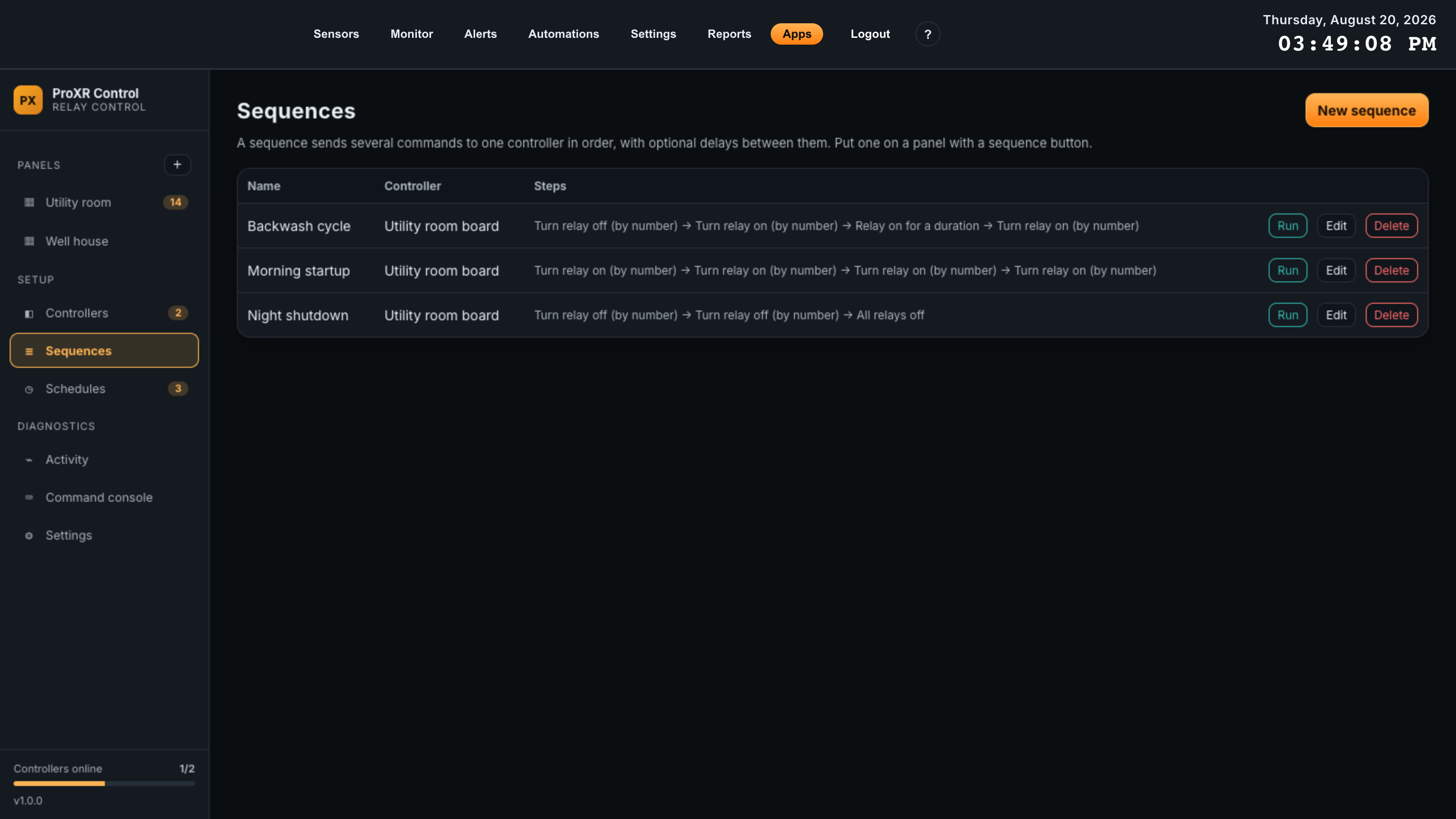

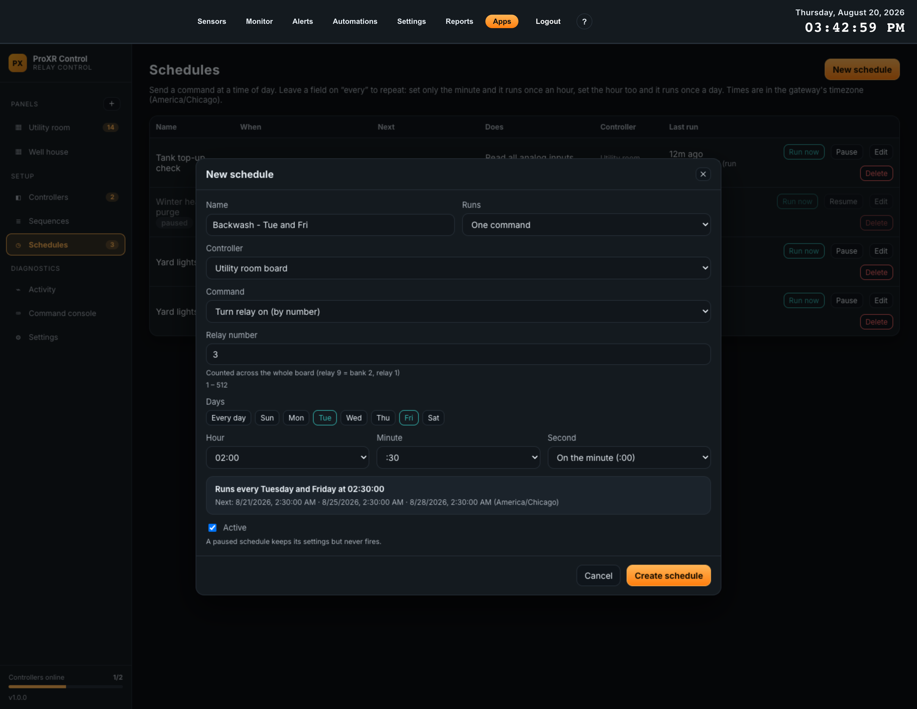

Sequences run several commands in order. Schedules fire a command or a sequence at a time of day, in the gateway’s timezone.

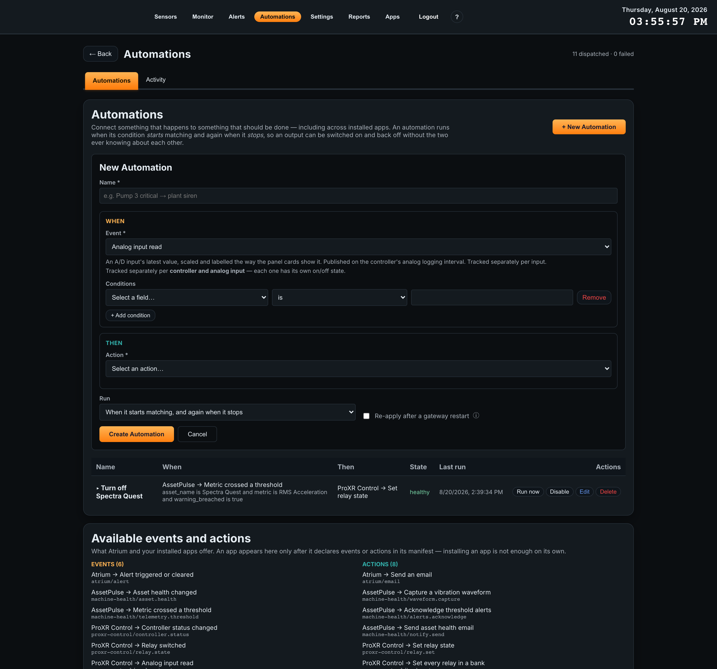

  • It reads no sensor telemetry. ProXR boards are not sensors, so nothing the app does appears on the gateway’s Sensors, Monitor or Reports pages.
  • It cannot authorize its own hardware. Registering a board’s radio is an operator action on the gateway, covered in First-Time Setup.
  • It does not watch the inter-app bus. It publishes its own state and offers commands, but you decide on the gateway’s Automations page what connects to what.

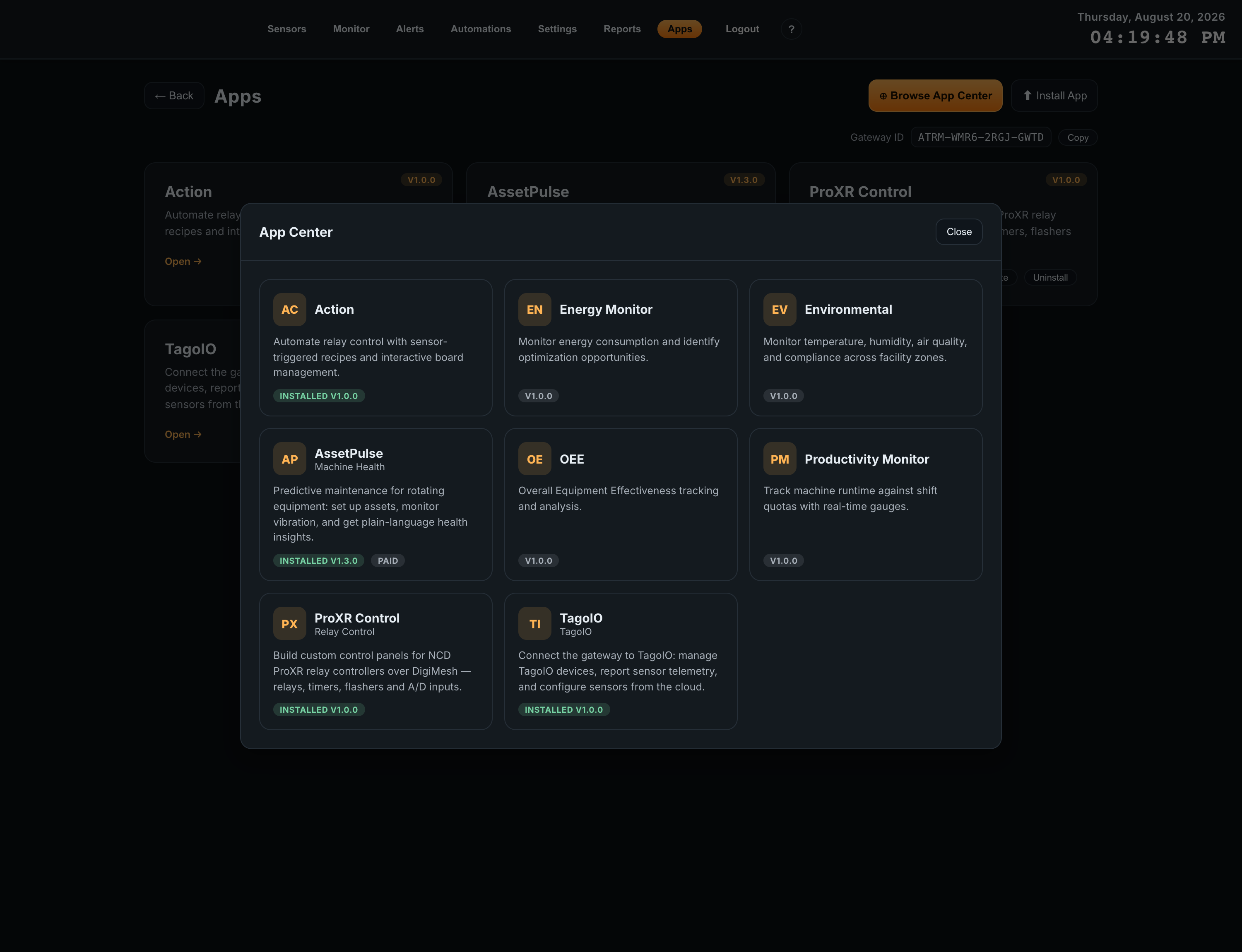

ProXR Control installs like any other Atrium app, from the App Center or from a package file. Nothing about the install needs a ProXR board present.
From the App Center
  1. 1
    Open Apps
    Click Apps in the gateway’s top navigation.
  2. 2
    Click Browse App Center
    The catalog lists every app available to this gateway. Apps already installed are marked INSTALLED with their version.
  3. 3
    Choose ProXR Control
    The tile shows the icon PX and the subtitle Relay Control. Install it, and the gateway restarts its API and ingest services when the install finishes.

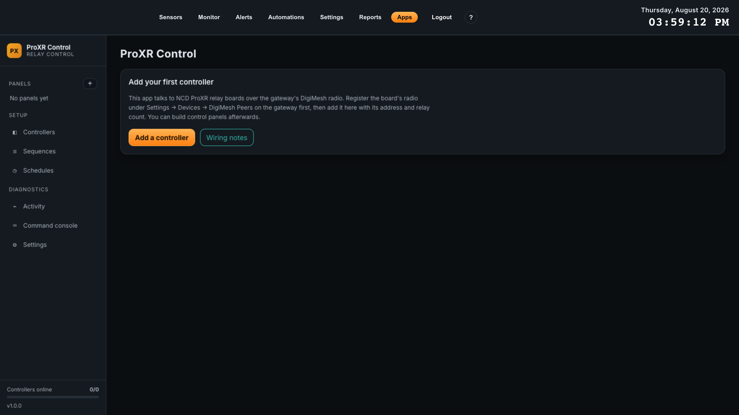

04First-Time Setup
Four steps get you from a freshly installed app to a board that answers. The first two happen outside the app — on the gateway and on the radio — and they are where almost every commissioning problem comes from.
proxr atrium app guide 04 first run
Apps > ProXR Control. What the app looks like before any controller exists.

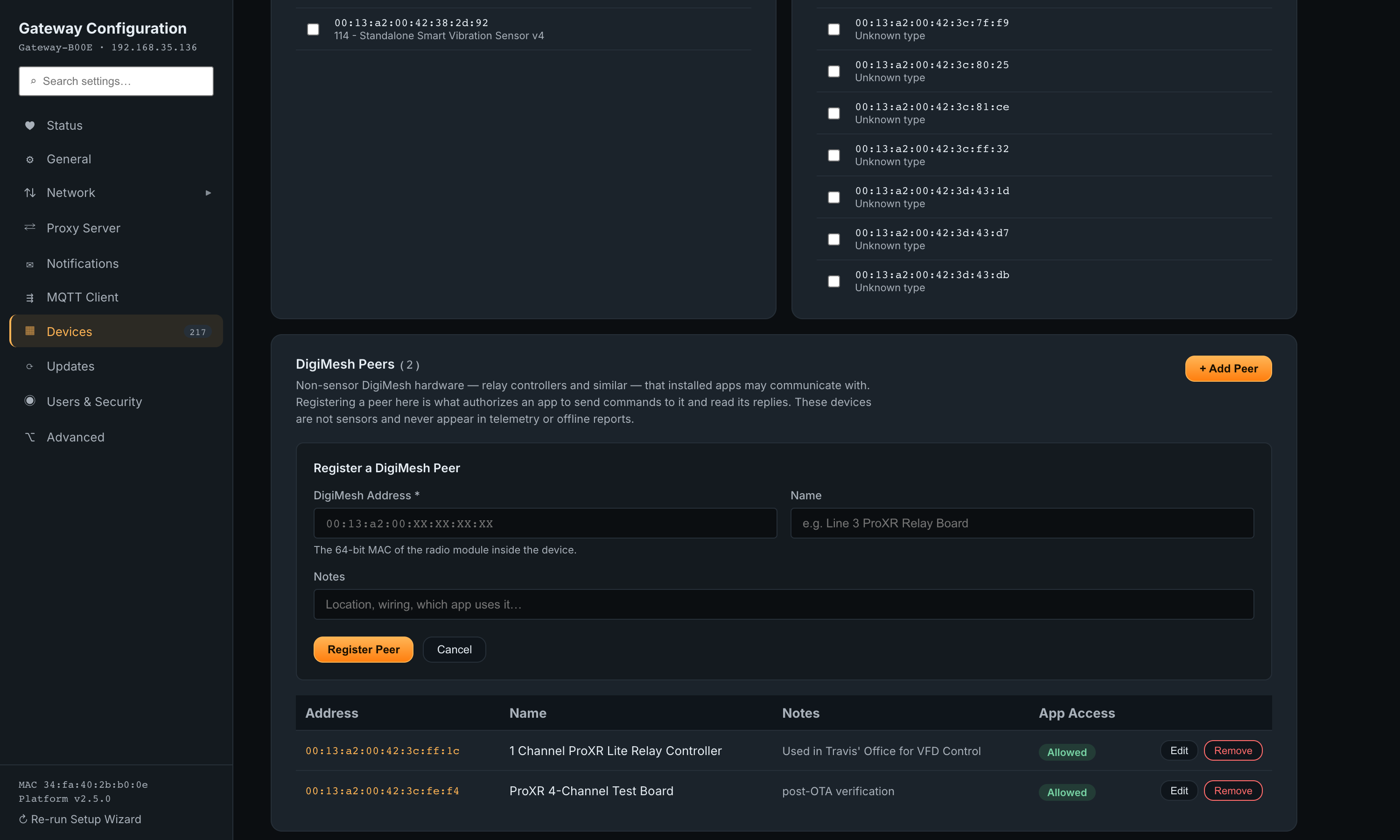

1. Register the radio as a DigiMesh peer
An app can never grant itself permission to talk to radio hardware. Registering a peer is the authorization, and only an operator can do it. Until the board’s radio is registered, ProXR Control shows the controller as not connected and names the address you need to add.
  1. 1
    Open Settings > Devices
    Scroll past the sensor whitelist and blacklist to the DigiMesh Peers panel at the bottom of the page.
  2. 2
    Click + Add Peer
    Enter the DigiMesh Address — the 64-bit MAC of the radio module inside the controller, not the controller’s own part number. A Name and Notes are optional but worth filling in; the name is what the app offers you in its address dropdown.
  3. 3
    Click Register Peer
    The peer appears in the table with App Access: Allowed. Registered peers are not sensors and never show up in telemetry or offline reports.
proxr atrium app guide 05 digimesh peers
Settings > Devices > DigiMesh Peers. Registering a peer here is what authorizes an app to command it.
proxr atrium app guide 06 digimesh add peer
Settings > Devices > DigiMesh Peers > Add Peer. The address is the radio module’s 64-bit MAC.

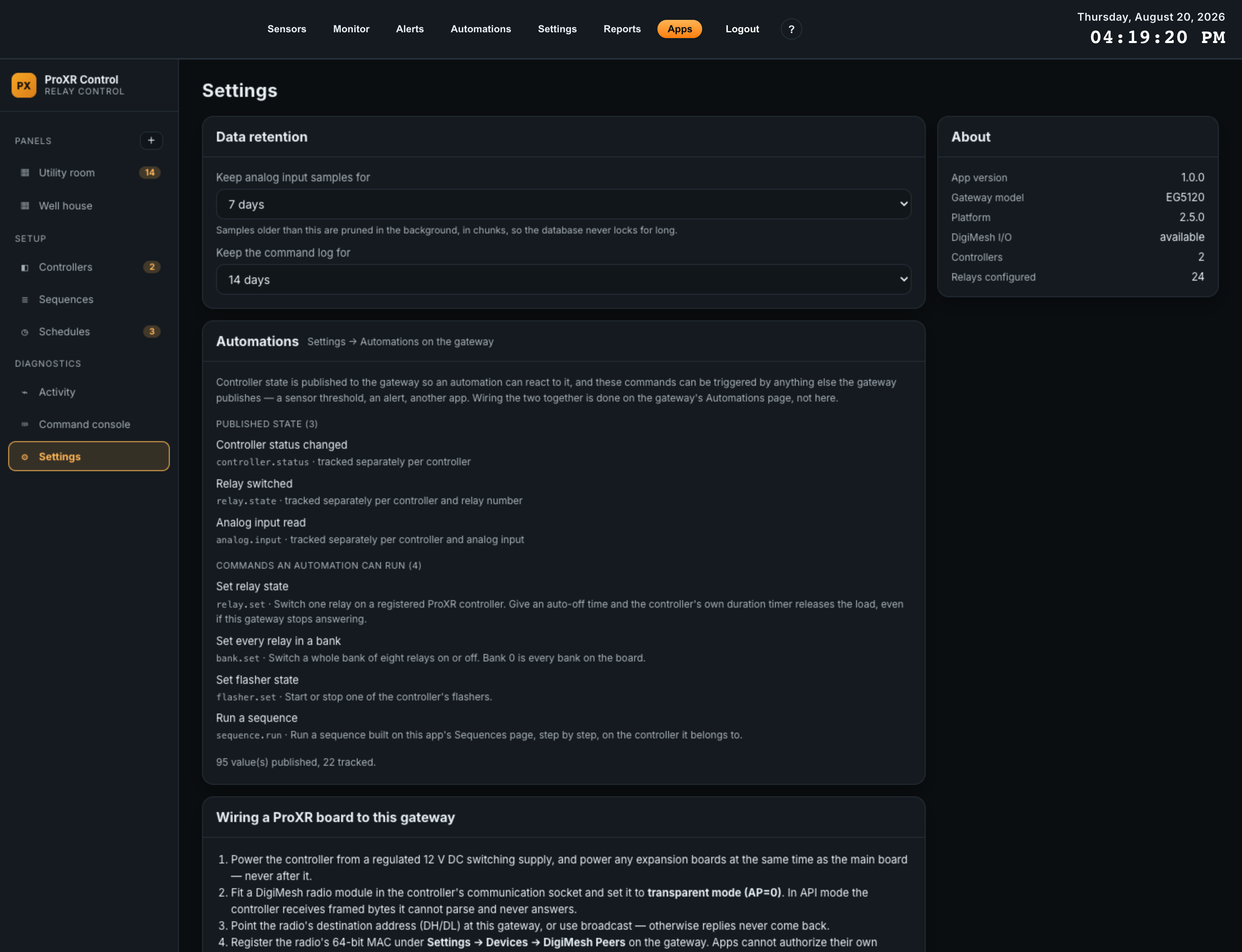

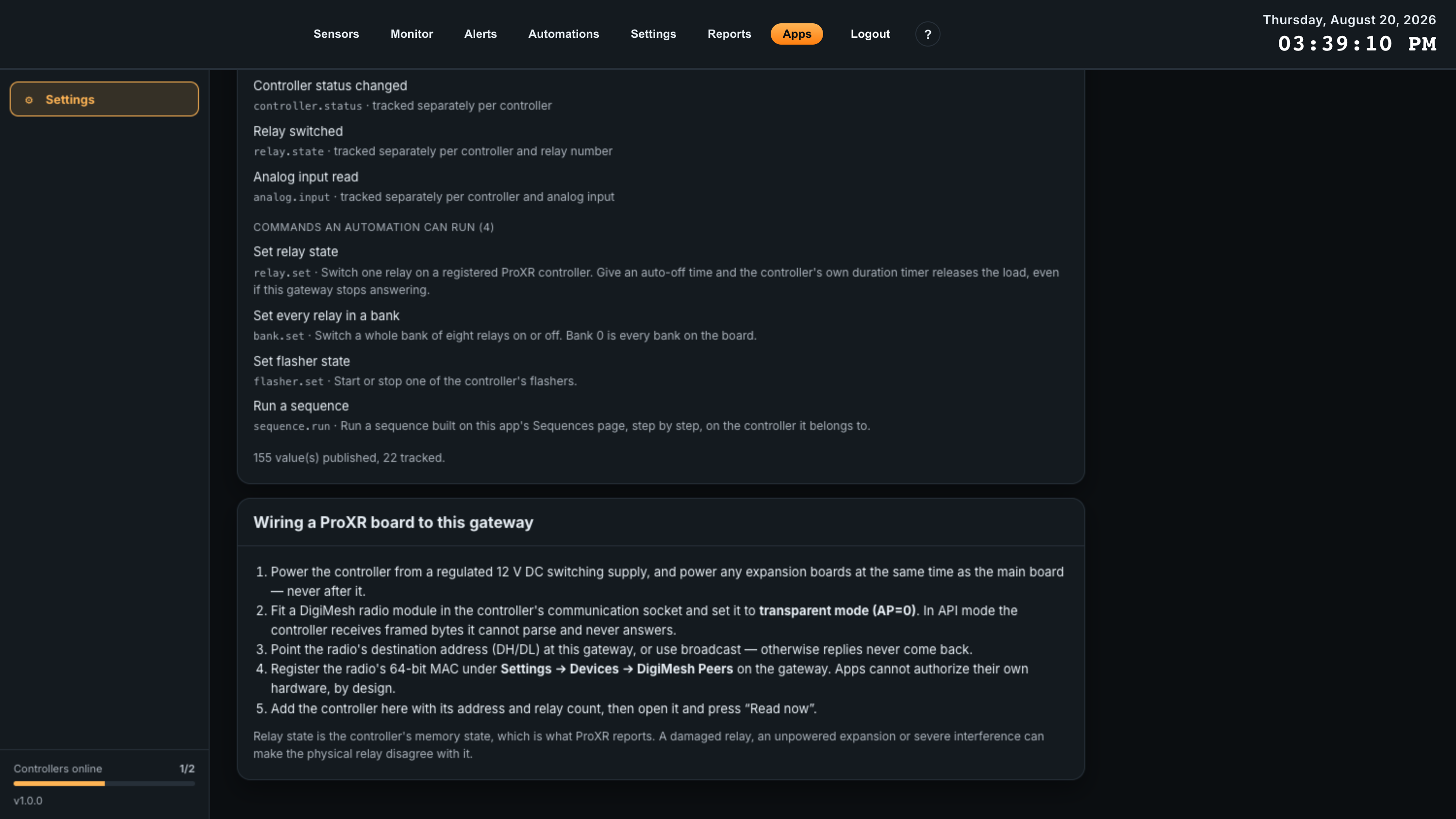

2. Set the radio mode and destination
The radio in the ProXR board has to pass bytes through untouched, and it has to send the board’s replies back to this gateway. Two settings decide both.
SettingValueWhat goes wrong otherwise
AP (API enable) 0 — transparent mode In API mode the controller receives framed bytes it cannot parse and never answers. The gateway still reports the transmit as delivered, so the failure looks like a dead board.
DH / DL (destination) This gateway’s radio address, or the broadcast address The board answers, but the reply goes somewhere else. The app sees timeouts on every read.
The app repeats this list on its own Settings page, under Wiring a ProXR board to this gateway, so an operator standing at the panel does not need this document.
proxr atrium app guide 07 settings wiring
ProXR Control > Settings. The wiring and radio checklist, repeated inside the app.

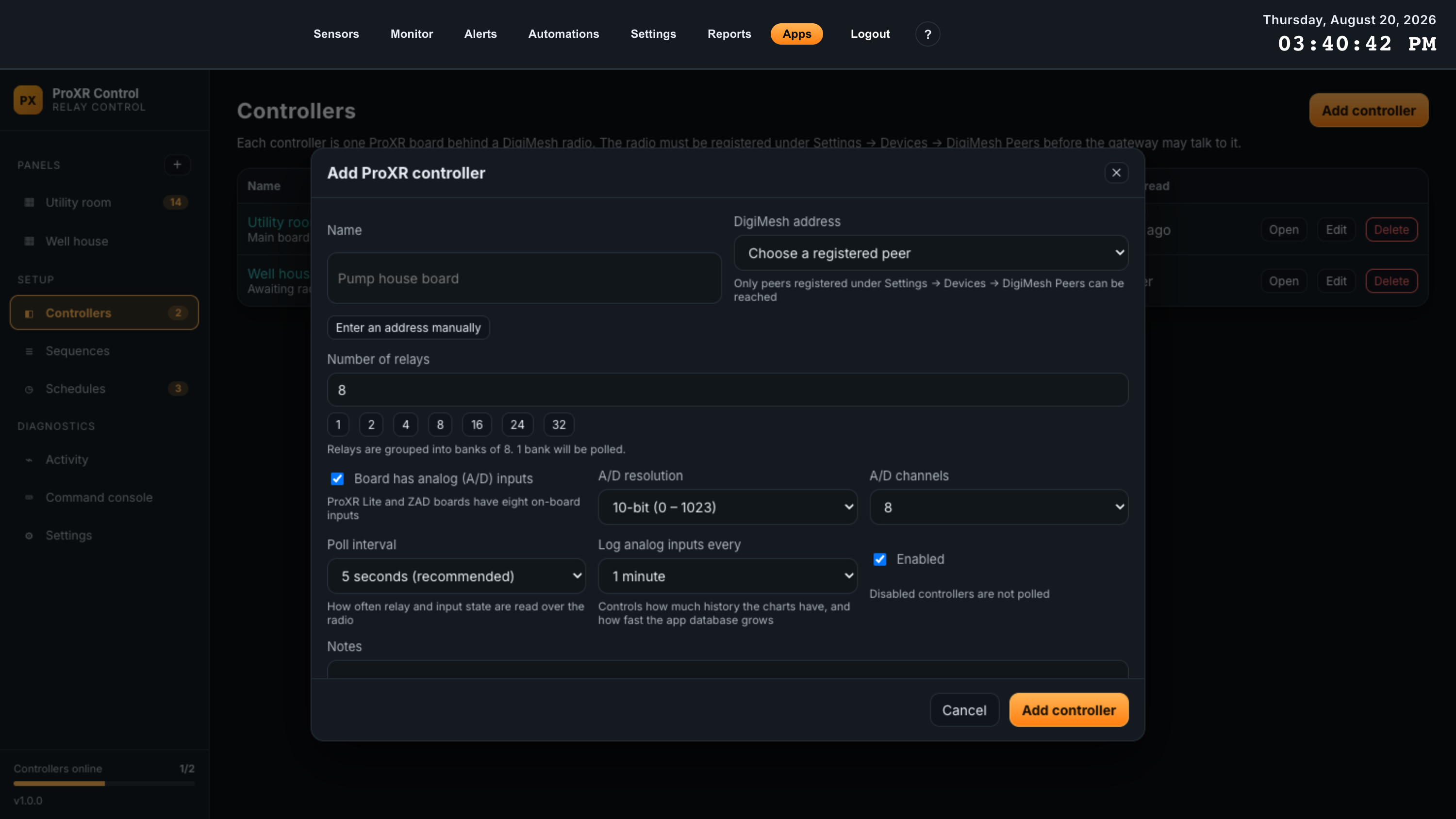

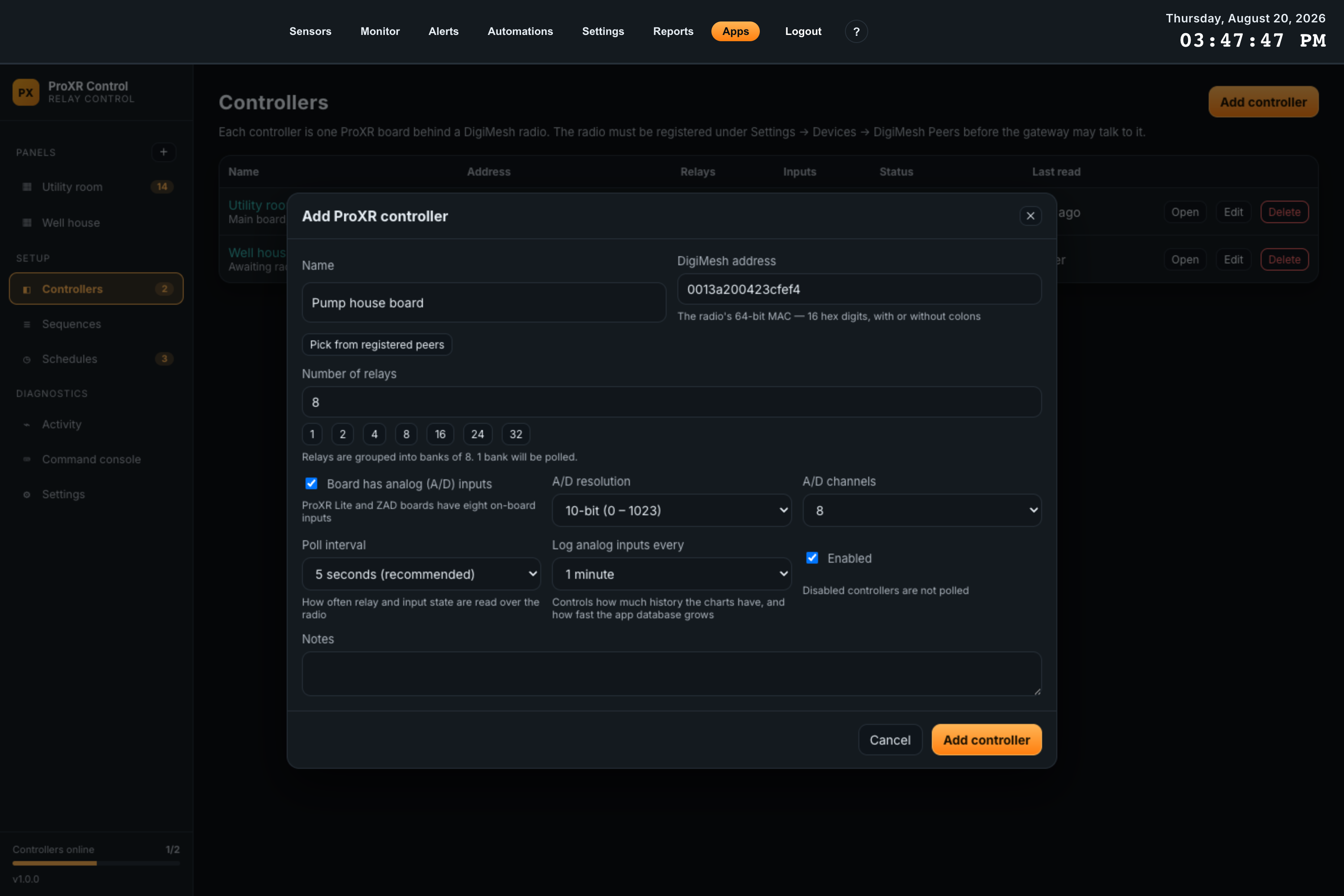

3. Add the controller in the app
Open Controllers in the app’s sidebar and click Add controller. Only three fields matter to get a board answering: the name, the address and the relay count. Everything else has a sensible default and can be changed later.
proxr atrium app guide 08 controllers empty
ProXR Control > Controllers. The page before any board is registered.
proxr atrium app guide 09 controller add
Controllers > Add controller. With peers registered, the address is a dropdown rather than something to type.
proxr atrium app guide 10 controller add manual
Controllers > Add controller > Enter an address manually. Use this when the peer is not registered yet.
The address accepts the 64-bit MAC with or without colons — 0013a200423cfef4 and 00:13:a2:00:42:3c:fe:f4 are the same board. The relay count sets how many banks get polled: relays are grouped in eights, and the dialog tells you how many banks that works out to as you type.
Every field on this dialog is documented in Controller settings.

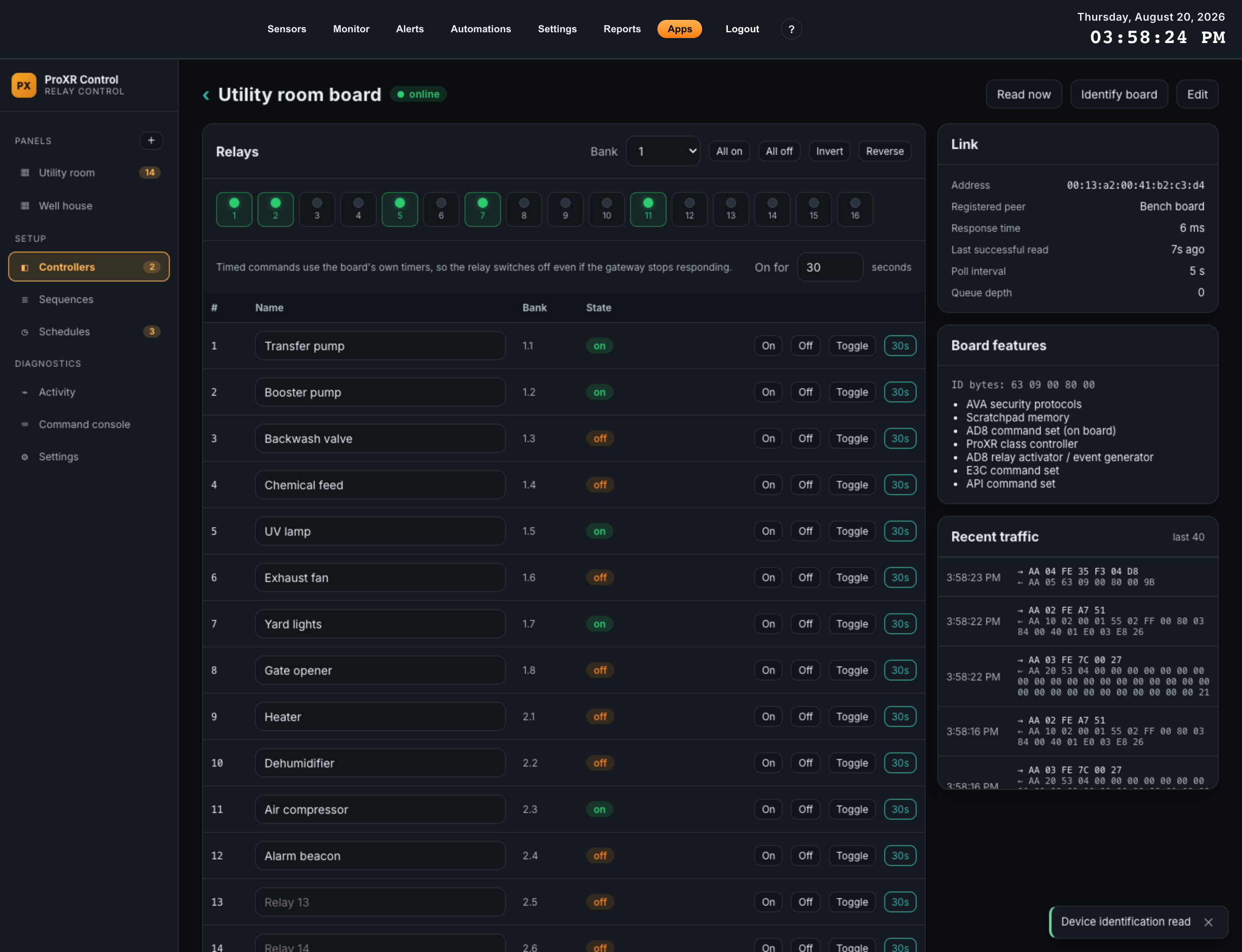

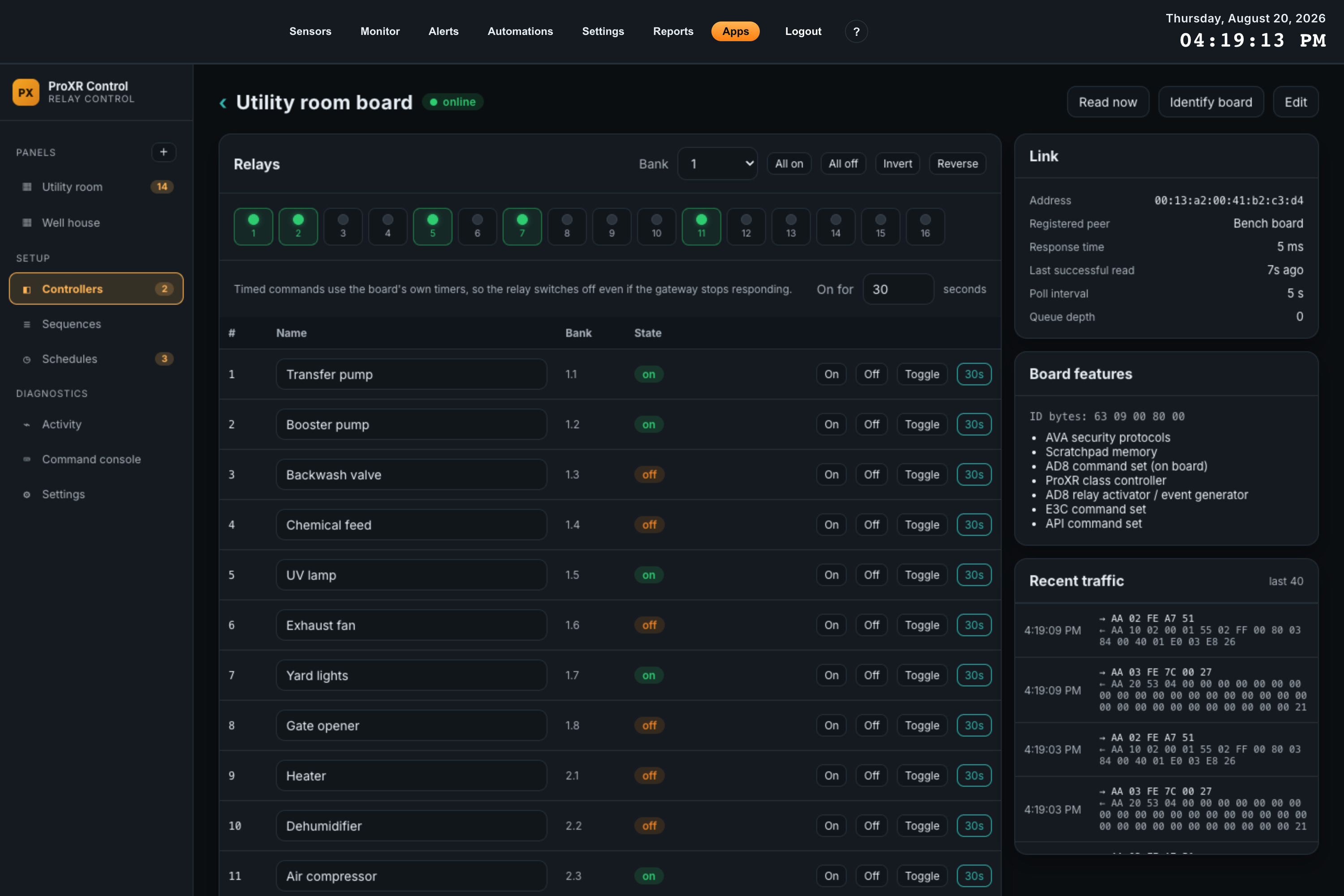

4. Prove the link before you build anything

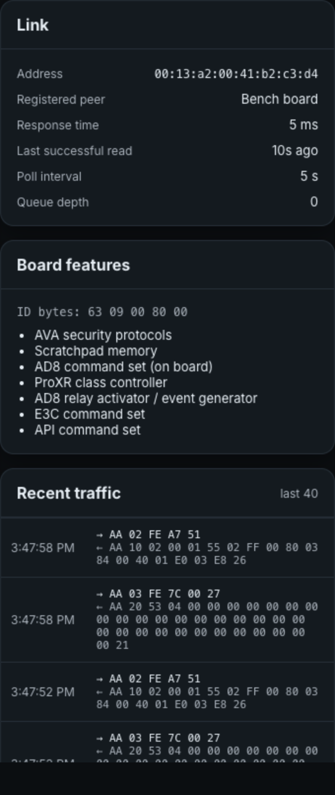

Open the controller and press Read now. A board that is wired, powered, authorized and in transparent mode answers within a few hundred milliseconds, and the header chip turns to online.
  1. 1
    Press Read now
    This polls the board immediately instead of waiting for the next poll interval. Response time in the Link panel fills in, and Last successful read becomes just now.
  2. 2
    Press Identify board
    The controller reports which command sets it implements. The Board features panel then lists them, with the raw identification bytes above. This is the fastest way to confirm you are talking to the board you think you are.
  3. 3
    Check Recent traffic
    Outbound frames with no reply mean the board is not answering. Frames in both directions mean the link is good and any remaining problem is a configuration one.
proxr atrium app guide 11 toast
Controllers > Utility room board > Identify board. Confirmations appear briefly at the corner of the screen.
With the board answering, go to Creating a panel. If it is not answering, work through Troubleshooting — the symptom table is ordered by how often each cause actually turns out to be the problem.

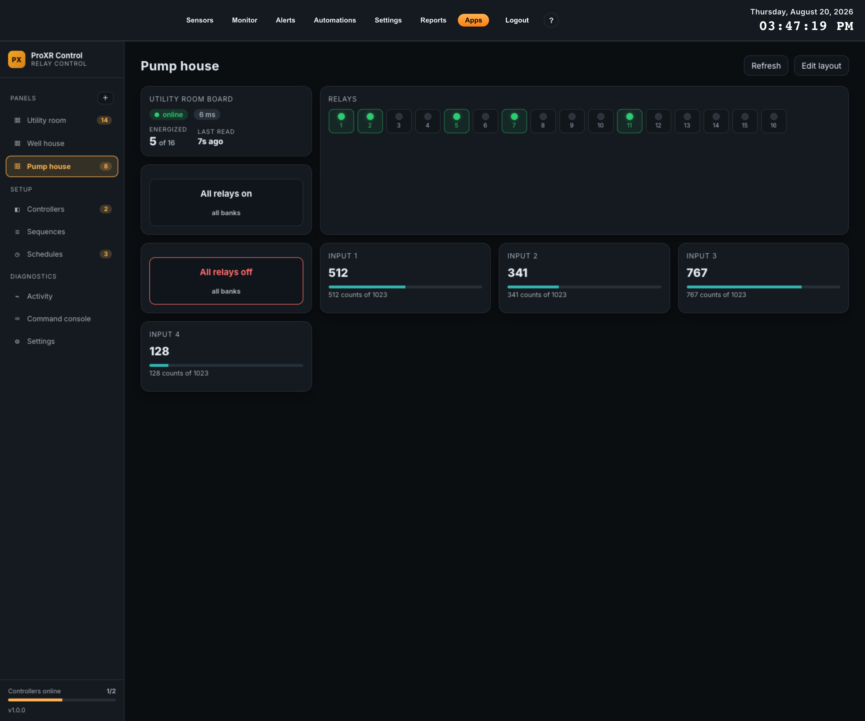

05Overview Screen
The app’s landing screen answers one question at a glance: is everything talking, and what is currently on. It is also the setup path when nothing is configured yet.
proxr atrium app guide 12 overview
Apps > ProXR Control. One card per controller, then the list of panels.
The header
The count beside the title reads online / total — how many controllers answered their most recent poll out of how many are configured. The same figure appears at the bottom of the sidebar as a bar, along with the installed app version.
Each card names the controller, shows its state chip, draws a lamp for every relay on the board, and reports how many are energized. Clicking the controller’s name opens its controller page.
ChipMeaningWhat to do
onlineThe board answered its most recent poll.Nothing.
no replyThe radio is authorized and the gateway is transmitting, but the board is not answering.Check power, the radio’s AP mode and its DH/DL destination.
not connectedThe gateway is not allowed to talk to this address — the peer is missing or disabled.Register or re-enable the peer under Settings > Devices > DigiMesh Peers.
pausedThe controller is configured but its Enabled box is cleared, so it is not polled at all.Edit the controller and tick Enabled.
Below the lamps, the card reports how many relays are on out of the total, how many analog inputs are reading, and the board’s address. If the last exchange failed, the error and its age replace the “Last reply” line, in red.

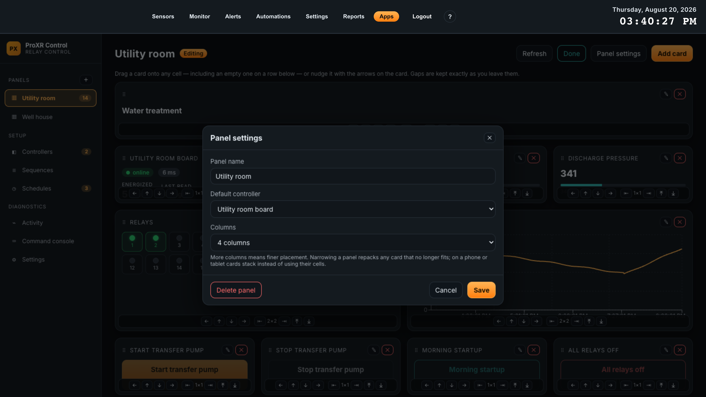

A panel is the screen an operator uses day to day. You build it from cards, arrange them on a grid, and from then on nobody needs to know anything about ProXR command codes.
Panel anatomy
Panels live at the top of the sidebar, above Setup, each with the number of cards it holds. The panel itself has two controls when you are not editing it:
ControlEffect
RefreshRe-reads live state for every controller immediately, instead of waiting for the automatic 5-second refresh.
Edit layoutSwitches the panel into editing mode: cards gain a drag handle and a move/resize bar, and the header gains Panel settings and Add card. Command buttons are deliberately inert while editing, so you cannot fire a load by clicking a card you meant to drag.
While a panel is open, a yellow banner names any controller used by its cards that is not authorized yet, so a panel that looks dead explains itself.

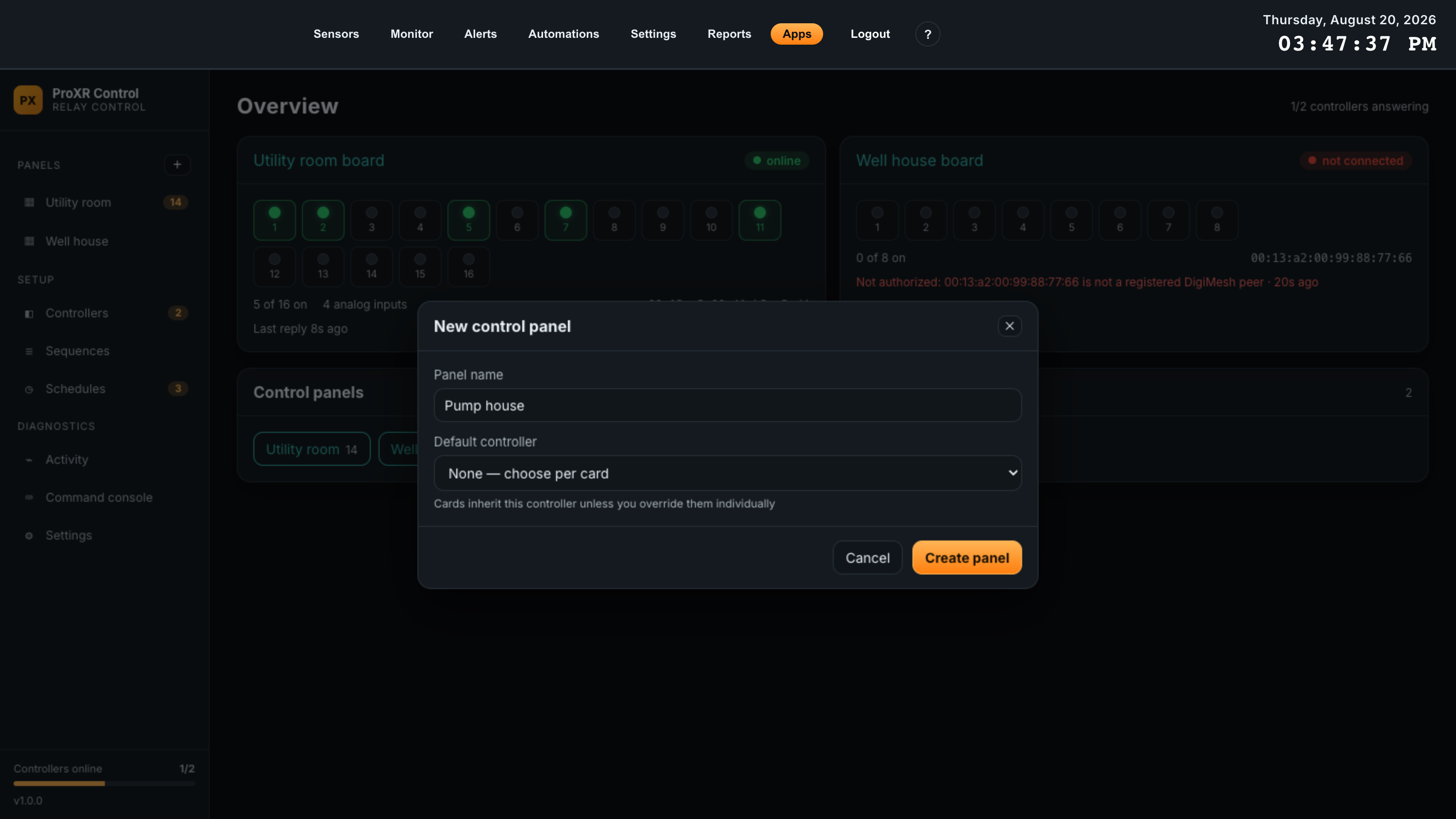

Creating a panel
  1. 1
    Click the plus beside PANELS in the sidebar
    The New control panel dialog opens.
  2. 2
    Name the panel
    Name it after the place or the process an operator thinks in — Utility room, Line 3, Pump house. The name is the sidebar entry.
  3. 3
    Choose a default controller
    Cards inherit this controller unless you override them one by one. Leave it on None — choose per card only if the panel really does drive more than one board.
  4. 4
    Click Create panel
    The app opens the new, empty panel.
proxr atrium app guide 13 panel new
Sidebar > PANELS > plus. Naming a panel and giving it a default controller.
proxr atrium app guide 14 panel empty
A new panel. Either place cards yourself or let the app generate a starter set.

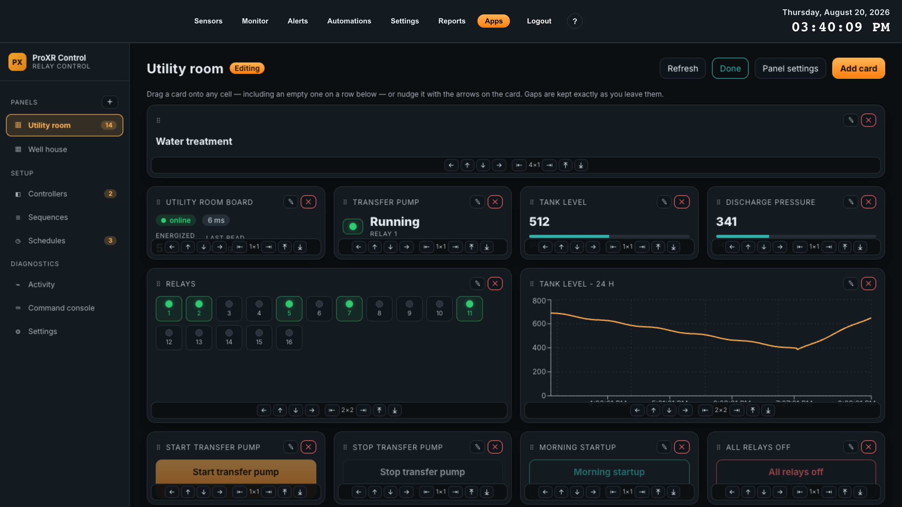

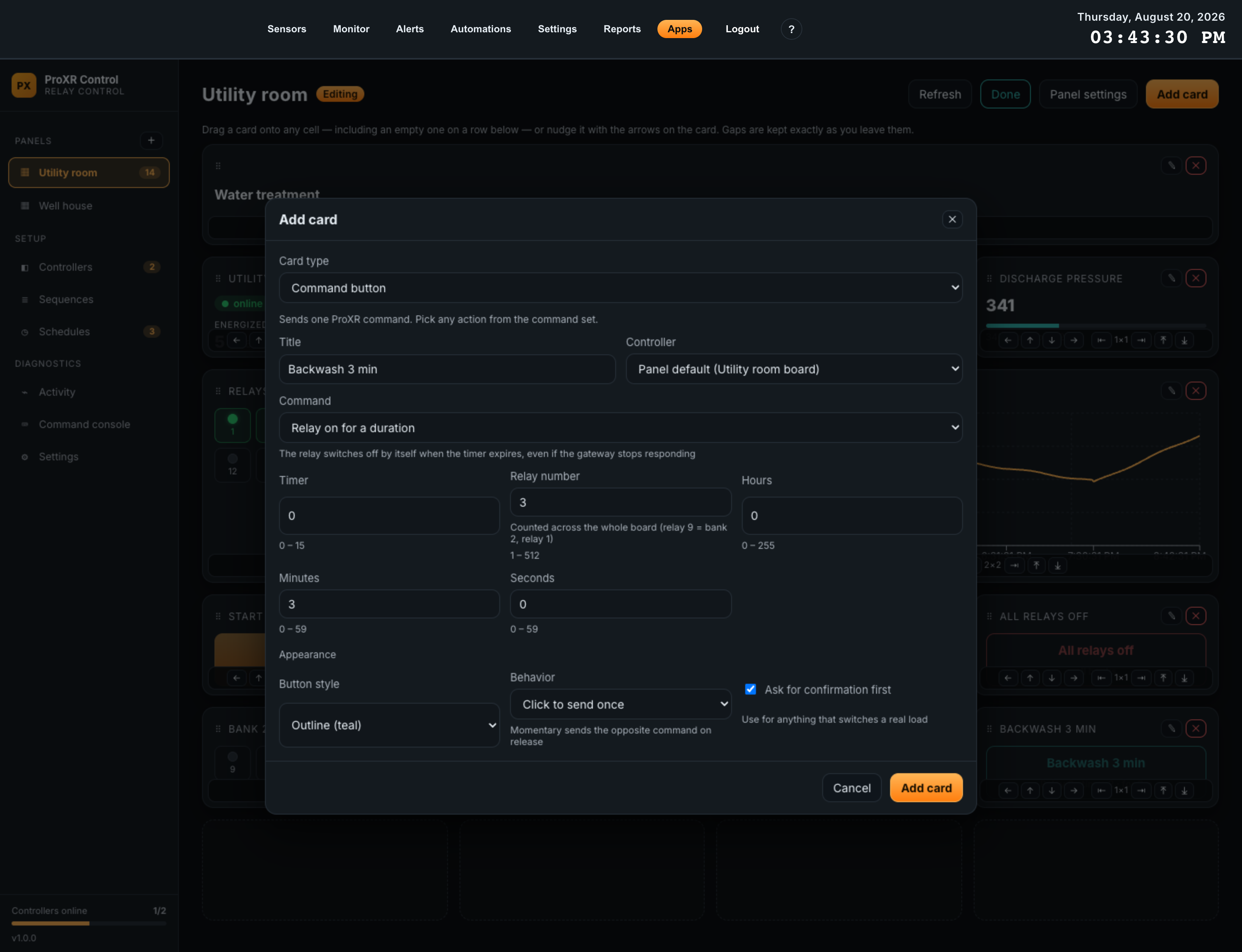

Adding cards
In editing mode, Add card opens a form that is generated from the installed app’s own catalogs — so it always offers exactly what this version supports, and it can never let you save something the board would reject.
proxr atrium app guide 16 panel add card
Panel > Edit layout > Add card. A timed command button, complete with the note that the controller switches the relay off by itself.
FieldWhat it doesDefault
Card typeWhich of the nine card types this is. Changing it resets the parameters and appearance options below to that type’s defaults. A one-line description of the selected type appears underneath.Command button
TitleThe card’s heading, or the button’s label. Left empty, the card falls back to a generated title — the command’s name for a button, Relay N for a relay card, Bank N for a bank card, Input N for an analog card, the controller’s name for a status card.Empty
ControllerWhich board this card drives. Left on the panel default, it follows the panel. Absent for the Section heading card, which drives nothing.Panel default
CommandCommand buttons only. A dropdown of all 42 ProXR commands, grouped as Relays, Banks, Timers, Flashers, Read, Refresh, Configuration and Advanced. Commands with a caveat show it under the dropdown — for example that Toggle relay needs ProXR firmware 3.9 or later.Turn relay on
SequenceSequence buttons only. Which saved sequence to run. Only sequences belonging to the selected controller are offered.None
Command parametersWhatever the chosen command or card type needs — relay number, bank, pattern, timer index, hours/minutes/seconds, channel, flasher. Each field shows its permitted range underneath and is validated on save.Per command
AppearanceThe card type’s display options: button style, click or momentary behavior, confirmation, meter visibility, relay numbering, chart time span, on/off labels.Per card type

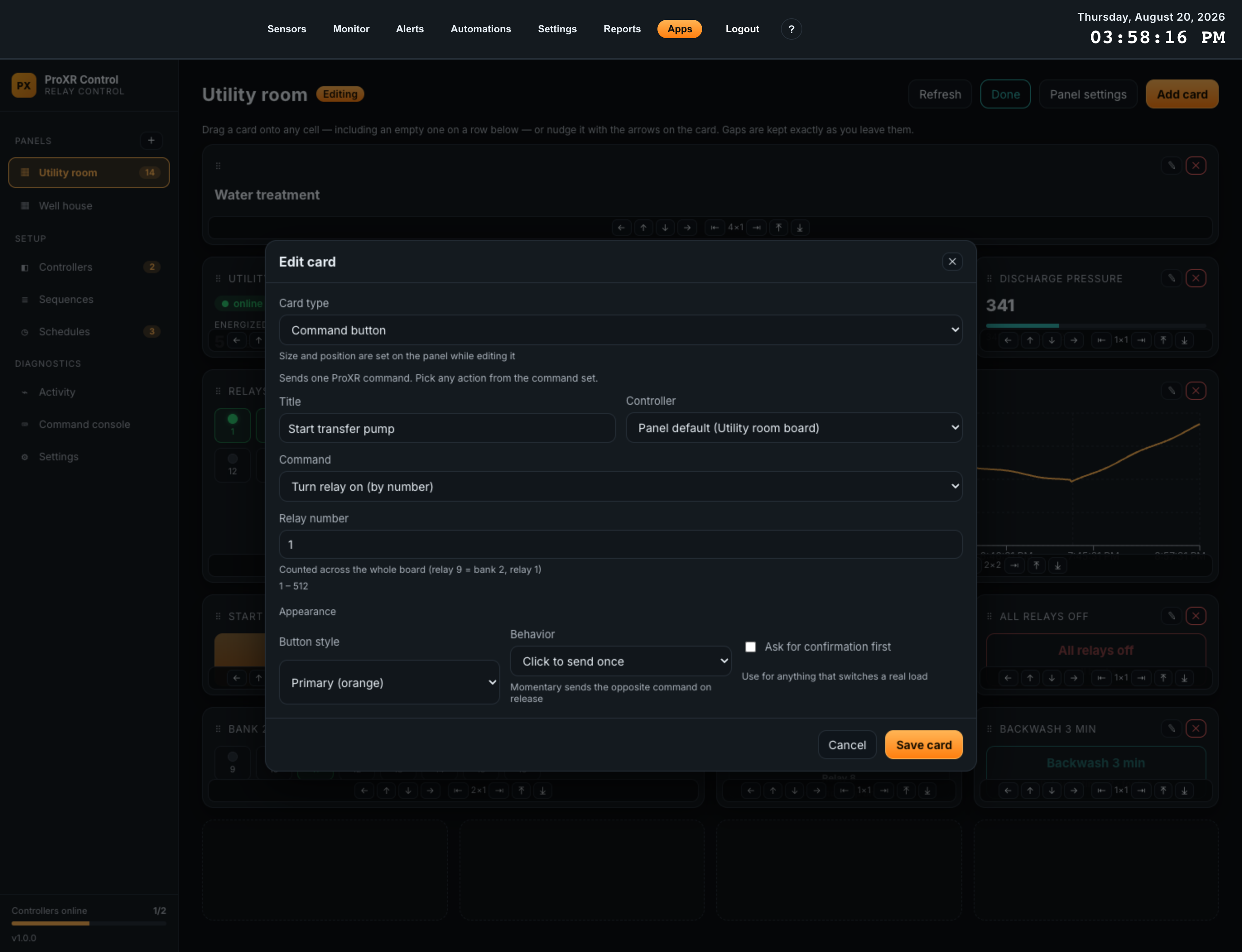

Editing and removing a card
In editing mode each card carries two icon buttons: a pencil that reopens the same form, and a red cross that removes the card after a confirmation. Removing a card affects the panel only — the controller and its relays are untouched. The edit form is identical to the add form except that it reminds you size and position are set on the panel itself.
proxr atrium app guide 17 card edit existing
Panel > Edit layout > pencil icon. Editing an existing card.

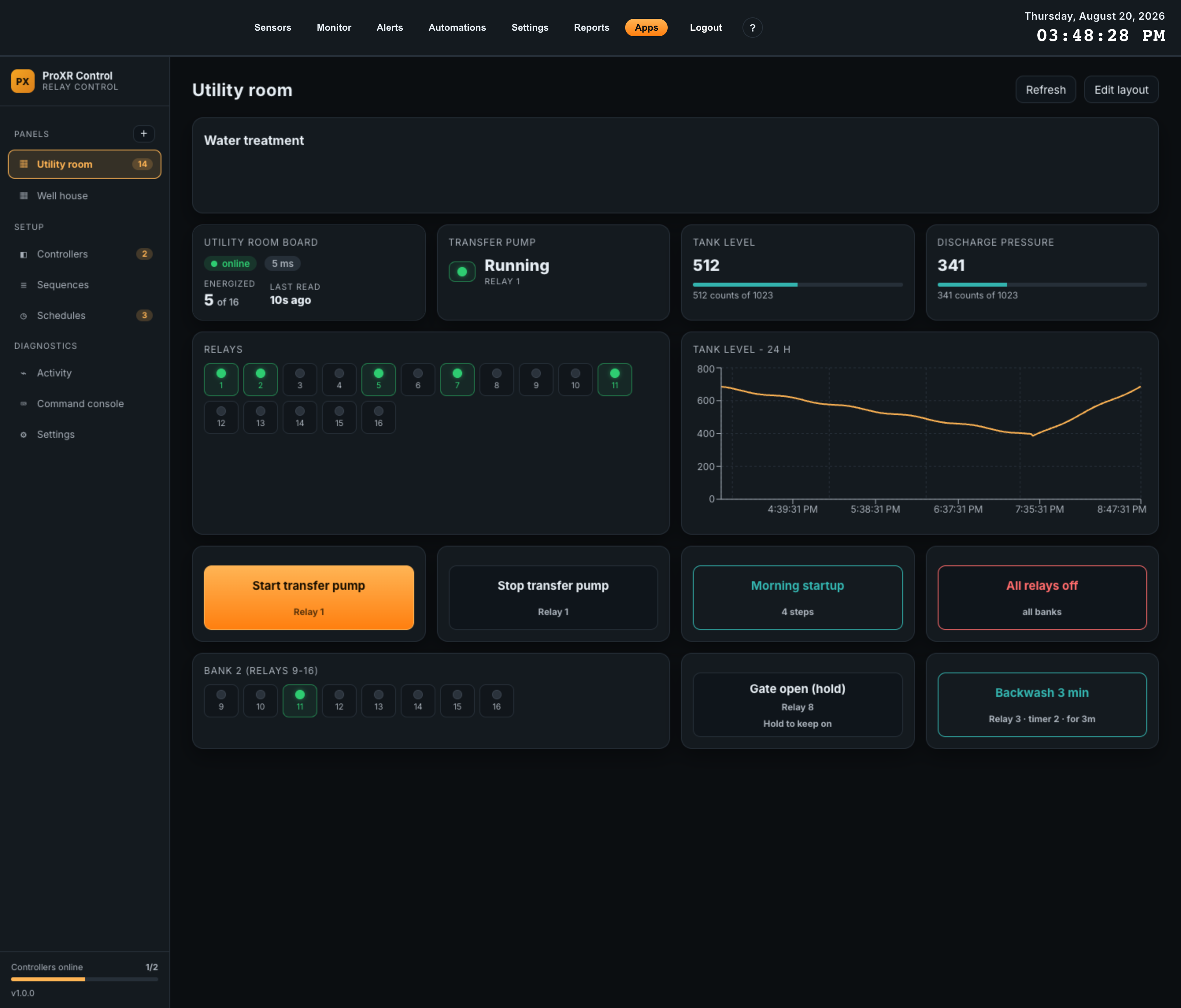

Card typeShowsOptionsDefault size
Command button A button that sends one ProXR command. Under the label it summarises what the command targets — the relay, the bank, the timer and duration — so two buttons on the same command are still tellable apart. Button style (Neutral, Primary orange, Outline teal, Destructive red); Behavior (Click to send once, Momentary); Ask for confirmation first 1 × 1
Sequence button A button that runs a saved sequence, with its step count underneath. Reads Sequence was deleted and goes inert if the sequence is gone. Button style; Ask for confirmation first 1 × 1
Relay state card One relay as a large lamp plus a word. Shows a dash and an unlit lamp until the relay has actually been read. Label when on (default On); Label when off (default Off) 1 × 1
Relay grid Every relay on the board as a lamp. Optionally clickable to toggle. A relay that has never been read is drawn dimmed, not off. Click a relay to toggle it (default on); Show relay numbers (default on) 2 × 2
Bank indicator The eight relays of one bank as a row of lamps. Read-only. Bank (1 – 32); Show relay numbers 2 × 1
Analog input card One A/D input as a large number, with a level meter and the raw count beneath it. Analog input (1 – 8); Show a level meter (default on) 1 × 1
Analog input chart A trend of one A/D input drawn from logged samples. Grows to whatever height you give the card. Analog input; Time span in hours (1 – 720, default 24) 2 × 2
Controller status Link chip, radio round-trip time, how many relays are energized out of the total, and how long ago the last successful read was. Shows the last error when the board is not answering. None 1 × 1
Section heading Plain text for grouping cards. Drives nothing and has no controller. Text 4 × 1

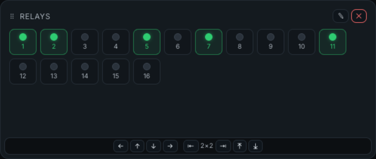

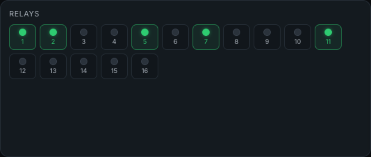

proxr atrium app guide 19 relay grid card
A relay grid card. Lit means the controller reports that relay energized; dimmed means it has not been read yet.
Clicking a relay in a clickable grid sends turn relay on or turn relay off by number — never toggle — so the grid works on ProXR firmware older than 3.9, and so a lost reply can never invert the load.
Arranging the grid
A panel is a grid of fixed cells — 1 to 6 columns wide, up to 40 rows deep. Cards occupy whole cells, and the app never rearranges your work: a gap you leave stays a gap.
proxr atrium app guide 20 panel edit layout
Panel > Edit layout. Empty cells become drop targets and every card gains its own controls.
proxr atrium app guide 21 card edit chrome
A card in editing mode. The bar reads the card’s current size in columns by rows.
ActionHowNotes
Move a card Drag it onto any cell, including an empty cell on a row below the last card. Or use the four arrows on its bar to nudge it one cell at a time. The arrows are the only way to move a card when the cell you want is behind another card, and the only way that works on a touchscreen or with a keyboard.
Swap two cards Drop a card squarely onto another card of exactly the same size. This is the one collision the app assumes you meant. Any other overlap is refused with No room there — move the card in the way first, or make this one smaller.
Resize a card The second group on the bar: narrower, wider, shorter, taller. The readout between them shows the current size. Maximum height is 6 rows; maximum width is the panel’s column count. Growing into an occupied cell is refused with Another card is in the way, and growing past the right edge with That would run off the right edge of the panel.
Finish Click Done. Every move is saved as you make it — there is no separate save step, and no way to discard a layout change other than moving the card back.

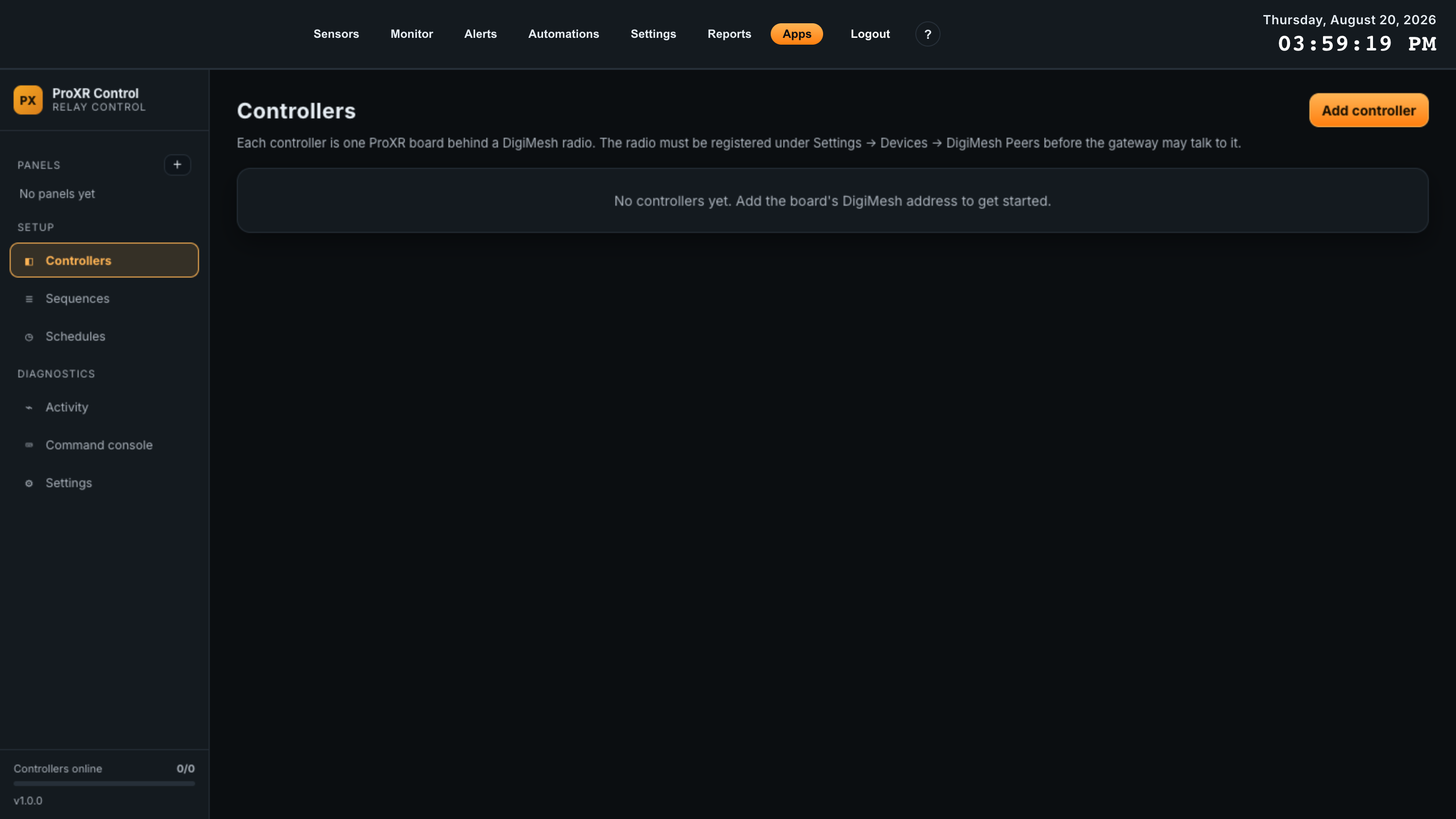

07Controllers
One controller is one ProXR board behind one DigiMesh radio. This is where you commission a board, name its relays, scale its analog inputs, and drive it directly without building a panel first.

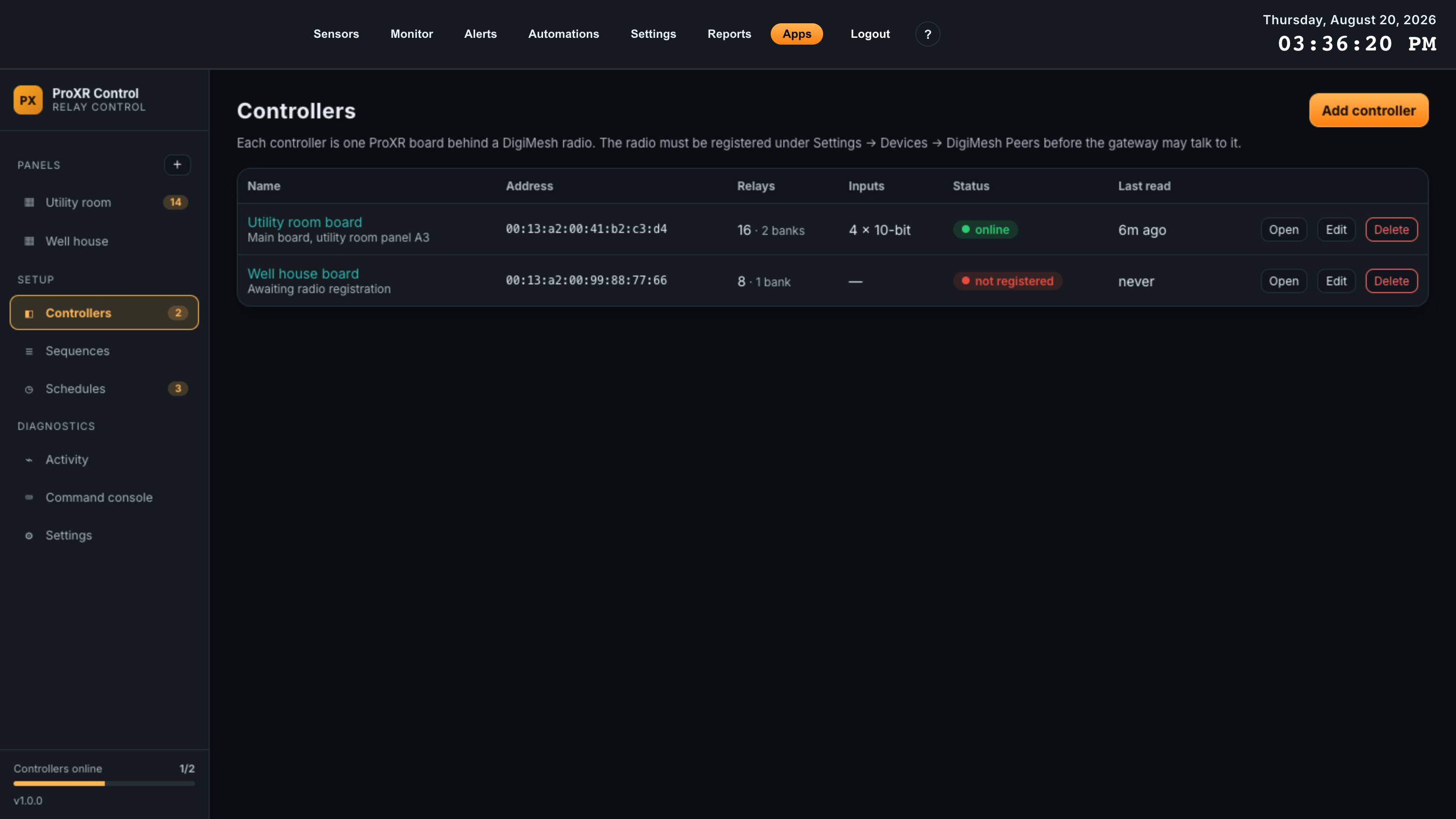

The controller list
proxr atrium app guide 23 controllers list
ColumnContents
NameA link to the controller page, with the controller’s notes underneath if any were entered.
AddressThe radio’s 64-bit MAC, normalized to colon-separated lower case however you typed it.
RelaysThe configured relay count, and how many banks of eight that comes to.
InputsChannels and resolution, for example 4 × 10-bit. A dash means analog inputs are switched off for this board.
StatusOne of online, no reply, not connected, not registered, peer disabled or disabled. The last three tell you the problem is on the gateway rather than on the wire.
Last readHow long ago the board last answered. Hover for the exact timestamp, in the gateway’s display timezone.
proxr atrium app guide 24 controller not connected
Controllers > a board whose peer is missing. The banner names the address you need to register.

The same dialog serves Add controller and Edit. Every field:
FieldWhat it doesRangeDefault
Name How the board is identified everywhere in the app, and in the state it publishes to Automations. Up to 120 characters Required
DigiMesh address The radio’s 64-bit MAC. A dropdown of registered peers not already claimed by another controller; Enter an address manually switches it to a text field, and back. Two controllers cannot share an address. 16 hex digits, with or without colons Required
Number of relays How many relays the app believes the board has, which decides how many banks are polled and how big a relay grid is. Preset buttons cover 1, 2, 4, 8, 16, 24 and 32; the field takes any value in range for larger expansion stacks. 1 – 512 8
Board has analog (A/D) inputs Whether to poll analog inputs at all. Clearing it disables the three fields below and hides the Analog inputs panel on the controller page. — Ticked
A/D resolution Which read command is used, and therefore the full-scale count: 10-bit reads 0 – 1023, 8-bit reads 0 – 255. It has to match the board. 10-bit or 8-bit 10-bit
A/D channels How many inputs to read and offer as cards. 1 – 8 8
Poll interval How often relay and input state are read over the radio. Faster panels cost more radio traffic; every board on the mesh shares the air. 2 s, 5 s (recommended), 10 s, 30 s, 1 min 5 s
Log analog inputs every How often a sample is written for the trend charts. Throttled separately from polling, so a 2-second poll for responsive panels does not multiply stored rows. 10 s, 1 min, 5 min, 15 min 1 min
Enabled Clearing it stops polling entirely. The controller keeps all its configuration, its panels keep their cards, and the list shows it as disabled. Use this for a board that is off for maintenance rather than deleting it. — Ticked
Notes Free text shown under the name in the controller list. Panel location, circuit numbers, who to call. Up to 1000 characters Empty

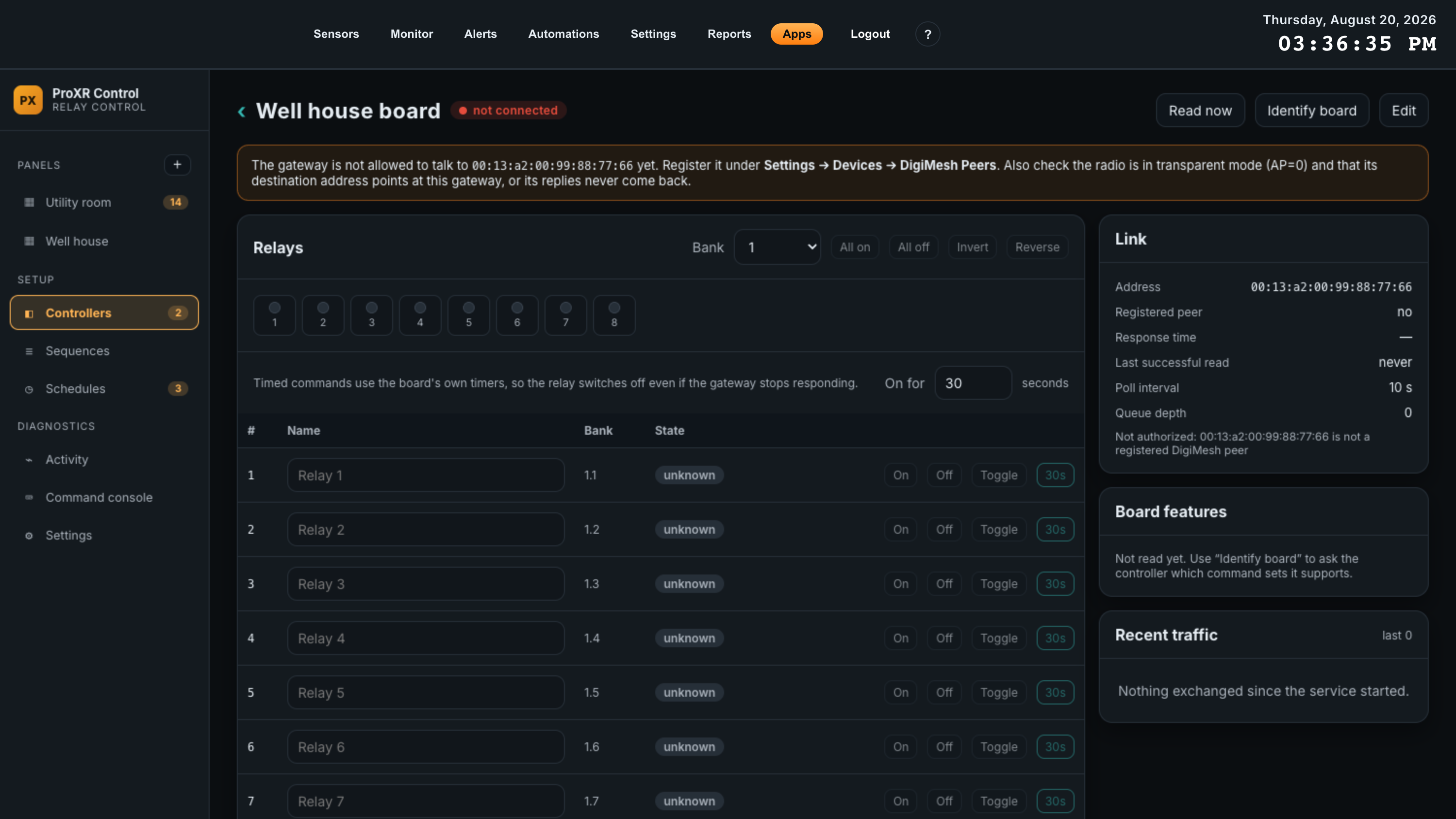

Relays
The controller page is the direct-control screen. The header carries the board’s state chip and three buttons — Read now polls immediately, Identify board asks the controller which command sets it implements, and Edit reopens the settings dialog.
proxr atrium app guide 25 controller detail
Controllers > Utility room board. The relay half of the controller page, with the three diagnostic panels alongside.
Bank controls
The toolbar above the lamps selects a bank and applies one of four commands to it. The bank selector lists only the banks the configured relay count actually covers.
ButtonEffect on the selected bank
All onEnergizes all eight relays in the bank.
All offDe-energizes all eight.
InvertEvery relay in the bank takes the opposite state.
ReverseReverses the pattern end to end — relay 1 takes relay 8’s state, 2 takes 7’s, and so on.

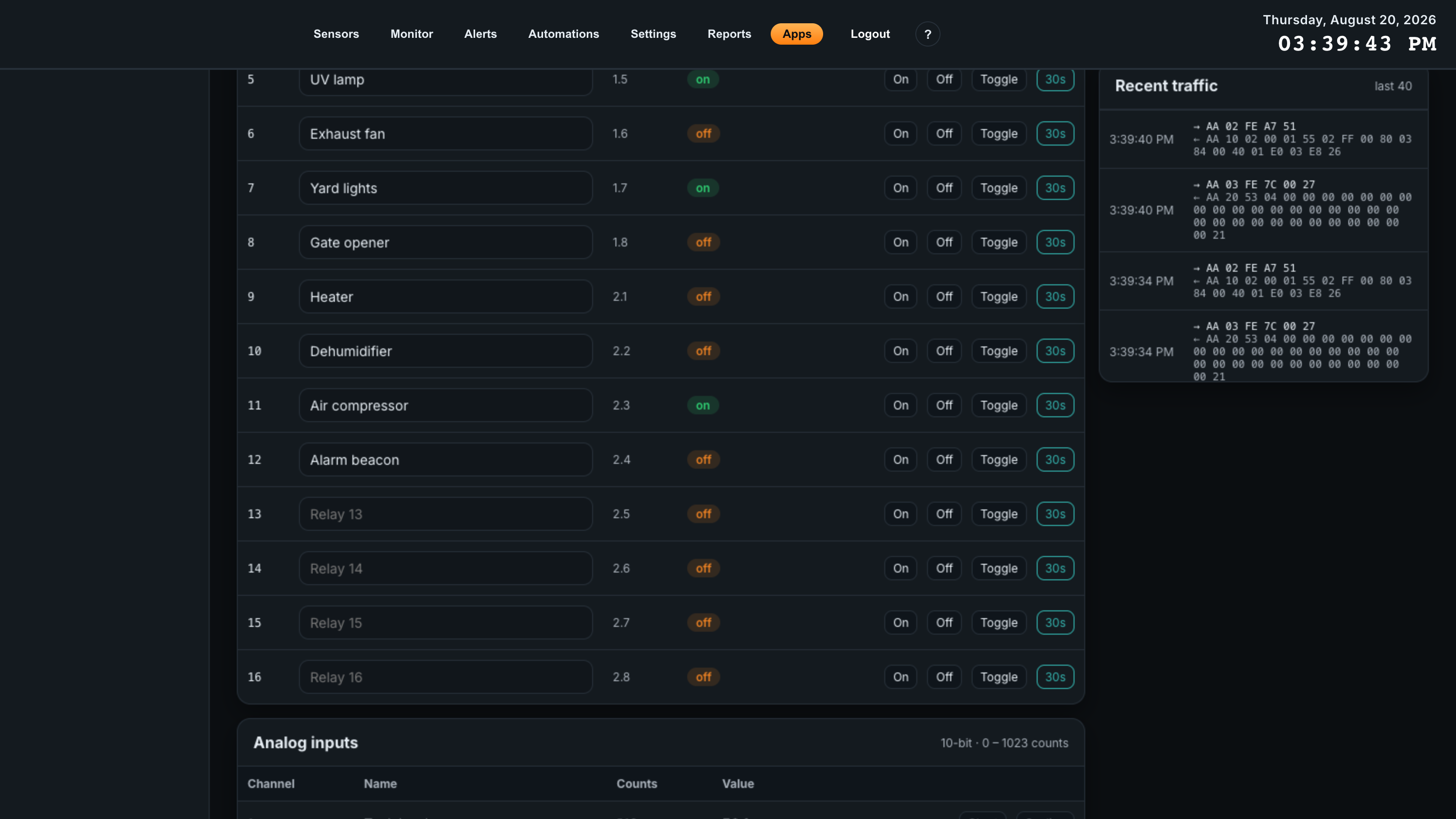

The relay table
proxr atrium app guide 26 controller relay table
Controllers > a board > relay table. One row per relay, with the timed-command duration set above.
ColumnContents
#The relay number, counted across the whole board. Relay 9 is the first relay of bank 2.
NameAn editable field. Type a name and press Enter, or click away, and it is saved. This name is used on this page and in the values the app publishes to Automations. Left empty it falls back to Relay N.
BankThe same relay expressed as bank.relay, which is how the ProXR protocol addresses it. Relay 11 reads 2.3.
Stateon, off, or unknown if the relay has not been read since the service started.
ButtonsOn, Off, Toggle and a timed button labelled with the current duration. All four are disabled while the controller is not connected.
Timed commands
The On for field above the table sets a duration in seconds, from 1 to 59. The button on each row then energizes that relay for that long using one of the controller’s own duration timers, so the relay switches off by itself — even if this gateway loses power, loses the network, or is switched off mid-cycle.
The timer used is derived from the relay number, cycling through the board’s sixteen timers, so pressing the same relay’s timed button twice reuses one timer instead of leaving two racing each other. Hovering the button names the timer it will use. For durations longer than 59 seconds, put a Relay on for a duration command on a panel button or in a sequence, where hours and minutes are available too.

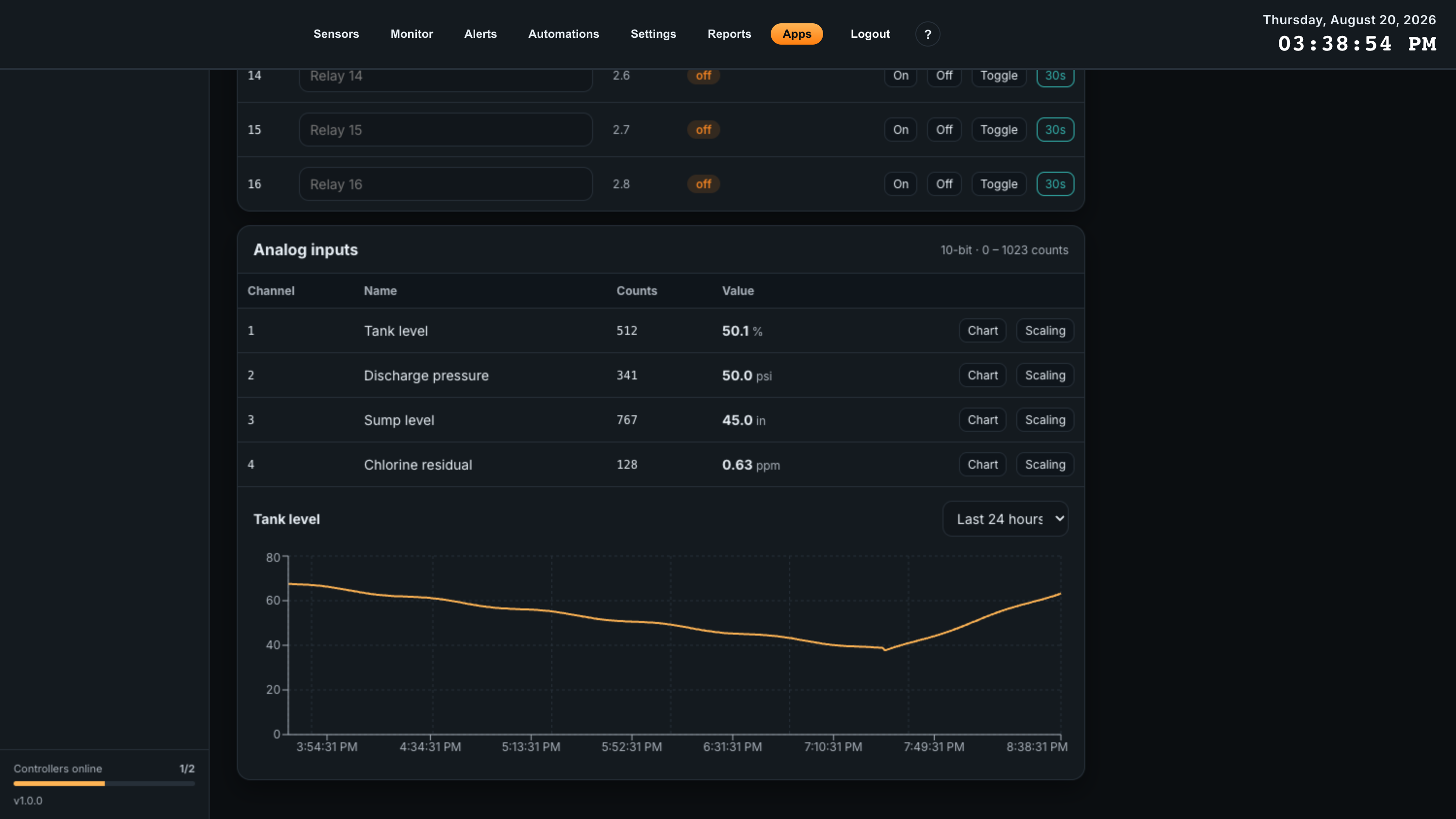

Analog inputs
The Analog inputs panel appears only when the board has analog inputs enabled. Its header states the resolution and the full-scale count, for example 10-bit · 0 – 1023 counts.
proxr atrium app guide 27 controller analog
Controllers > a board > Analog inputs. Raw counts and the same reading scaled into engineering units.
ColumnContents
ChannelThe input number, 1 to 8.
NameWhat you called this input, or Input N.
CountsThe raw A/D reading, exactly as the board reported it.
ValueThe same reading scaled into your engineering units and rounded to your chosen number of decimals, with the unit beside it.
ChartPoints the chart below the table at this channel.
ScalingOpens the scaling dialog for this channel.
The chart under the table plots the selected channel over Last hour, Last 6 hours, Last 24 hours or Last 7 days, in engineering units. It is drawn from logged samples, averaged into buckets, so a long span stays readable rather than dense.

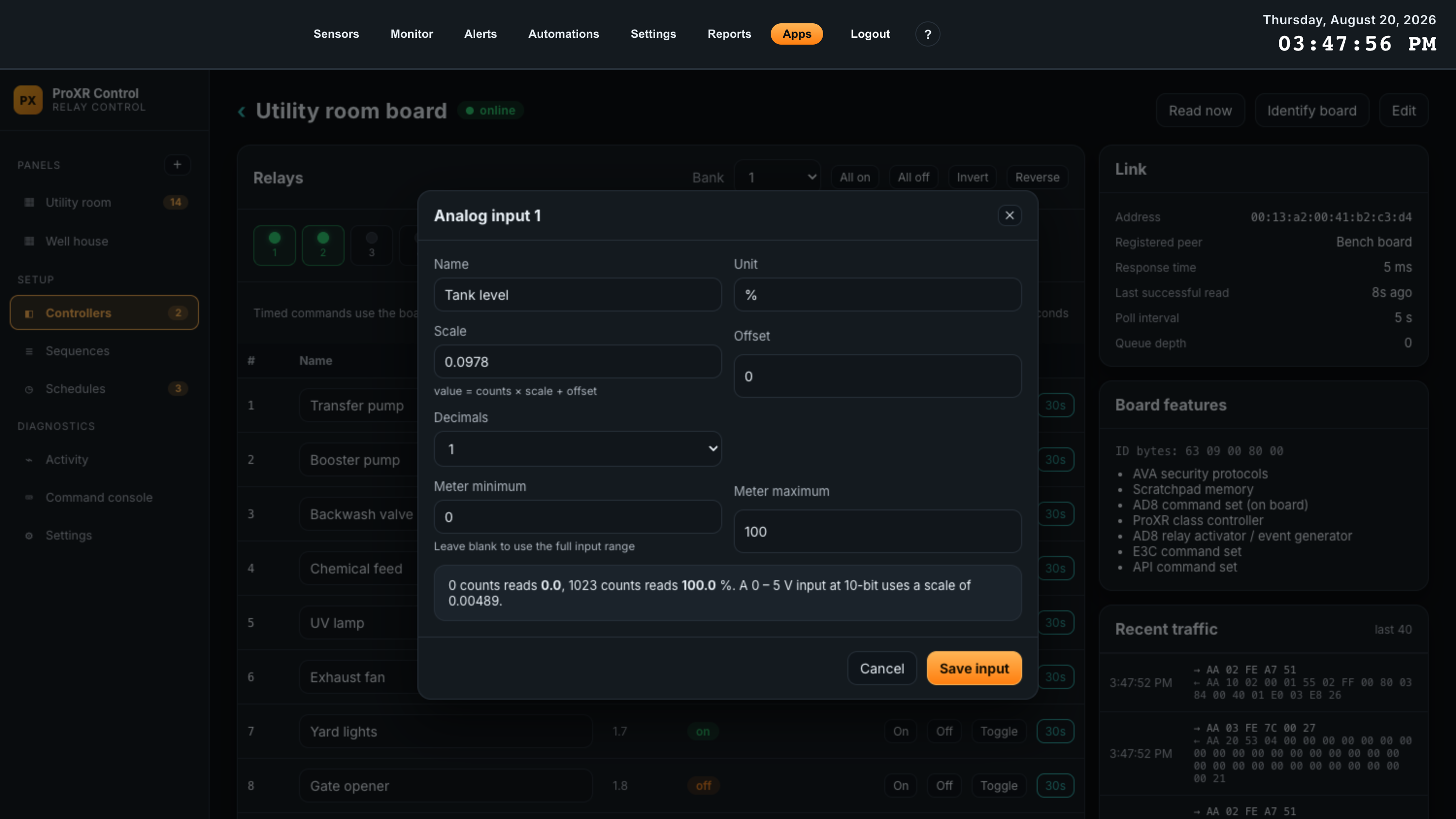

Scaling an input
proxr atrium app guide 28 controller input scaling
Controllers > a board > Analog inputs > Scaling. The banner recalculates as you type.
Scaling is a straight line: value = counts × scale + offset.
NameWhat this input is called on this page, on the chart, and in the values published to Automations.Input N
UnitShown beside the value and on the chart’s axis. Free text — psi, %, V, in, ppm.Empty
ScaleMultiplier applied to the raw count. For a linear sensor across the full input range this is range divided by full scale: a 0 – 5 V input at 10-bit is 5 / 1023 = 0.00489. The dialog states the right figure for a 0 – 5 V input at the board’s resolution.1
OffsetAdded after scaling. Use it for a sensor whose output does not start at zero — a 4 – 20 mA loop, or a gauge reading against atmosphere.0
DecimalsHow many decimal places the value is rounded to for display. 0 to 4.0
Meter minimum / Meter maximumThe ends of the level meter on an analog card. Leave both blank and the meter spans the full input range; set them to the part of the range that matters and the meter becomes readable. Display only — they do not clamp the value.Blank
The banner at the bottom of the dialog states what 0 counts and full scale would read with the numbers you have entered. Check both ends there before saving; it catches a scale that is off by a factor of ten immediately.

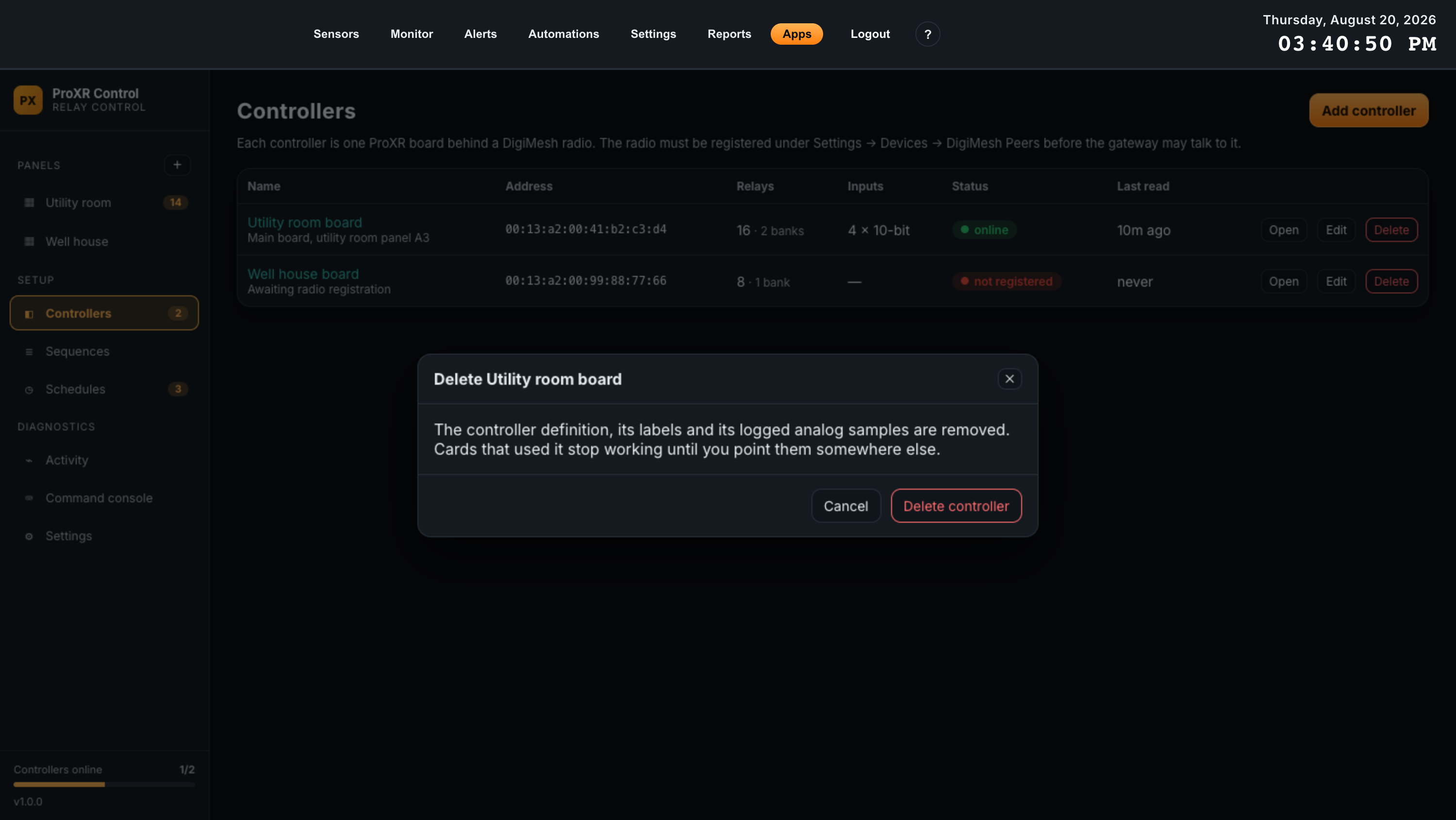

proxr atrium app guide 30 controller delete
Controllers > Delete. The dialog states exactly what goes.
Deleting a controller removes its definition, its relay names, its analog input scaling and its logged analog samples. Cards that used it stop working until you point them somewhere else; the panels themselves are not deleted. The board’s DigiMesh peer registration belongs to the gateway and is untouched, so re-adding the controller later needs only the address and relay count again.
If the board is only temporarily out of service, clear Enabled on the controller instead. That stops the polling and the “no reply” noise while keeping every name, scale and card intact.
08Sequences
A sequence sends several commands to one controller in order, with an optional wait before each one. Startup interlocks, shutdown orders, backwash cycles, test runs — anything where the order and the gaps matter.
proxr atrium app guide 31 sequences list
ProXR Control > Sequences. The Steps column reads out the commands in order.
Sequences run on the gateway’s ingest service, one command at a time, and stop at the first failure. That matters: a sequence is not fire-and-forget on the controller, so a board that stops answering half way through leaves the sequence half applied. Where the whole state must be guaranteed, end the sequence with an absolute command — an all-off or a pattern — rather than relying on every earlier step having landed.

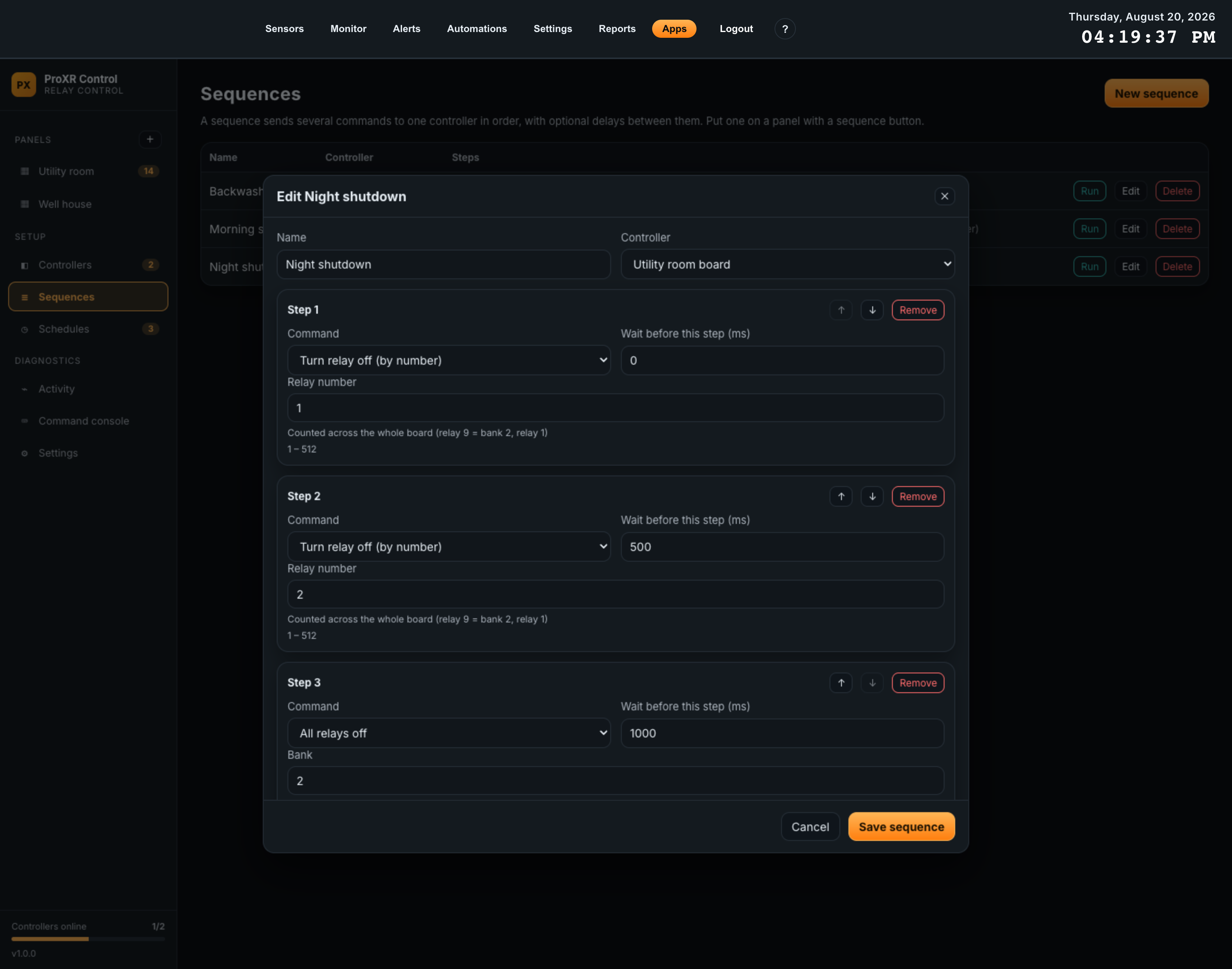

Building a sequence
proxr atrium app guide 32 sequence editor
Sequences > Edit. Three steps, each with its own command, wait and parameters.
NameWhat the sequence is called on this page, on sequence buttons, in schedules and in the Automations action Run a sequence.Required
ControllerWhich board every step runs against. A sequence cannot span two boards; use two sequences, or an automation, for that.Required
CommandPer step. The same grouped dropdown of all 42 commands as everywhere else. Changing it resets that step’s parameters to the command’s defaults.—
Wait before this step (ms)How long to pause before sending this step. Set it on step 1 to delay the whole sequence.0 – 10000 ms, in steps of 100
Step parametersWhatever the chosen command needs, with its permitted range shown. Validated when you save, so a saved sequence cannot fail validation later at run time.Per command
Reorder / removeThe up and down arrows move a step; Remove deletes it. A sequence must keep at least one step.Up to 32 steps
Running one
  • Run on the Sequences page runs it now and reports the result, naming the failed step if one fails.
  • A Sequence button card puts it on a panel, where it shows its step count under the label.
  • A schedule can run it at a time of day.
  • The Automations action Run a sequence lets anything else on the gateway trigger it.

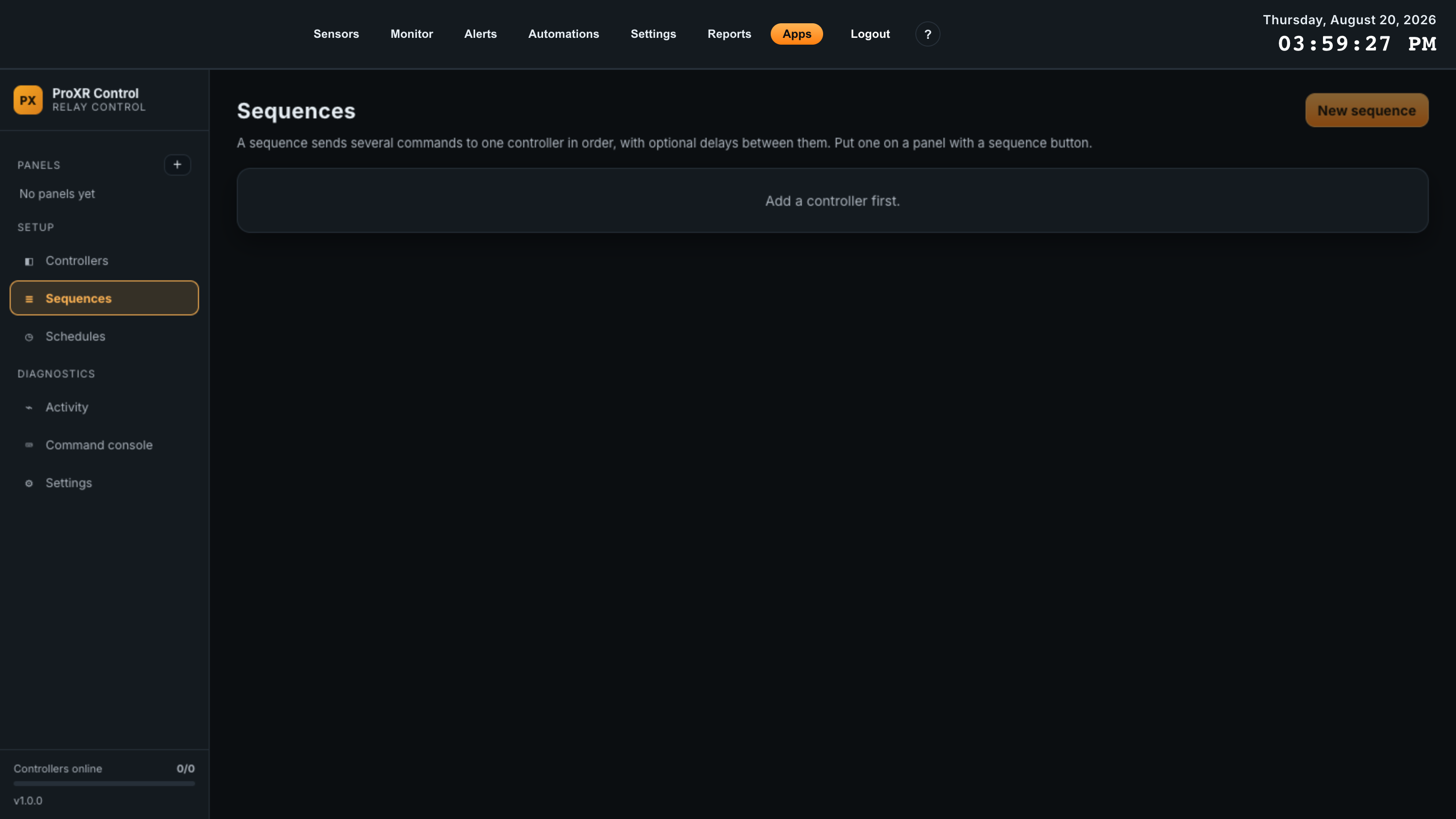

proxr atrium app guide 33 sequences empty
Sequences with no controller yet. Sequences and schedules both need a controller before they can exist.

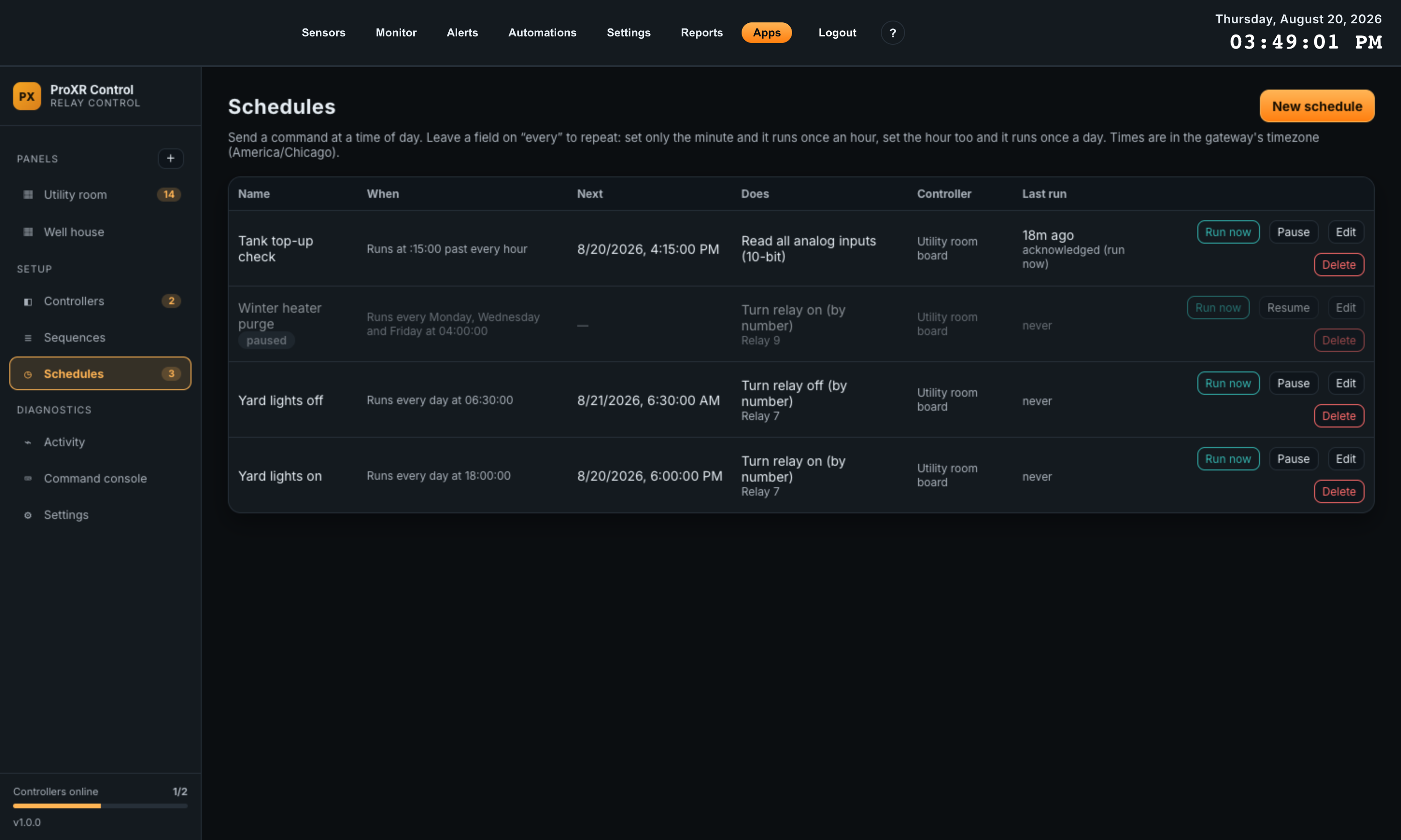

09Schedules
A schedule sends one command, or runs one sequence, at a time of day. Schedules are evaluated once a second on the gateway, in the gateway’s own display timezone.
proxr atrium app guide 34 schedules list
ProXR Control > Schedules. The When column is the rule in plain English; Next is the actual next firing.
ColumnContents
NameYours. Paused schedules also carry a paused chip and the whole row is dimmed.
WhenThe rule written out — Runs every Tuesday and Friday at 02:30:00, Runs at :15:00 past every hour. This sentence comes from the same code the gateway matches against, so it is not a paraphrase.
NextThe next firing, as an absolute time. Hover to see the next three.
DoesThe command’s name, or Sequence: name, with the target underneath — which relay, bank or input.
ControllerThe board. Blank for a sequence, which carries its own controller.
Last runHow long ago it last fired and what happened — acknowledged when the controller answered, or the error in red. never until it has run once.
How the time fields work
Day, hour, minute and second are each optional, and this is the part worth reading twice. An unset field that is coarser than the finest one you set means every. An unset field that is finer is treated as zero.
What you setWhat it meansHow often it fires
Minute = 15Runs at :15:00 past every hour24 times a day
Hour = 6, Minute = 30Runs every day at 06:30:00Once a day
Hour = 6Runs every day at 06:00:00 — the unset minute and second are zero, not “every”Once a day
Second = 30Runs at 30 seconds past every minute1440 times a day
Days = Tue, Fri; Hour = 2; Minute = 30Runs every Tuesday and Friday at 02:30:00Twice a week
NothingRefused — Pick at least one of day, hour, minute or second—
You never have to work this out in your head. The banner at the bottom of the editor states the rule in plain English and lists the next three firings, and it updates as you click. If the banner does not say what you meant, the schedule is wrong — before you save it.

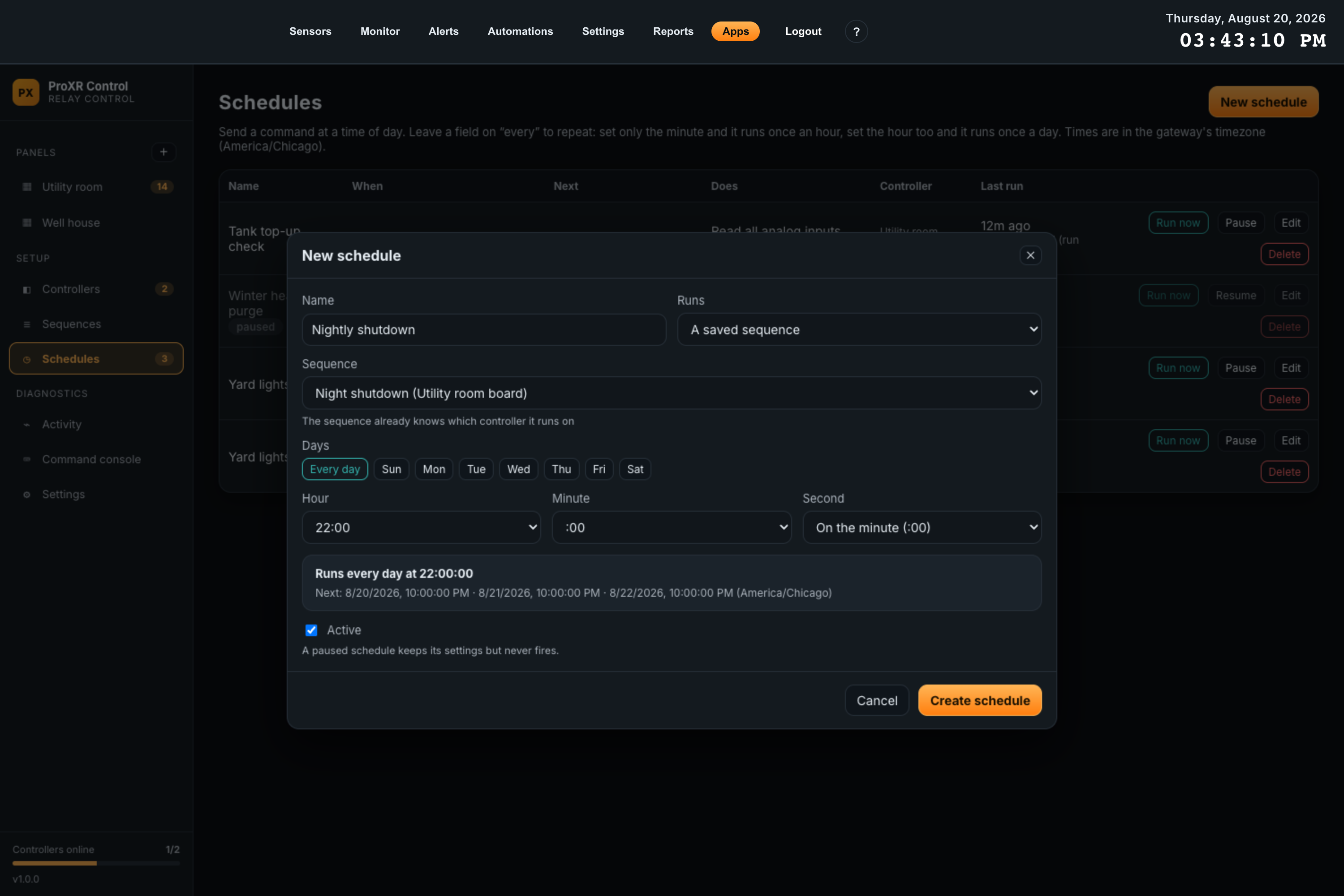

proxr atrium app guide 35 schedule editor
Schedules > New schedule. The banner is the rule as the gateway will actually match it.
FieldWhat it doesOptions
NameHow the schedule is listed and logged.Required
RunsWhether this schedule fires a single command or a saved sequence.One command; A saved sequence
ControllerWhich board the command goes to. Hidden in sequence mode — the sequence already knows its controller.Any configured controller
CommandAny of the 42 commands, grouped, with its parameters below and its caveat note if it has one.Command mode only
SequenceWhich saved sequence to run.Sequence mode only
DaysEvery day, or any combination of the seven day buttons. Selected days are highlighted.Every day, or Sun – Sat
HourEvery hour, or a specific hour on the 24-hour clock.Every hour, 00:00 – 23:00
MinuteEvery minute, or a specific minute.Every minute, :00 – :59
SecondOn the minute (:00), or a specific second.On the minute, :00 – :59
ActiveA cleared box keeps every setting but never fires.Ticked by default
proxr atrium app guide 36 schedule editor sequence
Schedules > New schedule > A saved sequence. The controller field disappears; the sequence carries its own.
Testing and pausing
ButtonEffect
Run nowFires the schedule immediately, without waiting for its time and without affecting when it next fires. Use it to prove a schedule works the day you build it, rather than finding out at 02:30.
Pause / ResumeToggles Active without opening the editor.
DeleteStops the schedule immediately. Relays stay exactly as they are — deleting a schedule never switches anything.

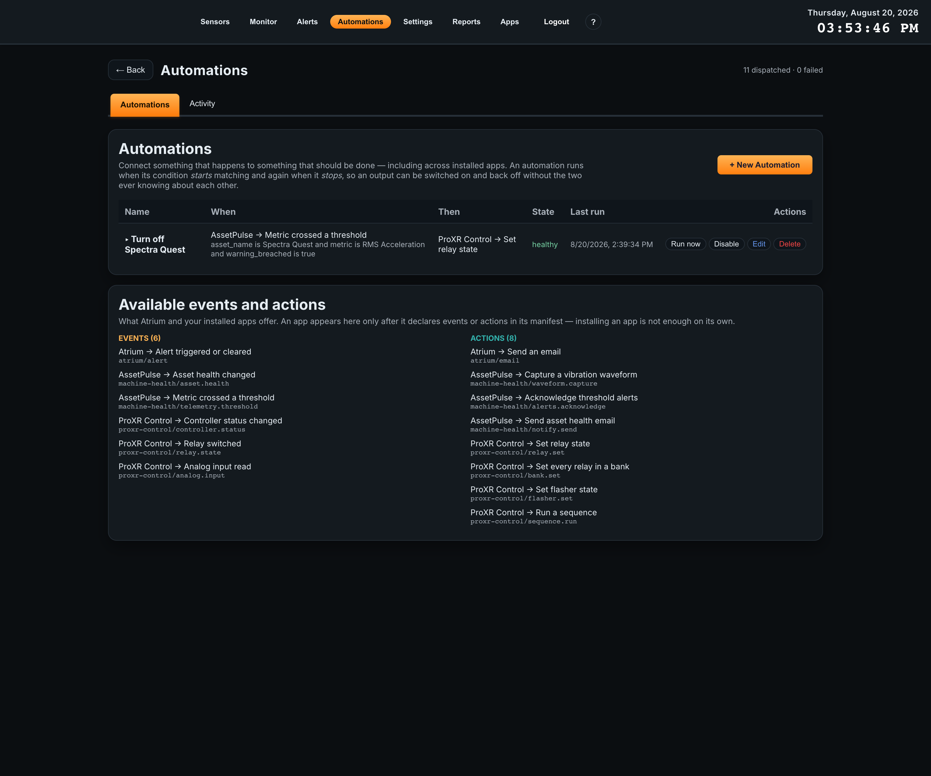

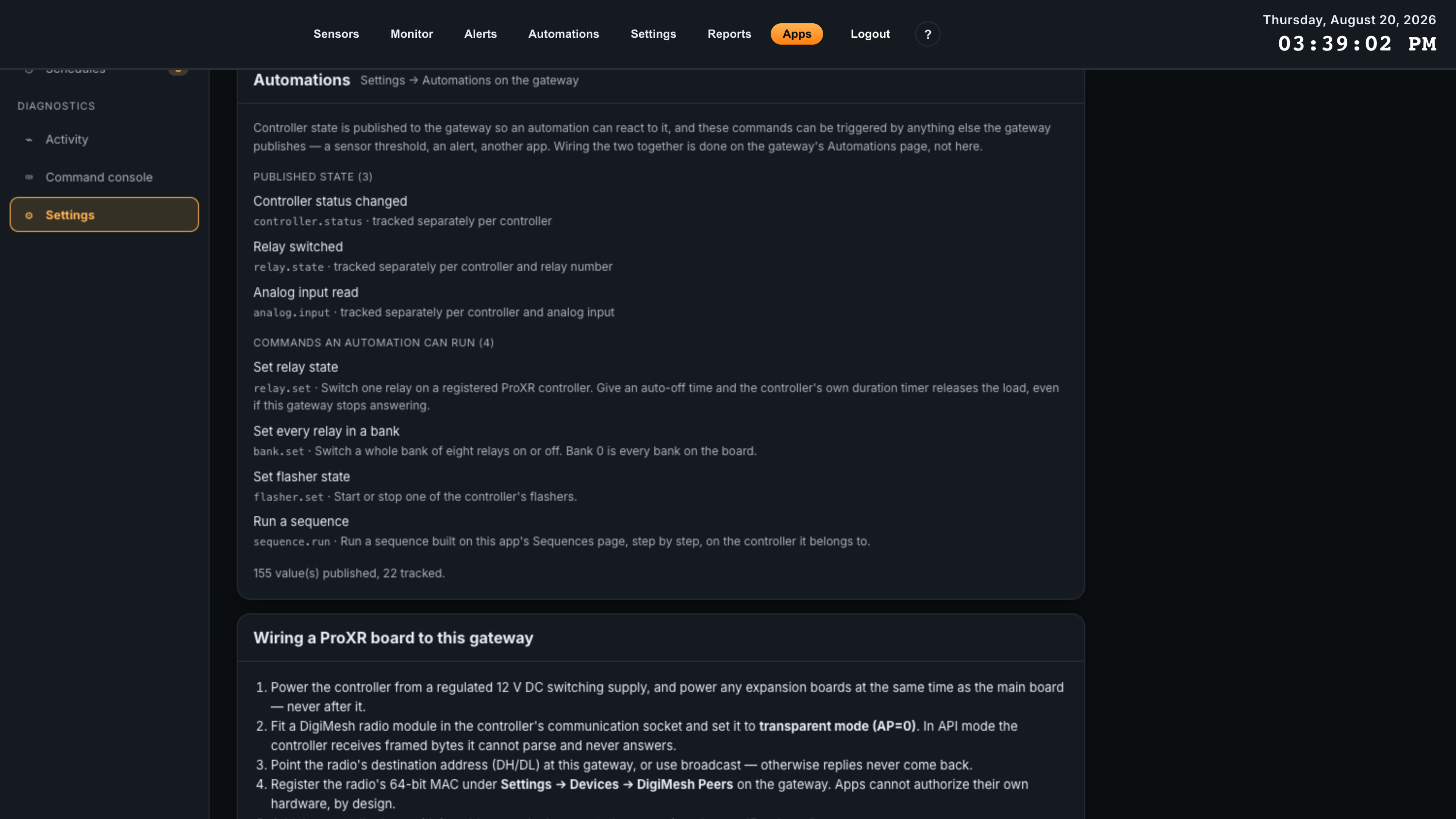

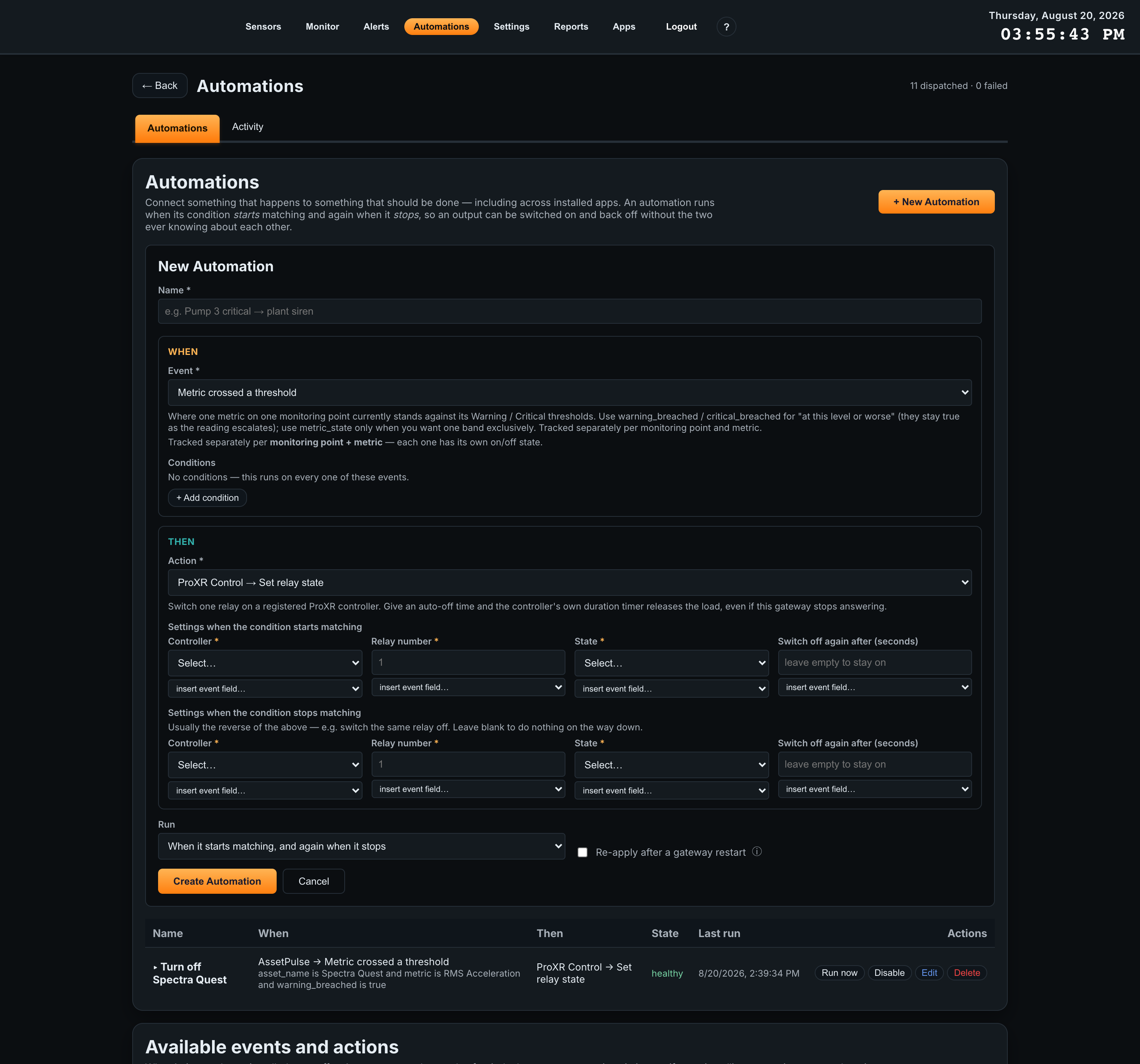

10Automations
ProXR Control publishes what its boards are doing, and offers four commands anything else on the gateway can trigger. You connect the two on the gateway’s own Automations page — not inside the app. That click is the authorization: this app holds permission to transmit on the radio, and no other app gets to borrow it without an operator saying so.
proxr atrium app guide 37 settings automations
ProXR Control > Settings. What this app contributes to Automations. The panel is read-only by design.
The app’s own Settings page lists what it offers, and how much it has published, but bindings are never created here. The panel is a reference so you know what to look for on the Automations page.
What the app publishes
All three are level-triggered current state, not one-shot notifications: the app republishes each value as it evaluates it, and the gateway dispatches only when the value actually changes. That is what lets an automation switch something on when a condition starts matching and back off when it stops, and what lets a binding heal itself after a dropped message or a restart instead of latching on.
EventTopicTracked separately perPublished when
Controller status changed proxr-control/controller.status Controller Every poll, and the moment a board turns out not to be authorized — which is the only state an un-subscribable board ever has.
Relay switched proxr-control/relay.state Controller and relay number Every poll. A relay that has never been read is deliberately not published, so an automation can never act on a value the app invented.
Analog input read proxr-control/analog.input Controller and analog input On the board’s Log analog inputs every interval, scaled and labelled the way you configured the input — so a threshold you set means what it means on screen.
Fields you can build conditions on
EventFields
controller.status controller_id, controller_name, address, status (online or offline), online (true/false), connected (true/false), relay_count, relays_on, last_error
relay.state controller_id, controller_name, relay, relay_label, state (on or off), on (true/false)
analog.input controller_id, controller_name, channel, label, raw (counts), value (scaled), unit, resolution
status and online carry the same fact in two forms on purpose: status gives the condition builder a dropdown, while online reads better dropped into an email body. Use connected to tell “the board is not answering” apart from “the gateway is not allowed to talk to it”.
Commands an automation can run
All four are absolute: you set a state, never toggle one. A binding is re-asserted after a gateway restart, and a relative command would invert the load instead of restoring it.
ActionIdParameters
Set relay state proxr-control/relay.set Controller (a dropdown of your configured boards), Relay number, State (on / off), and Switch off again after (seconds) — optional; leave it empty to stay on.

Building a binding
proxr atrium app guide 38 automations list
Automations. A real binding: an AssetPulse threshold shuts down a machine through a ProXR relay.
  1. 1
    Open Automations and click + New Automation
    Name it for what it achieves, not for its mechanism — the name is what appears in the audit trail and in the ProXR activity log.
  2. 2
    Pick the WHEN event
    Any event the gateway or an installed app offers, including the three from ProXR Control. The form explains what the chosen event is tracked per, which decides how many independent on/off states the binding has.
  3. 3
    Add conditions
    Without conditions the automation runs on every one of those events. With them it runs only while they all match. Fields come from the event’s declared payload.
  4. 4
    Pick the THEN action and fill in both edges
    A ProXR action asks for its parameters twice: Settings when the condition starts matching and Settings when the condition stops matching. The second is usually the reverse of the first — the same relay, switched off. Leave it blank to do nothing on the way down. Any parameter can instead be filled from a field of the triggering event, using the insert event field dropdown underneath it.
  5. 5
    Choose when it runs, then create it
    When it starts matching, and again when it stops is the usual choice for relay control. Re-apply after a gateway restart re-asserts the current state after a reboot, which is what you want for a load whose state should survive a power cycle of the gateway.
proxr atrium app guide 39 automation new proxr action
Automations > New Automation. A ProXR action asks for its parameters on both edges.
proxr atrium app guide 40 automation proxr event
Automations > New Automation. A ProXR analog reading driving something else on the gateway.
Checking the app is offering everything
proxr atrium app guide 41 automation catalog
Automations > Available events and actions. All three ProXR events and all four ProXR actions, listed.
The catalog at the bottom of the Automations page lists everything Atrium and the installed apps offer. If ProXR Control’s three events and four actions are not there, no binding can reference them, and the cause is one of two things: the gateway is older than platform 2.4.0, or the ingest service has not loaded the app. The app’s Settings page reports both, and its Automations panel says so in a red banner.
Commands an automation triggers are written to the app’s Activity log with the source Automation, or Automation (test run) when an operator pressed Run now on the binding — so a test never looks like a real firing. Each one is also written to the gateway’s audit trail with the binding’s name.

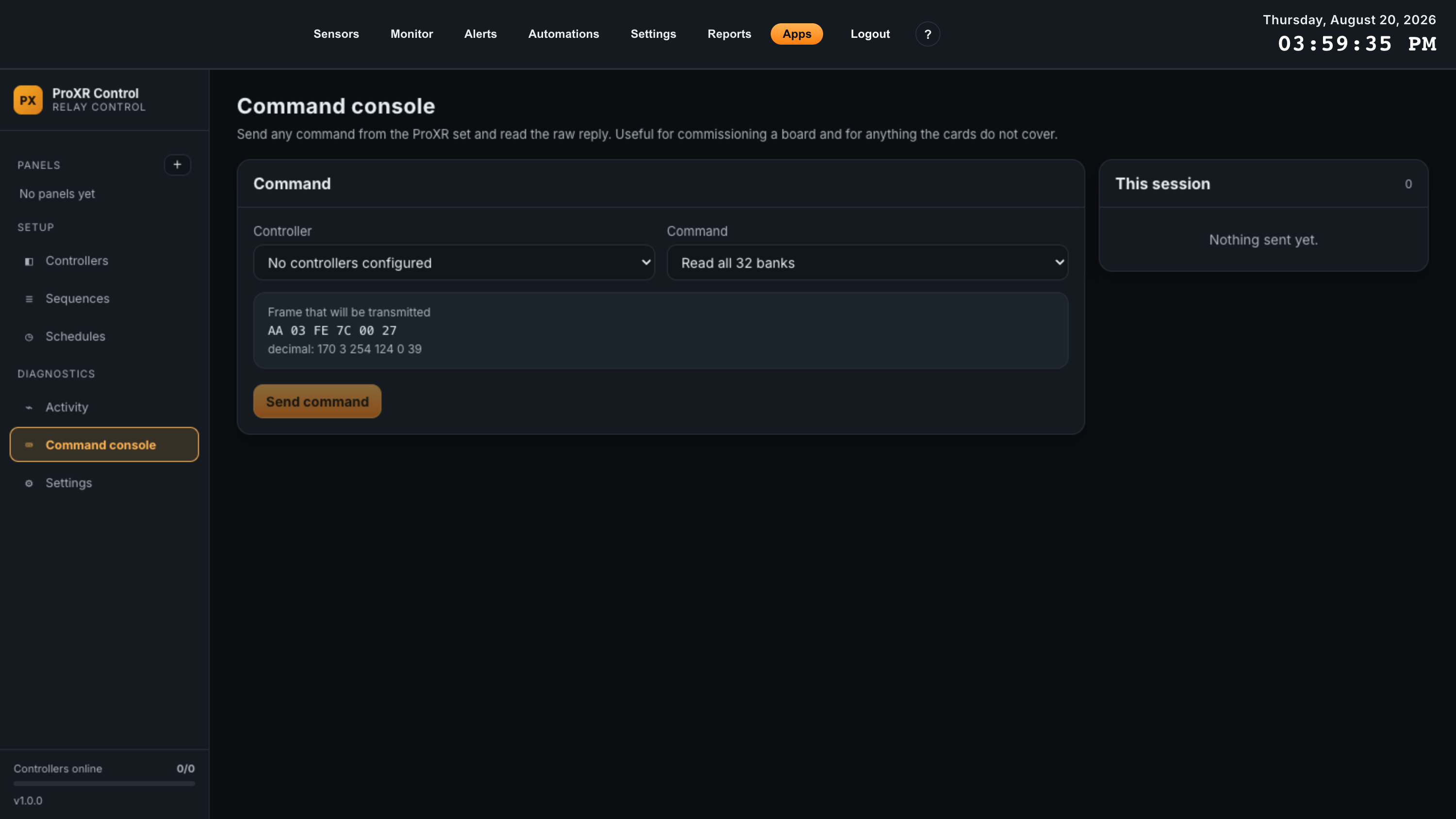

11Command Console
The console is a ProXR terminal. Pick any command from the set, see the exact frame that will be transmitted, send it, and read the controller’s reply decoded. It exists for commissioning a board and for the things the cards do not cover.
proxr atrium app guide 42 console
ProXR Control > Command console. The frame is shown before anything is sent.
ControlWhat it does
ControllerWhich board to talk to, listed as name and address. The chip beside the panel title shows that board’s current link state.
CommandAll 42 commands, grouped as Relays, Banks, Timers, Flashers, Read, Refresh, Configuration and Advanced. A command with a caveat shows it under the dropdown.
ParametersWhatever the command needs, each with its permitted range printed underneath.
Frame previewThe bytes that will go out, in hex and in decimal. It is built by the gateway, not the browser, so what you see is exactly what will be transmitted — header, length byte and checksum included. An out-of-range parameter replaces the preview with the reason, and disables Send command.
Send commandTransmits. A note beside it reads This command can change relay state whenever the selected command writes to relays.

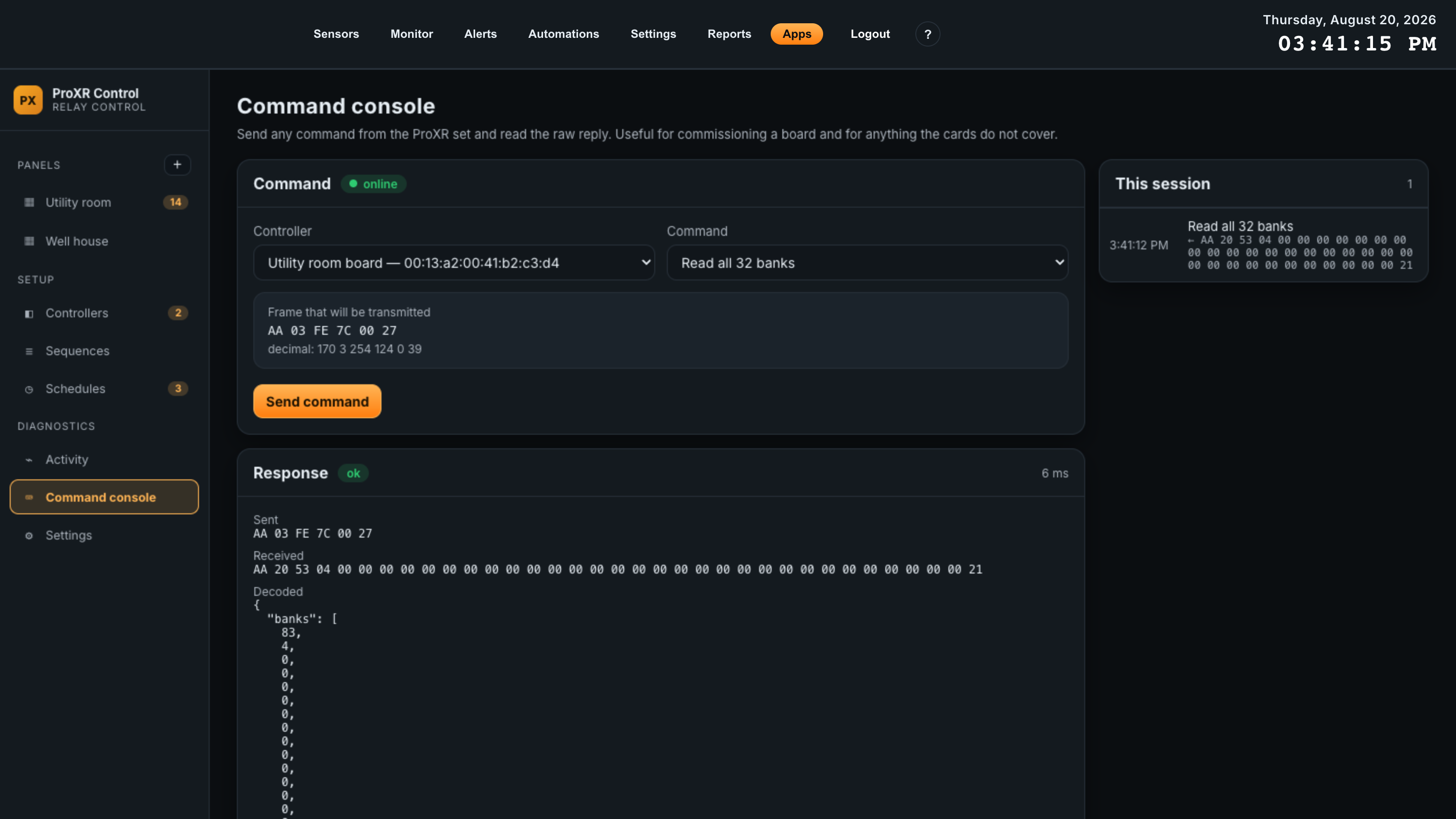

Reading the response
proxr atrium app guide 43 console response
Command console after a send. Sent bytes, received bytes, and the reply decoded.
RowContents
Chip and timingok or failed, and the round-trip in milliseconds.
SentThe transmitted frame.
ReceivedThe reply frame, or no reply when the board did not answer.
DecodedThe reply interpreted — an acknowledgement, a relay state, a bank bitmask, a list of analog channels with their resolution, a decoded device identification. This is the same decoder the polling loop uses.
This sessionThe last 25 commands sent from this browser tab, newest first, each with its reply. It is per-tab and not persisted; the Activity page is the durable record.

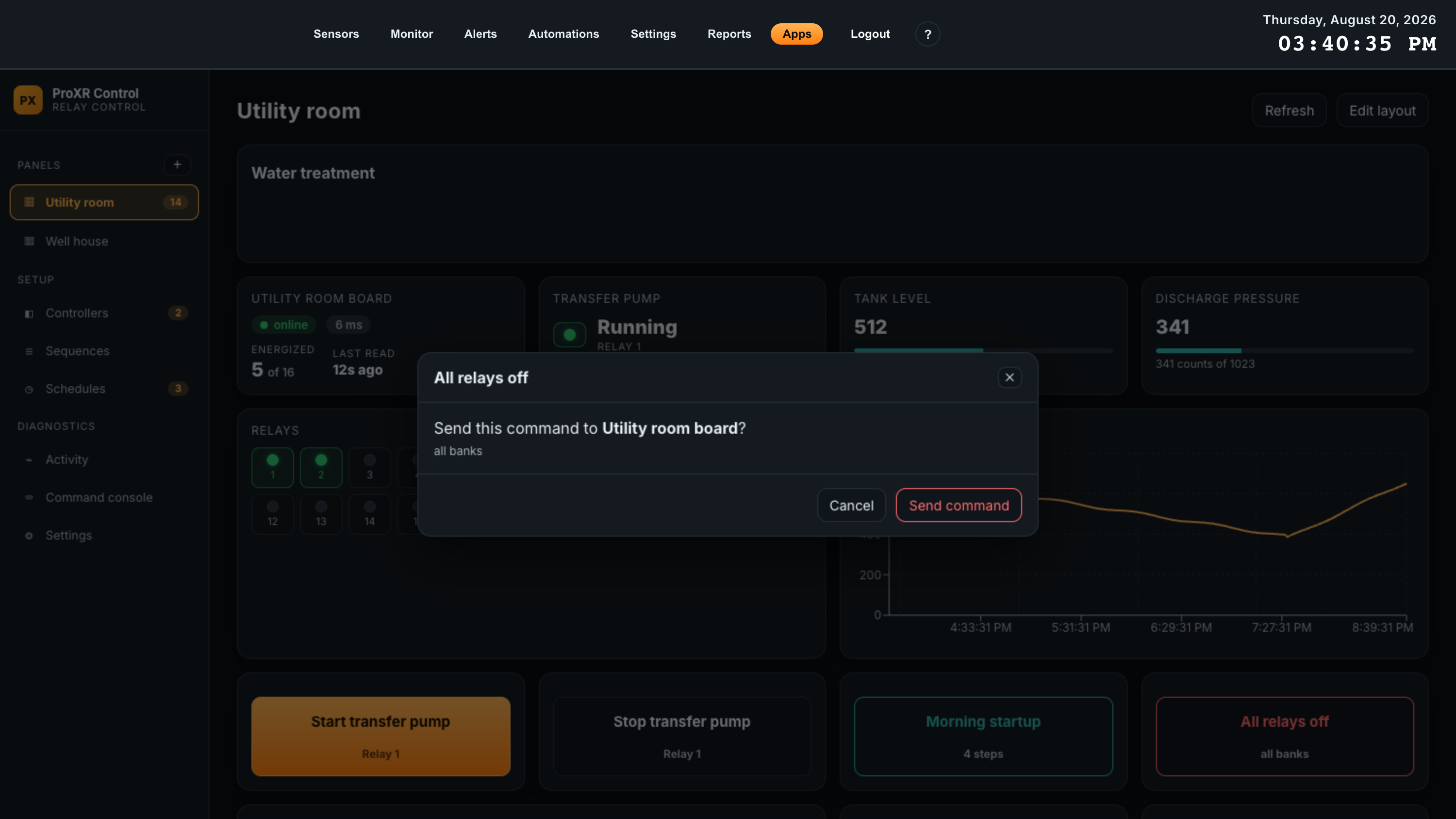

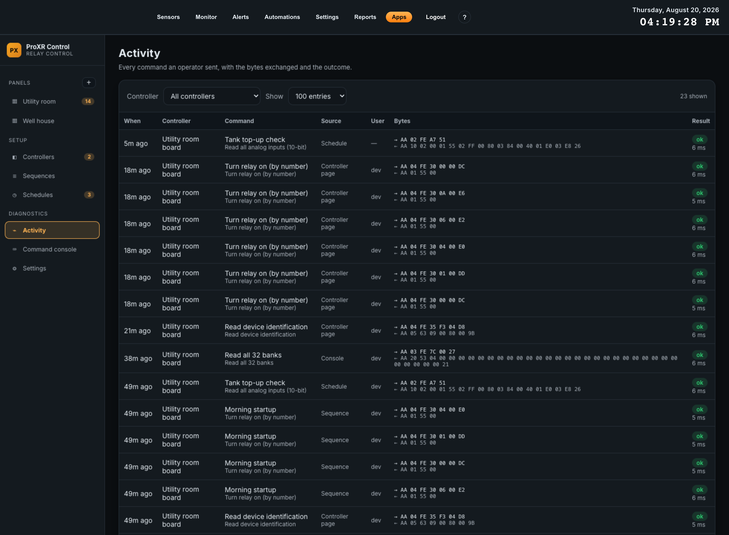

12Activity
Every command the app sent on somebody’s behalf, with the bytes exchanged, who sent it and what came back. Polling traffic is deliberately excluded — a board polled every five seconds would bury everything that matters.
proxr atrium app guide 45 activity
ProXR Control > Activity. Operator-initiated commands, with the frames exchanged.
ColumnContents
WhenHow long ago. Hover for the exact timestamp in the gateway’s display timezone.
ControllerWhich board it went to.
CommandThe label the command was sent under — a card’s title, a relay’s name, a bank action — with the underlying ProXR command name beneath it.
SourceWhere it came from. See the table below.
UserThe signed-in gateway user who caused it. Blank for anything the gateway itself initiated.
BytesThe frame sent and the frame received.
Resultok or failed, with the error text and the round-trip time underneath.
Sources
SourceMeans
Panel cardSomebody pressed a button or clicked a relay on a control panel.
Controller pageAn On, Off, Toggle, timed or bank button on a controller page.
ConsoleSent from the Command console.
SequenceOne step of a sequence run. A four-step sequence writes four rows.
ScheduleA schedule firing at its time.
AutomationA binding on the gateway’s Automations page fired this command.
Automation (test run)An operator pressed Run now on a binding. Recorded separately so a test is never mistaken for a real firing.
APISent by something calling the app’s HTTP API directly.

13Settings
Four panels: how long data is kept, what the app offers Automations, the wiring checklist, and what the app can see about the gateway it is running on. There are no credentials to enter and no external service to configure.
proxr atrium app guide 46 settings
Data retention
Two of the app’s tables grow continuously. Both are pruned by a background worker every 30 minutes, in chunks, so the database is never locked for long. Changes take effect on the next pass — there is no separate save button; choosing a value saves it.
SettingWhat it prunesOptionsDefault
Keep analog input samples for The logged A/D samples the trend charts are drawn from. Shortening it shortens the longest chart you can draw. 1 day, 3 days, 7 days, 30 days, 90 days 7 days
Keep the command log for The Activity log. This is your record of who switched what, so shorten it only deliberately. 1 day, 3 days, 7 days, 14 days, 30 days, 90 days 14 days
Sizing at the defaults: one board with eight analog inputs at the fastest allowed 10-second logging interval is roughly 480,000 sample rows over seven days, a few tens of megabytes. At the default 1-minute interval the same board stores about 80,000 rows. Analog logging is throttled independently of polling, so a 2-second poll interval for responsive panels does not multiply stored rows.
Automations
A read-only summary of the three events the app publishes and the four commands it offers, with the topic or id of each. See Automations for what to do with them. Underneath, a line reports how many values have been published, how many things are being tracked, and how many publishes were held back by the platform’s rate limit or refused. If the inter-app bus is unavailable, a red banner replaces the counters and says so.
The five-step commissioning checklist from First-Time Setup, repeated inside the app so an operator at the panel has it to hand, and closing with the reminder that relay state is the controller’s memory state.
About
RowMeaning
App versionThe installed version of ProXR Control. Quote it in any support request.
Gateway modelThe gateway hardware the app is running on.
PlatformThe Atrium platform version. Must be 2.4.0 or newer.
DigiMesh I/Oavailable or unavailable. Unavailable means no command can be sent by anything — not panels, not schedules, not automations.
ControllersHow many boards are configured.
Relays configuredThe total across every board, which is a quick sanity check on relay counts.

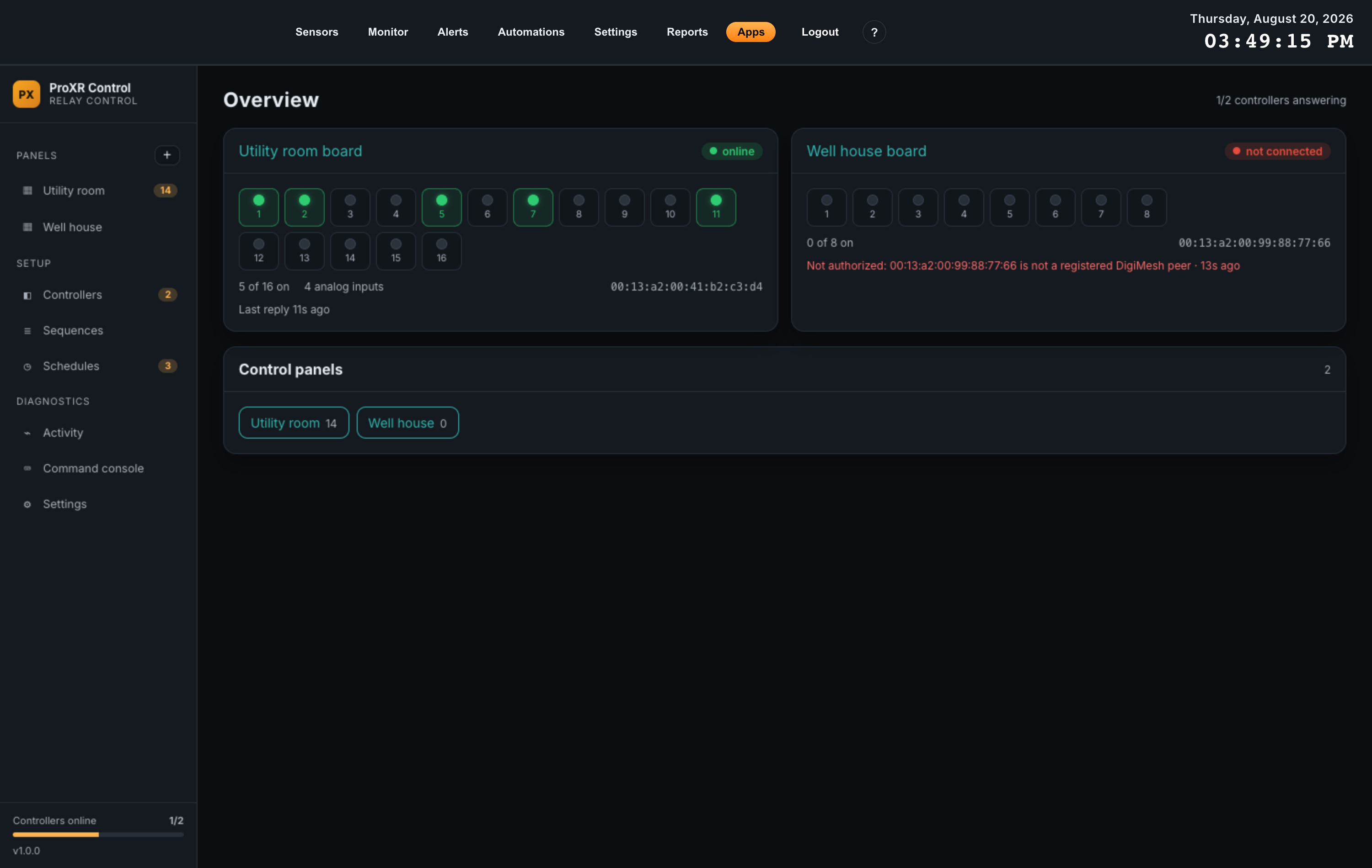

The board does not answer
SymptomLikely causeFix

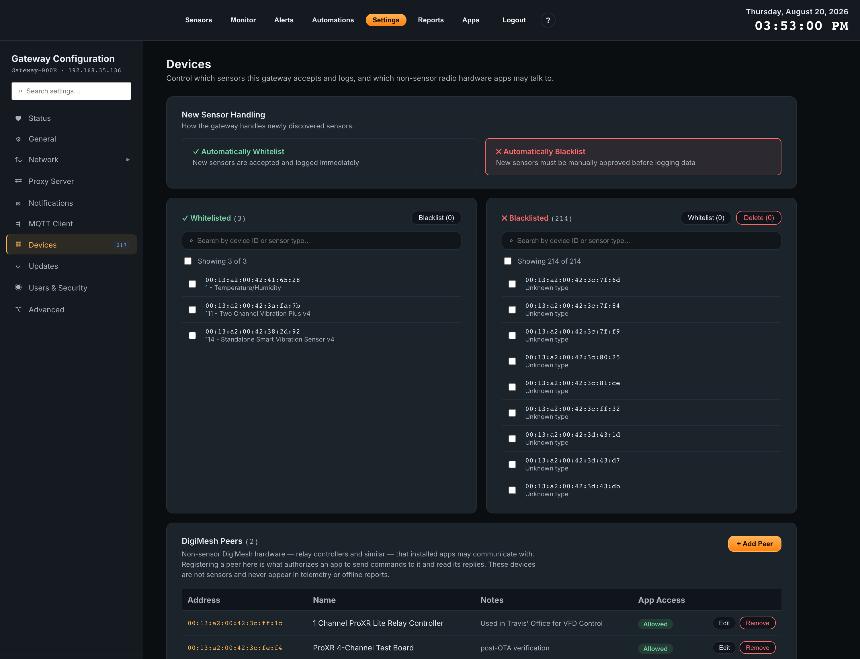

Controller shows not connected or not registered, and a yellow banner names an address The radio is not registered as a DigiMesh peer on the gateway. Register that exact address under Settings > Devices > DigiMesh Peers. The app retries every 15 seconds, so no restart is needed.
Controller shows peer disabled The peer exists but has been switched off on the gateway. Re-enable it on the same page.
Controller shows no reply. Recent traffic has outbound frames and nothing coming back The radio is in API mode, so the board receives bytes it cannot parse. This is the single most common cause. Set the radio to transparent mode, AP=0.
Controller shows no reply, radio is confirmed at AP=0 The radio’s destination is not this gateway, so replies go elsewhere. Point DH/DL at this gateway, or set the radio to broadcast.
Controller shows no reply, radio settings confirmed correct The board has no power, or the radio module is not seated in its socket. Check the 12 V supply and reseat the radio.
Controller shows disabled and is never polled Enabled is cleared on the controller. Edit the controller and tick Enabled.
It answered before and stopped, response time had been climbing A marginal mesh link, or congestion from too many boards polled too fast. Raise the poll interval on the boards that do not need to be fast, and check the intermediate radios.
The relay switches off by itself when the timer expires, even if the gateway stops responding
Timer 0 – 15 · default 0
Relay number 1 – 512 · default 1
Hours 0 – 255 · default 0
Minutes 0 – 59 · default 0
Seconds 0 – 59 · default 5
can change relay statetimer_duration
