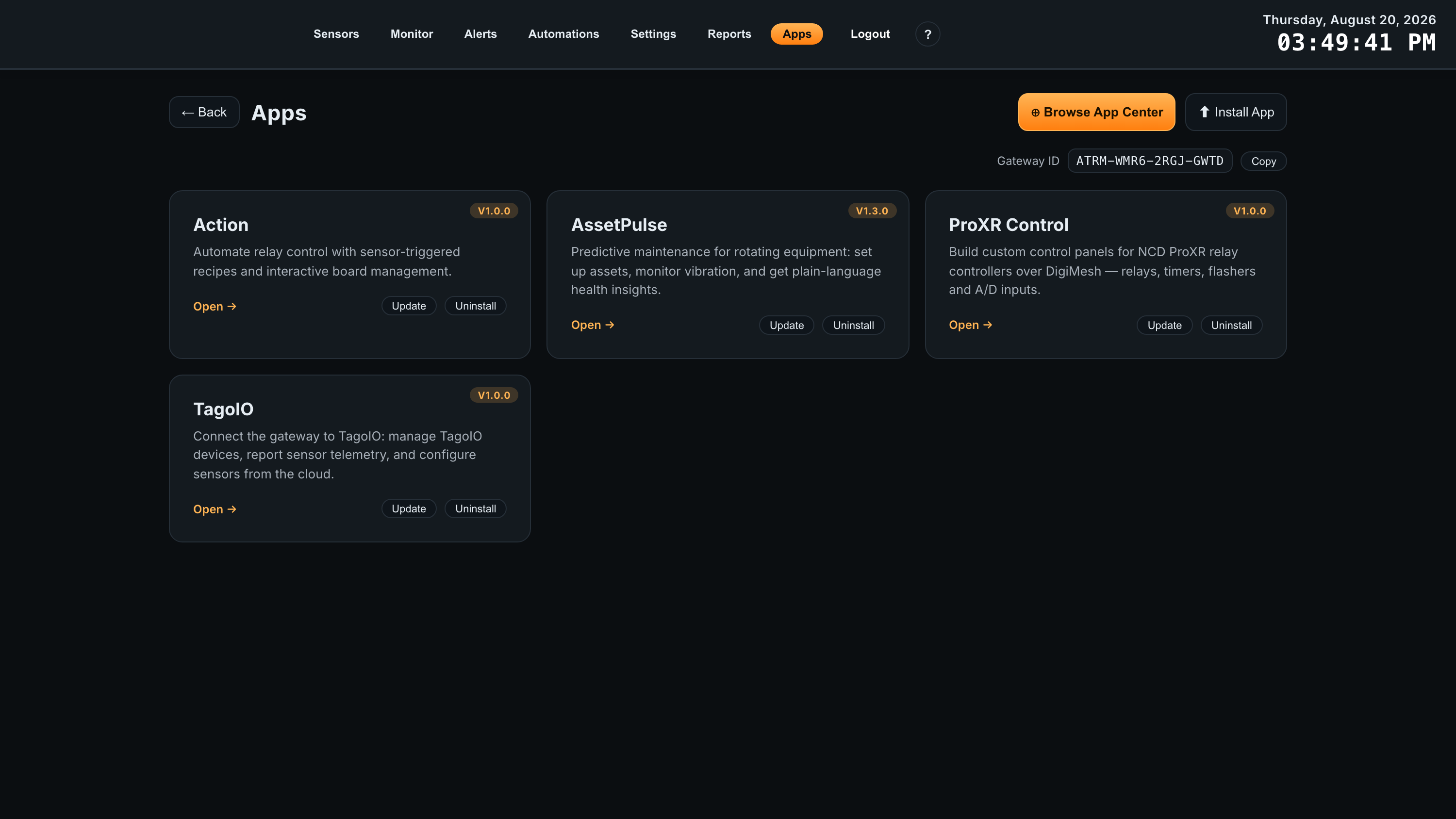

The Apps page
Open Apps from the Atrium navigation. This page lists the apps installed on this gateway, and it is where AssetPulse appears once it is installed. Each card shows the app’s installed version and its controls: Open to launch it, Update when a newer version has been published, and Uninstall to remove it.
Two buttons sit at the top of the page. Browse App Center opens the catalog of published apps, and Install App installs one from a package file — the route for a pre-release build or an app supplied directly by NCD.
This page is also where you find the Gateway ID, an identifier in the form ATRM-XXXX-XXXX-XXXX, with a Copy button beside it. A license is issued against one specific gateway, so that ID is what you supply when you request one — copy it from here rather than transcribing it from the label on the enclosure.
assetpulse atrium app guide 01 apps page
Apps. Installed apps with their Open, Update and Uninstall controls, and the Gateway ID used for licensing.

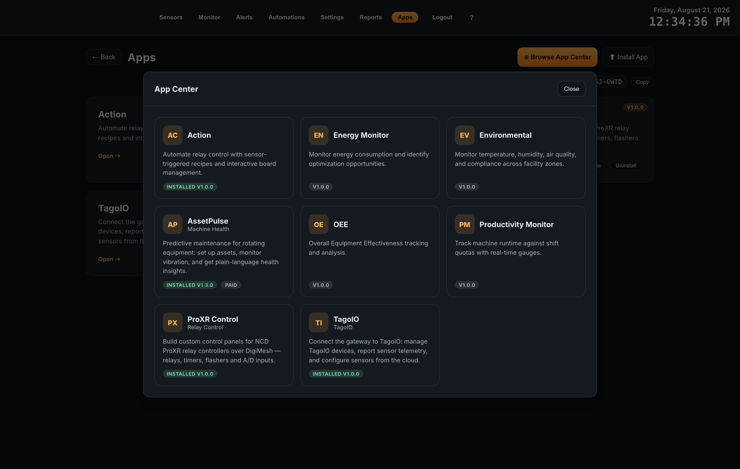

    Open the App Center
    On the Apps page, click Browse App Center. The catalog opens over the page and lists every app published for Atrium gateways; the ones already on this gateway carry an INSTALLED badge with their version.
  2. 2
    Find AssetPulse
    Its card is titled AssetPulse with the subtitle Machine Health, and carries a PAID badge marking it as a licensed app.
  3. 3
    Install it
    If this gateway does not meet a requirement — the wrong model, or a platform version older than the app needs — the App Center says which requirement is unmet instead of offering the install.

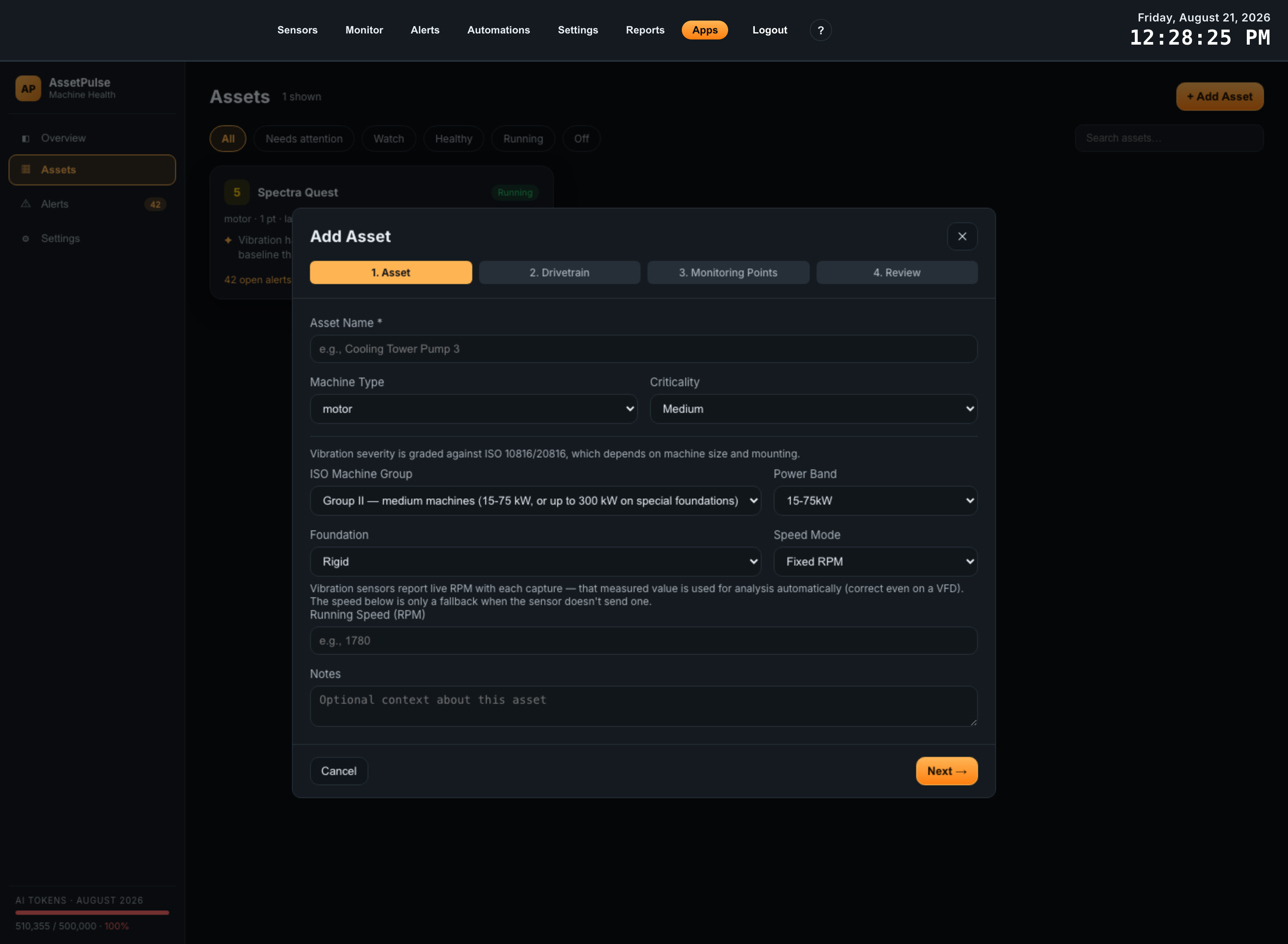

An asset is a machine you want to watch. Go to Assets and click + Add Asset to open a four-step wizard. What you enter here is what makes the analysis precise — the same vibration reading means different things on a small fan and a large rigid-mounted motor.
Step 1 — Asset
Describe the machine itself.
FieldWhat it does
Asset Name (required)How the machine appears throughout the app, for example Coolant Pump P-101.
Machine Typemotor, pump, fan, gearbox, compressor, blower, or other.
CriticalityLow, Medium, or High — how much this machine matters to you.
ISO Machine GroupGroup I (small, under 15 kW), Group II (medium, 15-75 kW or up to 300 kW on special foundations), Group III (large, rigid foundation), or Group IV (large, flexible foundation).
Power BandUnder 15 kW, 15-75 kW, 75-300 kW, or over 300 kW.
FoundationRigid or Flexible.
Speed ModeFixed RPM, Variable (VFD), or From tach metric.
Running Speed (RPM)Shown for Fixed RPM. For Variable (VFD) the fields become Min RPM and Max RPM; From tach metric asks for nothing. See the note below — which value actually gets used depends on this choice.
NotesOptional context — useful for recording when a baseline was taken.
Machine group, power band and foundation together decide which ISO zone boundaries apply, so they are worth getting right rather than leaving at the defaults.

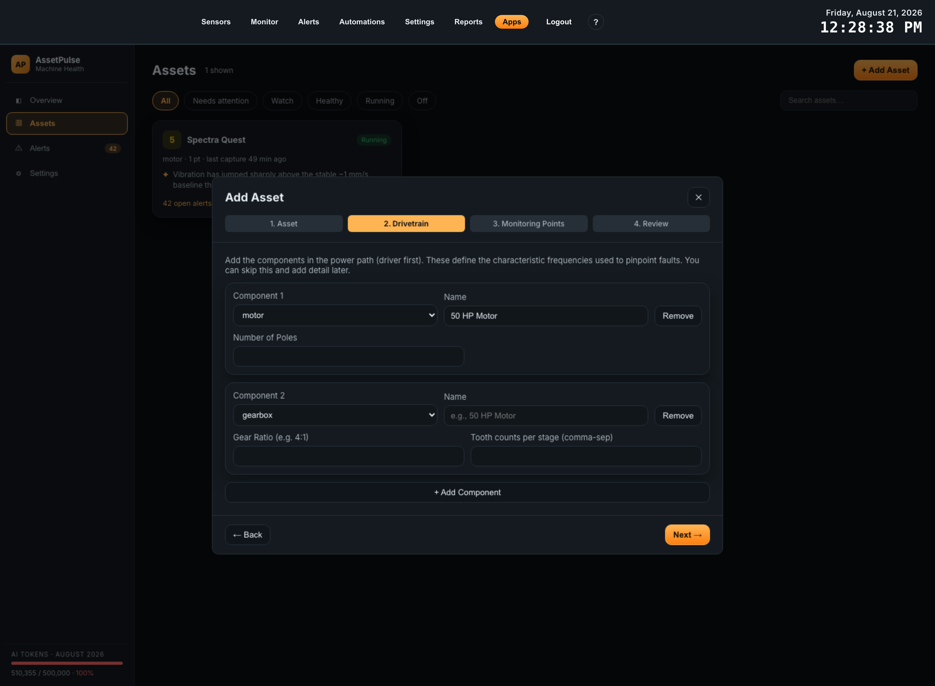

Step 2 — Drivetrain
A machine is not one object — it is a power path. Step 2 is where you list the parts of that path, driver first: the motor, then whatever it turns through whatever couples them. A pump skid might be motor → coupling → pump; a cooling tower might be motor → belt → fan.
This matters because rotating machines fail at predictable frequencies. A pump with 6 impeller vanes pushes energy at 6 times shaft speed; a 23-tooth gear meshes at 23 times its shaft speed; a 4-pole motor shows electrical faults near line frequency. Once AssetPulse knows the parts, it knows which frequencies to look at, and a peak in the spectrum stops being “energy at 174 Hz” and becomes “vane pass frequency”. Without the drivetrain it can still grade overall vibration severity — it just has fewer names to give what it finds.
Adding a component
Click + Add Component. Each component appears as its own card with:
  • Component N — the type. Choosing the type is what reveals the parameter fields below it, so set this first.
  • Name — free text, how the component reads in the app, for example 50 HP Motor or Gearbox (4:1).
  • Remove — deletes that card.
Add them in power-path order. The position of each card is the drivetrain order, so a component added out of sequence should be removed and re-added rather than left in the wrong place.

Each type asks only for what it needs. These values build the kinematic model that is handed to the analysis engine with every capture; leave one blank and the frequency it would have defined is simply not part of the model.
TypeParametersThe frequency it defines
motorNumber of PolesPoles and supply frequency fix the motor’s synchronous speed (a 4-pole motor on 60 Hz turns at 1800 RPM unloaded), which is the reference for electrically-driven vibration.
gearboxGear Ratio (e.g. 4:1)
Tooth counts per stage (comma-separated)
Gear mesh frequency — teeth × that shaft’s speed, per stage — and the output shaft speed implied by the ratio.
pumpImpeller Vane CountVane pass frequency — vanes × shaft speed. Where cavitation, recirculation and vane damage show up.
fan / blowerBlade CountBlade pass frequency — blades × shaft speed. What separates a fouled or damaged wheel from ordinary imbalance.
beltPulley RatioThe driven-side shaft speed, and the belt’s own rotation rate.
couplingNoneNothing on its own — it records the coupling as part of the power path.
otherNoneA placeholder so the power path can be described completely.
assetpulse atrium app guide 04 add asset step 2 drivetrain
Assets › Add Asset › Drivetrain. A motor added as the driver, and a second component being added — picking gearbox reveals its Gear Ratio and tooth-count fields.

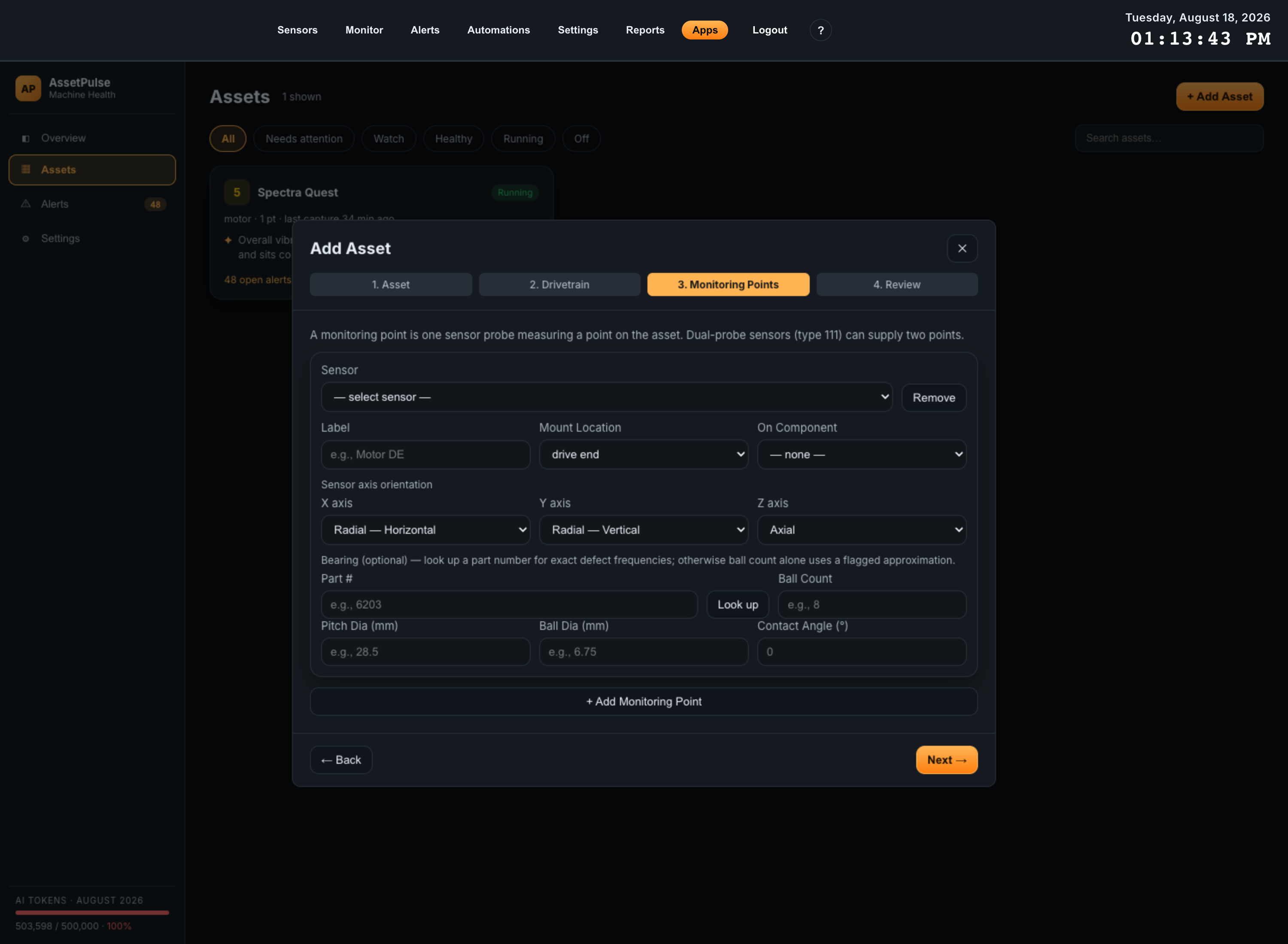

Step 3 — Monitoring Points
A monitoring point is one sensor probe measuring one point on the machine. Click + Add Monitoring Point and fill in:
FieldWhat it does
SensorWhich vibration sensor measures this point. Dual-probe sensors are marked (dual-probe) and can supply two points.
LabelA short name for the point, for example Motor DE.
Mount Locationdrive end, non drive end, inboard, outboard, casing, or other.
On ComponentWhich drivetrain component from step 2 this point sits on.
Sensor axis orientationWhat the sensor’s X, Y and Z axes mean on this machine: Radial-Horizontal, Radial-Vertical, Axial, or Tangential.
Bearing (optional)The bearing at this point. See below.
For bearings, entering a part number and clicking Look up gives exact defect frequencies. If you only supply ball count, pitch diameter, ball diameter and contact angle, the analysis uses a flagged approximation instead.
assetpulse atrium app guide 05 add asset step 3 monitoring points
Assets › Add Asset › Monitoring Points.
assetpulse atrium app guide 06 add monitoring point
A monitoring point: sensor, mount location, per-axis orientation, and an optional bearing.

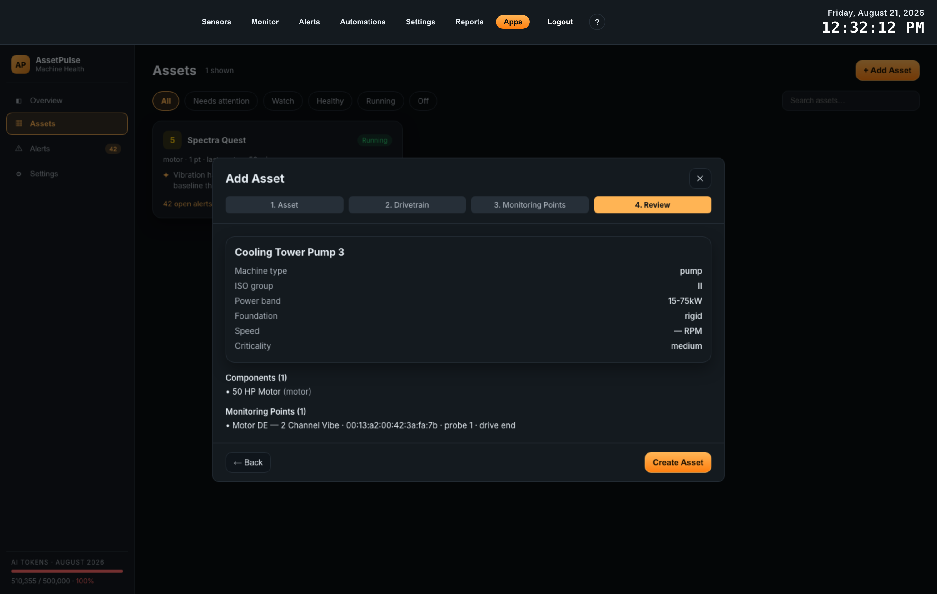

Step 4 — Review
The last step is a read-only summary of everything the wizard is about to create. Check it before saving — the machine description is what every future severity score is graded against, and a wrong ISO group or a missing vane count is far cheaper to fix here than to notice a month later in the trend.
BlockWhat to check
Asset summaryName, machine type, ISO group, power band, foundation, speed, criticality. Speed reads back as 1780 RPM, as 600-1800 RPM (VFD), or as From tach metric, depending on the speed mode.
Components (n)One line per drivetrain component, in power-path order, with its type in brackets. The count in the heading is the quickest check that nothing was lost.
Monitoring Points (n)One line per point: label, sensor name and device ID, probe number for dual-probe sensors, and mount location. A point showing (unlabeled) still works, but it is worth going back for a name.
← Back returns through the steps with everything you entered intact, so correcting something costs nothing. Create Asset saves the asset, its components and its monitoring points together in one operation — there is no half-saved state to clean up if something is rejected.

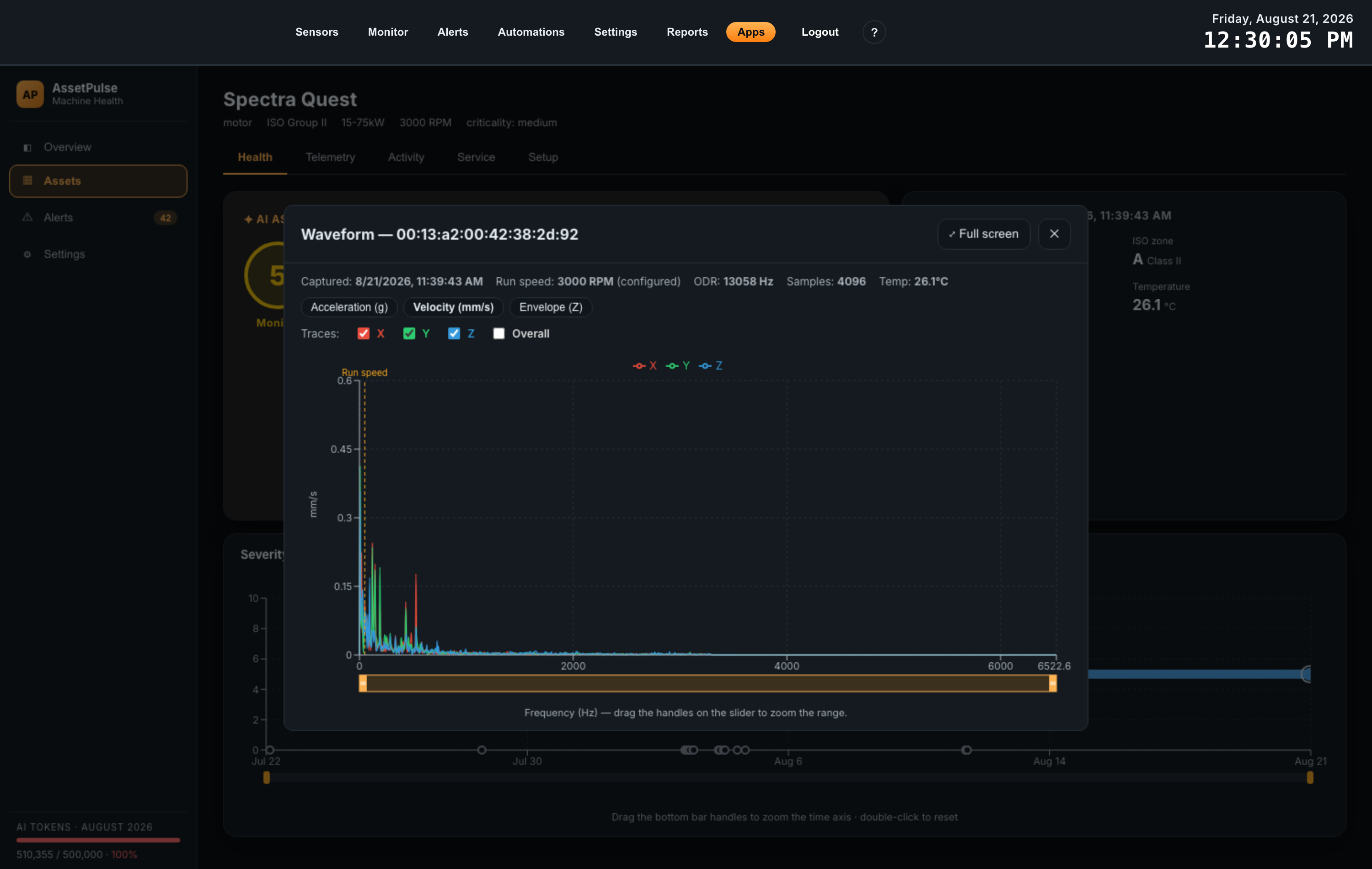

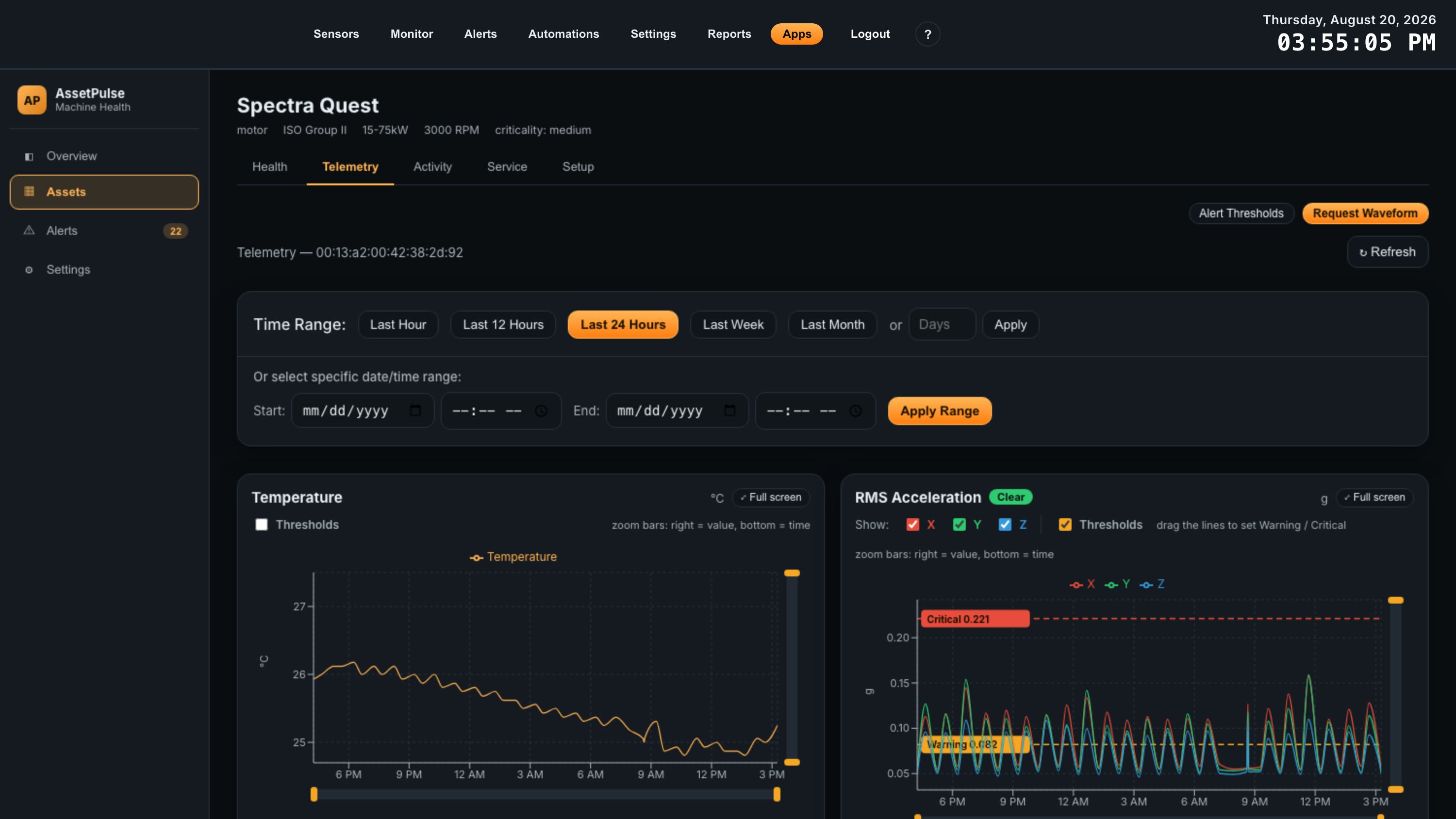

  • The first score arrives with the next capture from one of its sensors. Every capture that lands on one of this asset’s monitoring points is analyzed automatically from now on.
  • To get one immediately, open the asset, go to Telemetry and click Request Waveform. The sensor takes the capture on its next sync rather than instantly.

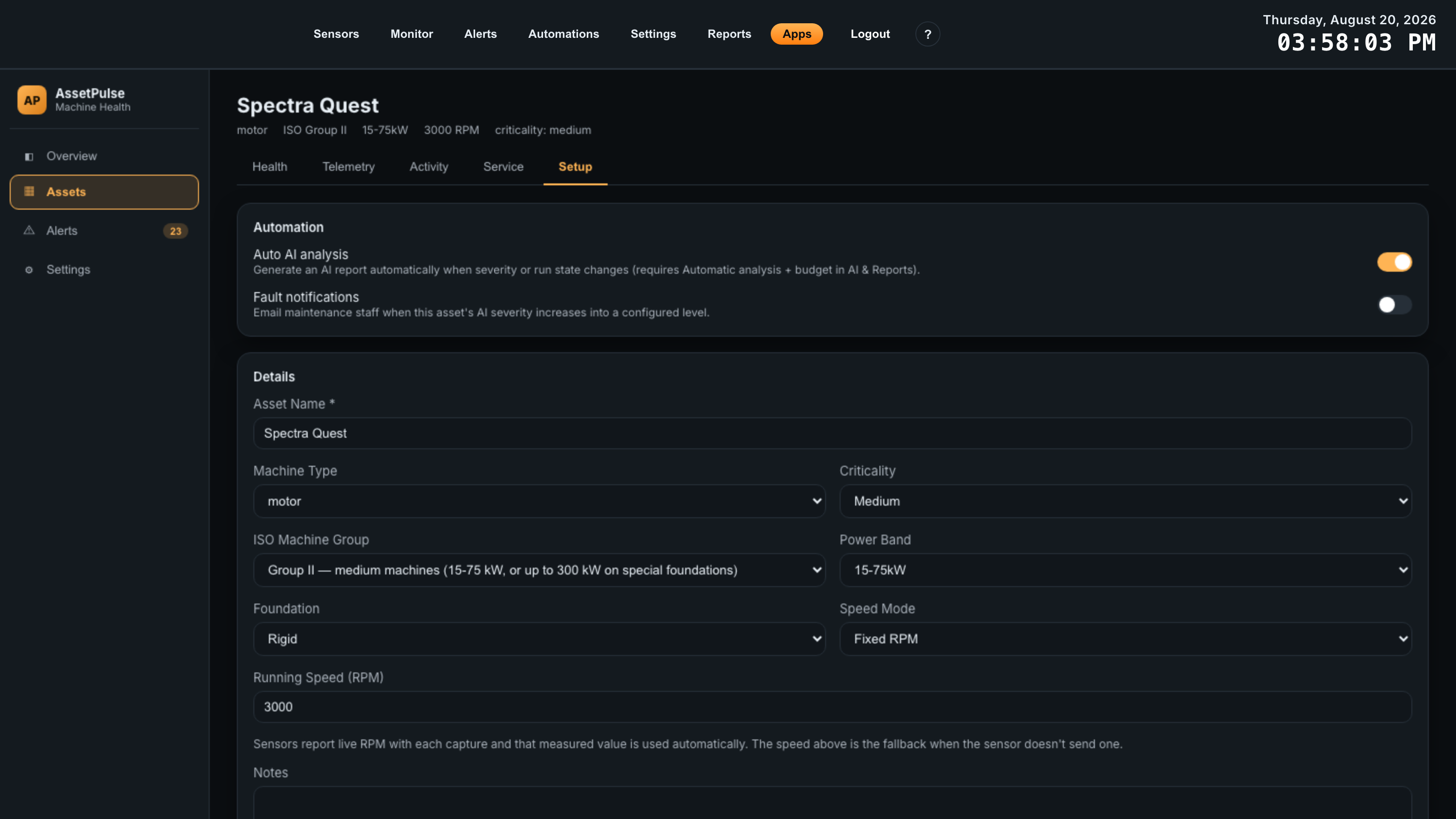

Everything entered in the wizard remains editable from the asset’s Setup tab, so a rough first pass is a reasonable way to start — get the sensor attached and the ISO class right, then add drivetrain and bearing detail as you learn the machine.

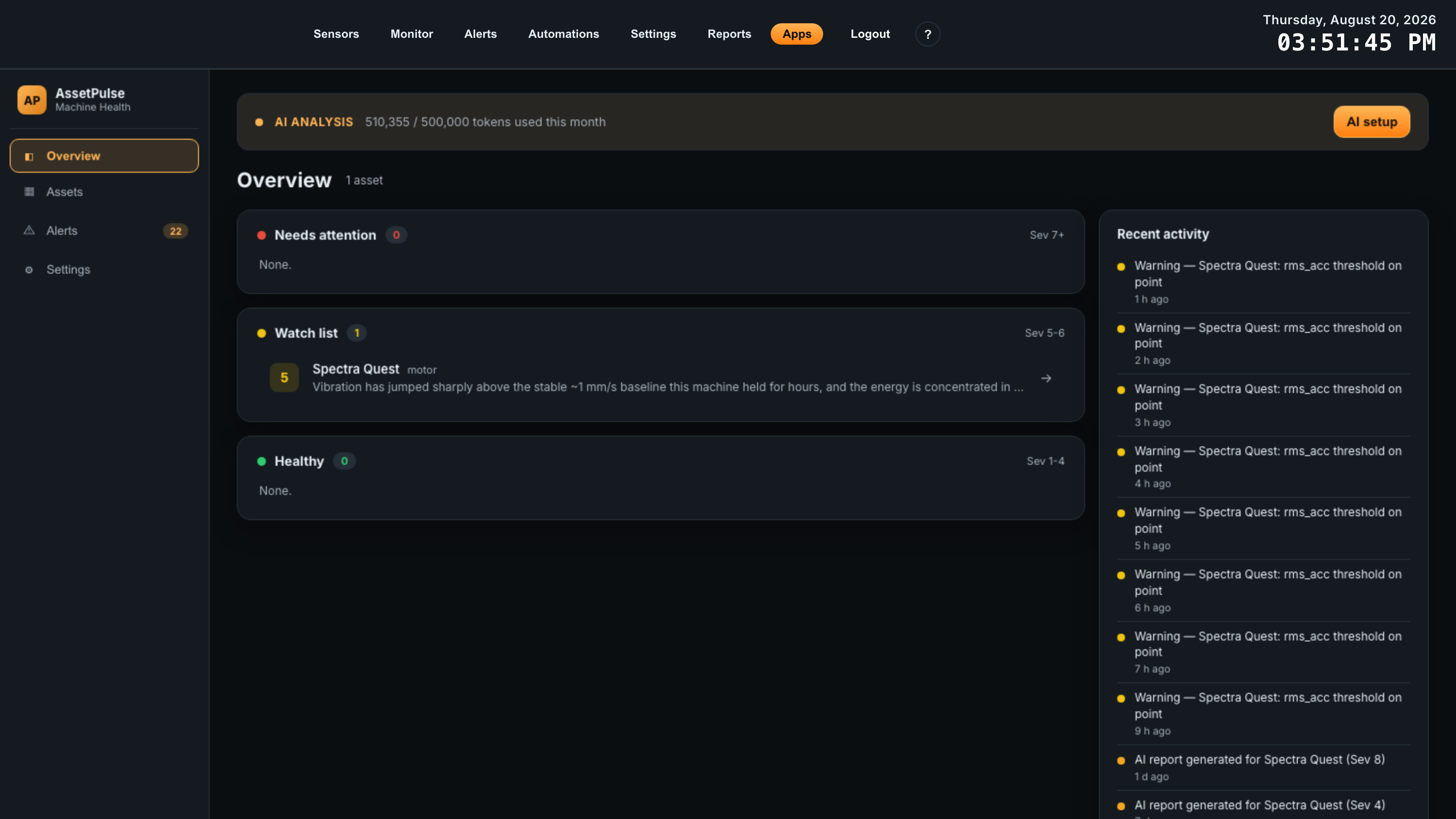

The landing screen answers one question: what needs attention right now. Assets are grouped into three severity bands, with a feed of recent activity underneath.
BandSeverityMeaning
Needs attention7 and aboveInvestigate now.
Watch list5 to 6Something is developing; keep an eye on the trend.
Healthy1 to 4Running as expected.
Recent activity lists threshold warnings and report generations across all assets, newest first, so you can see what changed since you last looked.

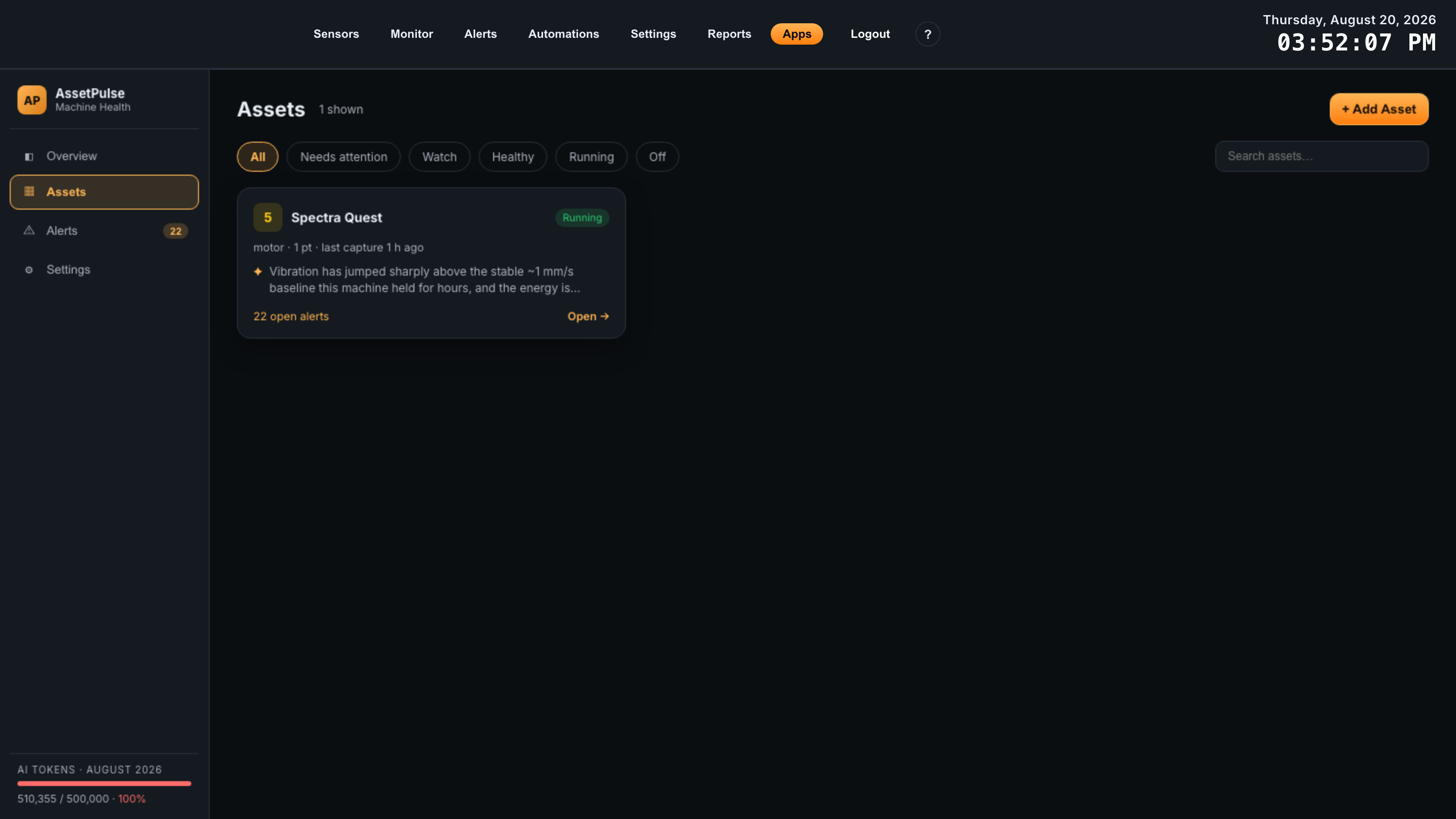

The Assets screen is the full list, filterable by All, Needs attention, Watch, Healthy, Running and Off, with a search box. Each card shows the severity score, run state, machine type, how many monitoring points it has, when it last captured, the latest assessment, and its open alert count.
assetpulse atrium app guide 09 assets list
The Assets screen, filtered and searchable.

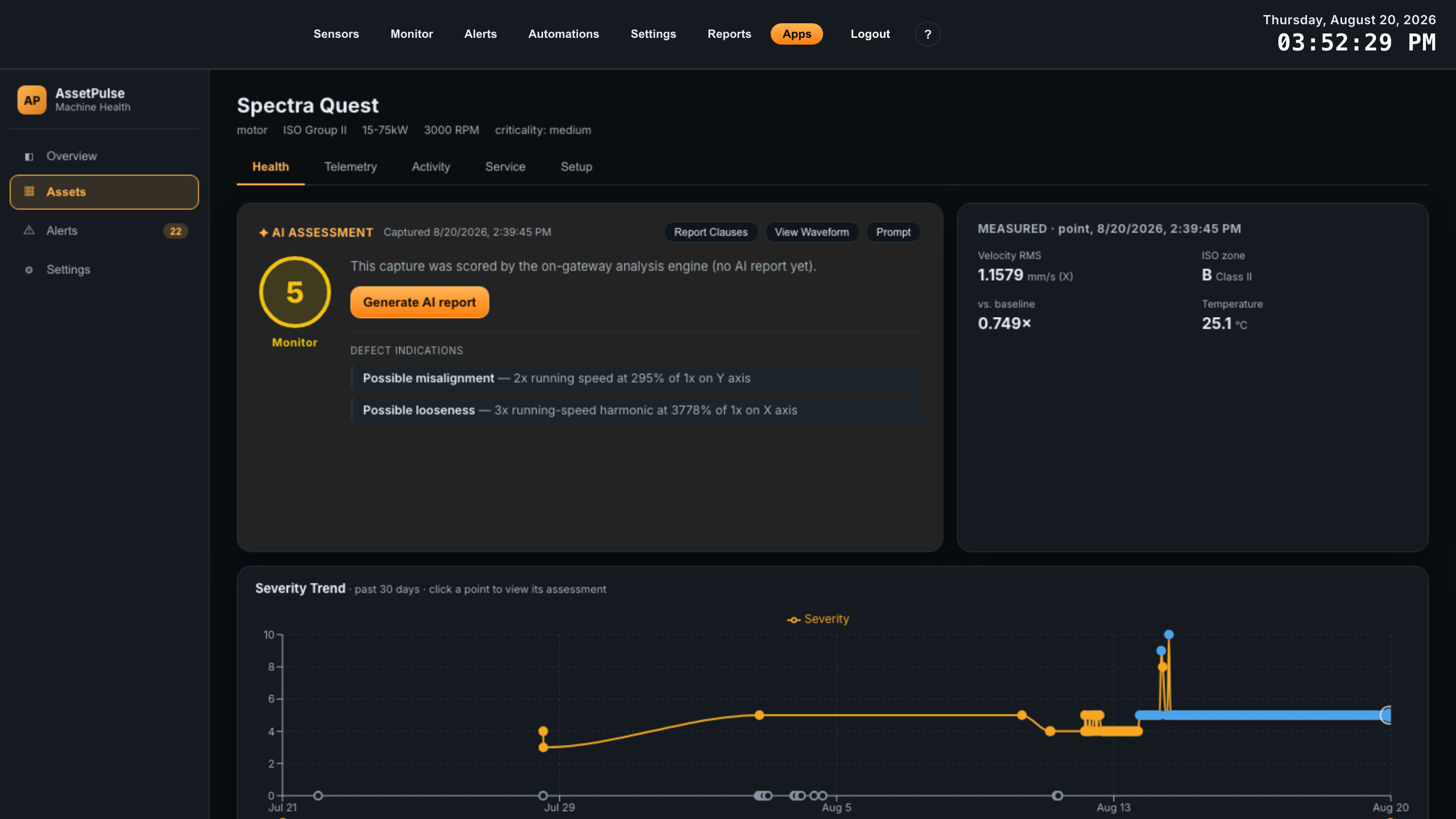

1. Health
Health is where AssetPulse earns its place. Everything else on the gateway records measurements; this tab turns one waveform capture into a graded, explained verdict about a specific machine, and puts thirty days of those verdicts on one chart.

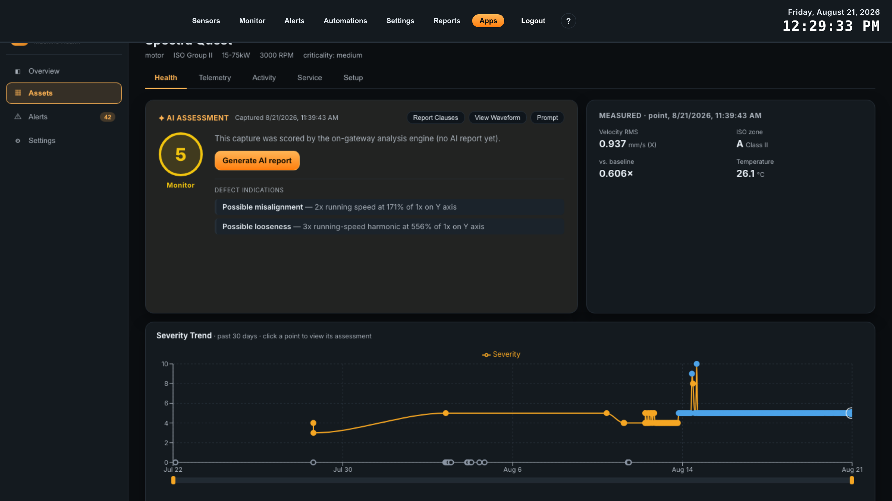

The tab has three parts: the AI Assessment panel on the left, the Measured panel on the right, and the Severity Trend chart underneath. The important thing to understand first is that the two panels always describe one single capture — the one currently selected on the trend chart. Click a different point on the trend and both panels change to that moment in the machine’s history.
assetpulse atrium app guide 10 asset health
Asset › Health. The AI Assessment panel, the Measured panel, and the Severity Trend for the selected capture.
The panel header names the capture it is describing — Captured <date and time> — followed by the actions that operate on that capture: Report Clauses, View Waveform, Prompt, and Regenerate (or Generate AI report where no report exists yet). Each is covered below.
The body of the panel holds, in order:
ElementWhat it tells you
Severity ring A single number from 1 to 10 with its label, colored to match. Where an AI report exists this is the AI’s severity; where one does not, it is the on-gateway engine’s score. A dash means the capture has no score — which happens when the machine was off.
Assessment The written verdict, in plain language: what the evidence looks like, and what it most likely means for this machine. This is the part the AI writes.
Recommended action One of five categories, from least to most urgent: Monitor, Monitor Closely, Plan Repair, Repair Now, Shut Down.
Confidence High, Medium or Low — how strongly the evidence supports the conclusion. Low confidence on a high severity is a reason to request another capture rather than to dispatch a crew.
AI usage Tokens this report consumed, so a report’s cost is visible next to the report itself. The running monthly total sits at the bottom of the app’s left-hand navigation.
Defect indications The named findings from the on-gateway engine, each with the evidence it rests on — for example Possible misalignment — 2x running speed at 230% of 1x on Y axis. These come from the gateway, not the AI, and appear whether or not AI is configured.
The panel reads differently depending on what exists for the selected capture:
SituationWhat the panel shows
Capture analyzed, report writtenThe full assessment, action, confidence and usage described above.
Capture scored, no report yet, AI configured“This capture was scored by the on-gateway analysis engine (no AI report yet)” and a Generate AI report button.
Capture scored, AI not configuredThe same explanation, with a pointer to configure AI Reports in Settings. The severity ring and defect indications still work.
Machine was off during the capture“Machine was off during this capture — no severity score.” A stopped machine has nothing to grade; scoring it would only produce a false all-clear.
No captures analyzed yet“No captures analyzed yet.” Use Request Waveform on the Telemetry tab if you do not want to wait for the sensor’s own schedule.

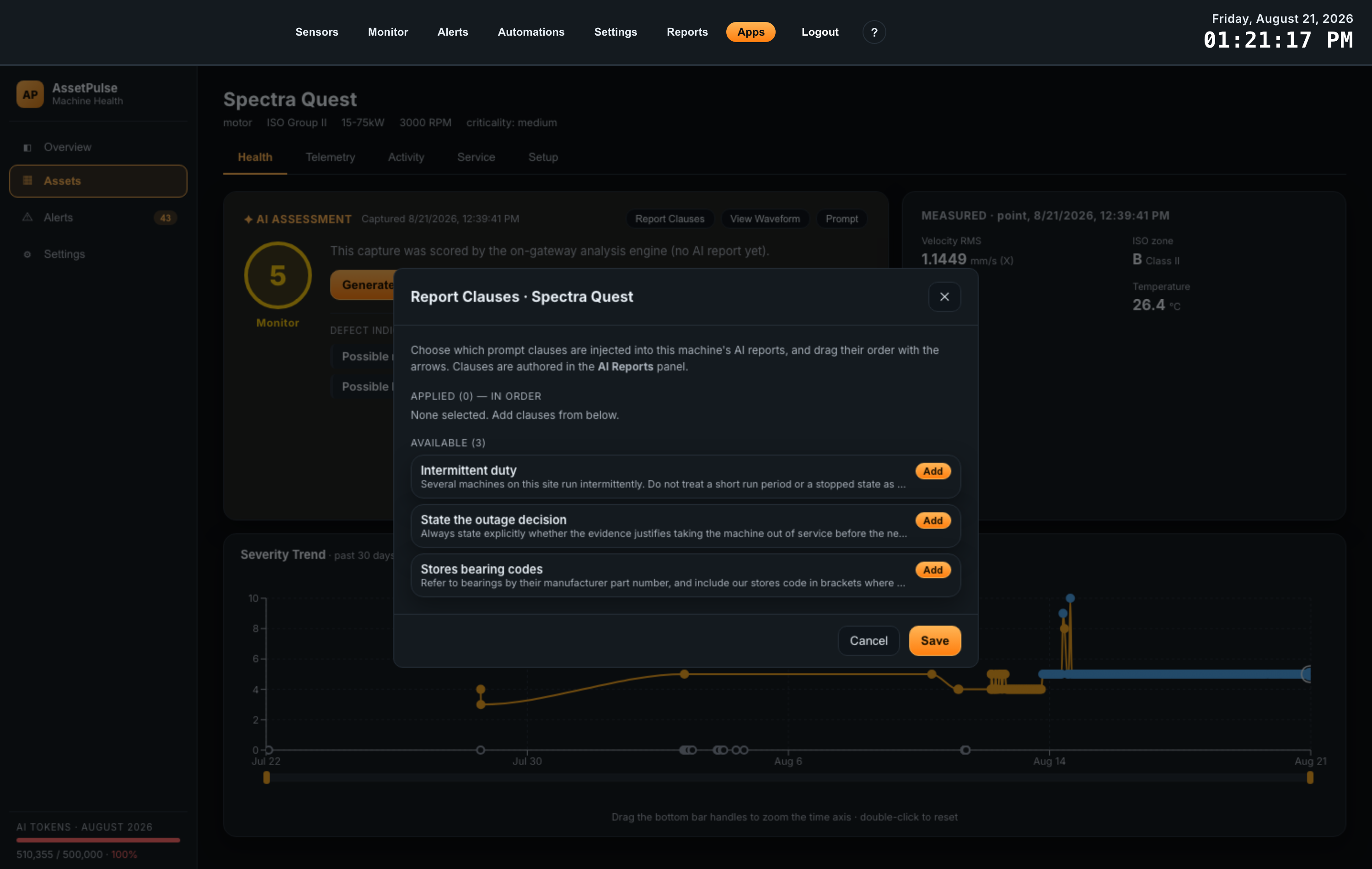

Report Clauses
AI reports are useful in proportion to how much they know about your plant. Report Clauses is where you decide which standing instructions are added to this particular machine’s reports — things the analysis cannot infer, such as “this pump runs intermittently, so short run periods are expected”, “refer to bearings by our stores code”, or “always state whether the reading justifies an outage”.
The modal has two lists:
  • Applied — the clauses this asset uses, in order. The arrows move a clause up or down, and Remove takes it out. Order matters because it is the order they appear in the prompt.
  • Available — every other enabled clause in the library. Add appends it to the applied list.
Save applies the selection to this asset only, from the next report onward. The clauses themselves — their names and wording — are written once in Settings under AI Reports, then reused across assets; a clause shown as disabled has been switched off there and will not be sent even while it is listed here.
assetpulse atrium app guide 12 report clauses
Asset › Health › Report Clauses. The clause library, each entry with an Add button. Applied is empty until you add one; from then on the arrows set the order they are sent in.

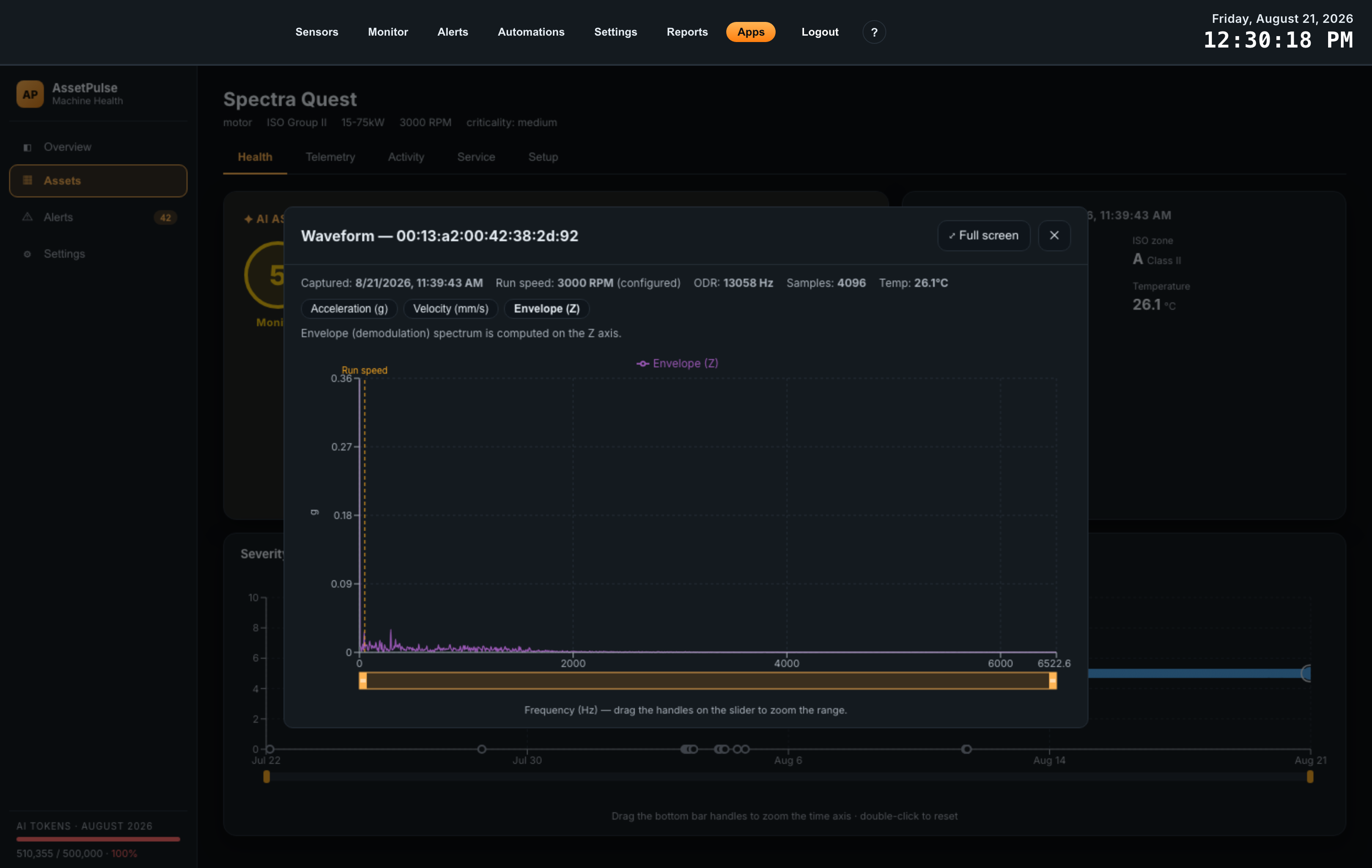

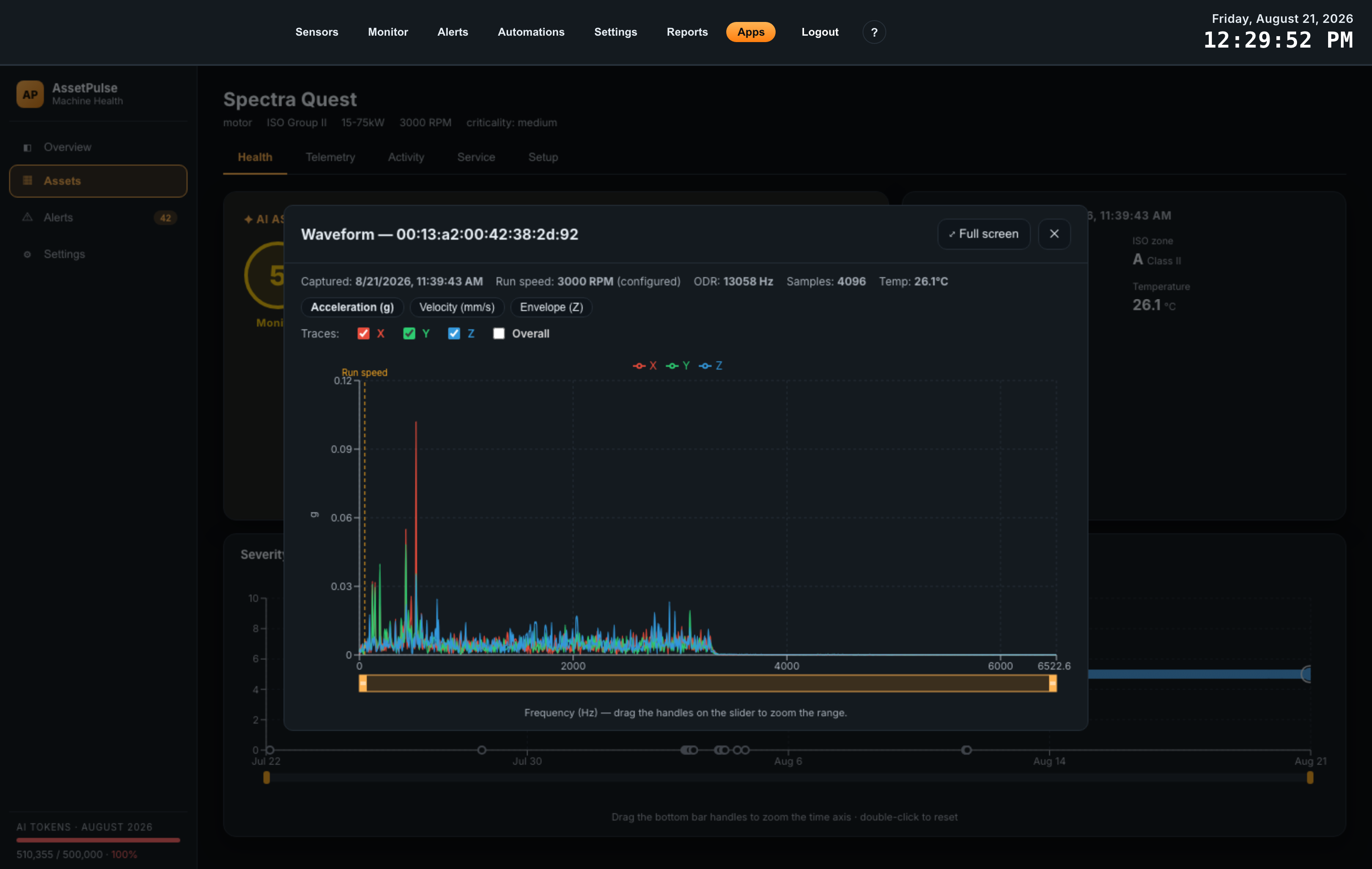

The Waveform viewer
View Waveform opens the frequency spectrum of the selected capture — the evidence underneath everything else on this tab. The button appears only when the selected capture has a stored raw waveform behind it. The spectrum is computed on the gateway when you open the viewer, from the stored samples.
The strip along the top states the conditions of the capture: when it was taken, the run speed in RPM (marked configured when it came from the asset’s fixed speed and measured when the sensor reported it), the ODR (output data rate, in Hz — the sampling rate, which sets how high in frequency the spectrum can see), the number of samples, and the temperature.
Three metric views, selected with the buttons above the chart:
ViewUnitWhat it is for
Acceleration (g)gThe default. Emphasises high-frequency content — bearing defects, gear mesh, looseness rattle.
Velocity (mm/s)mm/sThe view that matches ISO severity limits. Emphasises low-frequency content — imbalance, misalignment, running-speed harmonics.
Envelope (Z)gDemodulation, computed on the Z axis only. It strips away the strong low-frequency vibration to expose the small repetitive impacts of early bearing damage, long before they show up in the ordinary spectrum.
In the acceleration and velocity views, the Traces checkboxes turn the X, Y and Z axes on and off individually, plus Overall — the resultant of all three, off by default. Showing one axis at a time is the fastest way to confirm which direction a defect is acting in, which is exactly what the axis orientation you set on the monitoring point is there to make meaningful. The envelope view is Z-only, so it has no trace selection.
Two features make the spectrum readable rather than merely present:
  • A dashed Run speed line marks 1x — one turn of the shaft. Nearly all vibration diagnosis is a question of where energy sits relative to this line.
  • The tooltip reports every frequency both in Hz and as a multiple of run speed — “174.0 Hz (5.8× run speed)”. A peak at 2x suggests misalignment; a peak at the vane or blade count suggests the pumped or moved fluid; a peak at a non-integer multiple with sidebands suggests a bearing.
Drag the handles on the slider under the chart to zoom the frequency axis, and use Full screen when a crowded spectrum needs the room.
assetpulse atrium app guide 14 waveform acceleration
Asset › Health › View Waveform. Acceleration spectrum with X, Y and Z traces and the dashed run-speed marker at 1x.

assetpulse atrium app guide 16 waveform envelope
The Envelope (Z) view. Demodulation exposes early repetitive bearing impacts that the ordinary spectrum buries.

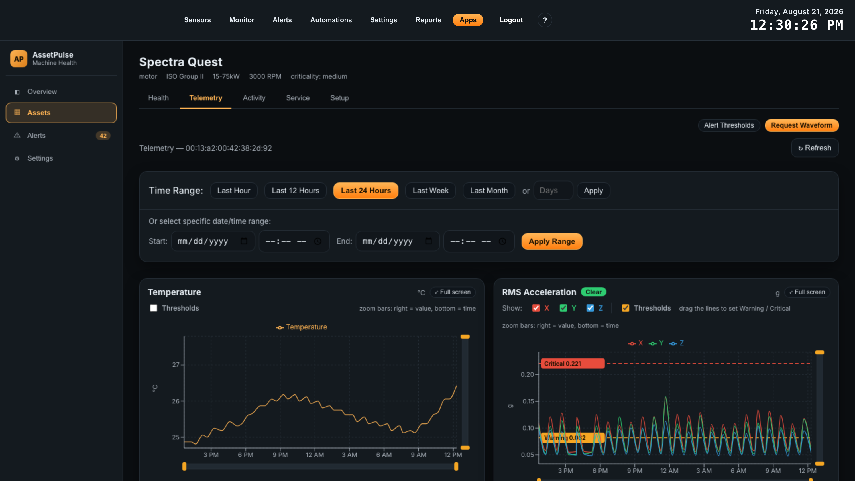

2. Telemetry

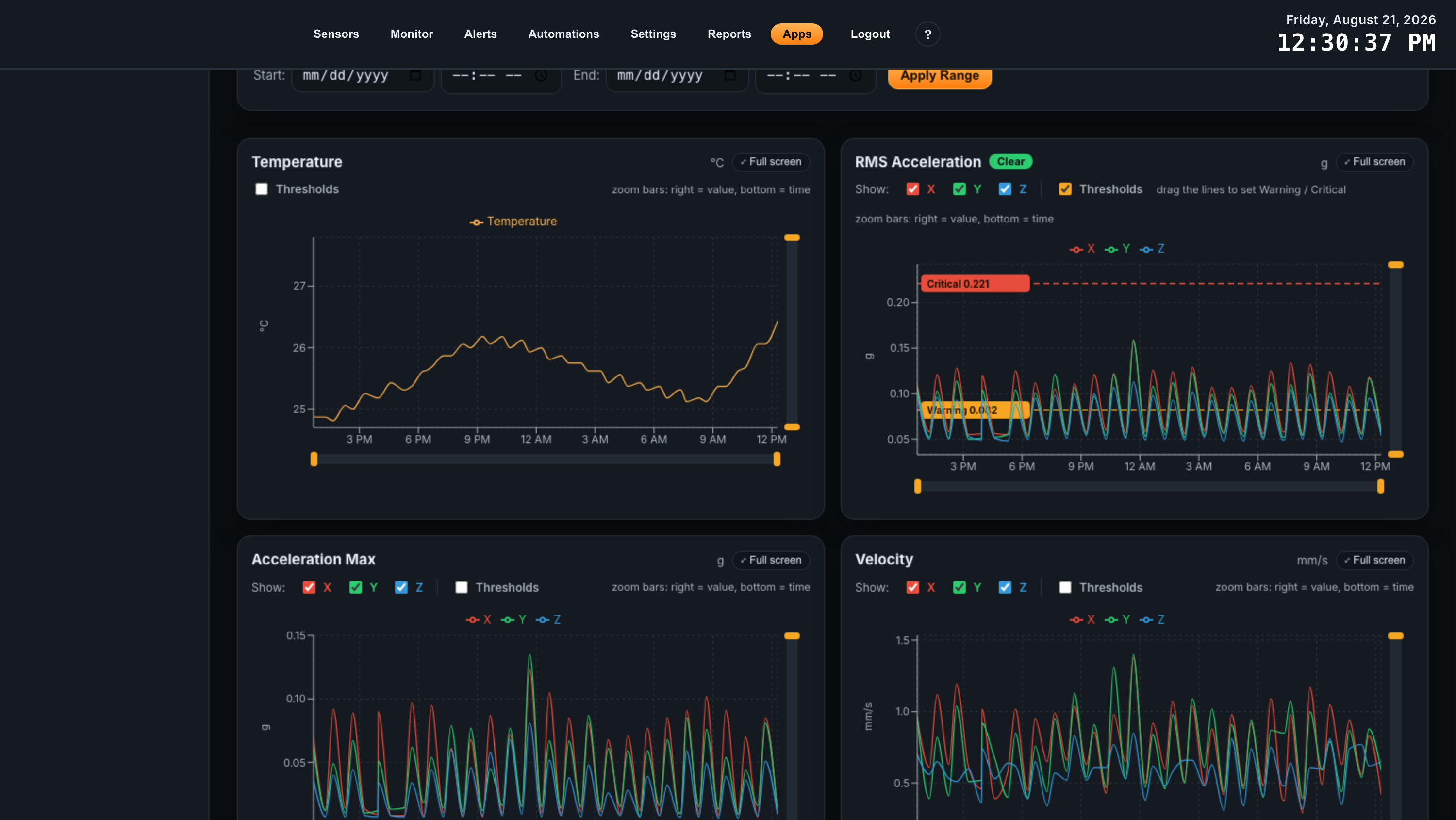

Health answers “what is wrong with this machine”. Telemetry answers “what have the numbers been doing”, and it is where you set the thresholds that make AssetPulse tell you about a change without being asked.
Everything on this tab is scoped to one monitoring point. Where an asset has more than one, the Monitoring point selector at the top switches between them; dual-probe sensors list each probe separately. Two buttons sit alongside it:
  • Request Waveform queues a one-shot raw capture from this point’s sensor. The sensor is asleep between its scheduled reports, so it takes the capture on its next sync rather than immediately — then the capture is analyzed and appears on the Health tab as a new dot.
  • Alert Thresholds opens the table of every threshold on this asset, described at the end of this section.
Refresh reloads the graphs for the current window.
Choosing a time range
The panel at the top of the tab sets the window every graph below it draws. Preset buttons cover Last Hour, Last 12 Hours, Last 24 Hours, Last Week and Last Month. Beside them, a Days box with Apply takes any number of days from 1 to 365 — useful for “the last 90 days” without hunting for dates.
Under that, Or select specific date/time range takes an absolute Start and End date and time and applies it with Apply Range; Reset returns to Last 24 Hours. This is the one to use when you are comparing against a known event — the day a coupling was replaced, or the shift when an operator reported a noise.
Wide windows are averaged into buckets before they are drawn, because a month of raw readings is neither readable nor quick to load. The bucket size is chosen for you:
WindowEach plotted point is
Up to 1 houra raw reading — no averaging
Up to 12 hoursa 1-minute average
Up to 24 hoursa 2-minute average
Up to 7 daysa 10-minute average
Up to 30 daysa 30-minute average
Over 30 daysa 1-hour average
assetpulse atrium app guide 17 asset telemetry
Asset › Telemetry. The monitoring point selector, Request Waveform, the time-range panel, and the first of the seven graphs.

The seven graphs
Each monitoring point produces seven graphs. Together they are the sensor’s routine reporting — the small numbers it sends on every cycle, as opposed to the full waveform captures behind the Health tab.
GraphUnitSeriesWhat it is good for
Temperature°ConeBearing and lubrication trouble usually shows as heat as well as vibration. A step change with no vibration change often means a cooling or load problem instead.
RMS AccelerationgX, Y, ZThe everyday measure of how much the machine is shaking. The most useful single trend to set a threshold on.
Acceleration MaxgX, Y, ZThe peak within each reporting period. Rising max with steady RMS points at impacts — looseness, a spalled bearing race — rather than at general roughness.
Velocitymm/sX, Y, ZThe quantity ISO severity is written in. This is the trend to quote when discussing whether a machine is inside standards.
X / Y / Z Peak FrequenciesHzPeak 1, 2, 3Three graphs, one per axis, each tracking where the sensor found its strongest three frequencies. When a dominant peak moves or a new one takes over, something in the machine has changed character — a strong prompt to open the waveform viewer.
Working with a graph
Every graph carries the same controls.
ControlBehavior
Status badgeNext to the title: Clear, Warning or Critical — where the latest reading sits against this graph’s thresholds. Absent until thresholds are set.
Series legendClick an entry to hide or show that series. Isolating one axis is how you tell a horizontal problem from a vertical one.
ThresholdsThe checkbox that turns this graph’s Warning and Critical lines on. See below.

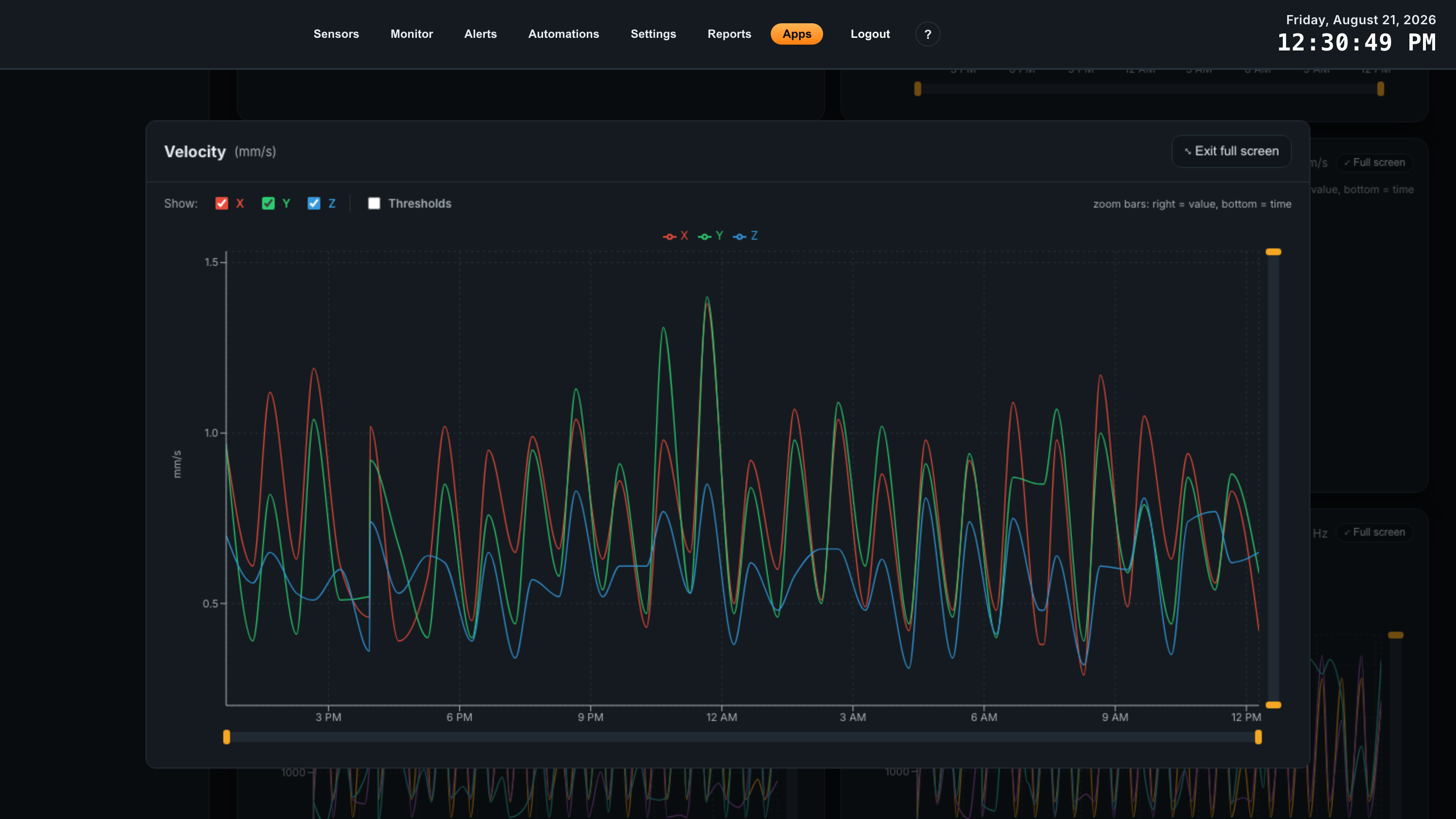

Zoom barsTwo: the bar on the right zooms the value axis, the bar along the bottom zooms time. Drag a handle to resize the window, drag the middle to pan, double-click to reset. Reset zoom clears both.
Full screenOpens the graph alone at full window size, with the same controls. The way to read a crowded trend.
No data in this time rangeThe graph has no readings in the current window — a wider range, or a sensor that has not reported.
assetpulse atrium app guide 19 telemetry full screen
A single graph in full screen, with the value zoom bar at the right and the time zoom bar along the bottom.
Setting thresholds by dragging
Tick Thresholds on a graph and two dashed lines appear across it: an amber Warning line and a red Critical line, each with a labelled tab showing its value. Drag a tab up or down to set the level; the value follows your drag and is saved when you let go. The graph keeps its scale while you drag, and leaves headroom above the data so a threshold can be placed above anything recorded so far.
Setting a threshold against a real trend is the point of doing it here rather than in a form: you can see the machine’s normal band, its daily variation, and where a line would have to sit to catch a genuine change without firing on every start-up. A common first pass is Warning a little above the highest normal peak, and Critical where you would want someone woken up.
Thresholds are stored per monitoring point, per graph — so the drive end and the non-drive end of the same machine can have different limits, and temperature limits are independent of vibration limits.
assetpulse atrium app guide 20 telemetry thresholds
Thresholds enabled on a graph. Drag the Warning and Critical tabs to set each level against the machine’s actual trend.

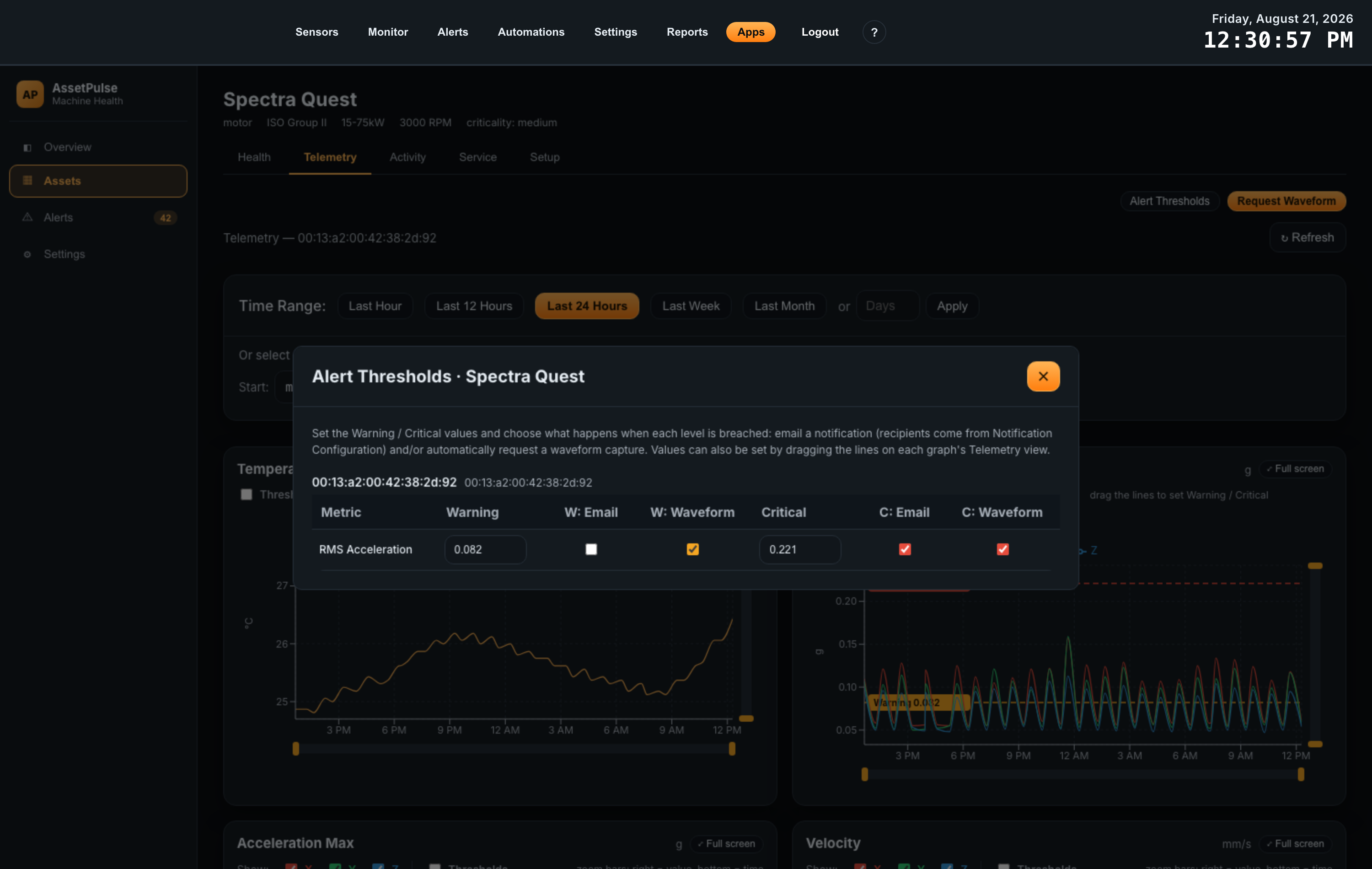

Alert Thresholds — deciding what a breach does
Dragging a line sets a value. What should happen when a reading crosses it is set in the Alert Thresholds table, reachable from this tab or from Activity. It lists every monitoring point on the asset, and for each graph that has thresholds:
ColumnWhat it does
Warning / CriticalThe values themselves, typed rather than dragged. Clearing a value disables that level.
W: Email / C: EmailEmail when this level is breached. Recipients come from Notification Configuration; delivery uses the gateway’s SMTP settings.
W: Waveform / C: WaveformAutomatically request a raw waveform capture when this level is breached — so the evidence for a problem is collected at the moment it appears rather than after someone gets round to looking.
The checkboxes for a level stay disabled until that level has a value, and a point with no thresholds at all reads No thresholds set. Enable thresholds on this point’s Telemetry view first. — the values come from the graphs, the actions come from here.
assetpulse atrium app guide 21 alert thresholds
Alert Thresholds. Per point and per metric: the Warning and Critical values, and whether each level emails, captures a waveform, or both.

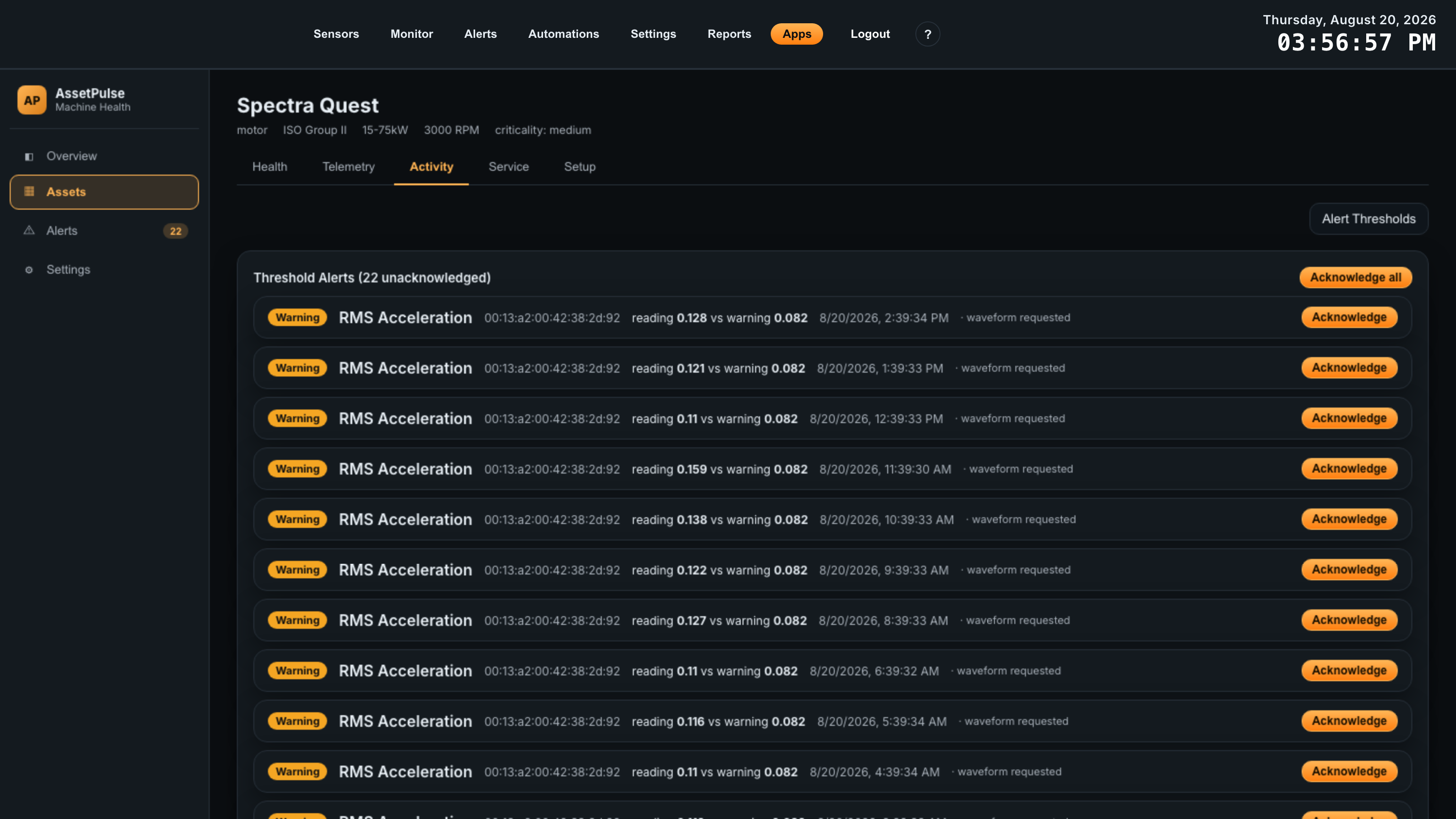

Threshold Alerts is every threshold breach this asset has raised, unacknowledged first, with the count of open ones in the heading. Each row names the metric and the monitoring point, states the reading against the limit it crossed (reading 0.126 vs warning 0.082), and timestamps it. Tags on the row record what the breach triggered — waveform requested, emailed. Acknowledge clears one row from the open count and Acknowledge all clears the backlog; the asset keeps its raised status until every open alert is acknowledged. A row marked timed out was never acknowledged within the re-arm window, so a continuing breach raised a fresh alert instead of staying silent behind the old one.

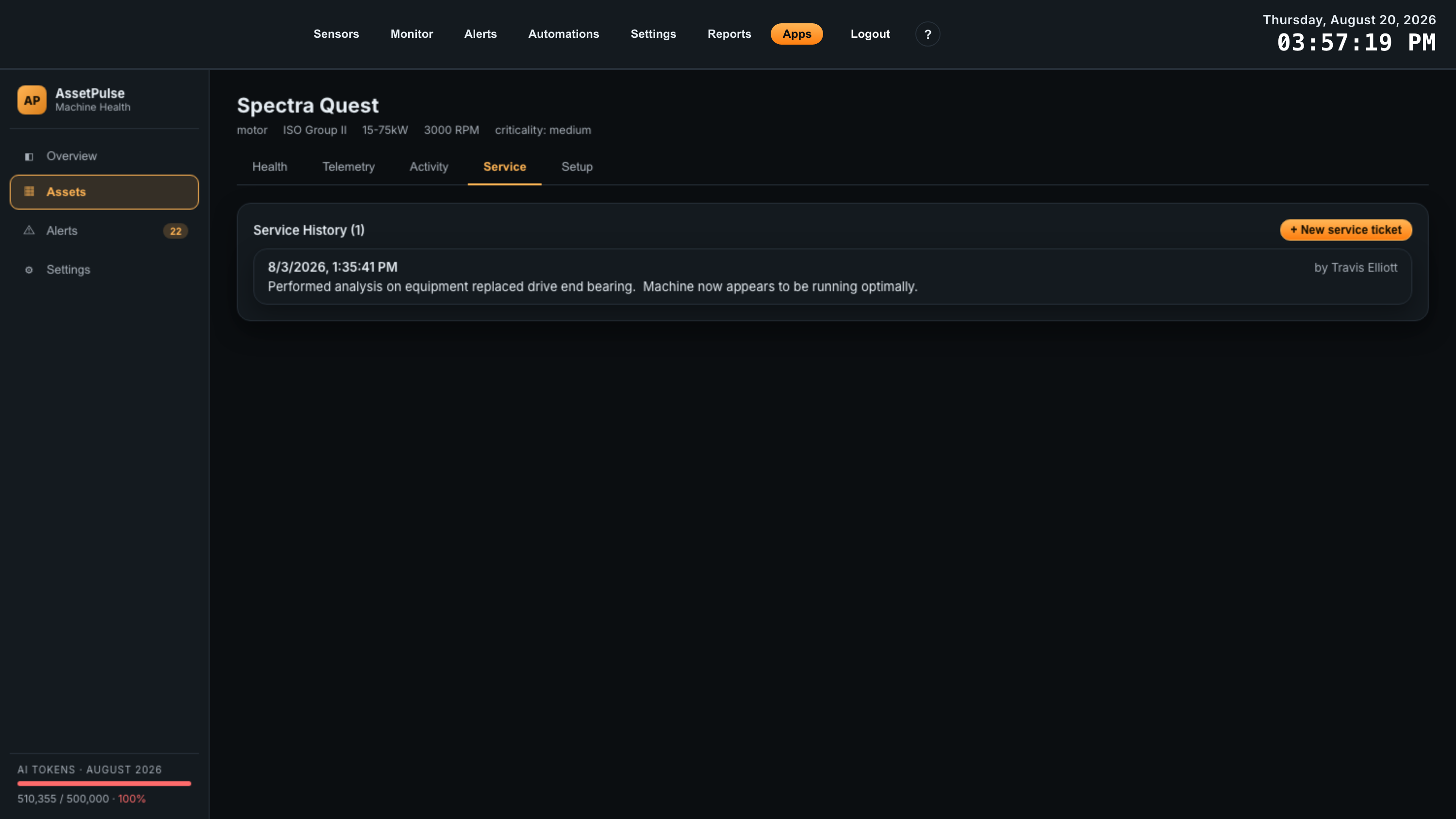

4. Service
The Service tab is the machine’s maintenance record — and it does one thing no other tab does: adding a service report is what stops repeat fault emails after you have fixed the machine. If you read only one paragraph about this tab, read the next one.
Why notifications go quiet, in plain terms
A machine with a real fault produces a high severity on every capture, for days or weeks. Emailing each one would be useless, so AssetPulse remembers the highest severity it has already emailed you about for this asset, and does not email again for anything at or below that level. One fault, one email.
Only three things break that silence:
  1. It gets worse. A capture that scores higher than the level already reported — and crosses another of the severity levels you asked to be told about — sends a new email.
  2. You add a service report. The remembered level is reset, so the very next qualifying capture emails you again. This is the intended way to close the loop.
  3. The re-arm timeout expires. If a fault is still there and nobody has recorded any work, AssetPulse re-sends after a set period — 48 hours by default — so an ignored fault resurfaces rather than being silenced forever. The period is set with the other notification defaults in Settings, and can be switched off.
So the practical rule: service report after every repair. It is the difference between “no emails because the machine is fine” and “no emails because the app already told us once”.

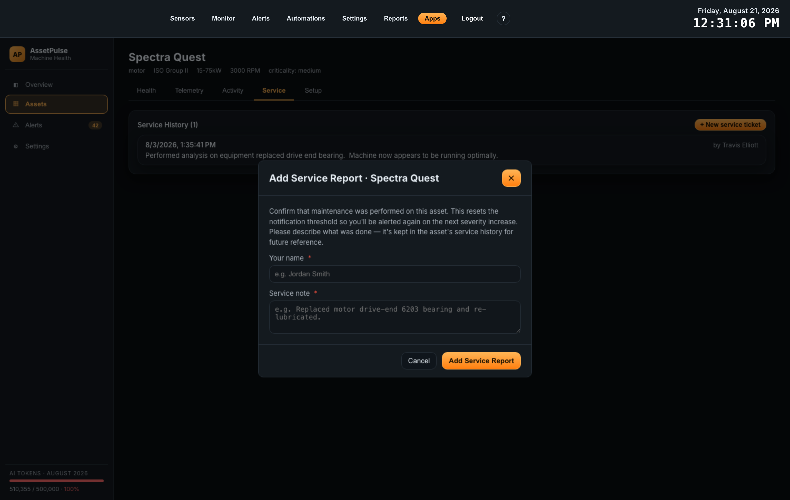

Adding a service report
Click + New service ticket. The Add Service Report dialog asks for two things, both required:
FieldWhat to put in it
Your nameWho did the work. Kept with the entry, so the history says who to ask in six months.
Service noteWhat was actually done — for example Replaced motor drive-end 6203 bearing and re-lubricated. Specific beats brief: this is the text you will be reading against the trend later.
Add Service Report saves the entry and resets the notification level in the same action; the app confirms with Service confirmed — notifications reset. There is no separate “clear faults” button to remember.
assetpulse atrium app guide 23 add service report
Asset › Service › Add Service Report. Recording the work is what re-arms fault notifications.
Reading the history
Service History lists entries newest first: when, who, the note, and — where notifications had already fired — the level it reset from, shown as reset from Sev 8. That last detail makes the log a record of what the machine was doing when someone intervened, not just a list of jobs.
Read alongside the Severity Trend, the log is what turns a chart into a story: severity climbing to 8 over two weeks, a bearing replacement, severity back to 3, and a clean baseline for whatever happens next. It is also the honest answer to “did that repair work?” — the trend after the entry says so either way.
assetpulse atrium app guide 24 service history
Asset › Service. Each entry records who did the work, what was done, and the severity it reset from.

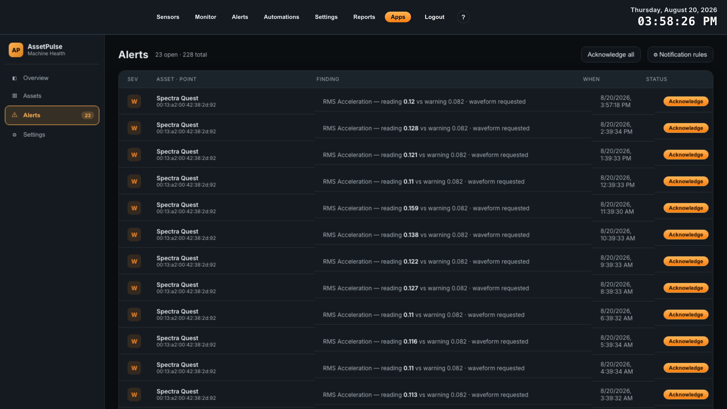

07Alerts
Every threshold crossing across all assets, in one table: severity, the asset and monitoring point, the finding, when it happened, and its status.
A finding reads like RMS Acceleration — reading 0.126 vs warning 0.082 · waveform requested, so you can see both what tripped and what AssetPulse did about it. Acknowledge rows individually, or clear the backlog with Acknowledge all.
Notification rules control who gets emailed and at what severity. Delivery uses the gateway’s SMTP settings, so those must be configured in Atrium’s Settings first.
assetpulse atrium app guide 26 alerts
The Alerts screen — findings across all assets with their readings and thresholds.

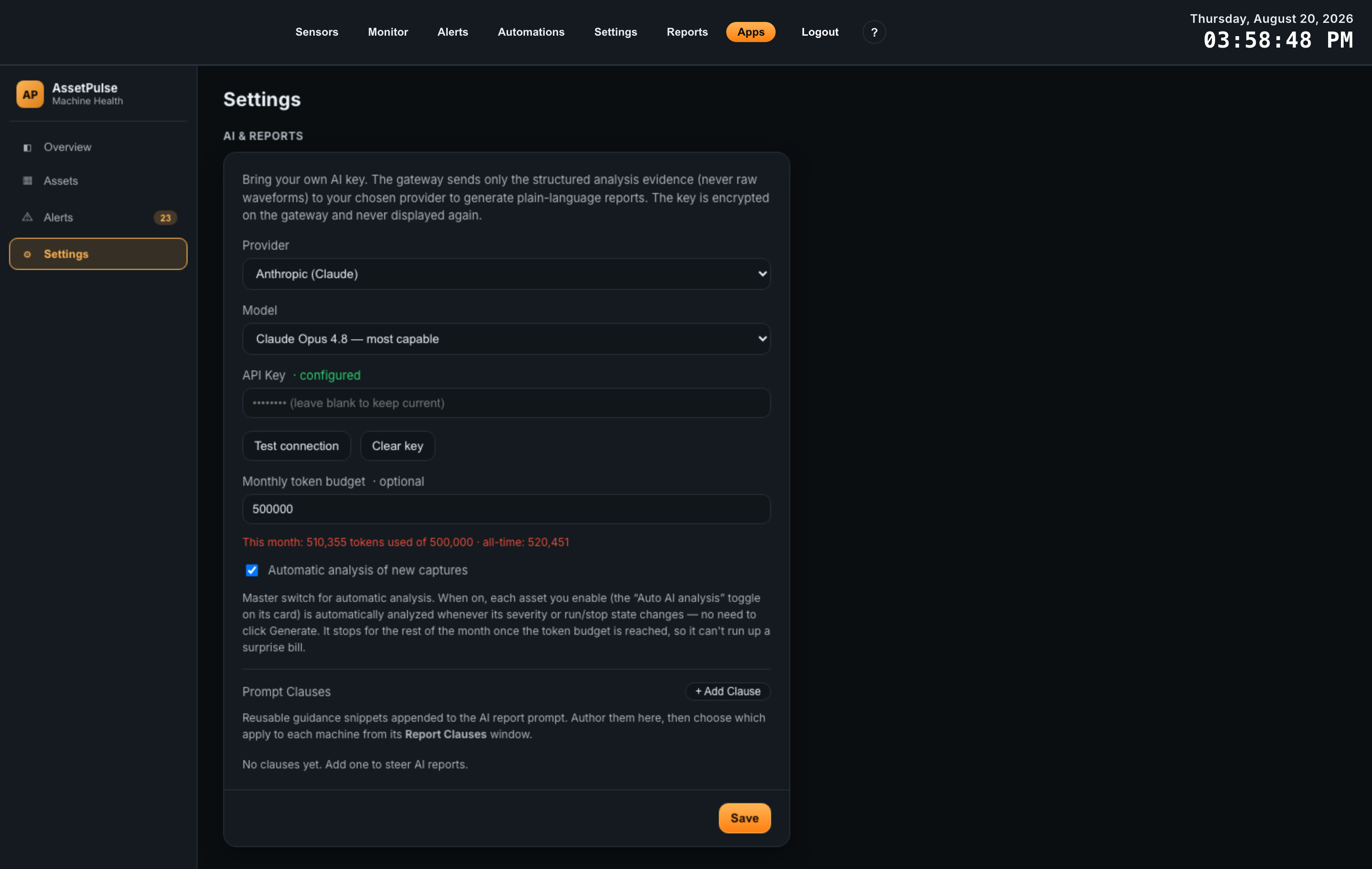

08AI Reports
AssetPulse can turn its analysis into a readable report. This is optional — severity grading, trending and alerts all work without it — and it runs on your own AI key.
What gets sent
Only the structured analysis evidence leaves the gateway. Raw waveforms are never sent. Your API key is encrypted on the gateway and is not displayed again after you save it.
Setting it up
SettingWhat it does
ProviderAnthropic (Claude) or OpenAI. Support for further providers is coming.
ModelThe provider’s default, or a model you name yourself.
API KeyYour key. Test connection confirms it works.
Monthly token budgetOptional but recommended — see below.
Automatic analysis of new capturesMaster switch. With it on, each asset that has its own Auto AI analysis toggle enabled is analyzed whenever its severity or run state changes, with no need to click Generate.
Prompt ClausesStanding instructions added to every report request — house terminology, what to always mention, what to leave out.
Reports can also be generated on demand from an asset’s Health tab with Generate AI report, regardless of whether automatic analysis is on.
assetpulse atrium app guide 27 settings ai reports
Settings — provider, model, key, token budget, automatic analysis, and prompt clauses.
