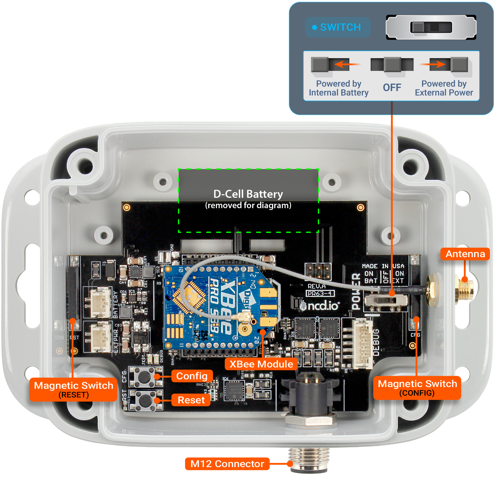

Powering On
  1. 1
    Open the enclosure
    Remove the four screws securing the enclosure lid and lift the cover.
  2. 2
    Power on the sensor
    The D-cell battery is pre-installed, but the 3-position power switch ships in the middle OFF position. Slide it to Battery to run on the internal D-cell, or to External if you are powering the unit from the external supply. After a few seconds the LED will blink once, pause briefly, then blink twice quickly — this confirms successful power-on.
  3. 3
    Close and seal the enclosure
    Replace the lid and tighten all four screws evenly to maintain the enclosure seal. Position the antenna upright for best signal strength.
01 sensor enclosure open
Inside the enclosure — the D-cell battery bay, the Battery / Off / External power switch, the RESET and CONFIG magnetic switches (with matching PCB buttons), the wireless module and antenna connection, and the M12 probe connector.

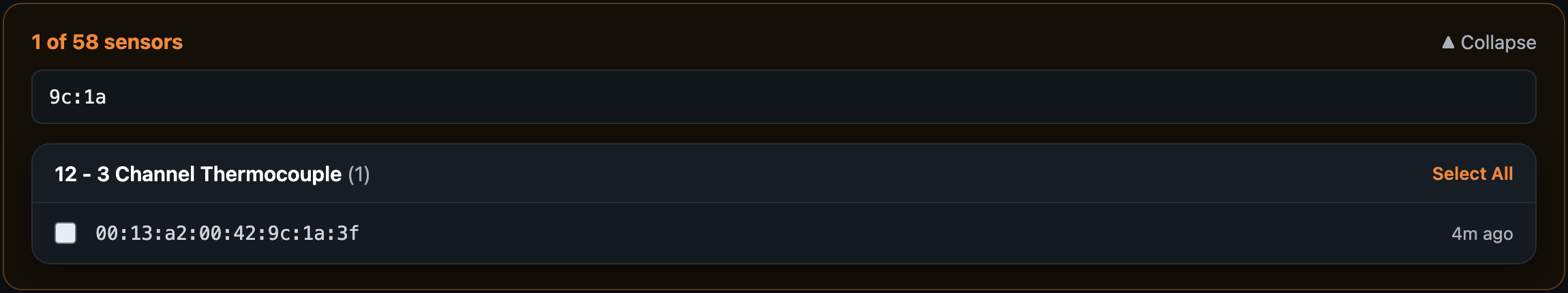

    Select sensors to set up
    The Set Up Your Sensors step lists all detected sensors with checkboxes, pre-selected by default. Deselect any you don’t want to add, then click Set Up [X] Sensors.

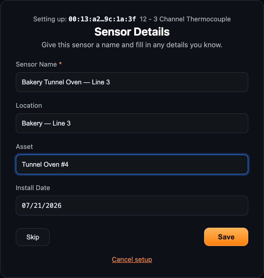

    Name and locate the sensor
    Click the sensor in the Sensors table to open its configuration. On the Sensor Meta tab, enter a Sensor Name, Asset, and Location. See Section 6 for full details.

Atrium detects new sensors automatically and lists them in the “sensors need setup” banner, grouped by type.
03 setup wizard sensors
The setup wizard’s sensor selection step — all detected sensors are pre-selected. Deselect any you don’t need, then confirm.
06Sensor Meta
The Sensor Meta tab controls how Atrium identifies and tracks this sensor. Access it via Sensors → [your sensor] → Configure → Sensor Meta.
FieldDescription
Sensor StatusWhitelisted — data is logged and displayed. Blacklisted — data is ignored.
Sensor NameHuman-readable label shown throughout the Atrium interface.
AssetThe asset or equipment this sensor is monitoring (e.g. “Oven 4 — Zones 1–3”).
LocationPhysical location of the sensor (e.g. “Plant A — Bakery Line”).
Report Interval (seconds)Must match the Delay value in Sensor Hardware Settings. Atrium marks the sensor offline if no data is received within 2× this value.
Install DateOptional. Records when the sensor was deployed.
Offline AlertWhen enabled, Atrium sends an email notification if the sensor stops reporting. Requires email configured in Settings → Gateway Configuration.

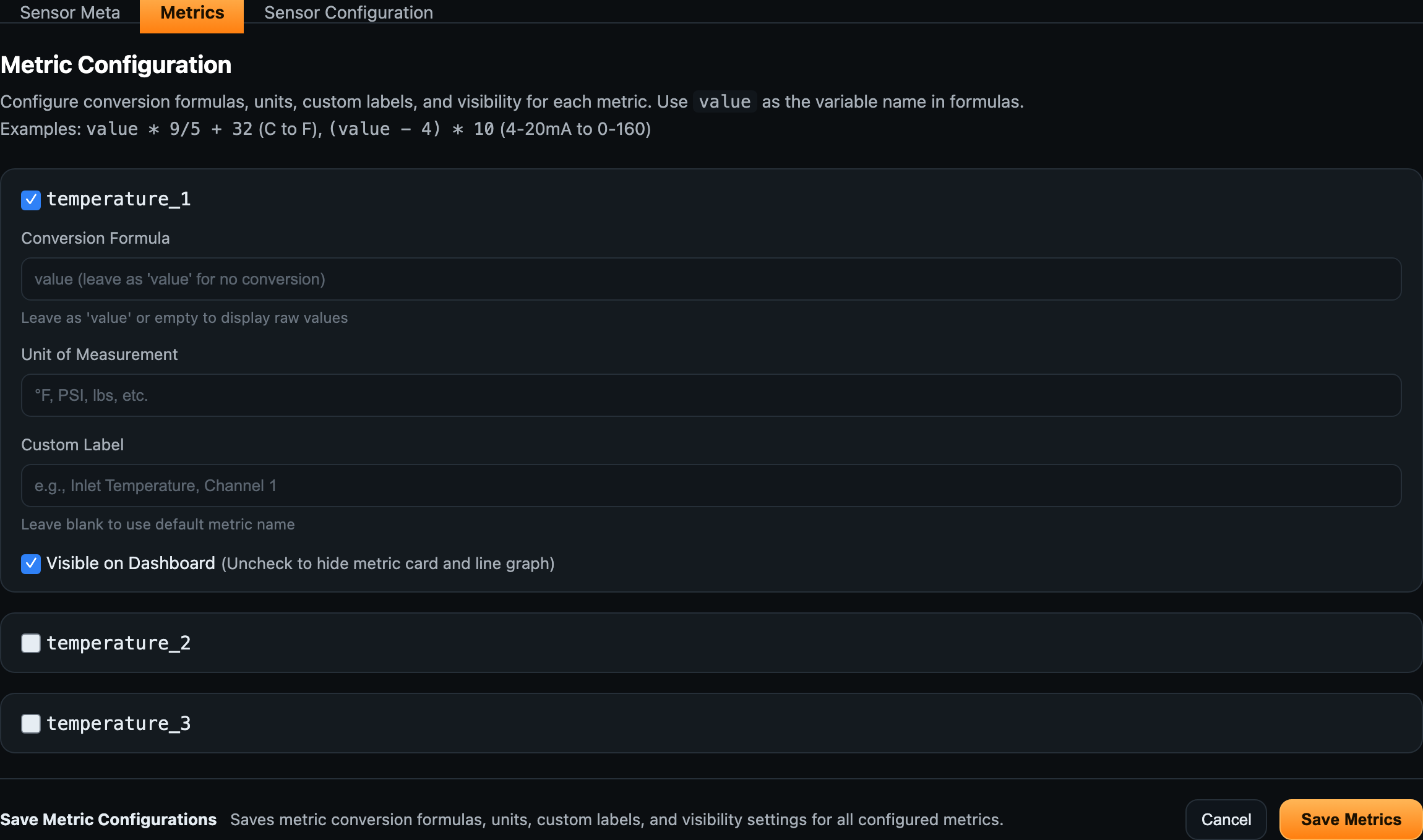

07Metric Configuration
The Metrics tab lets you configure conversion formulas, units, custom labels, and dashboard visibility for each data channel. Access it via Configure → Metrics.
This sensor exposes one temperature metric per thermocouple channel. Each value is cold-junction-compensated on-board, so Atrium receives a corrected reading:
MetricRaw DataDefault ConversionVisible by Default
temperature_1Compensated K-Type reading from Channel 1None (controlled by global Temperature Display Unit)Yes
temperature_2Compensated K-Type reading from Channel 2None (controlled by global Temperature Display Unit)Yes
temperature_3Compensated K-Type reading from Channel 3None (controlled by global Temperature Display Unit)Yes
battery_pctBattery percentage (%)NoneYes
Custom Conversion Formulas
Each metric supports a custom conversion formula using value as the variable name. Leave the formula as value or blank to display raw data. Examples:
Formula examples
value * 9/5 + 32       // Convert degrees C to F manually
value + 0.5            // Apply a calibration offset to a channel
value * 1.0            // Pass the raw value through unchanged
Custom Labels & Visibility
Each metric can be assigned a Custom Label (e.g. “Inlet Temp”, “Mid Temp”, and “Outlet Temp” for the three channels) that replaces the default metric name throughout Atrium. Unchecking Visible on Dashboard hides that metric’s card and chart without deleting data — useful if you are only using one or two of the three channels.
04 metrics config
Metric Configuration — all three temperature channels expanded showing available fields.

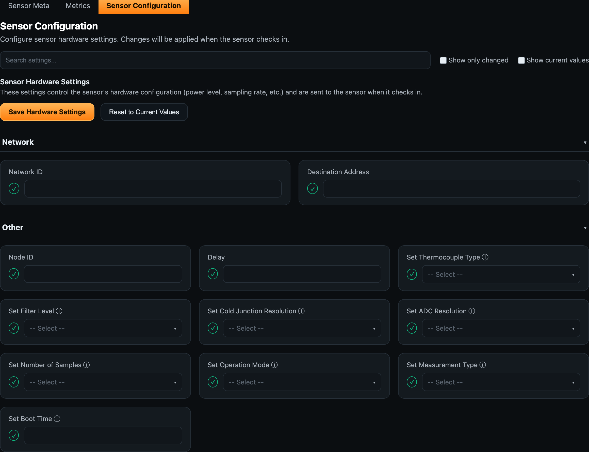

08Hardware Settings
Hardware settings control the sensor’s on-board configuration — transmission interval, network addressing, and node identity. Changes are staged in Atrium and pushed to the sensor on its next check-in. Access via Configure → Sensor Configuration. Default values shown below are loaded from the NCD config-options API and may vary by firmware version — confirm against your unit.
SettingDefaultDescription
Network ID7fffThe wireless network ID. Must match the gateway’s network ID for the sensor to communicate.
Destination Address0000ffffThe broadcast address the sensor transmits to. Typically left at default unless using a custom mesh topology.
Node ID0Optional human-readable node identifier within the mesh network.
Delay600Transmission interval in seconds. Lower values increase data frequency at the cost of battery life.
Thermocouple Settings
In addition to the network and timing settings above, the Sensor Configuration tab exposes thermocouple-specific measurement options. Defaults are loaded from the config-options API and may vary by firmware.
SettingOptionsDescription
Set Thermocouple TypeK, J, T, N, S, E, B, RSelects the thermocouple type. This product ships with K-Type probes and connectors; the firmware also supports the other seven types if you fit compatible probes.
Set Measurement TypeCold Junction, Hot Junction, DeltaWhether the sensor reports the hot-junction (process) temperature, the cold-junction (ambient reference) temperature, or the difference between them.
Set Filter LevelLevel 0 – 7Averages multiple temperature readings over time to smooth noise. Higher levels give steadier readings with slower response.
Set Number of Samples1, 2, 4, 8, 16, 32, 64, 128How many samples are taken per measurement. More samples improve stability at the cost of measurement time.
Set ADC Resolution18, 16, 14, 12 bitsHigher resolution gives more precise readings; lower resolution converts faster.
Set Cold Junction Resolution0.0625°C, 0.25°CResolution of the on-board ambient sensor used for cold-junction compensation.
Set Operation ModeNormal, Shutdown, BurstNormal is the standard reporting mode. Burst takes rapid back-to-back samples; Shutdown powers down the measurement front-end.
Adjusting the Transmission Interval
  1. 1
    Go to Sensor Configuration
    Navigate to Sensors → [your sensor] → Configure → Sensor Configuration.
  2. 2
    Update the Delay value
    Enter your desired interval in seconds. Minimum recommended value is 60 seconds.
  3. 3
    Click Save Hardware Settings
    The new value is staged and will be pushed to the sensor on its next transmission.
  4. 4
    Update the Report Interval in Sensor Meta
    Update the Report Interval on the Sensor Meta tab to match your new Delay value so offline detection stays accurate.
A shorter Delay increases data frequency and draws more power; a longer Delay extends battery life. The sensor delivers up to 5 years of battery life depending on configuration. To estimate battery life for your exact transmission interval and environment, use NCD’s battery life calculator. For continuous high-frequency monitoring, run the sensor on an external power supply.
05 hardware settings
Sensor Configuration tab showing network and timing settings.

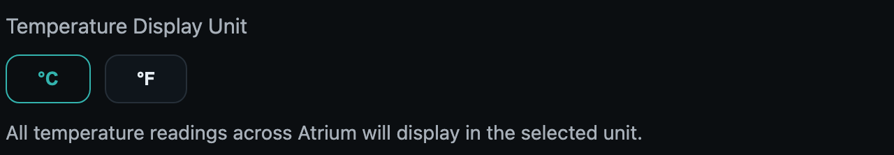

09Temperature Units
Atrium provides a global temperature display unit setting that controls how temperature readings appear across the entire interface — all sensors, dashboards, alerts, and reports, including all three channels of this sensor.
  1. 1
    Open Gateway Settings
    Click Settings in the top navigation to open Gateway Configuration.
  2. 2
    Select Temperature Display Unit
    Under Temperature Display Unit, toggle between °C and °F. This applies immediately to all temperature readings across Atrium.
  3. 3
    Save Configuration
    Click Save Configuration at the bottom of the page to apply the change.
06 gateway settings temp unit
The Temperature Display Unit toggle in Gateway Settings applies to all sensors globally.

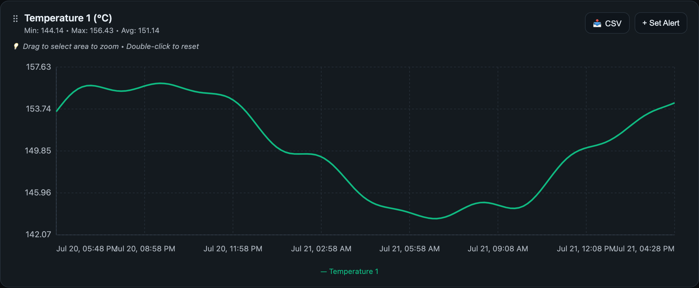

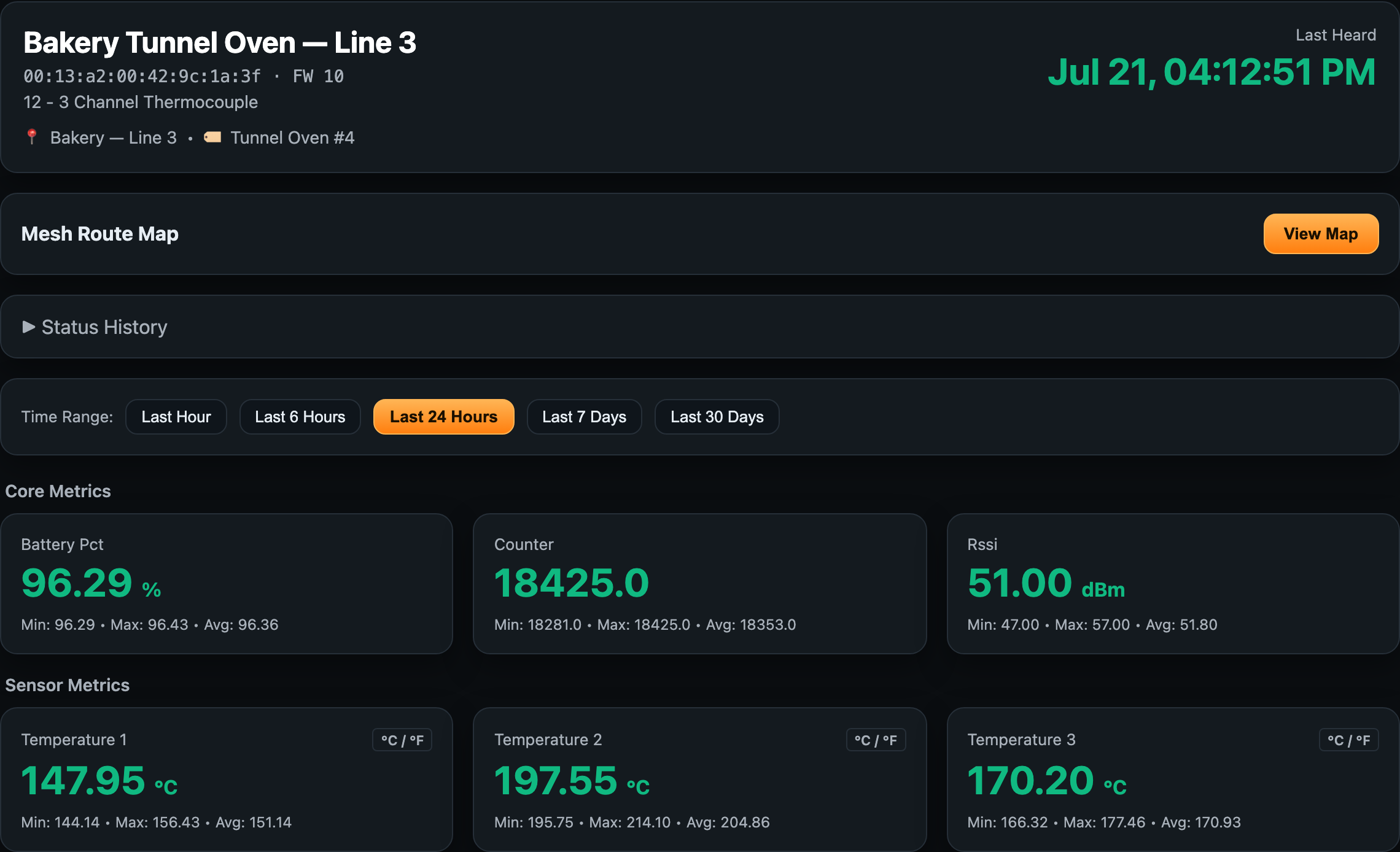

10Sensor Dashboard
The Sensor Dashboard provides a real-time and historical view of all data from this sensor. Access it by clicking the sensor in the Sensors list and selecting Dashboard.
Live Metrics
MetricUnitDescription
Temperature 1°F or °CCurrent temperature from K-Type Channel 1
Temperature 2°F or °CCurrent temperature from K-Type Channel 2
Temperature 3°F or °CCurrent temperature from K-Type Channel 3
Battery Pct%Estimated remaining battery capacity
RSSIdBmReceived signal strength — reported as positive magnitude; higher values indicate a weaker signal
