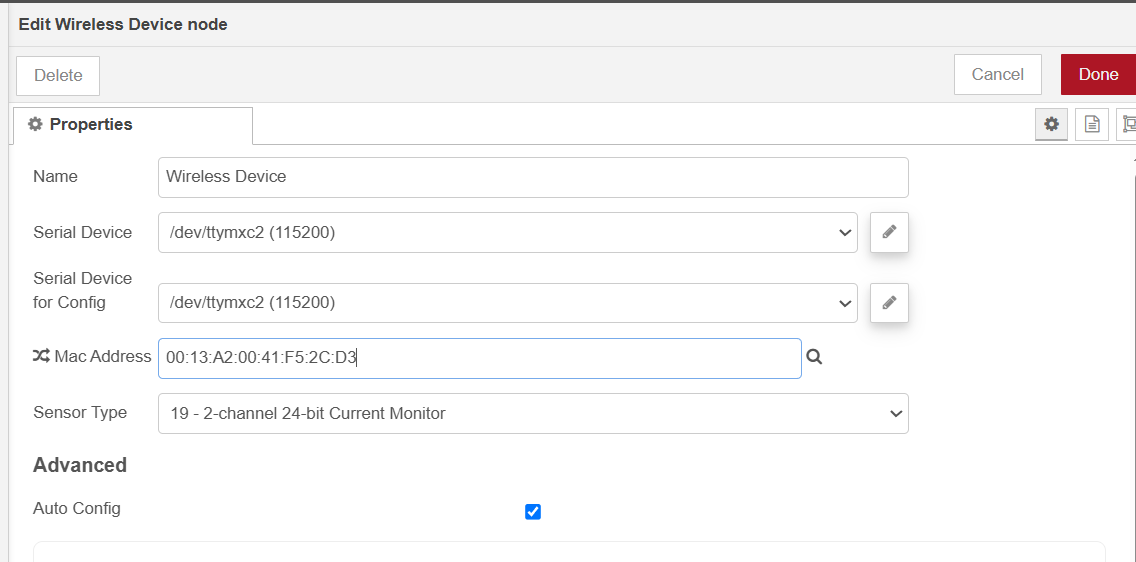

  • Name
    • Arbitrary name of this node
  • Serial Device*
    • For More information on the submenu the edit icon brings up see section ncd-gateway-config Nodes
  • Serial Device for Config
  • Mac Address
  • Sensor Type*
  • Auto Config
*Required

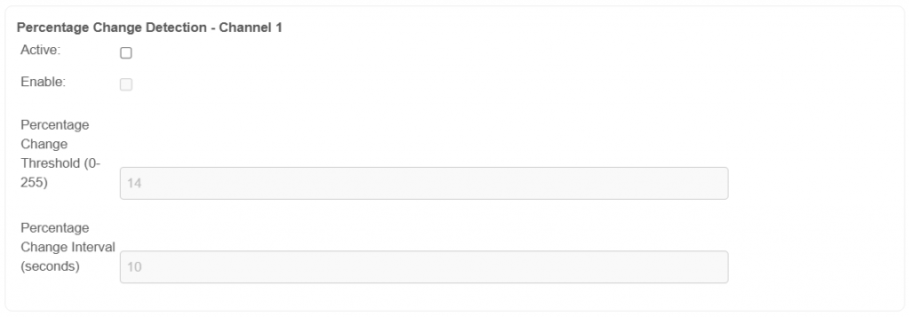

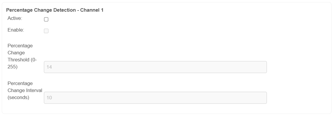

Percentage Change Detection - Channel 1
This functionality is disabled by default. If you enable it you can set two parameters:
Percentage Change Threshold – the value in % at which the sensor will send a packet. The sensor sends a packet when two consecutive readings differ by the set percentage.
Percentage Change Interval – This is the detection time after which the sensor periodically checks for the set percentage change in sensor data from last sample.
So if you set the parameters as per the example the sensor would send a data packet if the current value changes with 14% and 10 seconds have passed after the last data sample.
The above applies for Channel 1

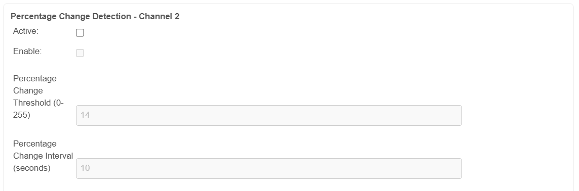

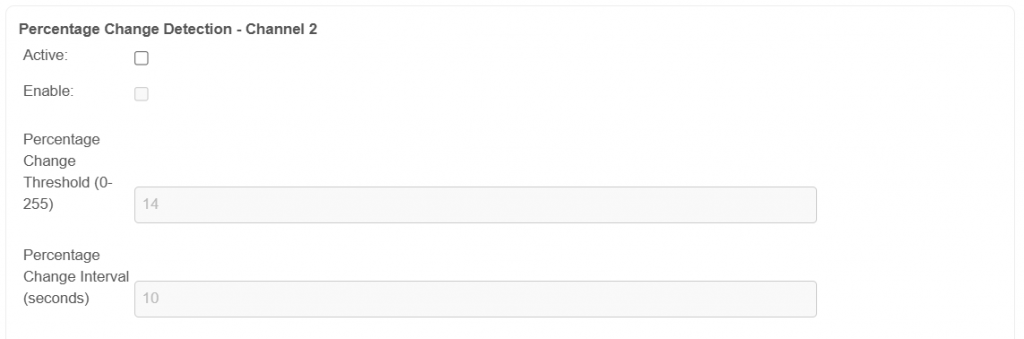

Percentage Change Detection - Channel 2
The above applies for Channel 2
